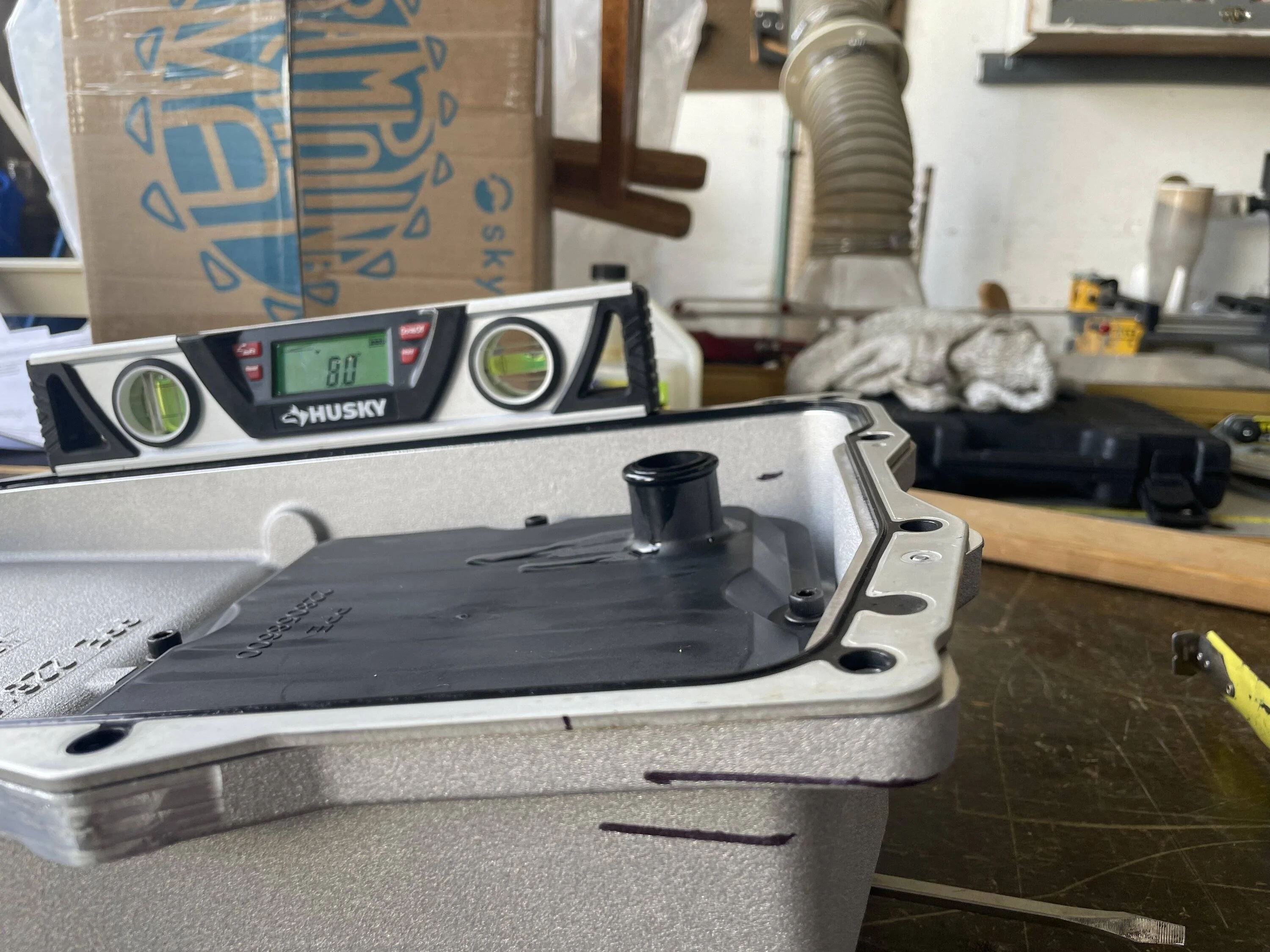

I changed out the pan because am going to install a full belly skid plate and wanted to change out the fluid once before I do that. I have done this on other vehicles I owned and found lots of metal fines and other material in the pan. I wanted anything from manufacturing and break in removed. Since I was changing the fluid and filter. The PPE pan makes doing this in the future easier. And yes, I used Mopar 8/9 speed transmission fluid for the change.
Here is the video I used when I changed the pan.

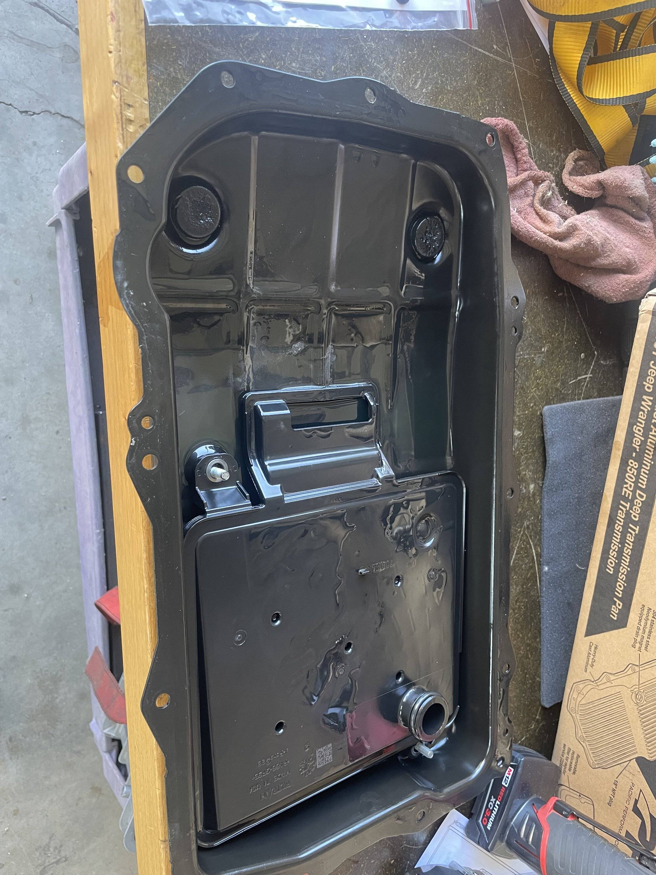

I also changed the trans pan on my JTRD to the PPE. the first thing I noticed was the difference in filters. The OEM filter has a rear pickup vs the standard bottom pickup at the front of the pan on the filter PPE uses. I wondered if this would lead to problems on steep uphills.
