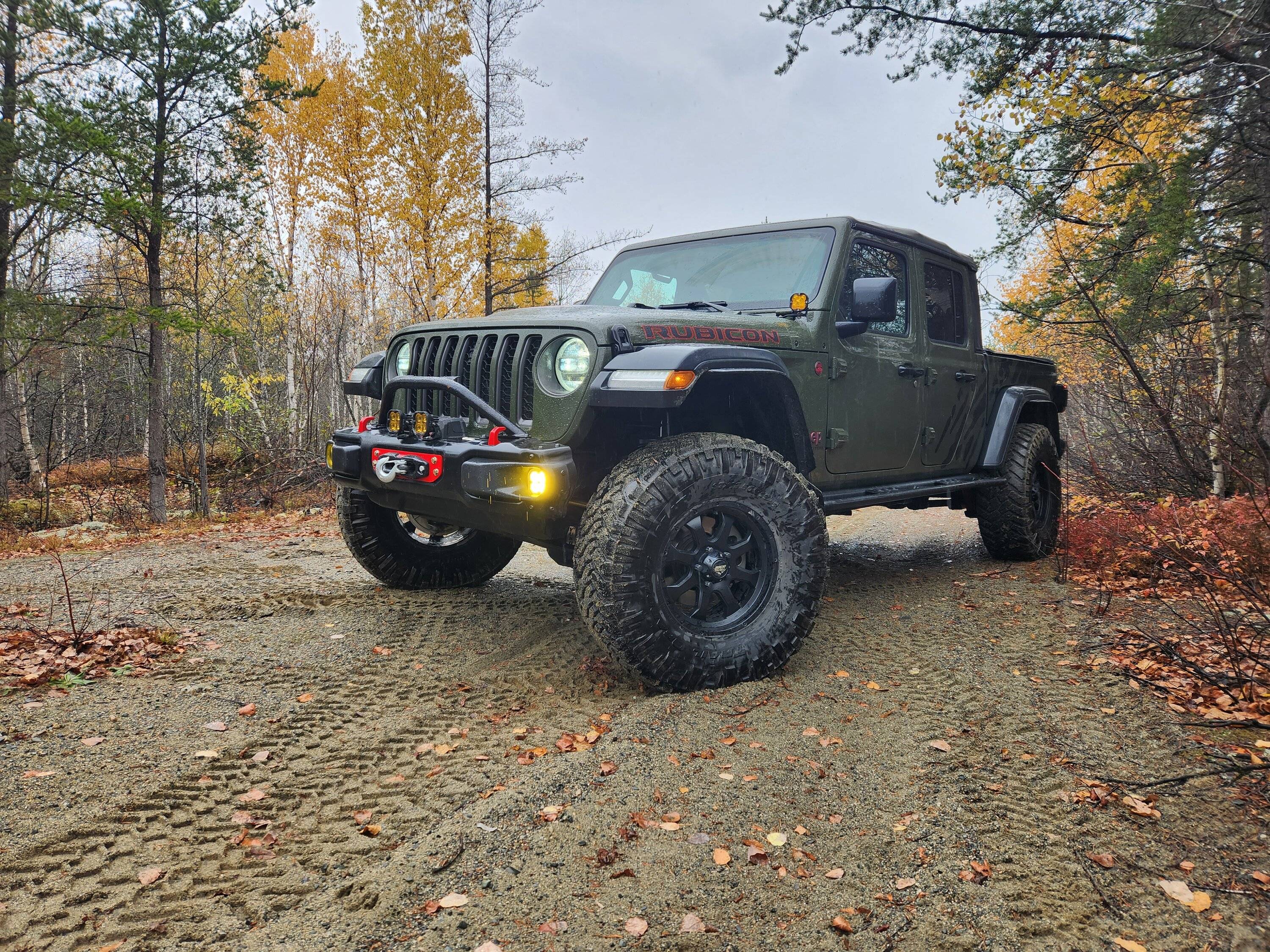

Hi guys, I've been running metalcloak true dual rate 3.5" for two years now, with their rocksport shocks, on 37 trail grapplers, on my '21 JTR 3.6 automatic
I regeared to 5.13 this summer, and now my mpg suffered a lot from that. I lost like 2mpg just because of the gears ?‍♂what I did not expect, and not what I experienced with my old jk's. I was doing better on 4.10's.. thats disapointing.
I thought about trading it in for an ecodiesel, but prices are still very high, and so are the interests, so I will wait a year or two for that option.
Anyway, the reason of the post is, I want to step down to 35's and 2.5" lift. I run 35" tires for the winter and my mpg is much better, so for daily use, and the little offroad I do, 35' would be enough. Not going offroad as much as my younger days lol.
The main question I got is, what springs should I go with for "factory like" ride? I liked the ride when stock, my MC springs ride stiff. My jeep is light, just a winch with stock bumpers and a tire carrier in the bed.
I heard good things about Clayton and synergy. Any other option I should concider? Anything that rides nice, that soaks all the small stuff without kicking my butt.
I tow occasionnally, an enclosed 7x14, around 2000lbs empty.
Also what Shocks would work great with those springs?

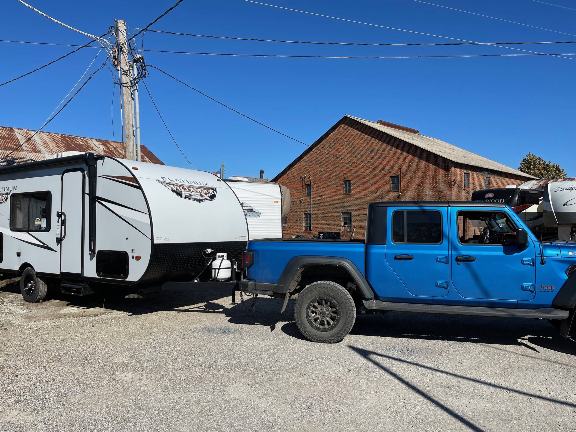

I'm a few weeks in after installing a 2.5" Clayton Overland Plus lift with Falcon 3.1 shocks on my 22 Rubicon. I can tell you without a doubt that this is the best mine has ridden or handled since I got it. Until installing the lift I’ve been at stock height but had upgraded the extremely soft OEM Fox shocks to Eibach and was using the .25” longer Mopar lift LCAs. Stock with those upgrades it drove great, but the Clayton lift and new Falcons took it to another level. Last weekend we had an RV show and I delivered two small travel trailers on Thursday and brought them home Saturday and after lowering my hitch it towed as well if not better than it did before. I’m a big fan of Metalcloak but went with Clayton this time because they had a slightly better price for what I wanted.
Did you go with the upgraded springs?
Just ordered the 3-1/2” performance overland + package and added the upgraded springs since I will run heavy with 37” tires/after market bumpers/ tent/ gear/ smart cap.
Reason asking is I was on the border about adding upgraded springs.

I find the ride of MC springs too stiff. I feel every bumps and every cracks. Pretty annoying

I went with the standard springs. Most of the trailers I tow are 5k or less and from what I've read the heavier springs will ride rough when you don't have much extra weight. I'm still running stock bumpers and no winch so the standard springs made more sense but they worked well for me. I took a picture hitched up to one of the trailer, let me see if I can find it.
