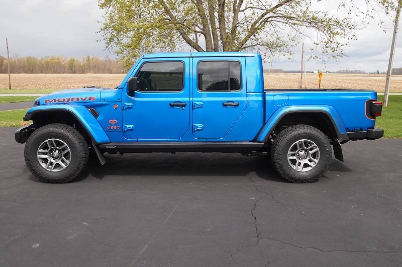

I have been running 285/75R/17 Toyo Open Country A/T's mounted on Mopar Off Road wheels.
This combination weighs the same as the stock black Mojave wheels w/Falken 285/70R/17 Wildpeak A/t's (right around 90#/wheel if I remember correctly).
Couldn't be any happier with these so far after putting just over 22K miles on them.
The tread is holding up great & wearing very even.
Plenty of clearance with no rubbing anywhere, and the Toyo's are whisper quiet on the road.
These are also fantastic in snow, in case your travels take you where that may be a benefit.
I think my mileage dropped 1 or 2 MPG with the switch, but hard to tell as I made the switch when the truck only had just over 1K miles on it, so the engine & drivetrain weren't fully broken in yet.
Jeep Gladiator Advice on stock Mojave change to 285/75/R17 ? P1011709E
Hope this might be a help.
