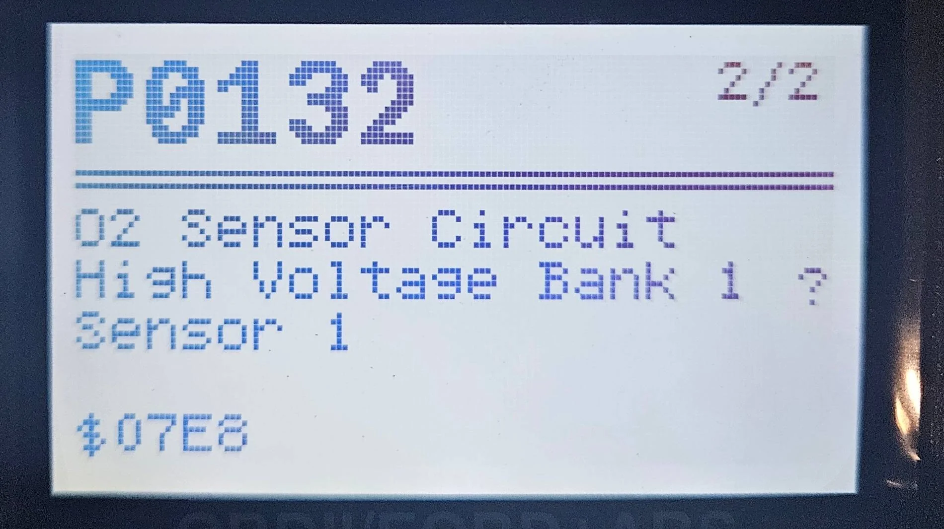

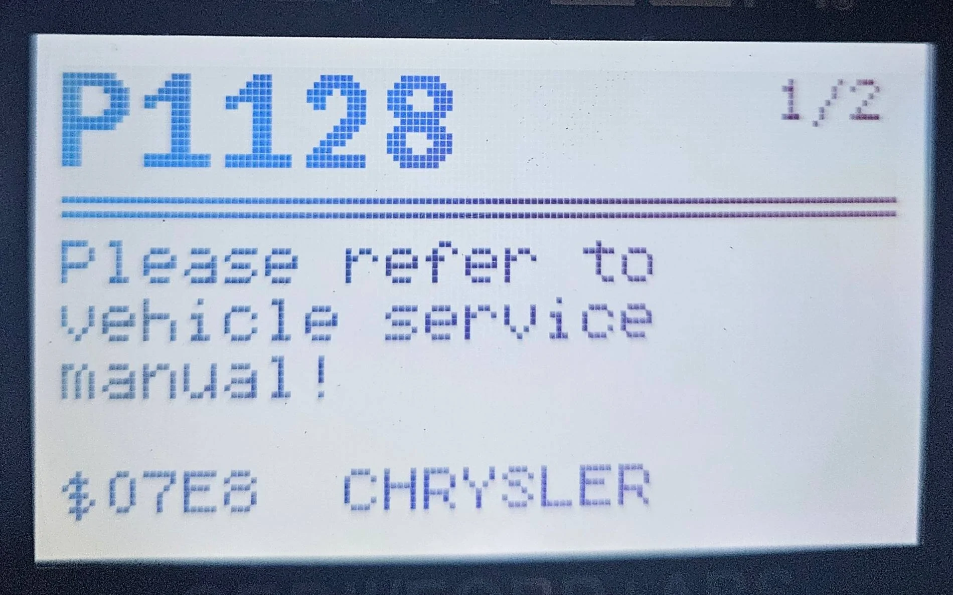

Another day, another two CEL codes.
Fuel system codes, it's staying in open loop. Perhaps due to the O2 sensor on the passenger side (bank 1 is on the right side)
Do you have a valve cover oil leak getting to the O2 sensor connector?
In any case, there's an issue over there with that bank.

Truck is brand new. No mods except bumper and winch. Just turned over 1300 miles, and this is the 4th check engine light. This one came up while it was running. The previous CELs came up on startup and would not allow me to shift into drive. This vehicle is a lemon. I am going to keep my code reader in the vehicle and start documenting the codes. I also wonder why my code reader is unable to erase the codes.
I had similar codes when it misfired due to bad coil packs. Several codes that seemed to make no sense, and seemed unrelated and impossible. I had one code that said my o2 sensors were hooked up in reverse. Ridiculous. Replaced the bad coil packs, and no more problems of any kind. Some of these codes happen because the ecu assumes if one problem occurs, the other probably does as well.
The O2 voltage high could indeed mean a rich condition, the other indicates there's a problem causing it to not go to closed loop.
So if there's enough misfires, it's going to send unburned fuel out the exhaust, causing the O2 sensor voltage to rise.
I'd love to have jscan on that and see what the misfire counts are on that bank.
It should even tell if it's an ignition misfire or not.
It did on our Grand Cherokee a few years ago - clearly said "ignition misfire".
It indeed needs to go back to the dealership - they should be able to read a lot more information, even capture a freeze frame giving more details.
