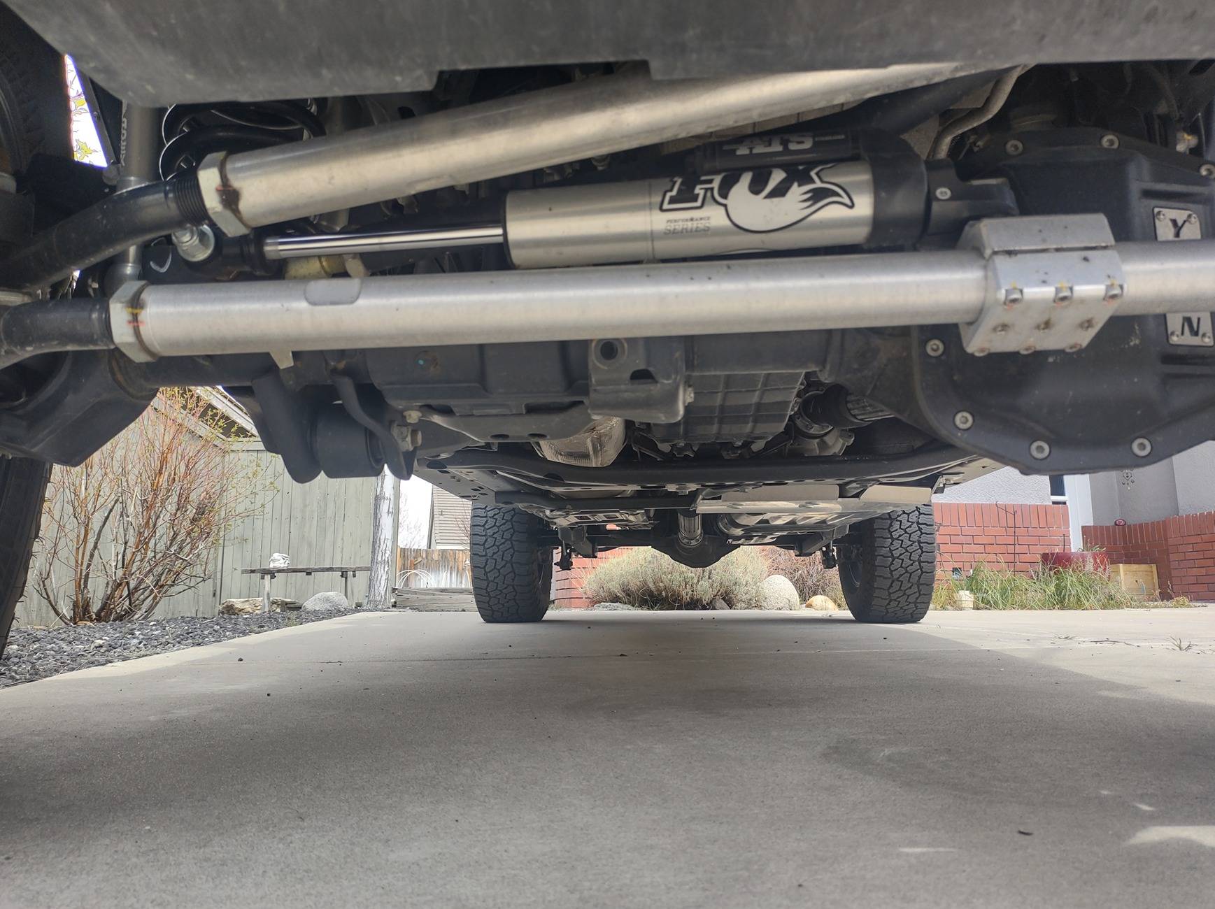

I had a creaking noise in my steering linkage. Tracked it to the tie rod end on the drag link at the pitman arm. It was just a tad loose. Didn't cause any other issues. Replaced both the drag link and tie rod with Core 4x4 steering linkage.

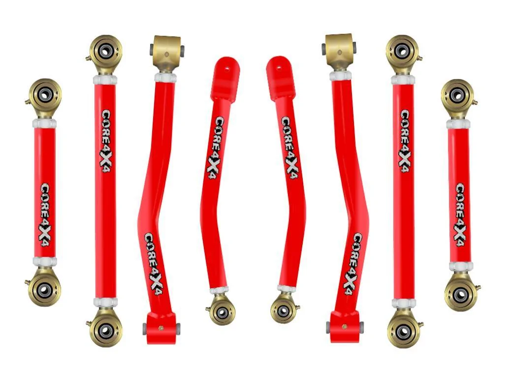

How do you like the Core 4x4 tie rod and drag link? I was thinking about buying those in red so they match my control arms.

So far so good. No issues with any of my Core stuff. If you get the Core steering linkage. Get the steering stabilizer bracket too. Getting one later on takes time.
I bought crows feet wrenchs from Snap On so that I can torque the jam nuts.
