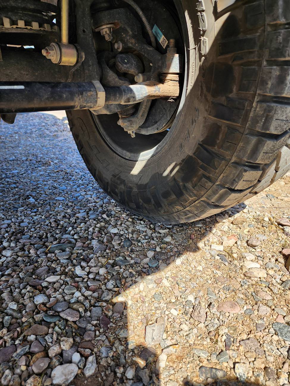

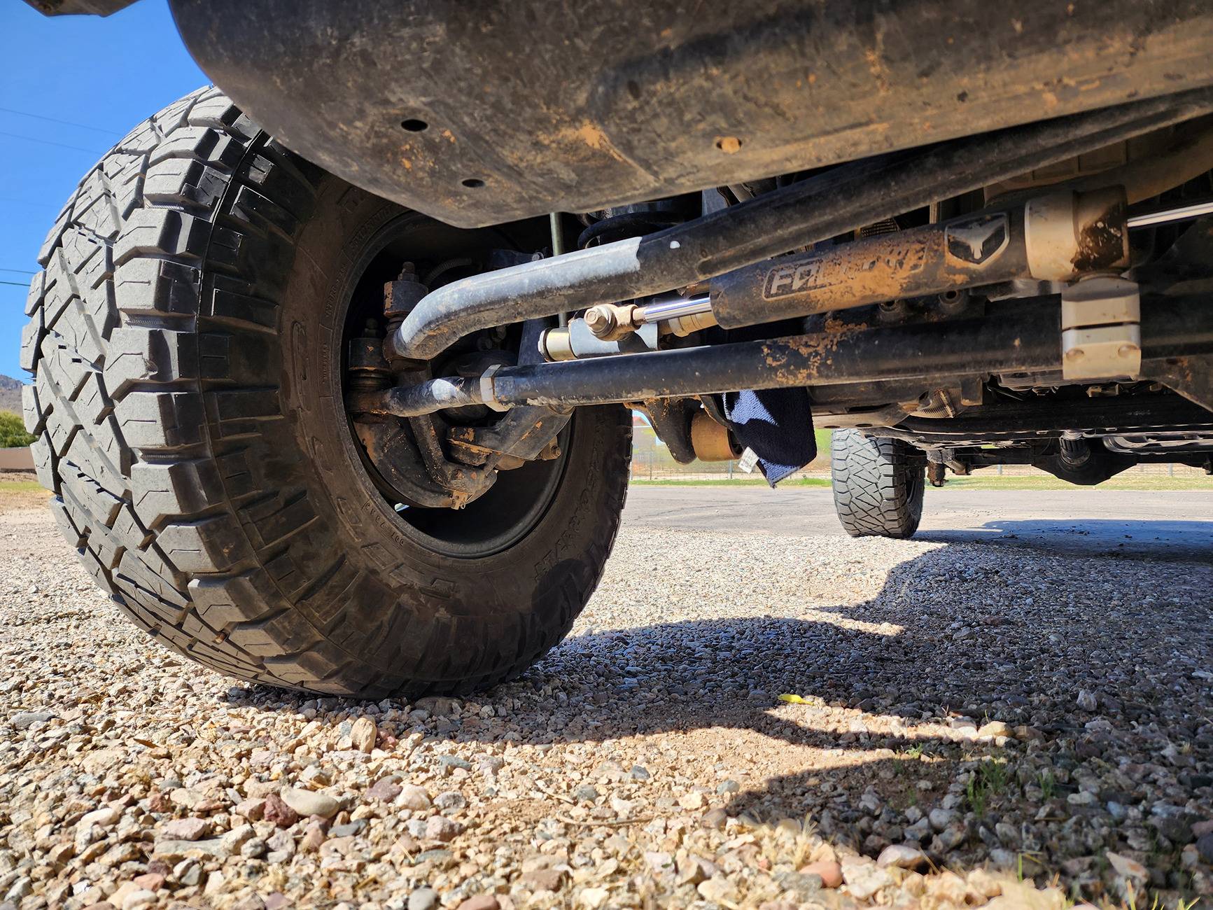

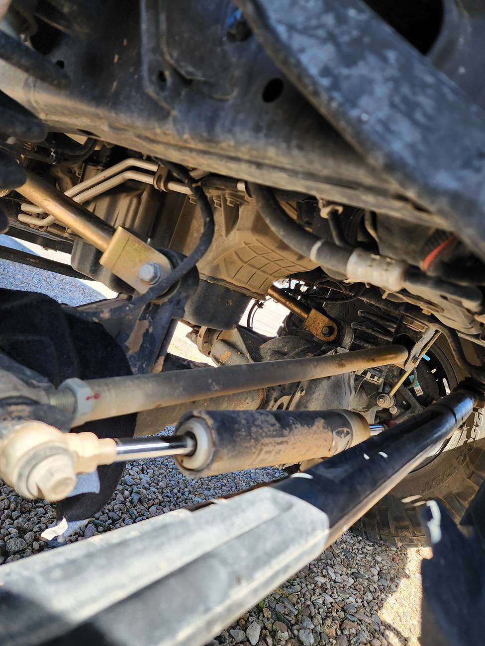

I took some pictures of the current set up, so if there is any better experience, I would love to hear it.

When you get the steering linkage. Put more anti seize on the threads and run the tie rod ends in and out a couple of times. Wipe off the anti seize on the face of the bars and jam nuts where the jam nuts mates to.
What I did for alignment. I removed the tires and measured from the outside edge of the brake rotor to outside edge of the other brake rotor. Then I removed the tie rod bar, then the drag link. I measured the lengths of both bars, using the center of the tie rod ends. I then set the Core bars to the same measurements. The drag link has to be installed first. If you install the tie rod bar first. The steering knuckle end of the drag link won't fit. Don't ask how I know. Once the bars are installed. Check your measurement from rotor to rotor again. Adjust until you get your measurement. I centered the steering wheel myself by driving around the block. Stopping and making adjustments as needed. Neighbors think I'm nuts anyway.....so.

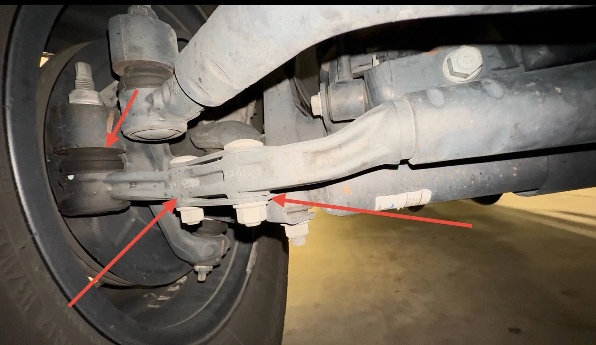

I’ve been having a weird almost rattle sound that’s gotten a bit more obvious over time. Only hear it at low speed and do not feel it as feedback in the steering wheel or seat. I thought it was probably shocks since I’m on the original Fox at 63k miles.
However, I got under the truck this evening to see if I could find anything obvious and to center the steering wheel a bit better. I grabbed the tie rod and was able to twist it enough to cause the same type of sound I’m hearing in the cab. I took a video of the area it is moving. I do not see anything ‘odd’ looking and would appreciate some input.

Trying to post the video of movement and not having any luck. I’ll see if I can create a still and point out the issues.
Have someone turn your steering wheel back and forth while you have a finger on each tie rod end to feel movement. All linkages twist to some degree. Your's might be loose enough to cause the noise.

Check the tightness on the bolts for the steering stabilizer. Then put your finger on the tie rod end and the steering knuckle at the same time and have someone turn your steering wheel back and forth. Should not feel any movement.
Thanks for the advice. Pretty positive something is “loose” or worn. Any suggestions for what to ‘tighten’ first?
