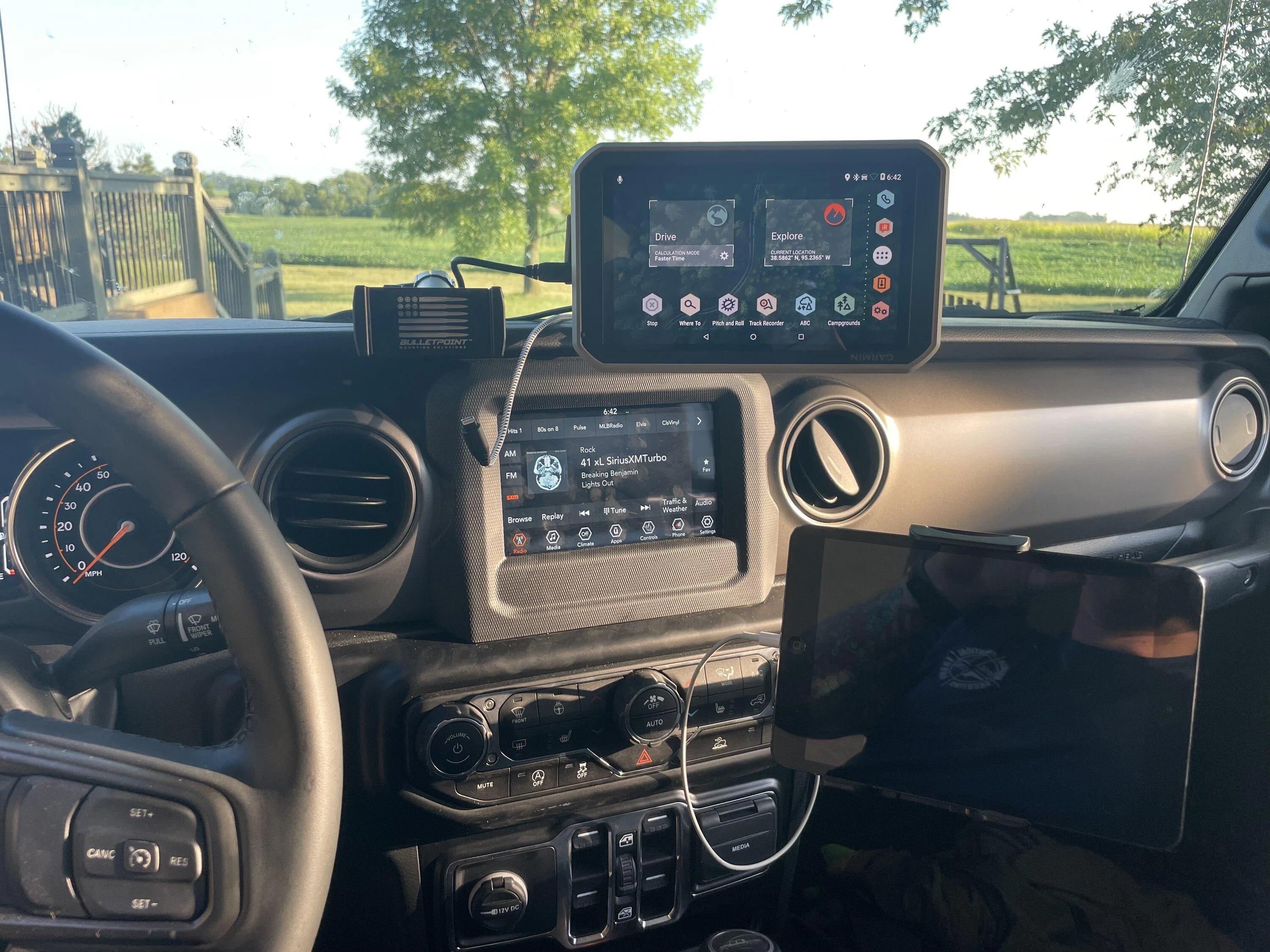

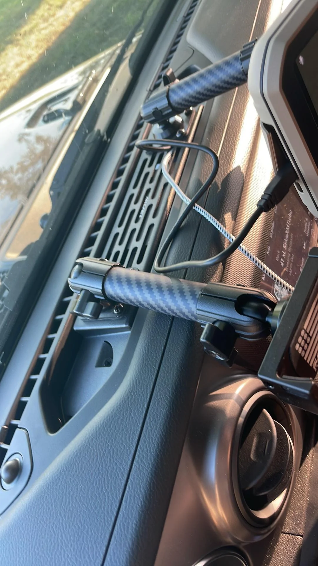

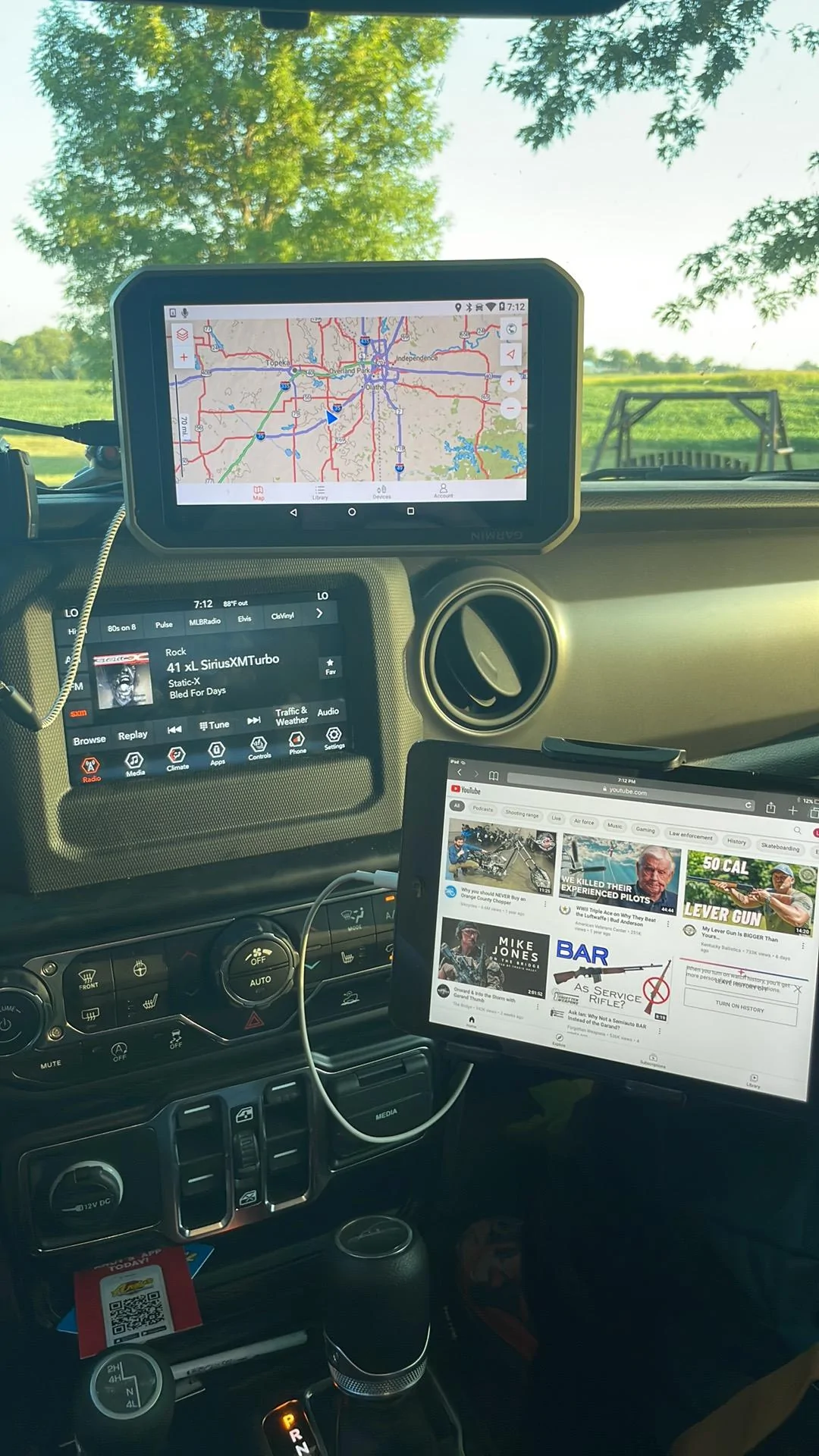

I blatantly stole your idea. Used bullet point mounts and hid the power block under the mount.
thanks for the inspiration !!!

Haha, no issues here! Looks like it turned out well! Still no issues with the setup on my end, so I can still highly recommend a configuration like this.
