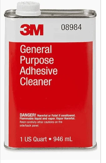

This stuff works great when combined with the fishing line method.
Drizzle a little around the edges of the letter before starting, and re-apply as you go. Then use it to remove ant adhesive residue.
Be very careful if using the pry tool or grabbing the letter and pulling it by one side only. You can end up denting the metal.
