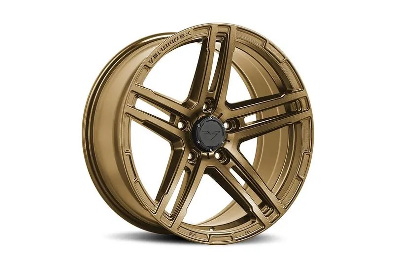

Oddly, these501 wheels came up in my ebay recommended listings today. I'm a fan of bronze wheels and based on the price I had to click the ad. THis led me down the path of researching these wheels (mainly offsets) and that research brought me right back to this forum and thread. Pretty cool the manufacturer is right here answering questions and comments. Great looking wheel designs. I really like the 501's. Put me on the list for people hoping for a +25ish offset in the future.

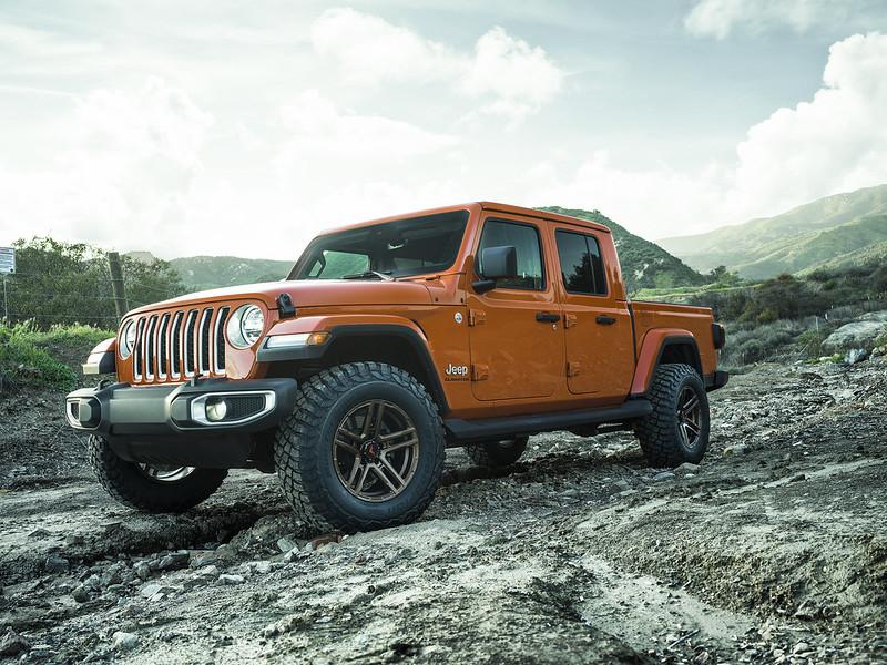

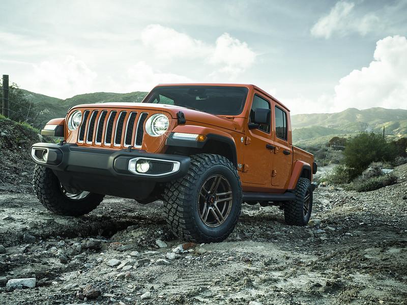

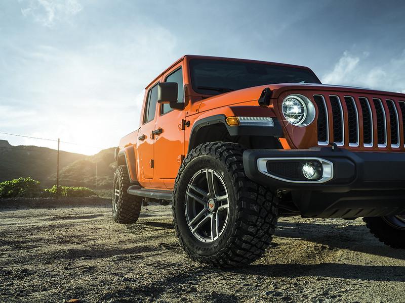

I am still new to trying to understand all the lingo that goes along with changing wheels and tire sizes.....in the picture of the orange gladiator you are running the 17" wheels with 285/70/17 correct? Is anything else changed on the suspension or wheels spacers installed? I like the look of how they are pictured but would want to make sure I would be legal in PA with how far it looks like they stick out....
Any info is appreciated!

So I really want some bronze 17" 501s for Christmas. Are they going to be back in stock by then? Also, are you going to do buy 3 get the 4th free this year?

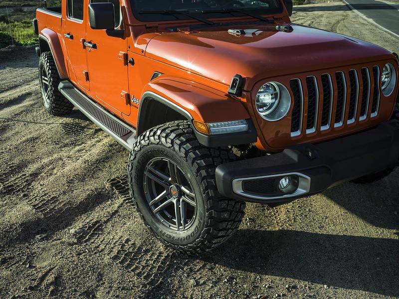

Unfortunately this most likely won't happen. The reason AEV is the only one doing it is because they work with OEM a lot and keep things within conservative OEM specs. Problem is when you really want to use the truck for offroading, and perform better than stock, and increase the tire size to do that, then you run into issues with rubbing the frame and suspension. This is why everyone else use more aggressive offsets than OEM because 90% of customers are looking to modify their Jeep more aggressively and to perform better.
However, our wheel fitment actually does sit within the fender wells. The poke you potentially get is not from the wheel, but from the exact tire size and model you choose. so if you want to go with a conservative look, and not have any poke, you can still run our wheels, but just use a smaller tire thats not as wide and you will be all good!
Hi new to all this. I was wondering what all terain 35 tire you would recommend to go with your 501 wheel. I dont want it sticking outside fender and most of all I want it to drive on road near exact to the OEM rubicon with 33s I have now. Is this possible? When is your next sale ready to buy if you have a code?
