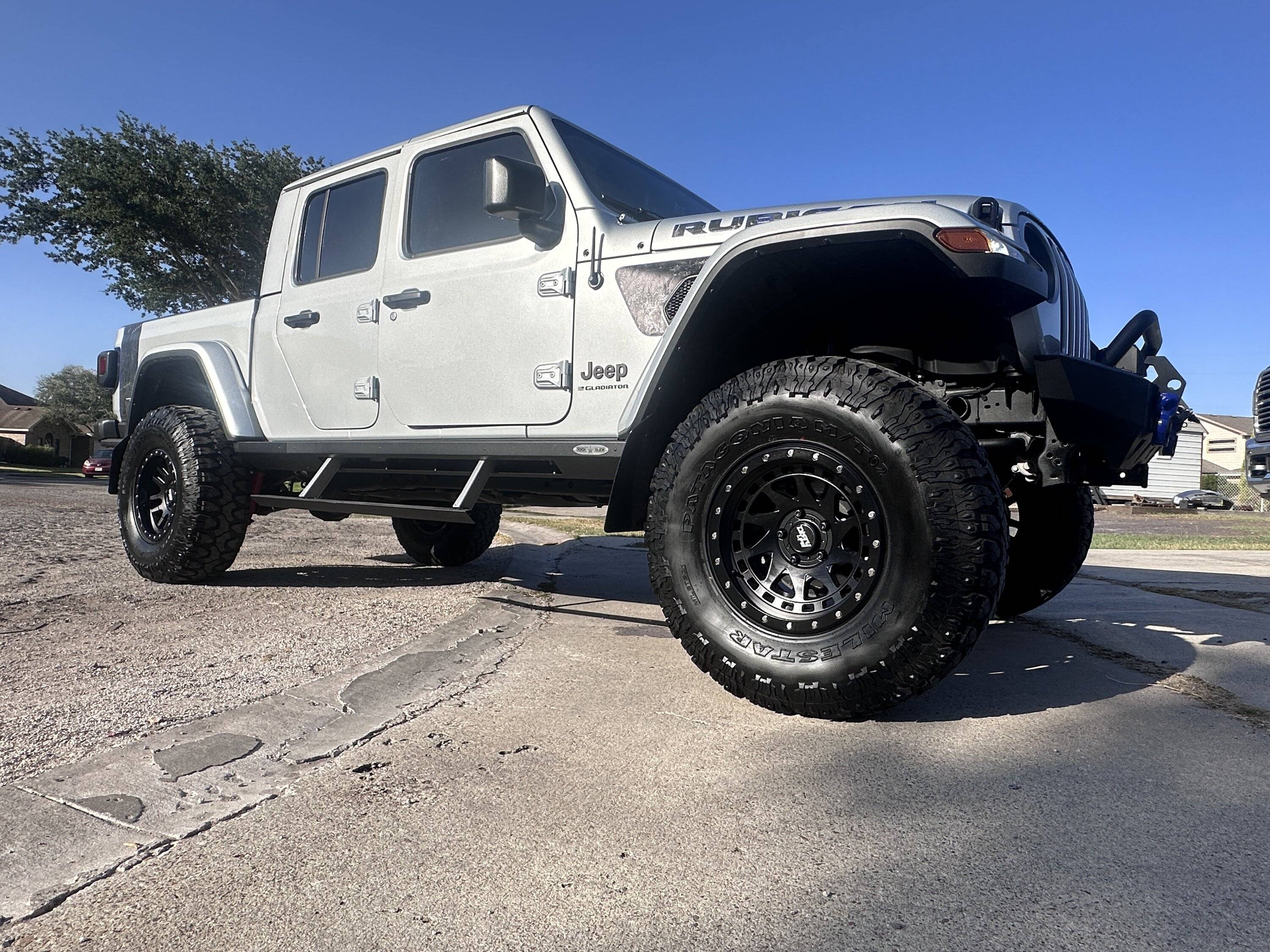

I've lift my 2023 Rubicon with a Clayton 3.5" over land lift with their HD rear spring which added about 3/4" more lift they said. I've have 37.12.50/17 milestart patagonia mt2 on it. with 5:13 yukon gear and a 1.5" drop for the carrier bearing. I have a vibration around 65-75. That i can't figure out. It's not a tire shake like one's out of balance i just had that check. It's for sure something with the drivetrain. I had it aligned but i'm not sure i trust the shop that did it. I just changed the def oil and everything looked good in there. I'm sure i'm not the only one thats had a problem so any idea on what to check are try??? The only thing i can think of is pinion gear angle.

The HD rear coils are designed to run about 600-800 lbs of additional weight from accessories, so it's possible that without enough weight on there, the springs are adding a bit too much height. However, this is also an issue that a lot of times is solved by going through and checking all of the jam nuts on all control arms and track bars to make sure nothing is loose, as this will definitely lead to vibration and eventually worn-out threads.
While the issue may not be suspension related at all, feel free to give us a call and we are always happy to do what we can to help out!
