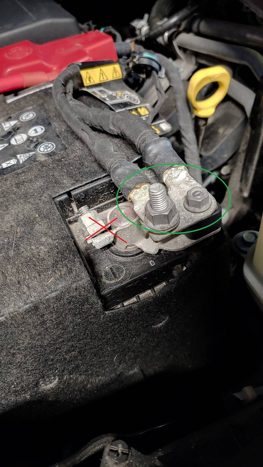

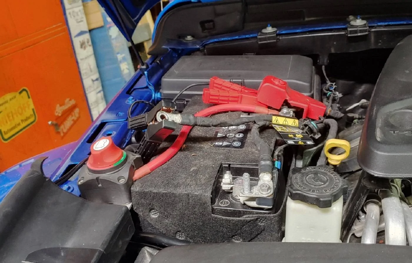

Thank you for that feedback. I did not charge them before installing. I wasn’t aware that was a thing. Is it possible to do so now that they are in the vehicle? Would rather not have to dig that aux battery out again. Can it be isolated and charged in place? If necessary I will do what I have to do. Any recommendations on a “good” charger.
Yup - just take the two ground cables apart and you can charge the aux battery by itself and the main battery by itself. Remove the IBS to reset it, erase all history.
You can charge the aux battery in place by connecting to the main battery positive and to the black cable that goes down to the aux battery.
Then charge the main battery the normal way.
Once it's all back together, do any subsequent charging by connecting to the cables on the top of the IBS - never directly on the main battery negative post.
Jeep Gladiator Voltage JT-neg-bat-post-connect
Since you have a 2020 (they changed cables in 2021 model year) you can connect like this to charge aux only ->
Jeep Gladiator Voltage 20220530_094946_HDR
