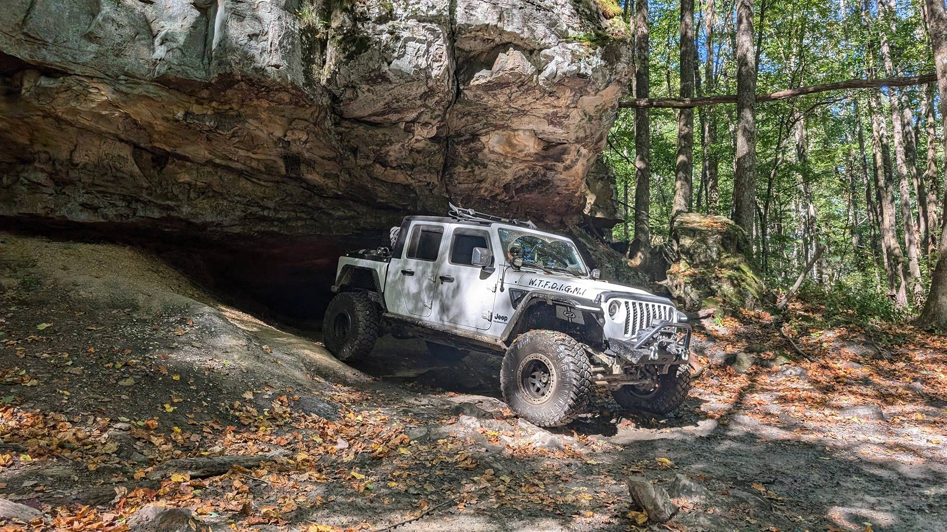

So been a couple busy months, back in August my mother passed away and part of the busy-ness was dealing with her funeral, estate, and my grief.
Been out wheeling a few times in September and October - Windrock a couple times and most recently to SMORR and Kansas Rocks -
Jeep Gladiator W.T.F.D.I.G.M.I - Turning my daily drive into a trail rig. PXL_20240914_150218429.MP
Jeep Gladiator W.T.F.D.I.G.M.I - Turning my daily drive into a trail rig. MoabHill2

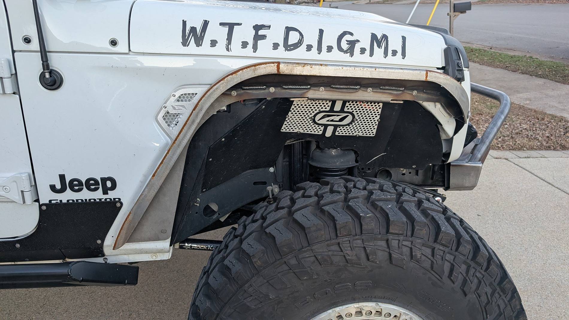

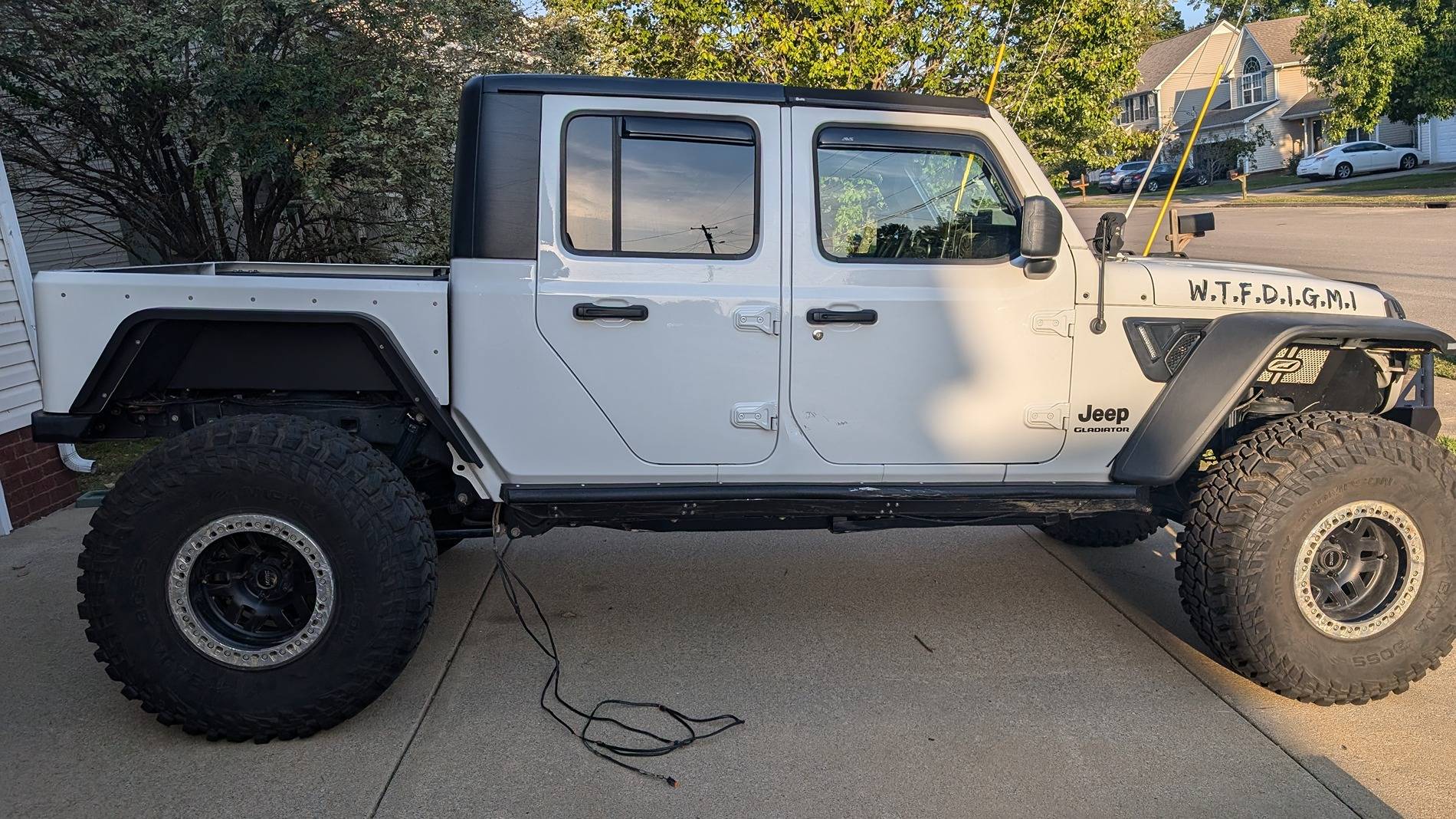

And now I'm rushing ahead to my next projects. If you'll notice in the pictures above at Windrock I had a spare on the rack and 37's on the Gladiator.
Moved up to a set of Mickey Thompson Baja Boss MT's in 40x13.5x17 for the SMORR trip, it's a surprising improvement over 37's. Always knew it would mean more clearance but it's a LOT.
Gladiator just feels right on 40s.

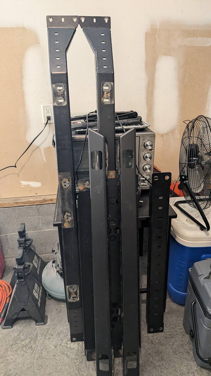

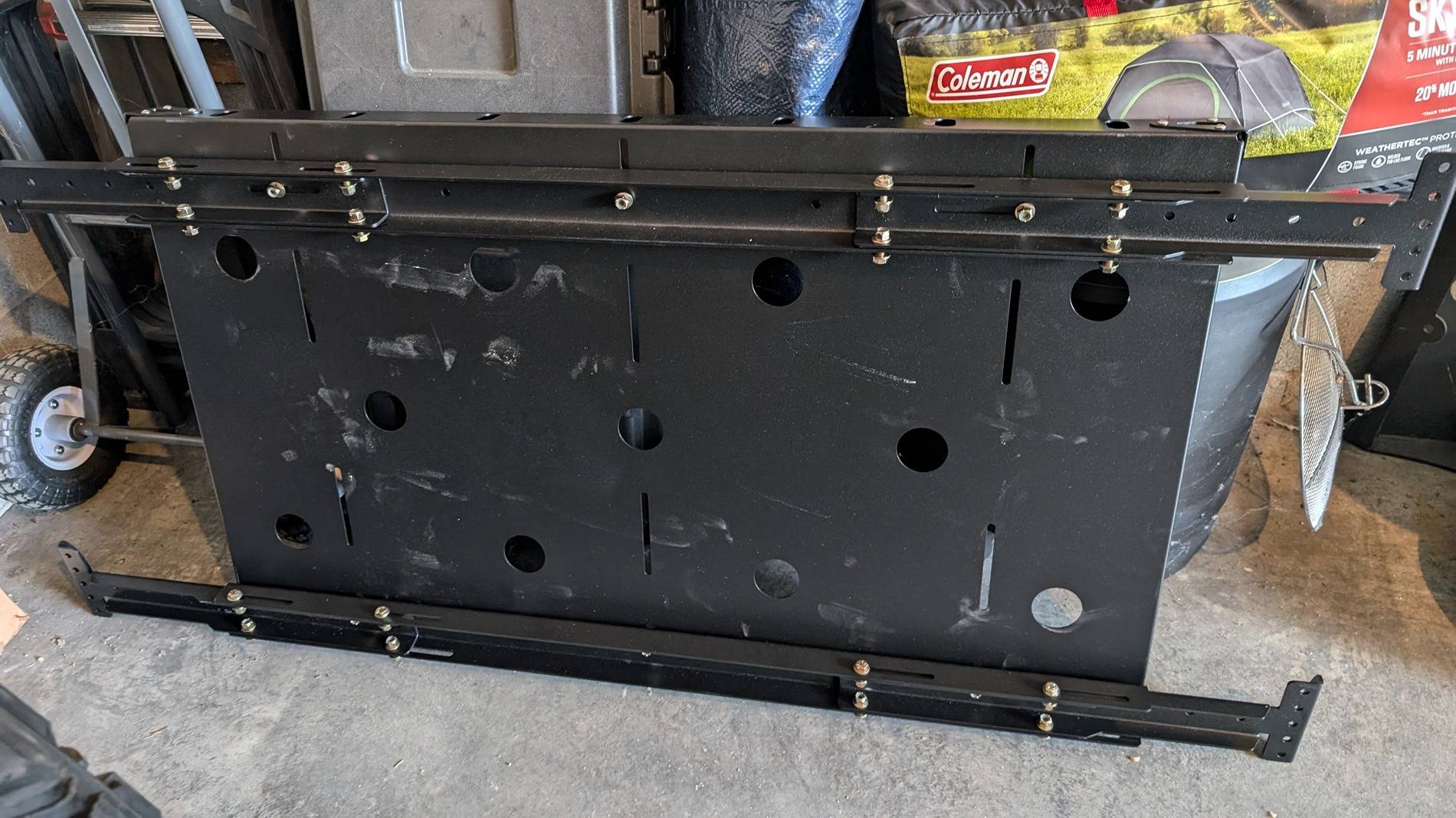

Again more of the rack missing and the loose wiring from my bed lights as I strip them off for now.

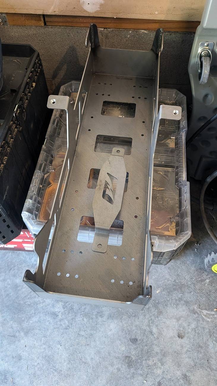

Getting the rack ready to go to powder coat for a professional finish along with a few other new Motobilt goodies -
Jeep Gladiator W.T.F.D.I.G.M.I - Turning my daily drive into a trail rig. PXL_20241012_220201068
Jeep Gladiator W.T.F.D.I.G.M.I - Turning my daily drive into a trail rig. PXL_20241012_220213968
The rack needs a good professional coating as my garage rattle can is already starting to flake and gather surface rust. New Jack Mount will be coated at the same time as well as the brackets for the cargo rack to replace the tire carrier -
Jeep Gladiator W.T.F.D.I.G.M.I - Turning my daily drive into a trail rig. PXL_20241012_220255381.MP
The cargo rack is one of a few things that Motobilt sells already powder coated, so all that is needed there is the additional brackets to help it mount to the bobbed bed rack.

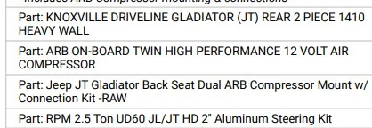

I've also got some extras on order to go with the setup -
Jeep Gladiator W.T.F.D.I.G.M.I - Turning my daily drive into a trail rig. RearAxleTwo
Jeep Gladiator W.T.F.D.I.G.M.I - Turning my daily drive into a trail rig. Extras

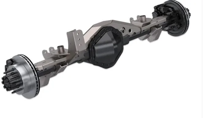

Silly question, but that 14 bolt axle says JL rather than JT. I'm under the impression that JL amd JT rears are not interchangeable. Checking on ECGS they don't say they offer a 14 bolt for the JT rather just a D60 or D80.
drewcnit
drewcnit
Andrew
Apr 26, 2022
686
1,836
Near Nashville, TN
2022 Gladiator Sport S, Bright White
IT Geek and Data Nerd
That's correct, it does say JL but my shop confirmed it's a roller housing with no brackets. ECGS website even has this bullet point - 1/4" Plate Stock JL Brackets. Bolt-In Ready.
Jeep Gladiator W.T.F.D.I.G.M.I - Turning my daily drive into a trail rig. 1728819175944-uu
Since that housing and setup is the preferred one for street driven vehicles, they will weld on the Artec bracket kit for a JT -
Jeep Gladiator W.T.F.D.I.G.M.I - Turning my daily drive into a trail rig. 1728819478149-7z
The only thing not interchangeable about the rear axle of a JL and a JT are those bracket positions for the most part.

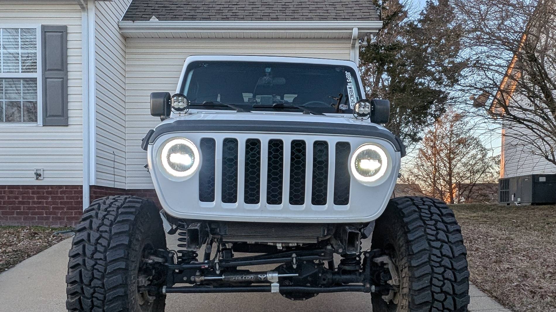

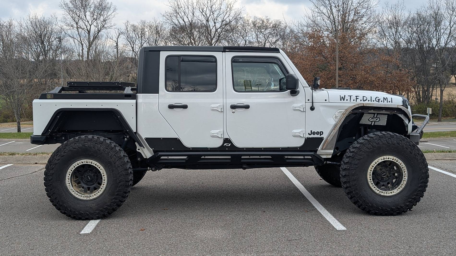

Well since last time I posted a few things have been done to continue the Motobilt armor and theme -
First was real sliders after my incident at SMORR -
Jeep Gladiator W.T.F.D.I.G.M.I - Turning my daily drive into a trail rig. PXL_20241006_140043759.MP

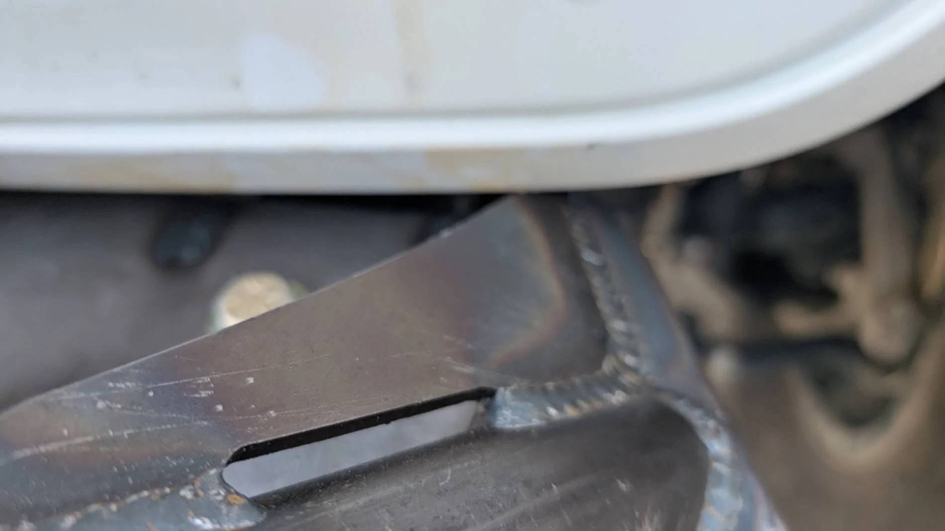

So took the steps off and added Motobilt rocker armor and weld on sliders (look at that door and hinge clean up as well) -
Jeep Gladiator W.T.F.D.I.G.M.I - Turning my daily drive into a trail rig. PXL_20241221_174433134.MP
Also done at the same time was the front fenders at least initial install, they've got to come back off for coating and final install in January when it's down for axles. Surface rust on my fenders right now because they've been in the elements. Can't wait to get them coated.
Jeep Gladiator W.T.F.D.I.G.M.I - Turning my daily drive into a trail rig. PXL_20241222_223615231

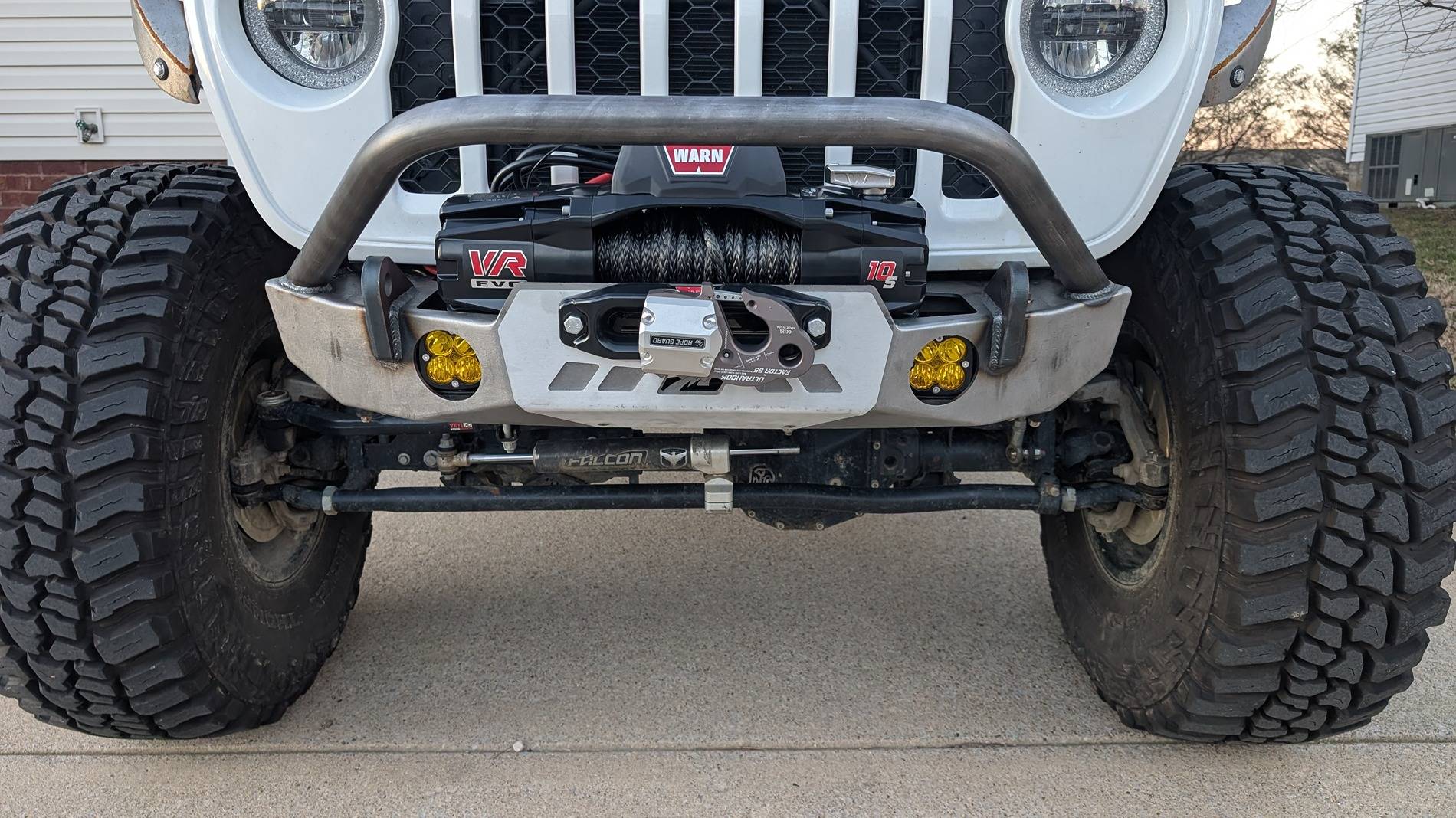

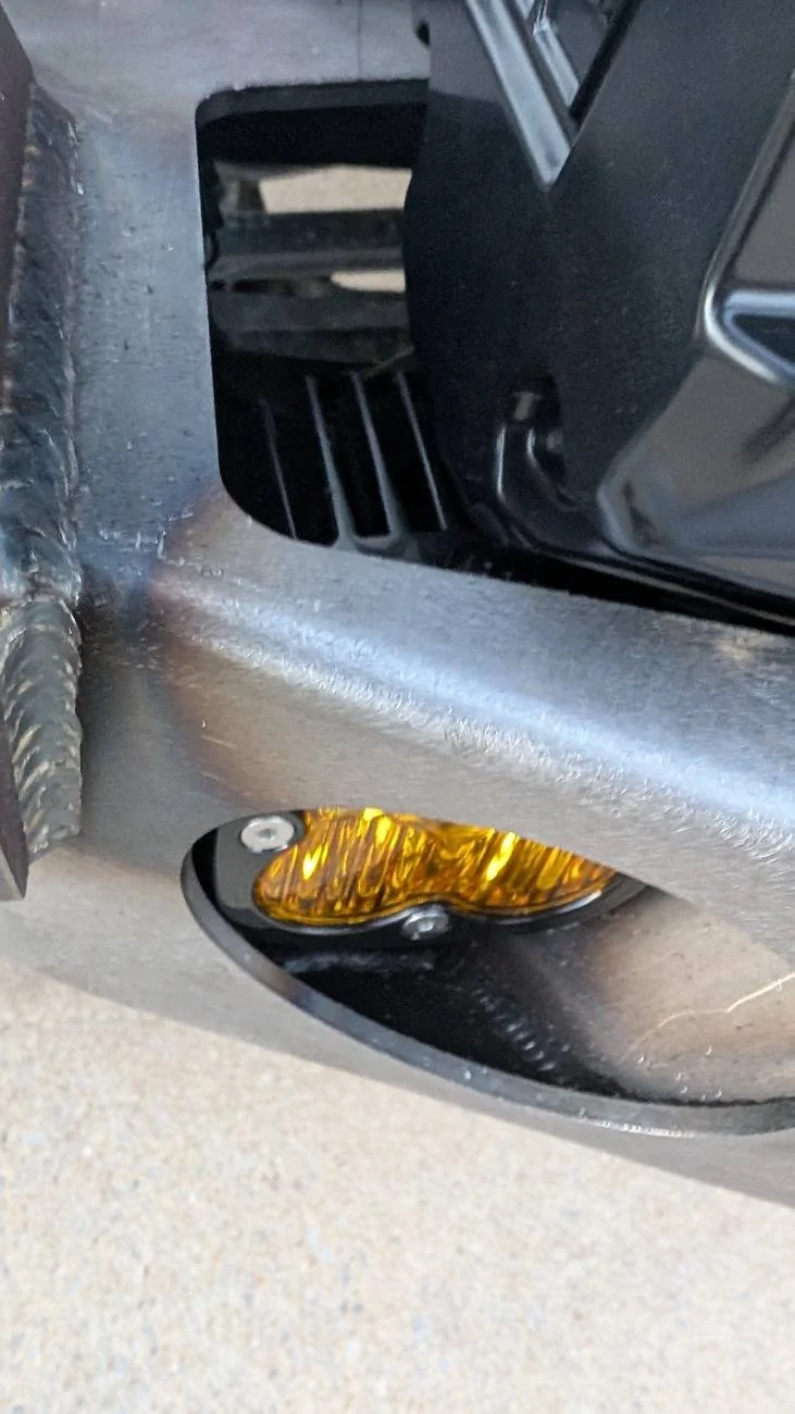

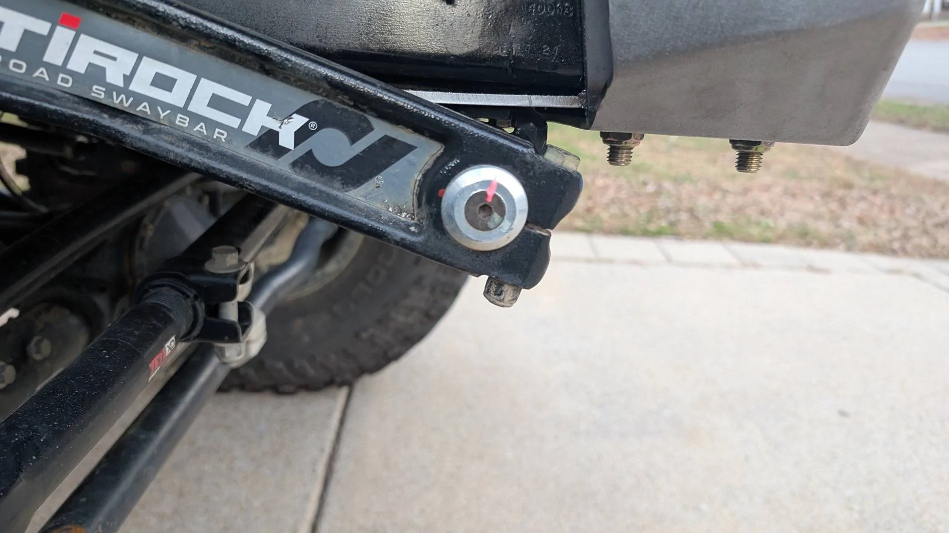

Also peaking in those pictures is the most recent addition, the gladius frame chop front bumper.
This thing is TIGHT, measure your winches twice... I had a Warn 9.5xp-s that I intended to install, but with how tight the winch mount area is and the offset larger motor on the side of the xp-s that plan had to change and we added a VR Evo 10-s instead, with some amber baja designs that are wired to my fog light button now.
Jeep Gladiator W.T.F.D.I.G.M.I - Turning my daily drive into a trail rig. PXL_20241222_223523391.MP
When I mentioned tight... this is Driver side where the bumper meets the grille -
Jeep Gladiator W.T.F.D.I.G.M.I - Turning my daily drive into a trail rig. PXL_20241222_223530051
And Passenger side where baja design and winch meet -
Jeep Gladiator W.T.F.D.I.G.M.I - Turning my daily drive into a trail rig. PXL_20241222_223538308
Anti-Rock Mounts to the bottom of the bumper -
Jeep Gladiator W.T.F.D.I.G.M.I - Turning my daily drive into a trail rig. PXL_20241222_223559978.MP

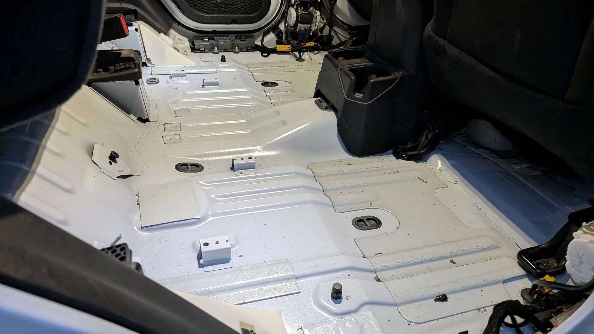

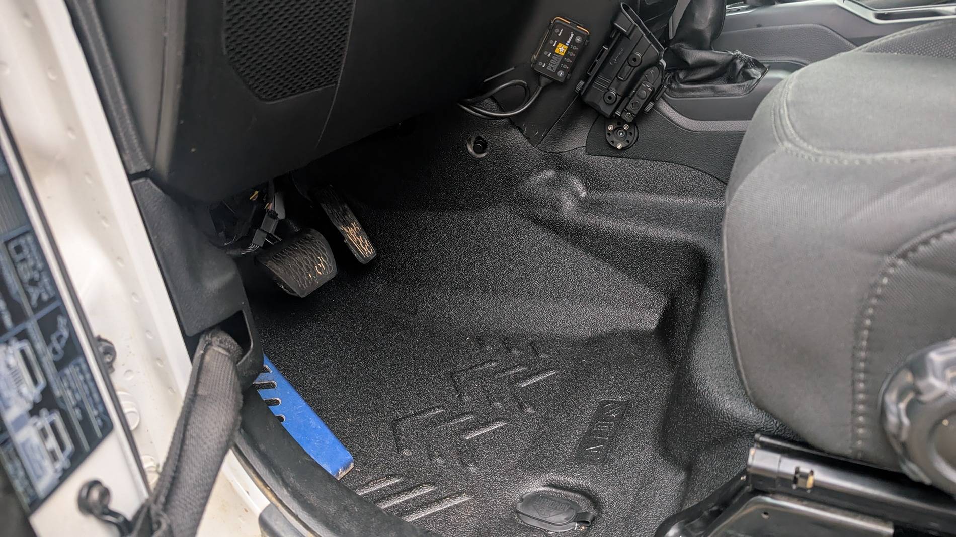

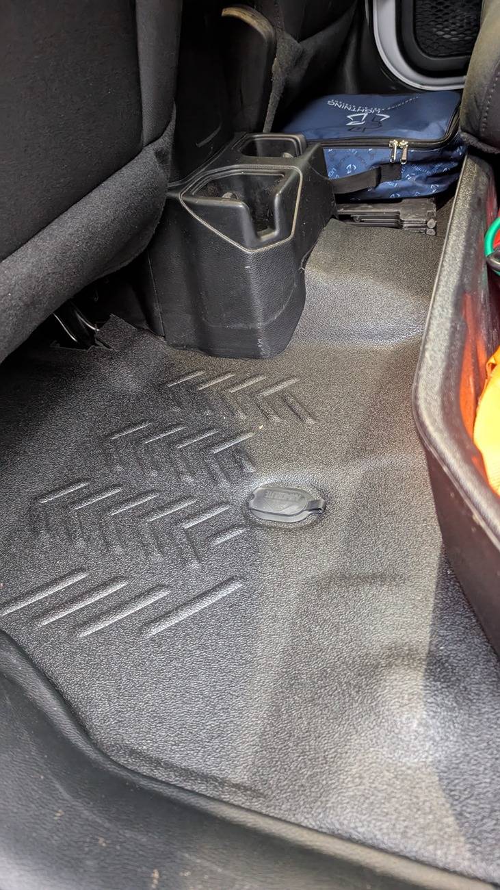

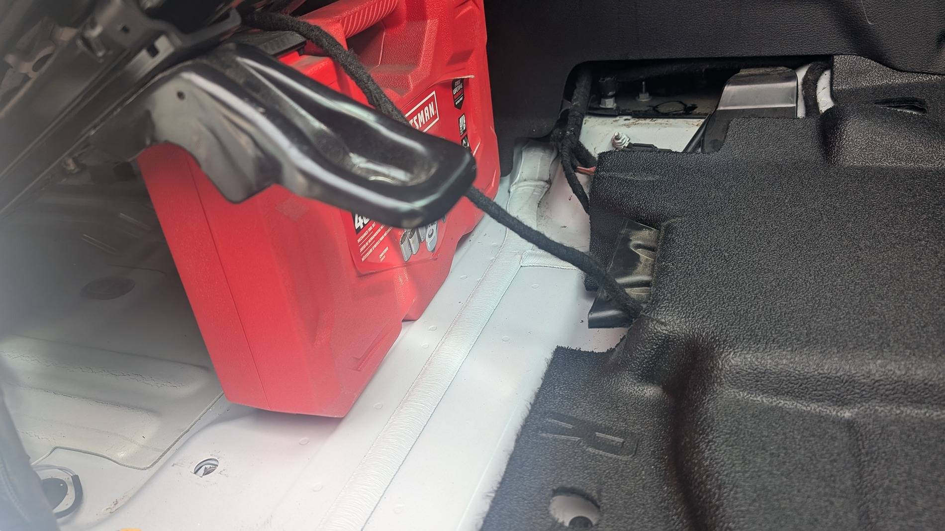

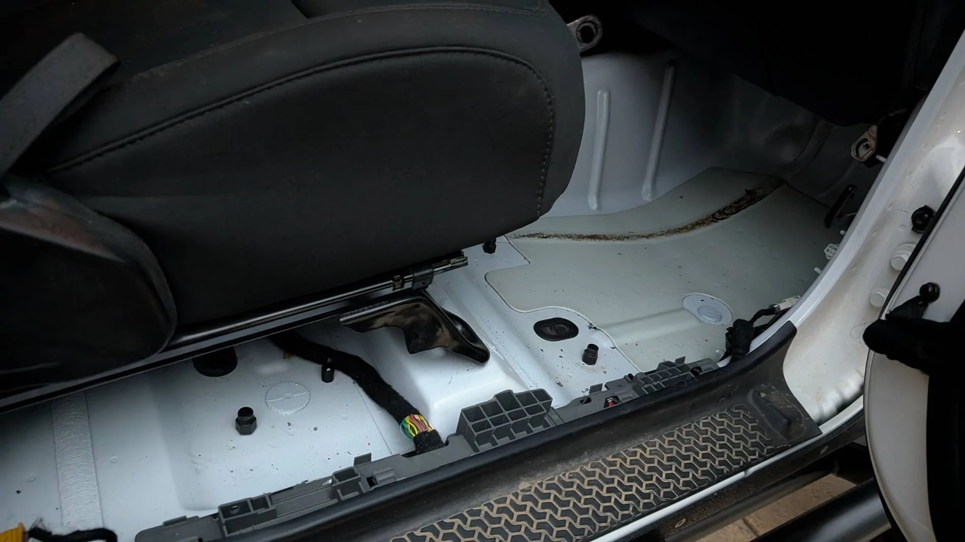

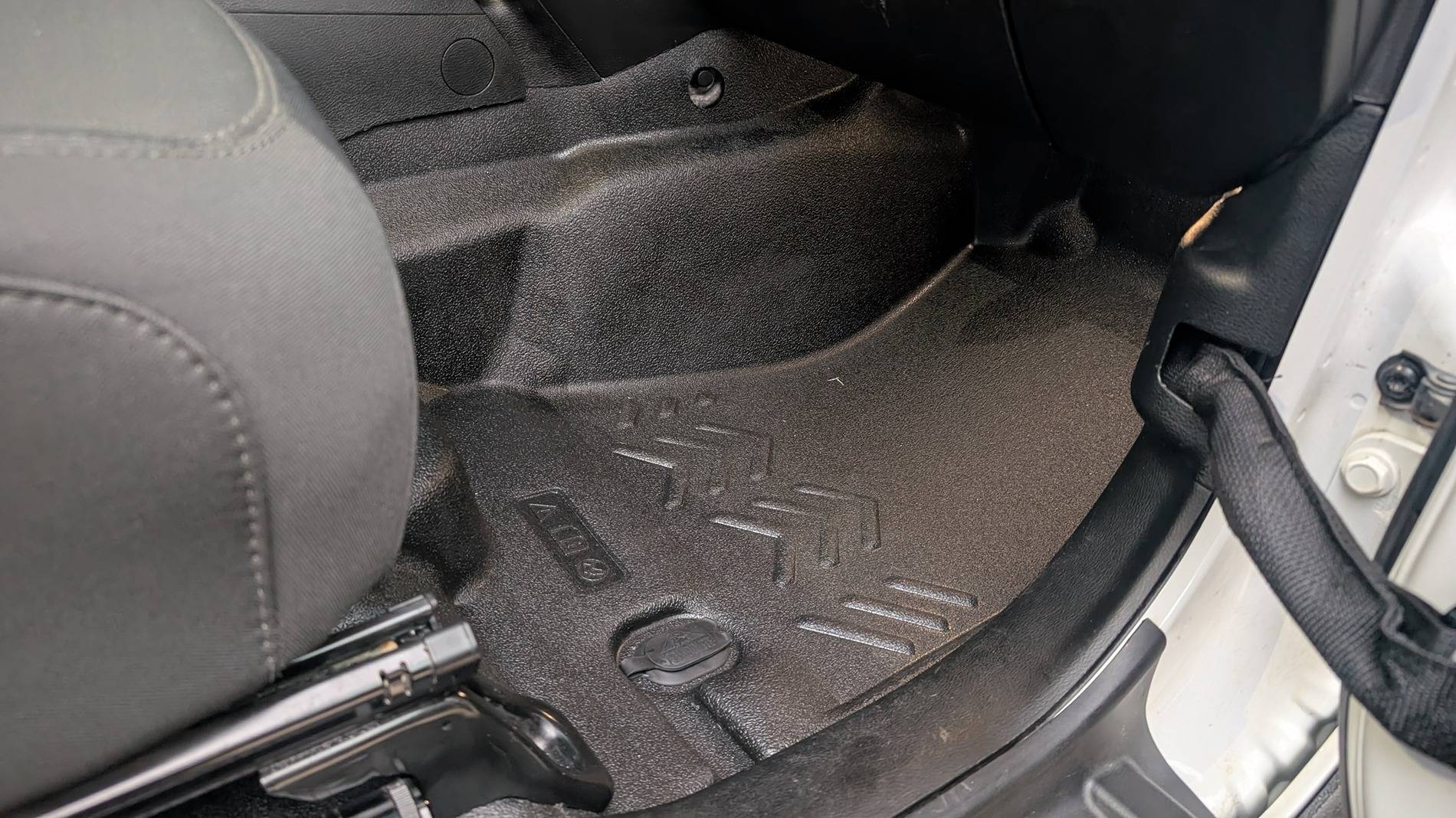

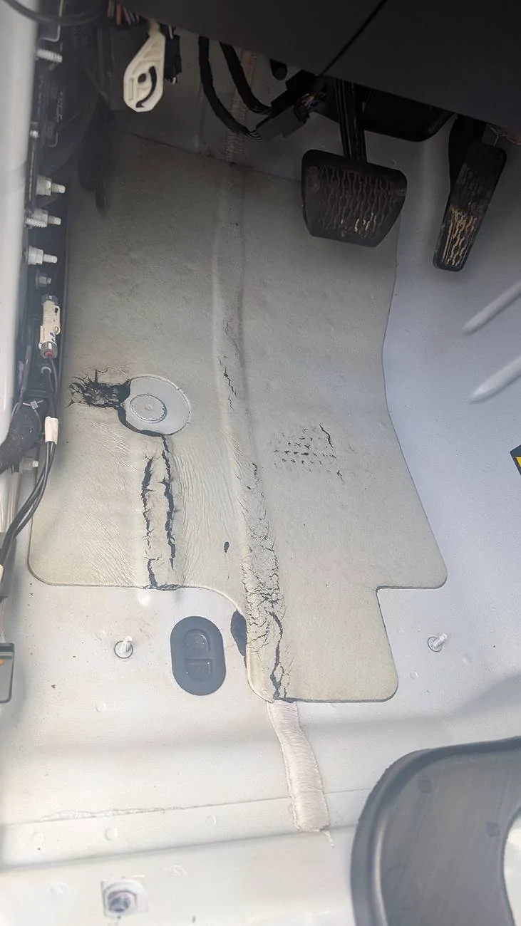

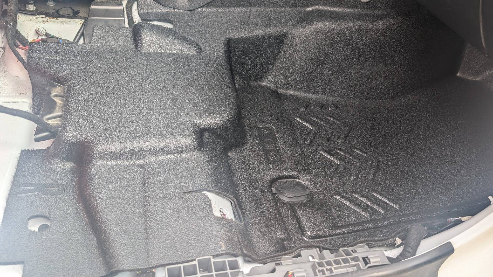

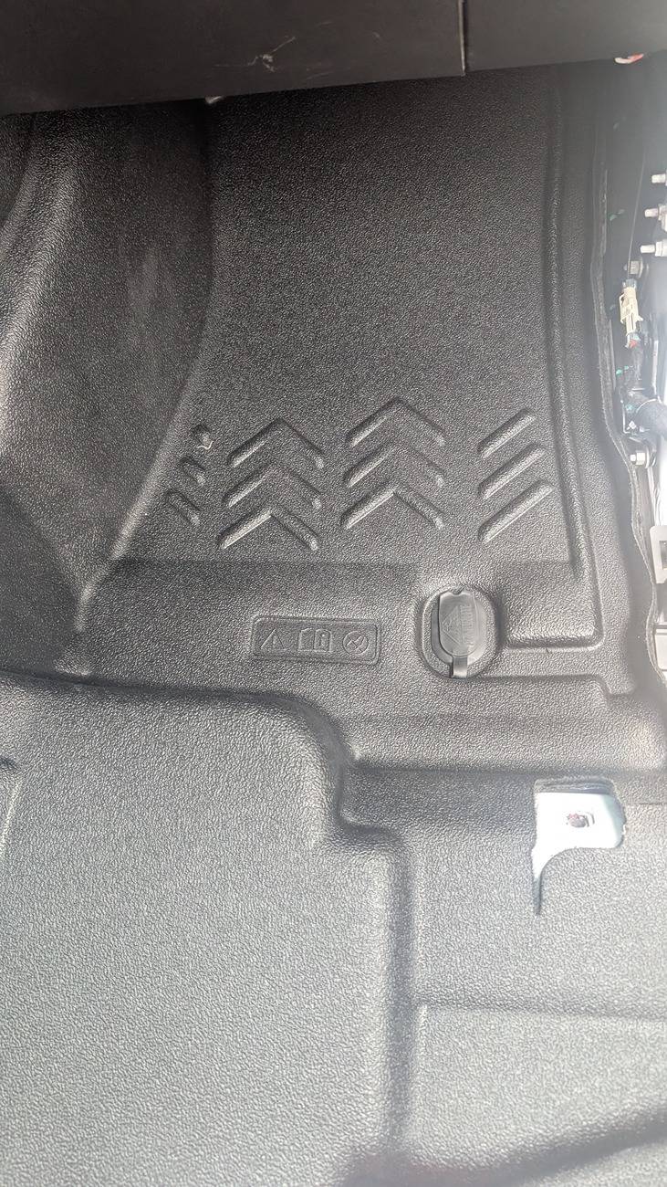

Did the Armorlite install the last two days as I've mentioned in the What did you do to..? thread.
All the pictures and full thoughts -
Taking it apart was easy enough..
I forgot to protect my seat side shields, oh well was extra careful.
It takes some bending and manipulation of the Armorlite to get it tucked under the trim well. Do it well though and it makes reinstall of all the hardware easier.
If I had done it straight through in one day, probably about 5-6 hours...
Seats were easier to reinstall rear bolts first, then front.
Jeep Gladiator W.T.F.D.I.G.M.I - Turning my daily drive into a trail rig. PXL_20241226_225434511
Jeep Gladiator W.T.F.D.I.G.M.I - Turning my daily drive into a trail rig. PXL_20241226_225427638.MP
Jeep Gladiator W.T.F.D.I.G.M.I - Turning my daily drive into a trail rig. PXL_20241227_172826815.MP
Jeep Gladiator W.T.F.D.I.G.M.I - Turning my daily drive into a trail rig. PXL_20241227_172846800.MP
Jeep Gladiator W.T.F.D.I.G.M.I - Turning my daily drive into a trail rig. PXL_20241227_172850691.MP
Used a Socket set box to prop up the seat while I worked... 😂
Jeep Gladiator W.T.F.D.I.G.M.I - Turning my daily drive into a trail rig. PXL_20241227_172855327
Jeep Gladiator W.T.F.D.I.G.M.I - Turning my daily drive into a trail rig. PXL_20241227_222812591.MP
Jeep Gladiator W.T.F.D.I.G.M.I - Turning my daily drive into a trail rig. PXL_20241227_222846467.MP
Jeep Gladiator W.T.F.D.I.G.M.I - Turning my daily drive into a trail rig. PXL_20241227_222822945

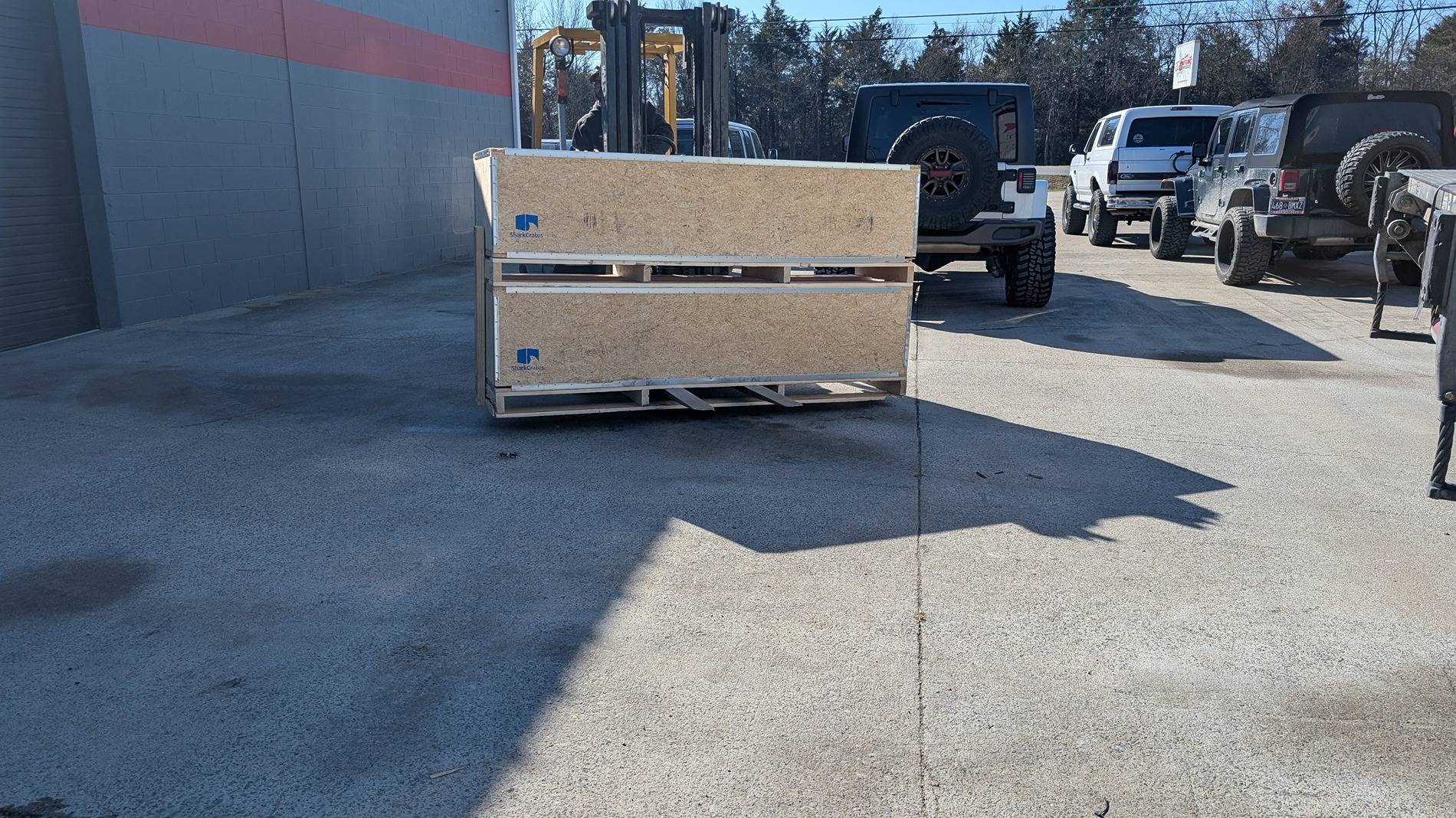

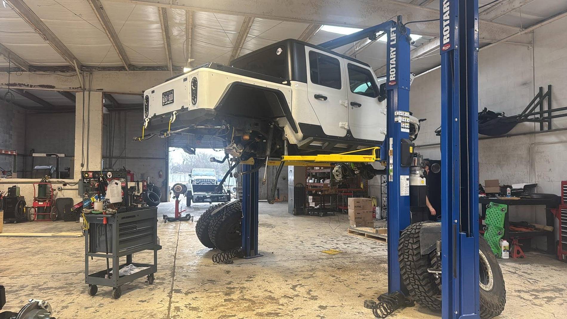

Well so last week I got her naked again -
Jeep Gladiator W.T.F.D.I.G.M.I - Turning my daily drive into a trail rig. PXL_20250128_225338458.MP

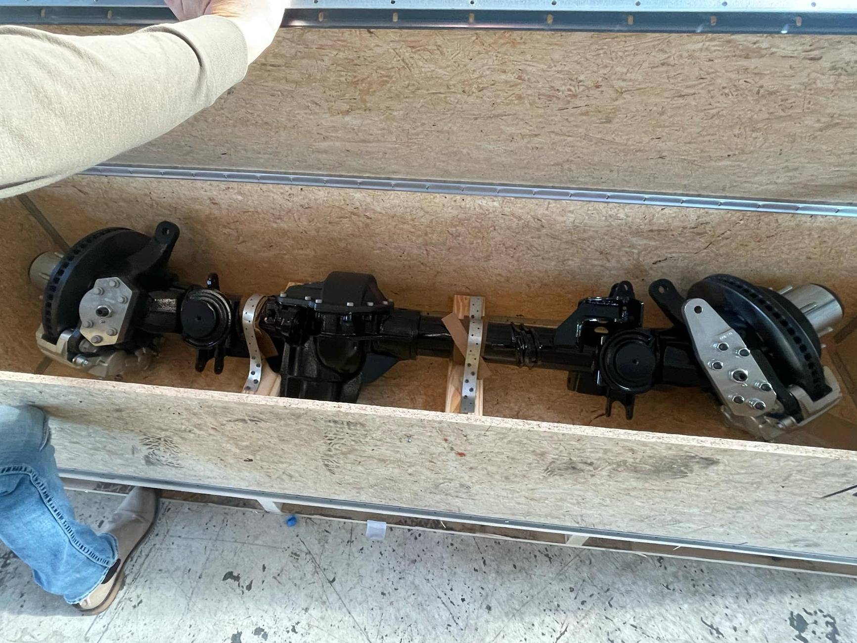

Because some beef showed up at the shop -
Jeep Gladiator W.T.F.D.I.G.M.I - Turning my daily drive into a trail rig. PXL_20250128_182040619.MP
Jeep Gladiator W.T.F.D.I.G.M.I - Turning my daily drive into a trail rig. CrateOpen
Today she went back to the shop and I got this photo a little earlier -
Jeep Gladiator W.T.F.D.I.G.M.I - Turning my daily drive into a trail rig. NoLegs
She's got no legs! Actually I lie, if you zoom in you can see the front is already under her.
So close now, should have her back first of next week.
