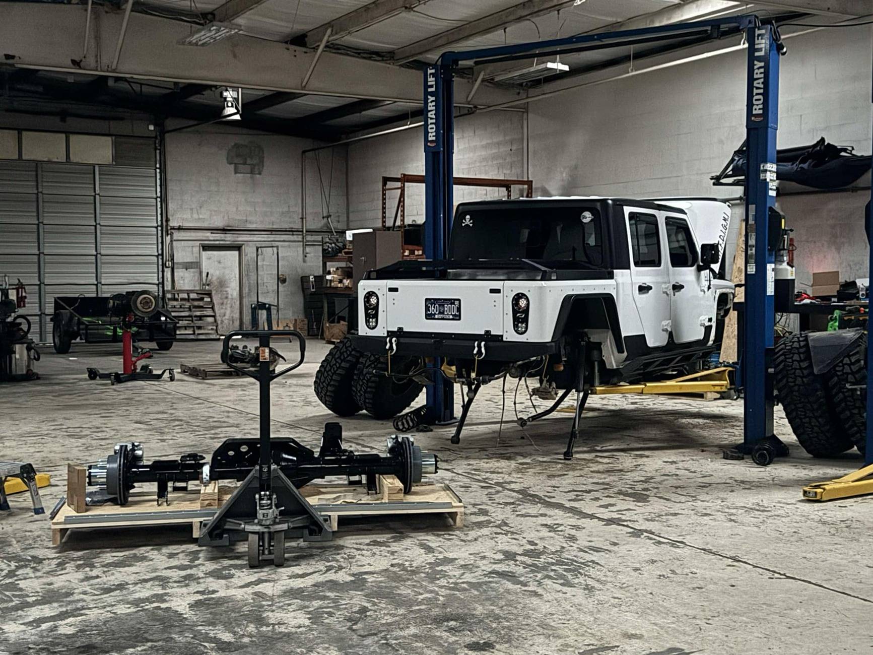

First shot of the rear on the crate. They have to cut off the rear track bar bracket as I have a 4 link and they have to weld the 4 link mounts to the top of the truss.

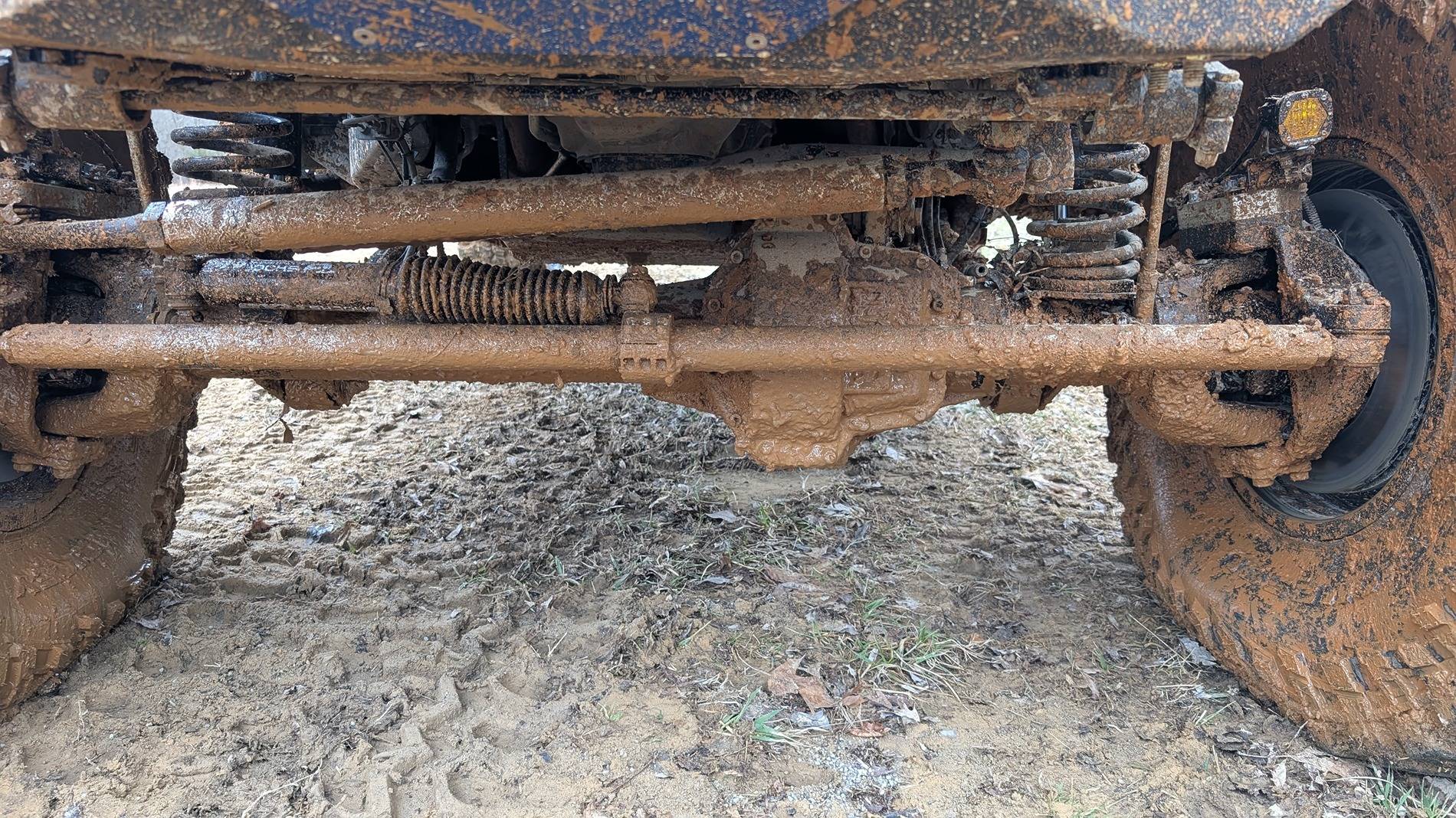

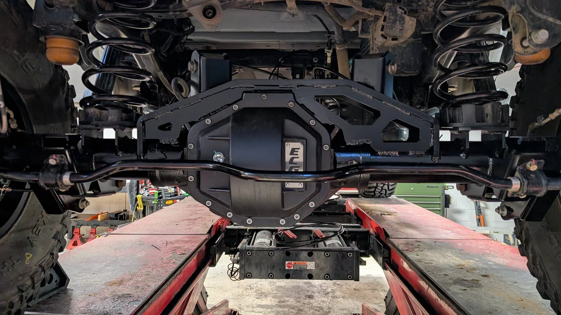

Notice what's wrong in the picture of the rear axle? -
Jeep Gladiator W.T.F.D.I.G.M.I - Turning my daily drive into a trail rig. RearOnCrate
You'd be correct if you said the truss is wrong and there's no need for the rear track bar bracket since I'm 4 linked...
So the guys had to cut the truss and track bar mount off the axle, weld the correct truss in place and do some touch up repainting. East Coast Gear did overnight the correct truss for free, but -1 point for not following directions that were in the email and causing more labor on the shops side.
Rear Axle after the rework -

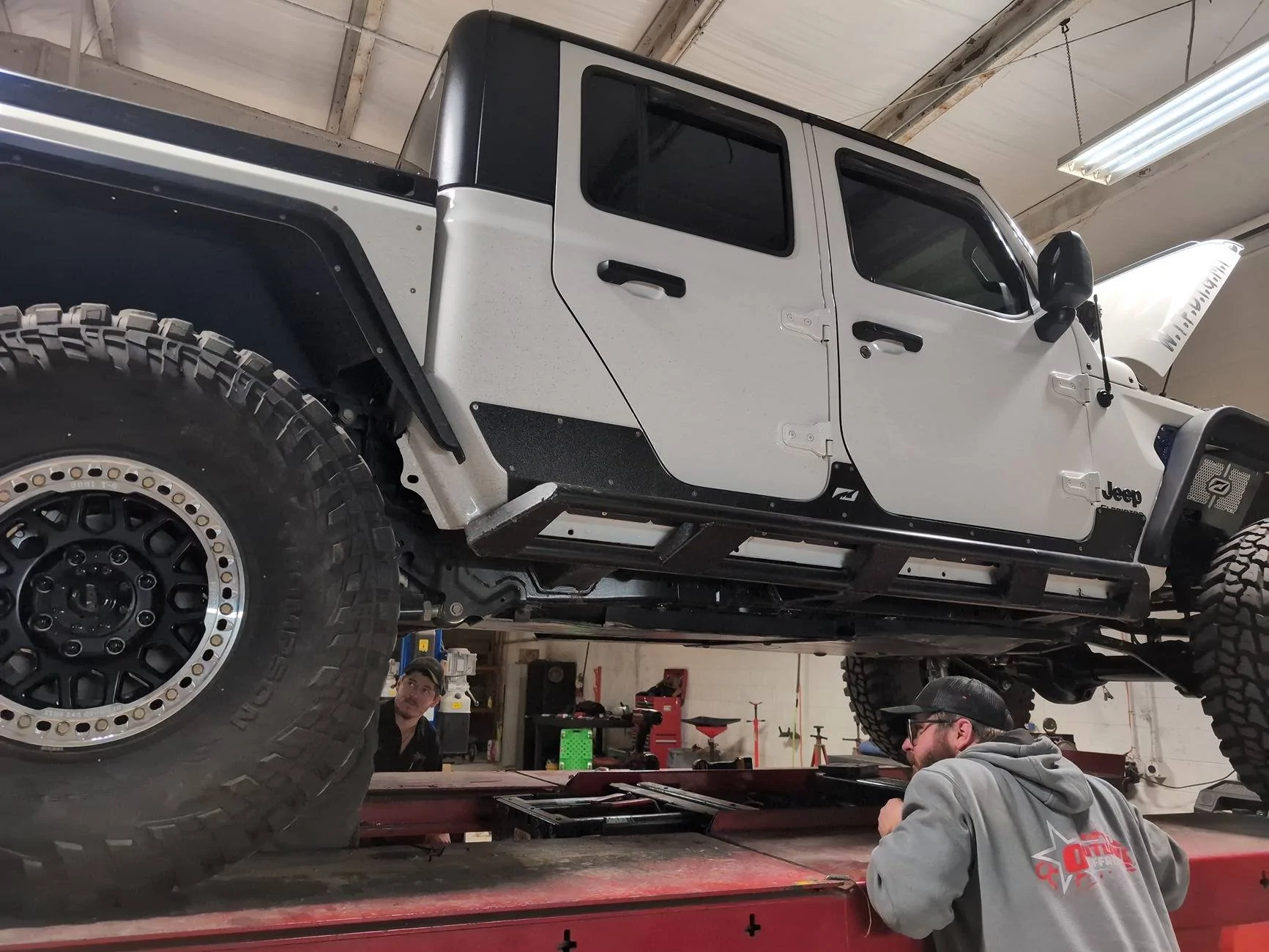

So fast forward to the 21st and I spent the last 3 hours with the owner's husband and two of the shops mechanics buttoning it up and test driving it.
Jeep Gladiator W.T.F.D.I.G.M.I - Turning my daily drive into a trail rig. PXL_20250221_233503655

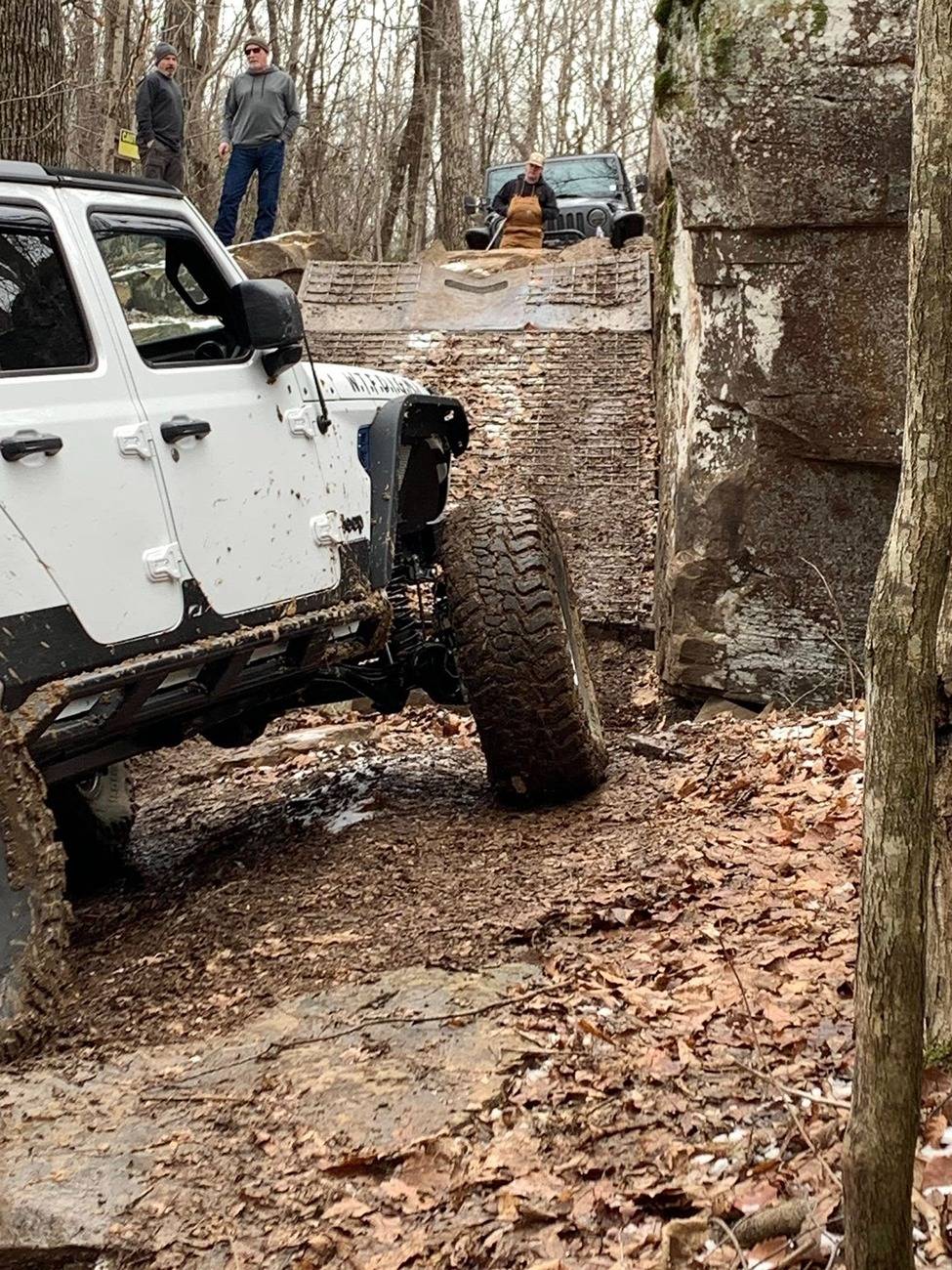

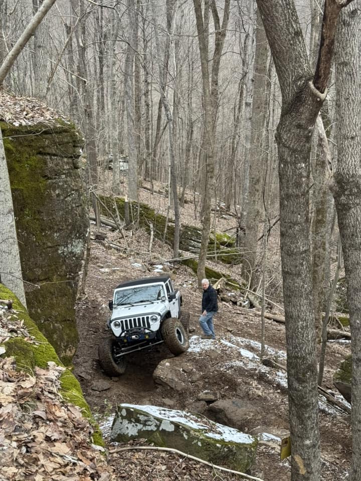

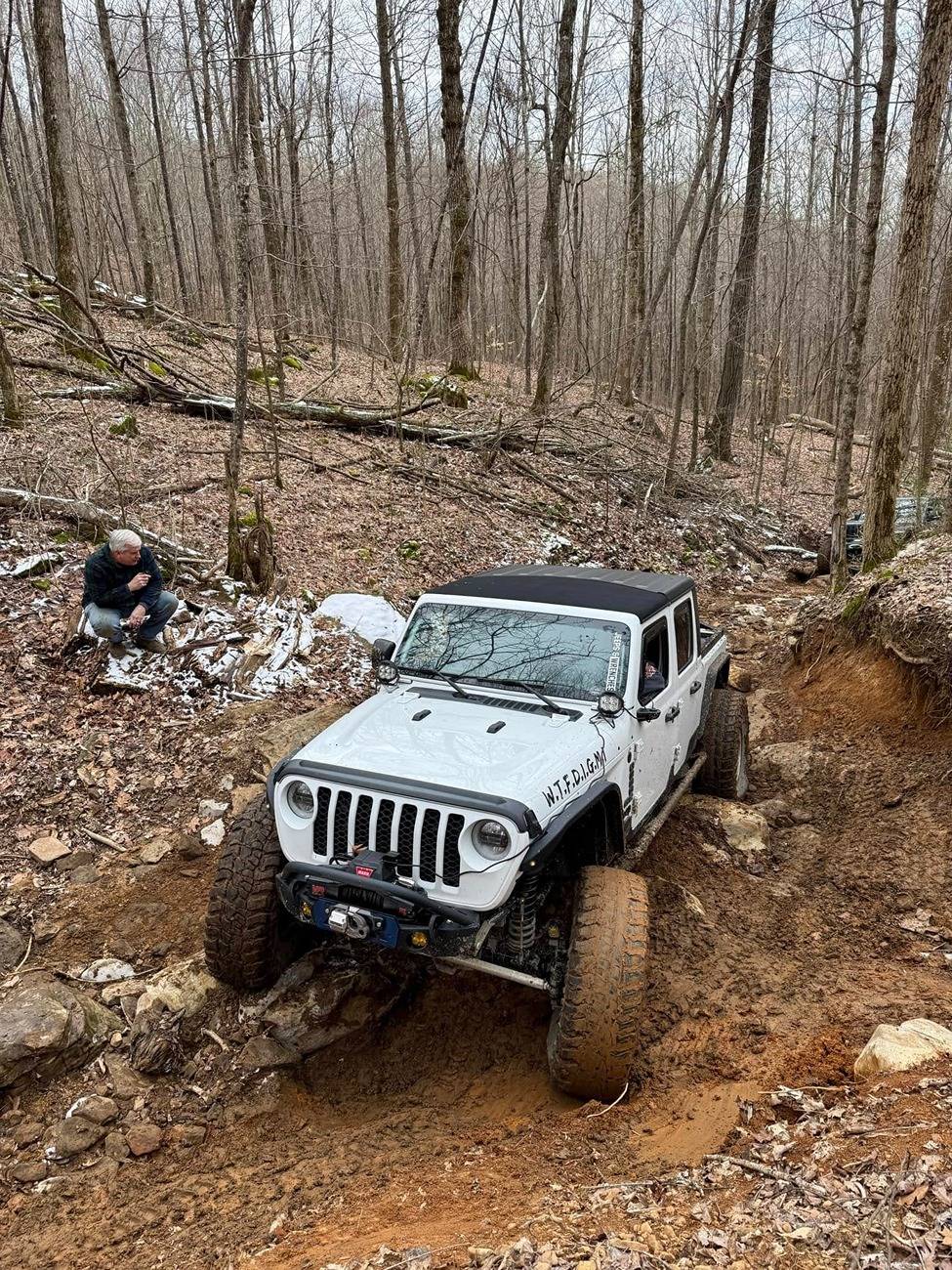

Overall the process of going to tons was stressful, had some bumps in the road, expensive, but altogether worth it.
I got rowdy on Saturday at Golden Mountain Off Road Park in Sparta, TN with the Jeep club -

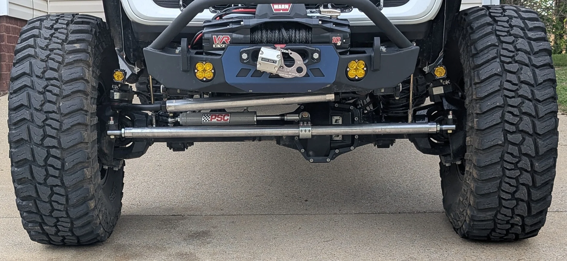

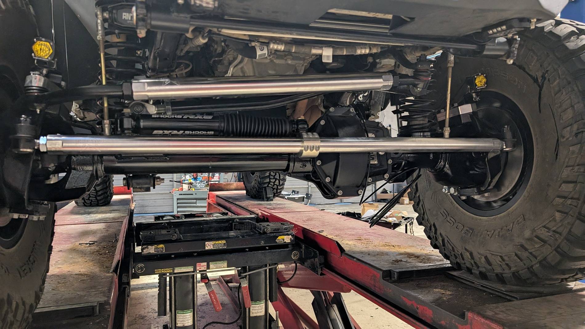

PSC Hydro Assist, felt needed after swapping to tons and 40s -
Jeep Gladiator W.T.F.D.I.G.M.I - Turning my daily drive into a trail rig. SteeringFront

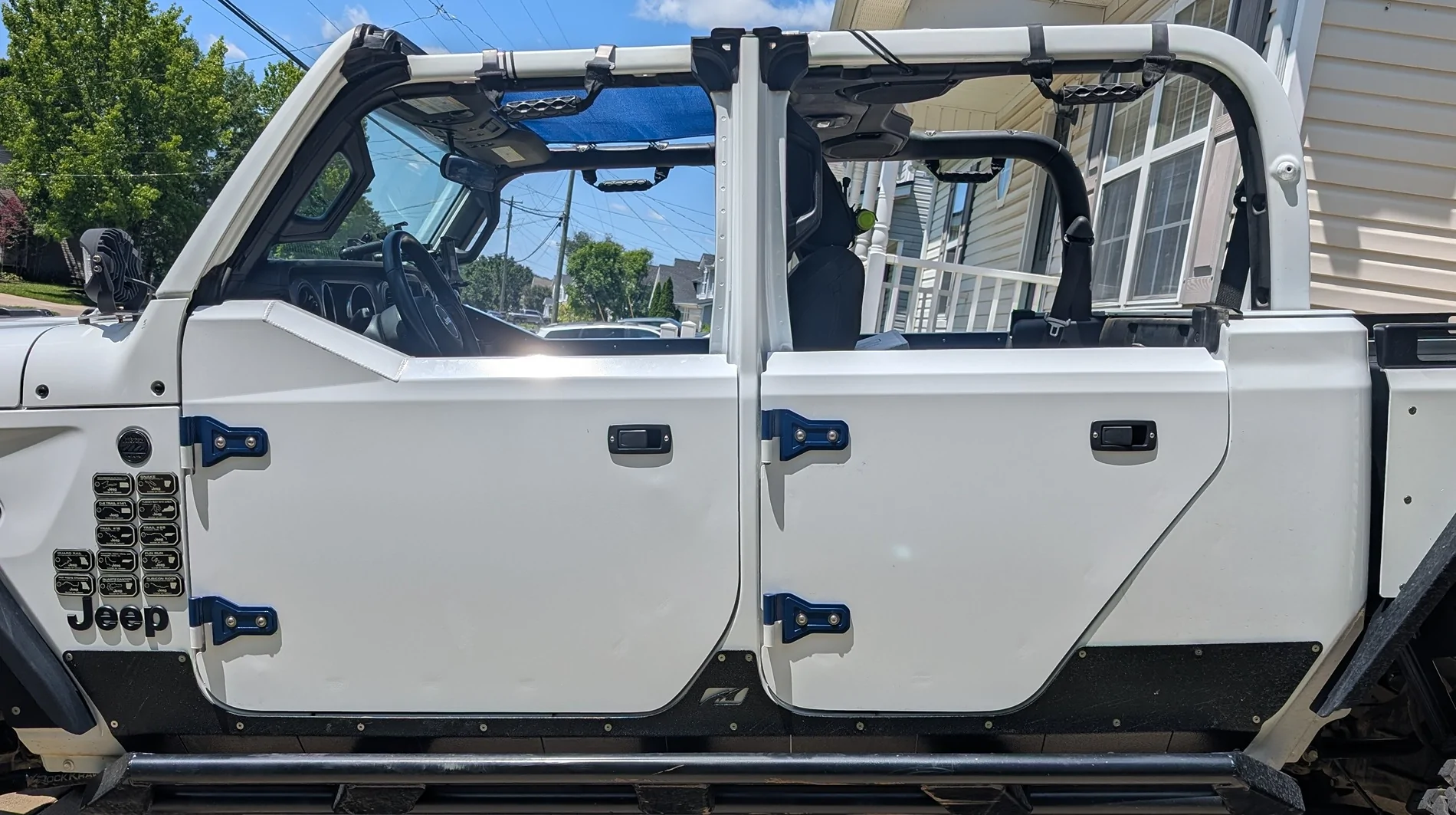

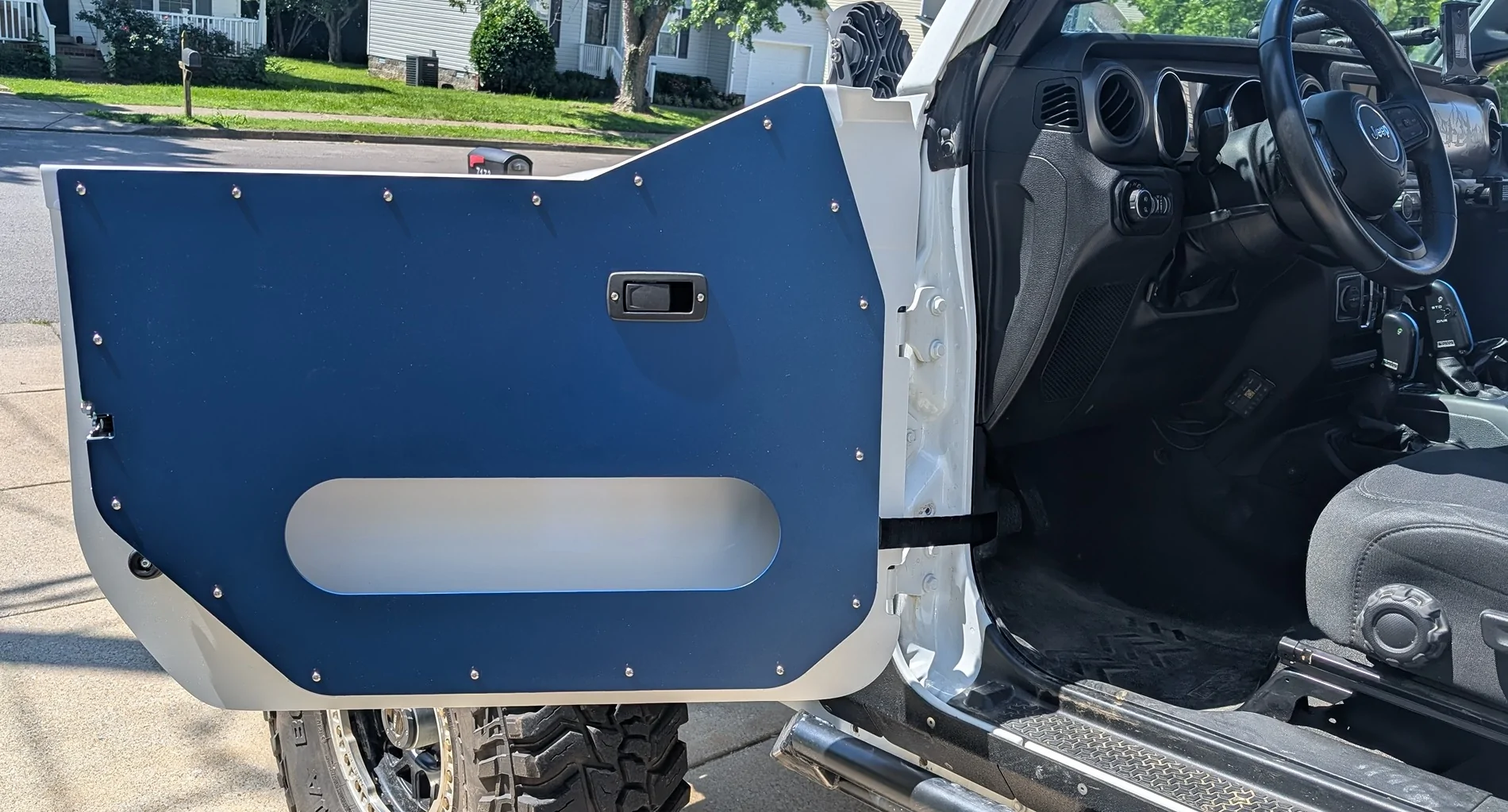

Added the Motobilt Half Doors for some summer fun -
Jeep Gladiator W.T.F.D.I.G.M.I - Turning my daily drive into a trail rig. DriverSid
Jeep Gladiator W.T.F.D.I.G.M.I - Turning my daily drive into a trail rig. InnerFront

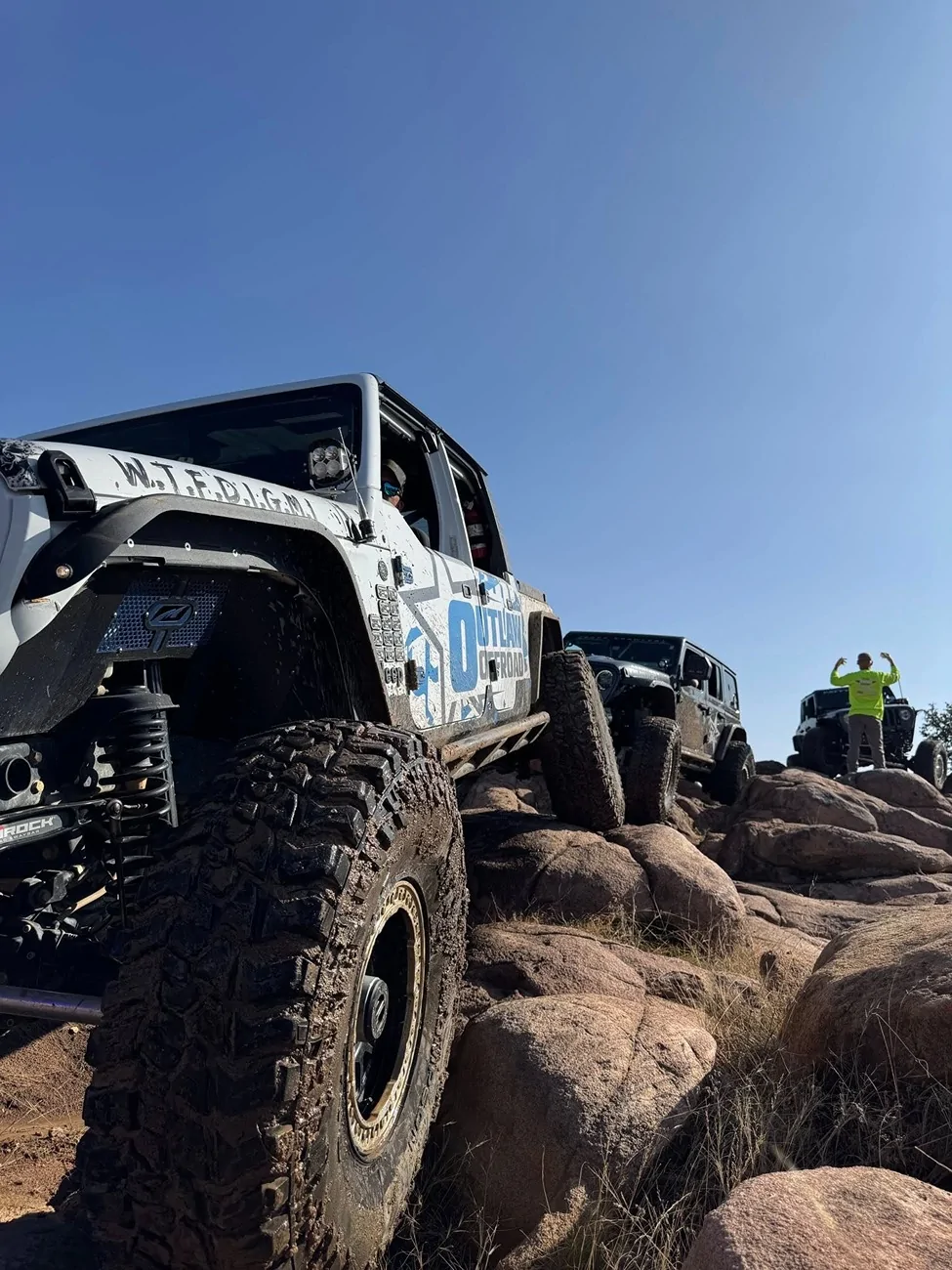

Texas -
Jeep Gladiator W.T.F.D.I.G.M.I - Turning my daily drive into a trail rig. 589135441_1563174185033815_7199607263886087094_n
