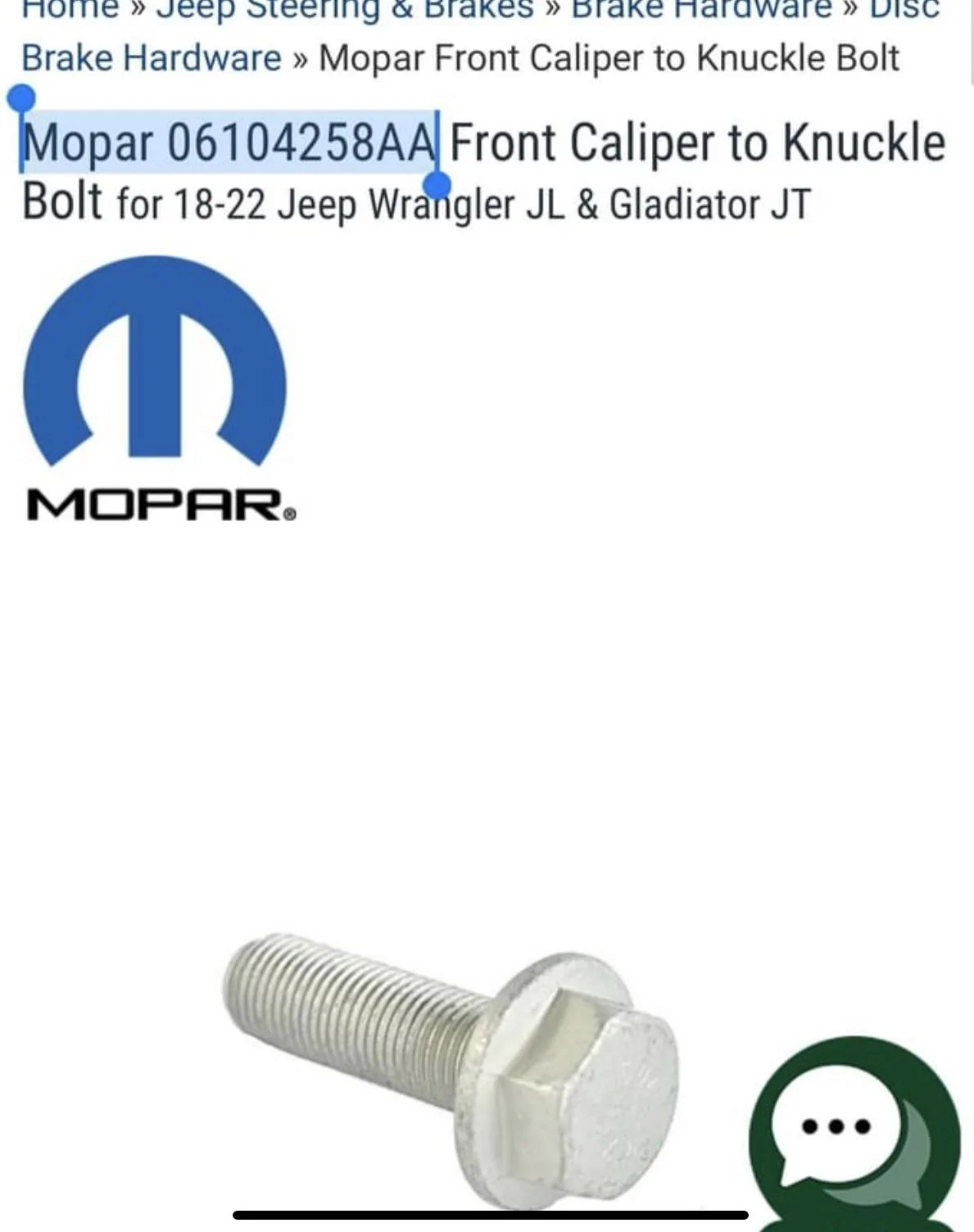

What's the part number?

This is the culprit right here.. Upper bolt Somehow backed itself out after 1.5 years of ownership. Many off road and rock crawling road trips with no issues or any indication that bolt was finding its way out.
Upon inspection at the same time, lower bolt was on its way out as well. If that one would have let loose, then it could have been bad.
Anyone know off the top what the correct torque is on these bolts?
