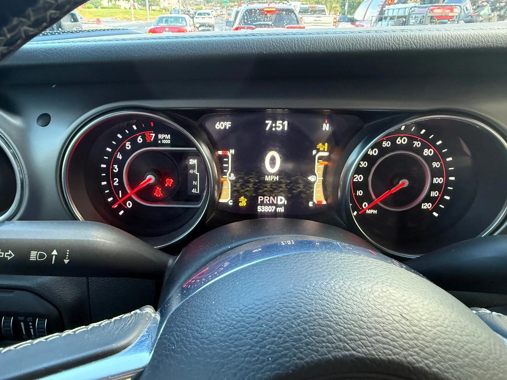

So I just had a local shop install Katzkin covers on my front seats and now I have four warning lights on. The lights are drivers seatbelt, airbag, collision light and cruise control light. The shop said this was known to happen on newer vehicles and he was not able to clear it on his scanner. The Jeep dealership said it may take three to five days for the scan. Does this sound right? Has anyone else had this issue after seats have been removed? I took my seats out when I bought the truck to spray line the floors and had no issue when they were reinstalled. Any insight would be greatly appreciated.

More than likely going to be a bunch of SRS codes stored. Have a scan tool like JScan or similar?
I would look at where the seat connector hookup and check them to see if they bent some pin or not fully seated.

They started it with the seat unhooked. Clear the codes and it should be good.

It’s quite easy to pull on the cables that attach to the underside of the seat when removing the seats. Same thing happened to me, and a wire had pulled slightly out of a harness under the plastic trim where the B-pillar meets the floor.
I happened to be at the dealer for something and mentioned it, and they fixed it as a free service. Seatbelt warranty is lifetime IIUC, so you might also have good luck. My dealer didn’t mention my obvious Armorlite and Seat Jacker mods
