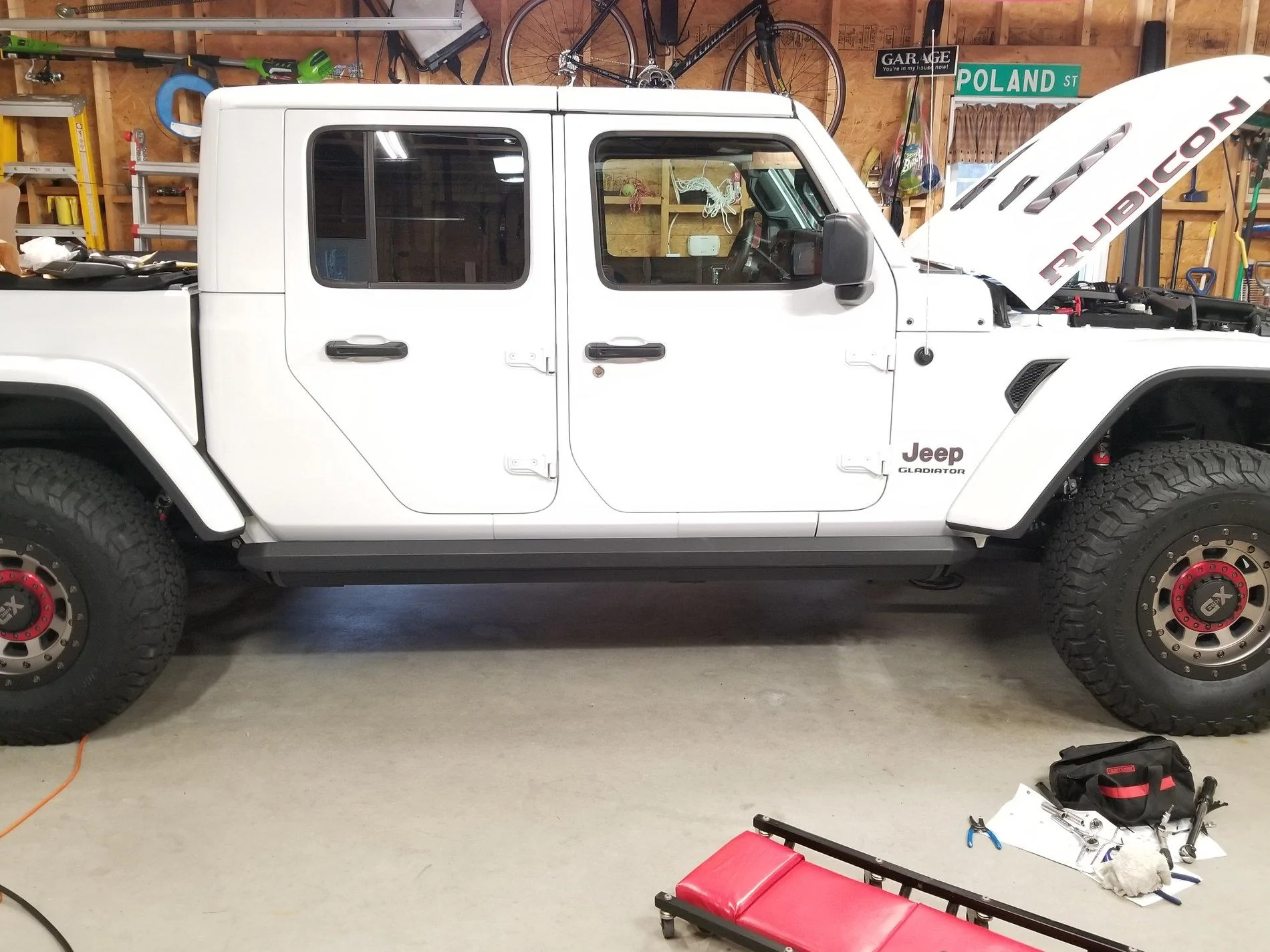

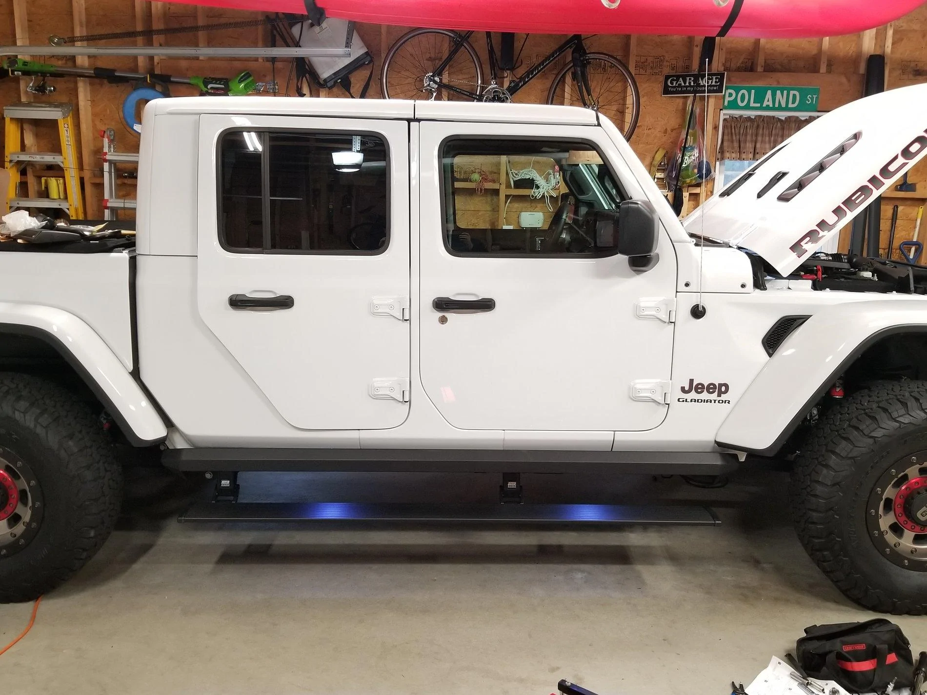

Well this project took way too long - Amp Powersteps
Doolin64
Jan 25, 2019
219
279
Dudley, Ma
2020 Jeep Gladiator, 2018 Audi A4
I thought I'd buzz this project out in a couple of years. I was wrong. First set of steps arrived damaged. So I had to wait for the new set to come in. The instructions were partially out of order. They also left out some details on a few steps, which I found out after a call to them. I also wish they made the driver side harness about foot longer to have a cleaner run in the engine bay. For reference, I installed a set of these on my former F150 with no issues.
In the end, I'm happy with the results, my wife and kids even more so.
