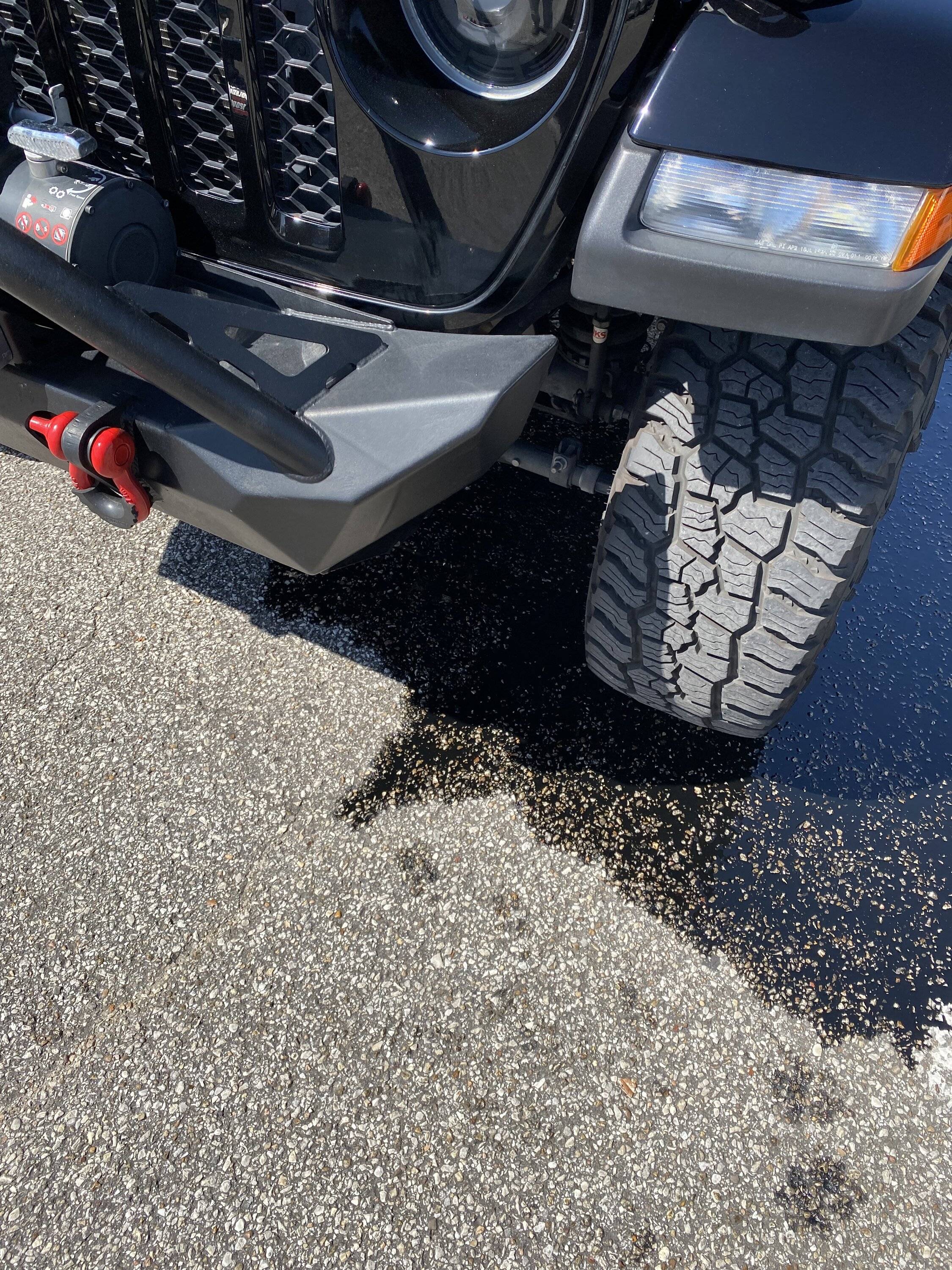

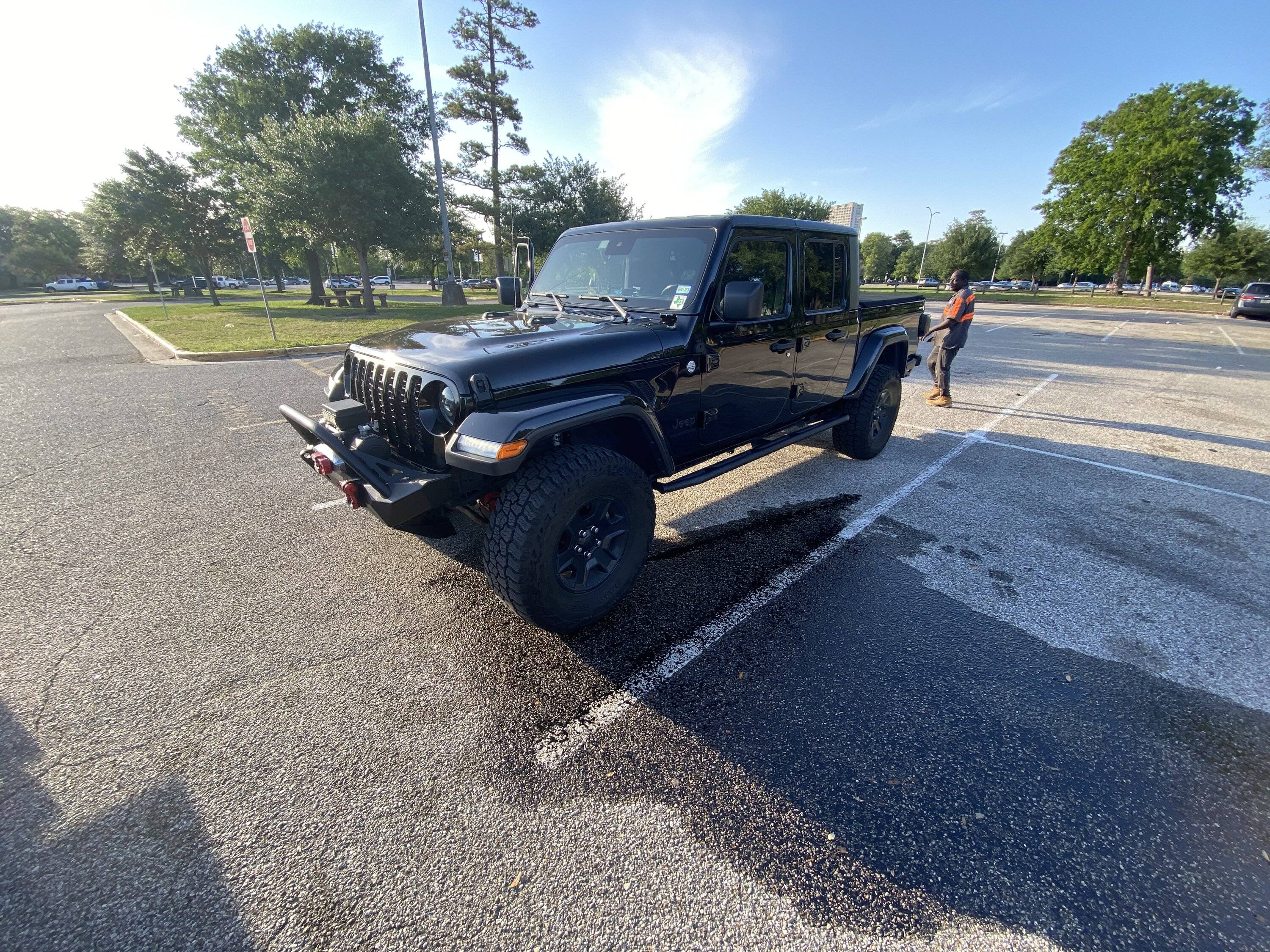

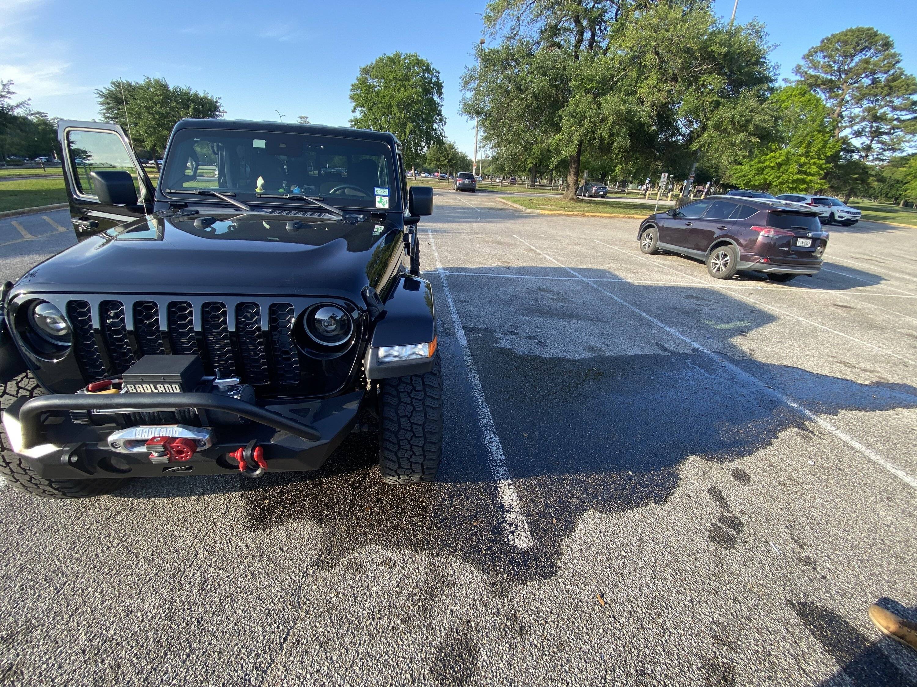

OP OP Ranbo Active Member First Name Randy Joined May 17, 2021 Threads 6 Messages 31 Reaction score 19 Location Houston, TX Vehicle(s) 2021 Gladiator Eco Diesel Occupation Plumber Apr 29, 2023 Thread starter #47 PackMule said: simple Click to expand... I just didn’t like finding out how common oil filter failures are. New fear unlock.

Vtur Well-Known Member First Name Le Joined Mar 6, 2021 Threads 11 Messages 1,933 Reaction score 2,292 Location Norcal Vehicle(s) JTOD Occupation Electrical Foreman Apr 29, 2023 #48 They had probably torque it to 25ft lbs instead of 25Nm and damaged the cap. With any twist on oring install, i usually back it off a little to ensure it's not pinch before tighten it again. Sponsored
