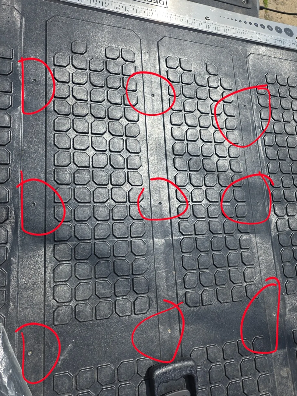

Got the decked system. There are evenly spaced dimples in the top. Are they intended for cargo T-rails? I'd like to use it for that purpose. Anybody know or done it?

Manufacturing from the molding process. Don't overthink it.
Source: I worked in injection molding MANY years ago.
That was my suspicion but hoped it was for a purpose.
They also work as pilot holes if you install the airplane tie down tracks
That is my intention. Please tell me you've done this and it works out nicely!

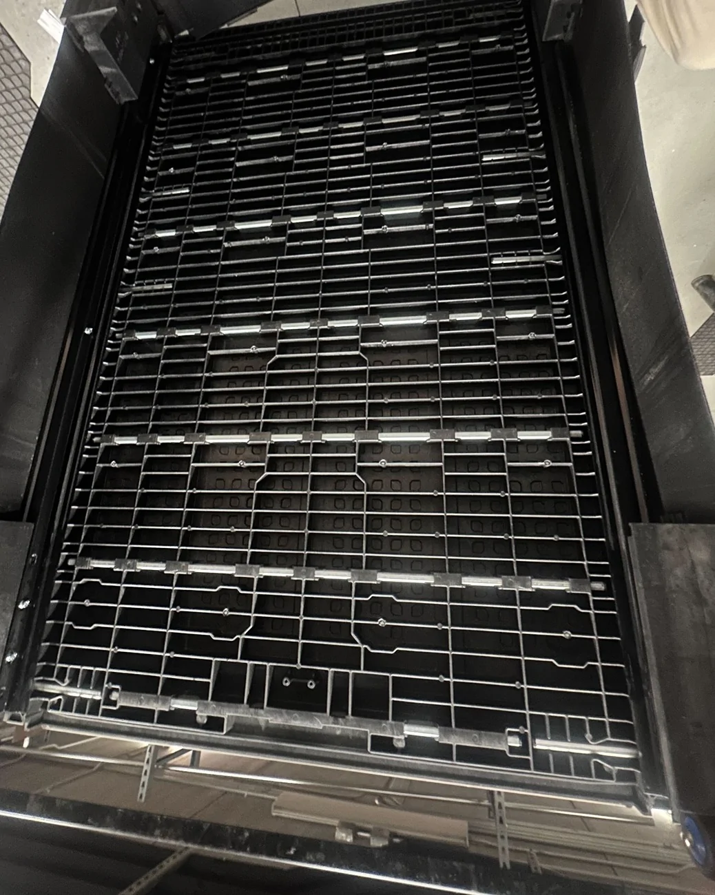

Call out in the user manual. Those mark the frame rail positions. If you need to mount something, drill along the line of dimples.
User manual? What's a user manual? (JK, but the only thing I got was the install instructions and there's no manual on the website)
I also emailed Decked customer service. Here's what they had to say:
ME: " I'm considering doing T-rails cargo rails for the top. I see there are dimples in the smooth-straight spaces that go all the way front to back on these. Are those dimples intended for that?"
Customer Service team: "In short, these dimples are not going to be intended for something like this. However, while not fully intended for this, I believe that these dimples should still line up with the metal supports underneath the panel. We can't recommend doing this since it would require drilling into the system, but unofficially this would likely be your best bet.
That being said, since we don't recommend drilling into the system, I am not fully sure if the dimples still do line up with the supports and I would use caution when doing this."

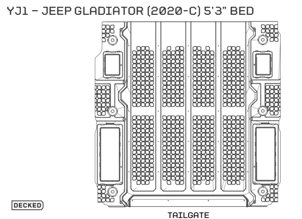

I believe its for the seafoam cover that is optional. I have the Gen1 so a little different than yours.
