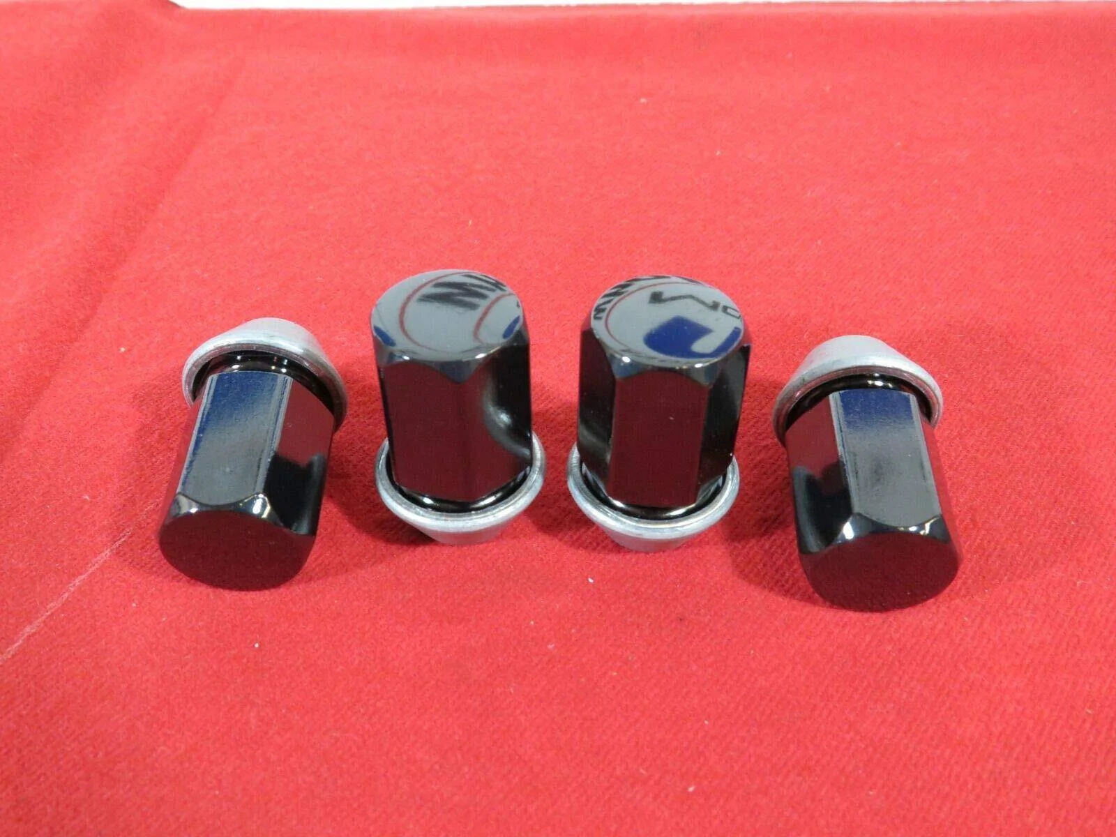

Hello Benny,
Do you carry Black lug nuts that are one piece? I would like to get away from 2 piece silver lug nuts.
TIA
PJJEEPLIFE
PJ
Oct 25, 2024
Michigan
2018 JLUR
Business owner
Yes but you'll also need brackets
68356519AA
68356518AA
And some general hardware.
- Benny
Benny, I am having a tough time finding the correct info on what actual hardware I will need for the brackets. Any help is greatly appreciated!
