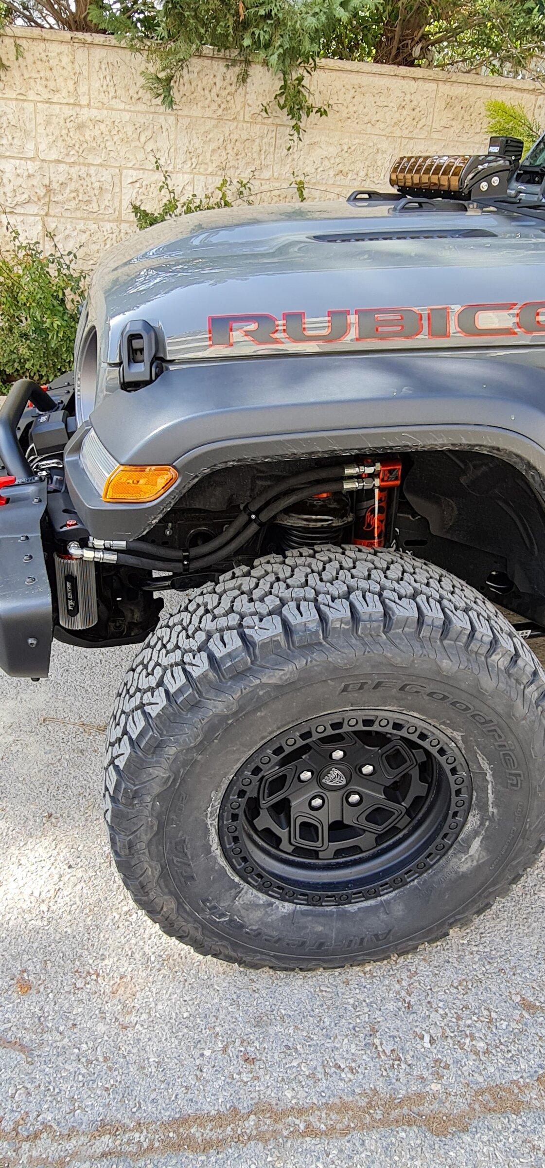

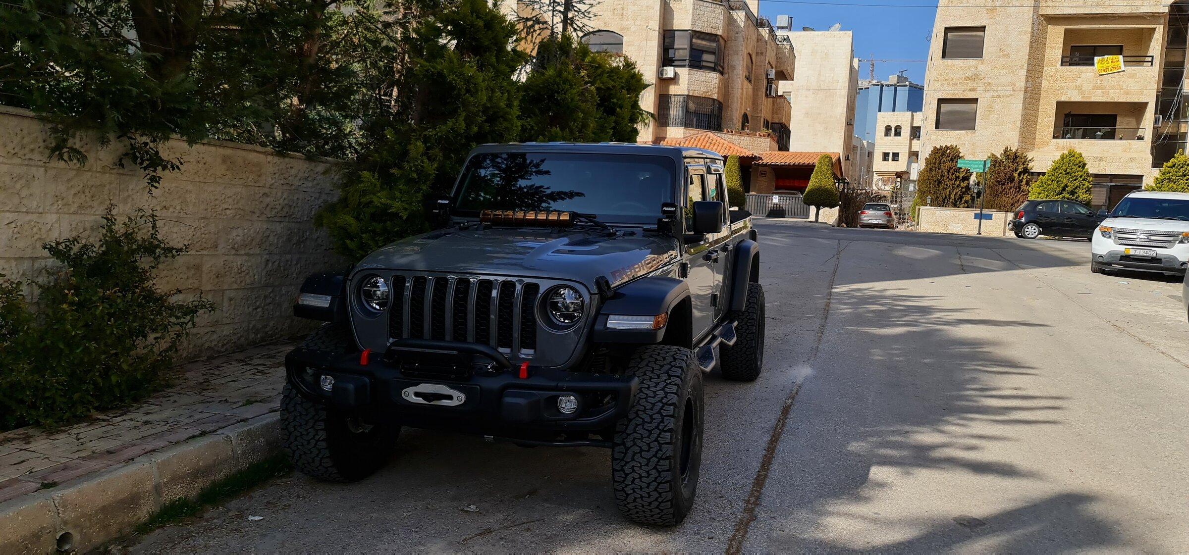

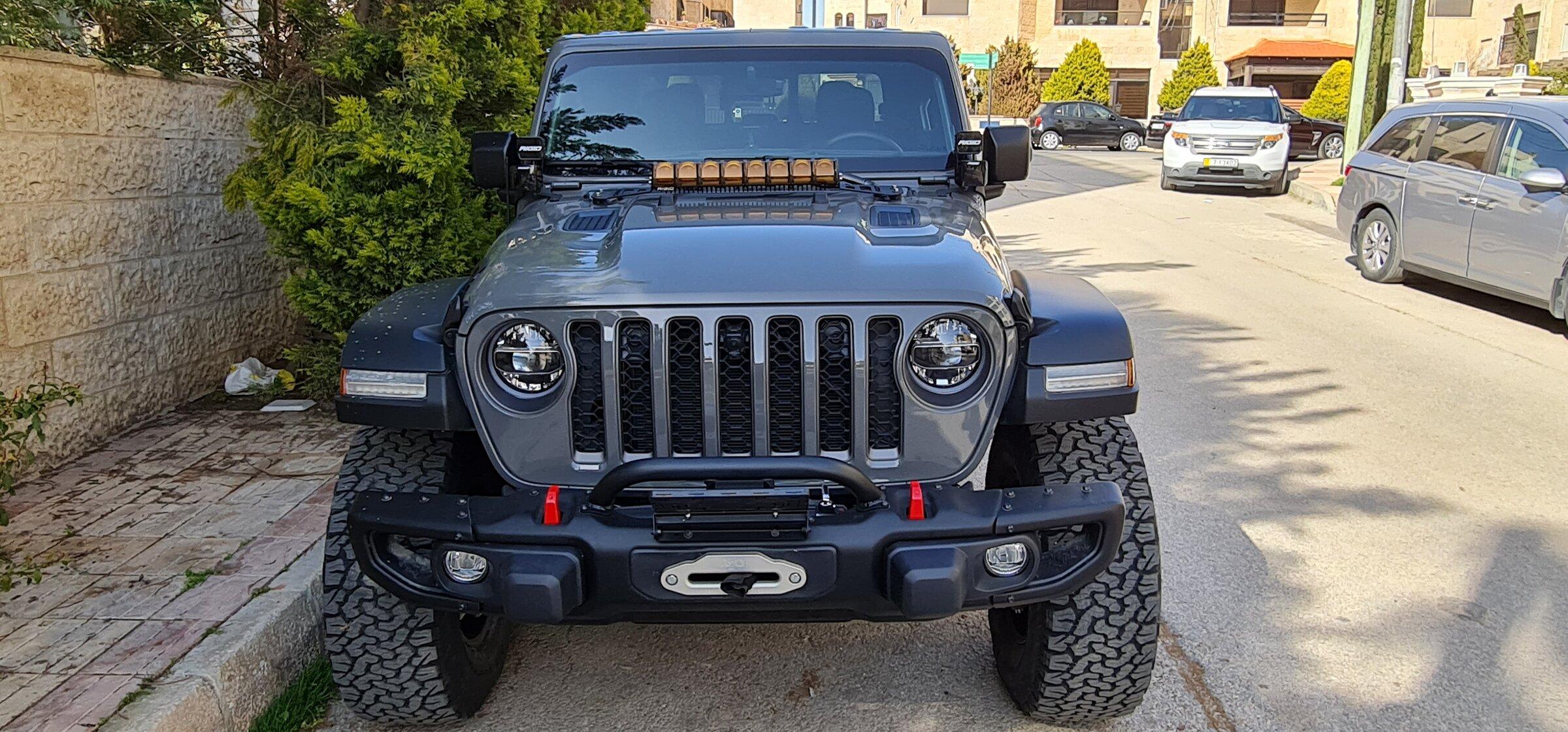

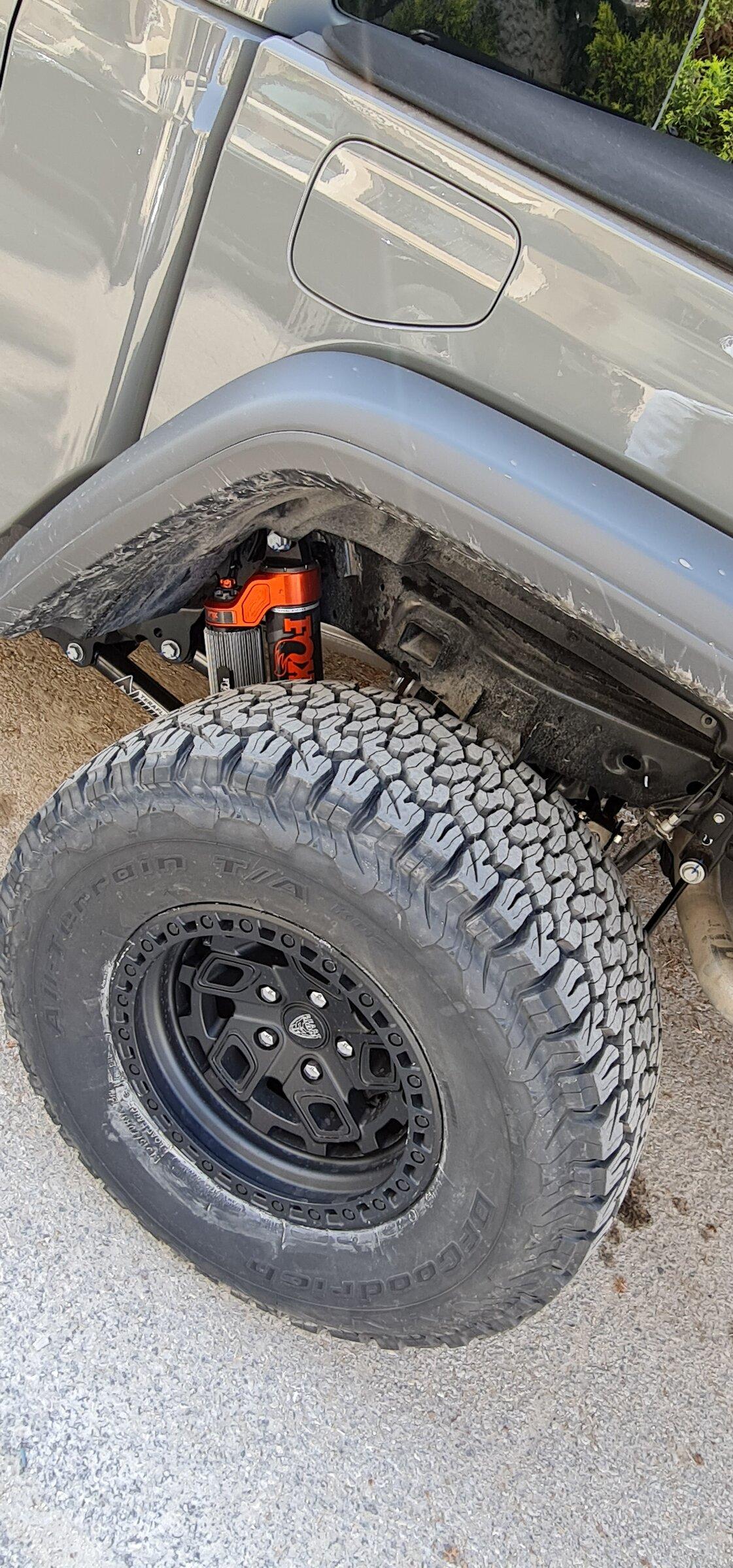

My 2021 gladiator rubicon sting gray with the following mods :
3" rock krawler lift kit
3" fox 3.0 racing series
2.0 fox front bump stop
teraflex adjustable short arm kit
rear teraflex bump stop
Artec industries front truss
A-pillar artec mount for rigid lights with d-ss flood rigid lights and d-pro rigid spot light
Rigid hood mount with rigid adapt 20" light bar
Smittybilt 10,000 winch
315/70/17 bfg A/T with beast wheels
Synergy ball joints

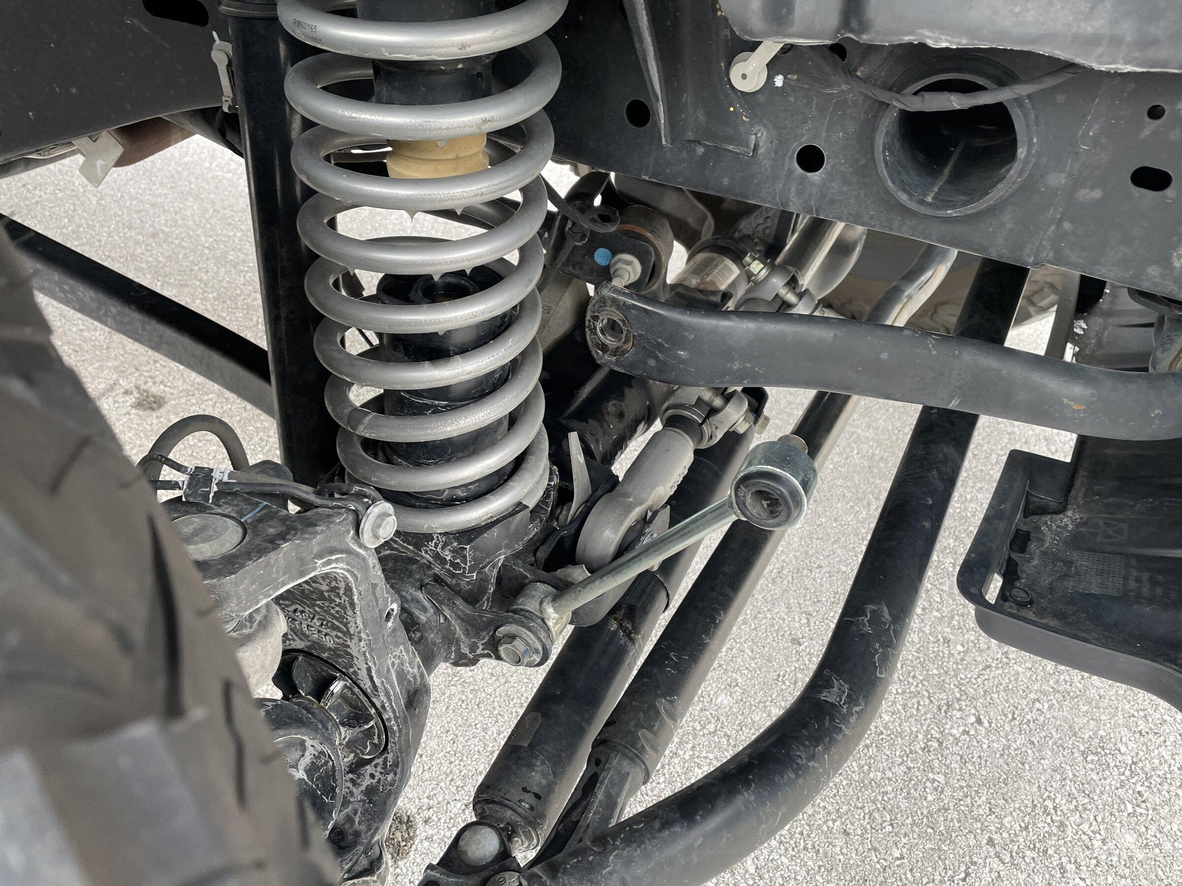

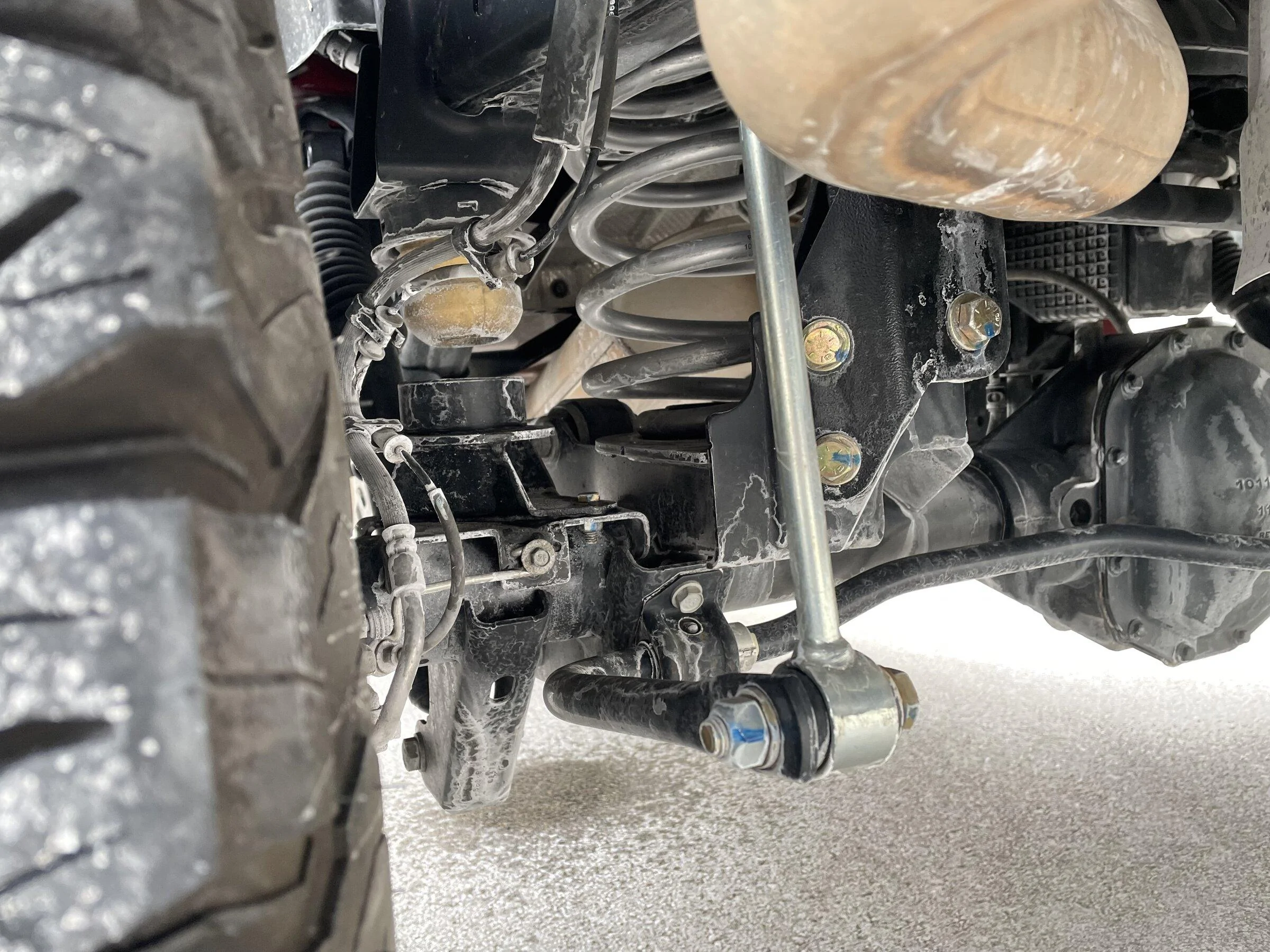

First off o found out why the ride was suddenly so awful (swayed as if front sway bar was disconnected… it was on passenger side. The bolt fell out, see picture. I had the lift put on by reputable shop but i still should have gone back and tightened everything after 500 miles and marked with a pen. Fixed that and ride is great.

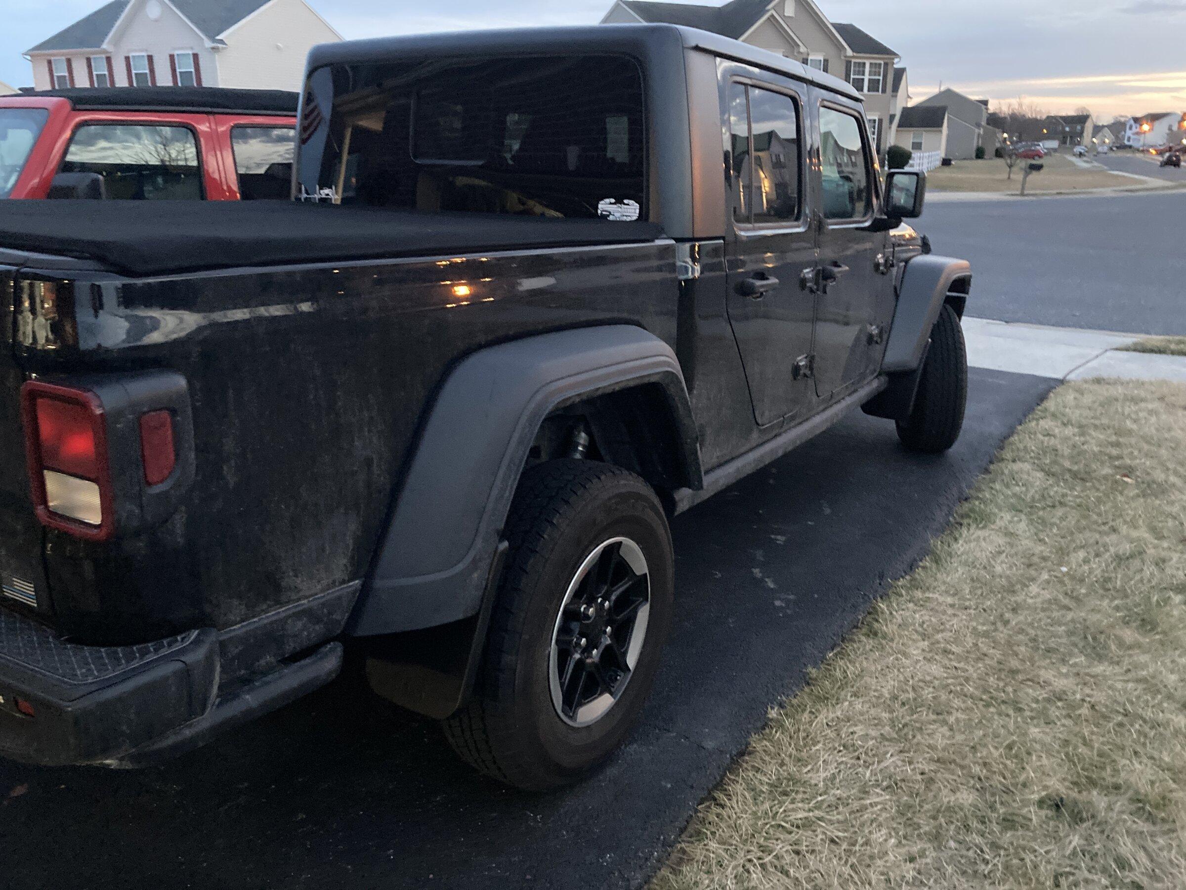

I am replacing the rear springs with something HD for towing and hauling weight, but throwing 2” spacer on this weekend until I figure out springs and shocks to buy. The stock 3.5” Rubicon Express rear springs are way too soft and has me on the bump stops with my roof top tent. The picture below is without the tent, leaves only about 1” to bump stop.

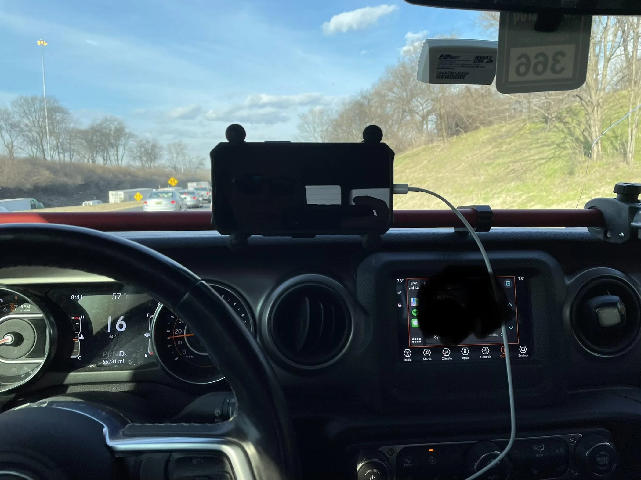

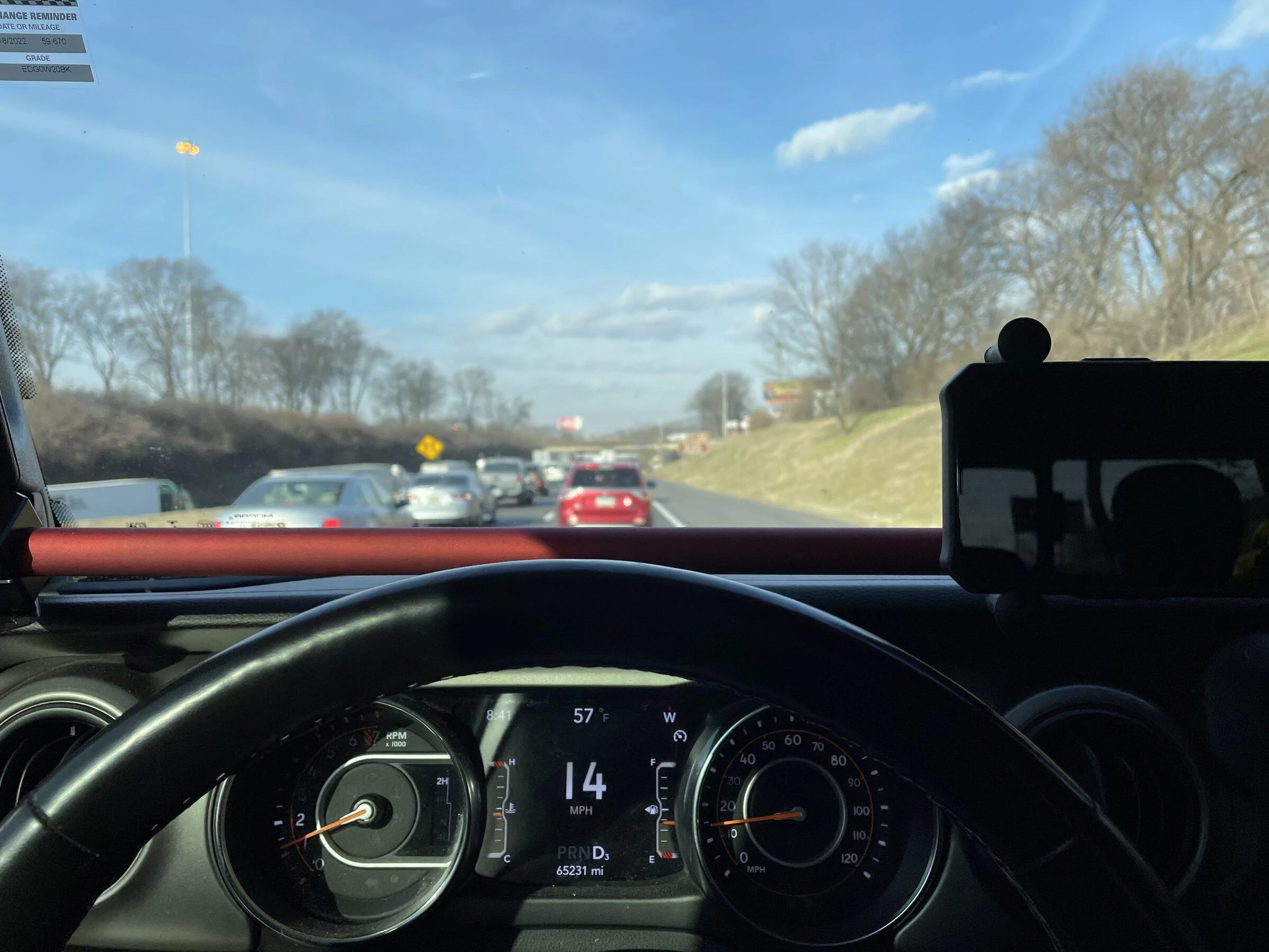

Also added the Anvil Overland dash bar for phone and tablet mounts. Really nice and well designed product! I love it.

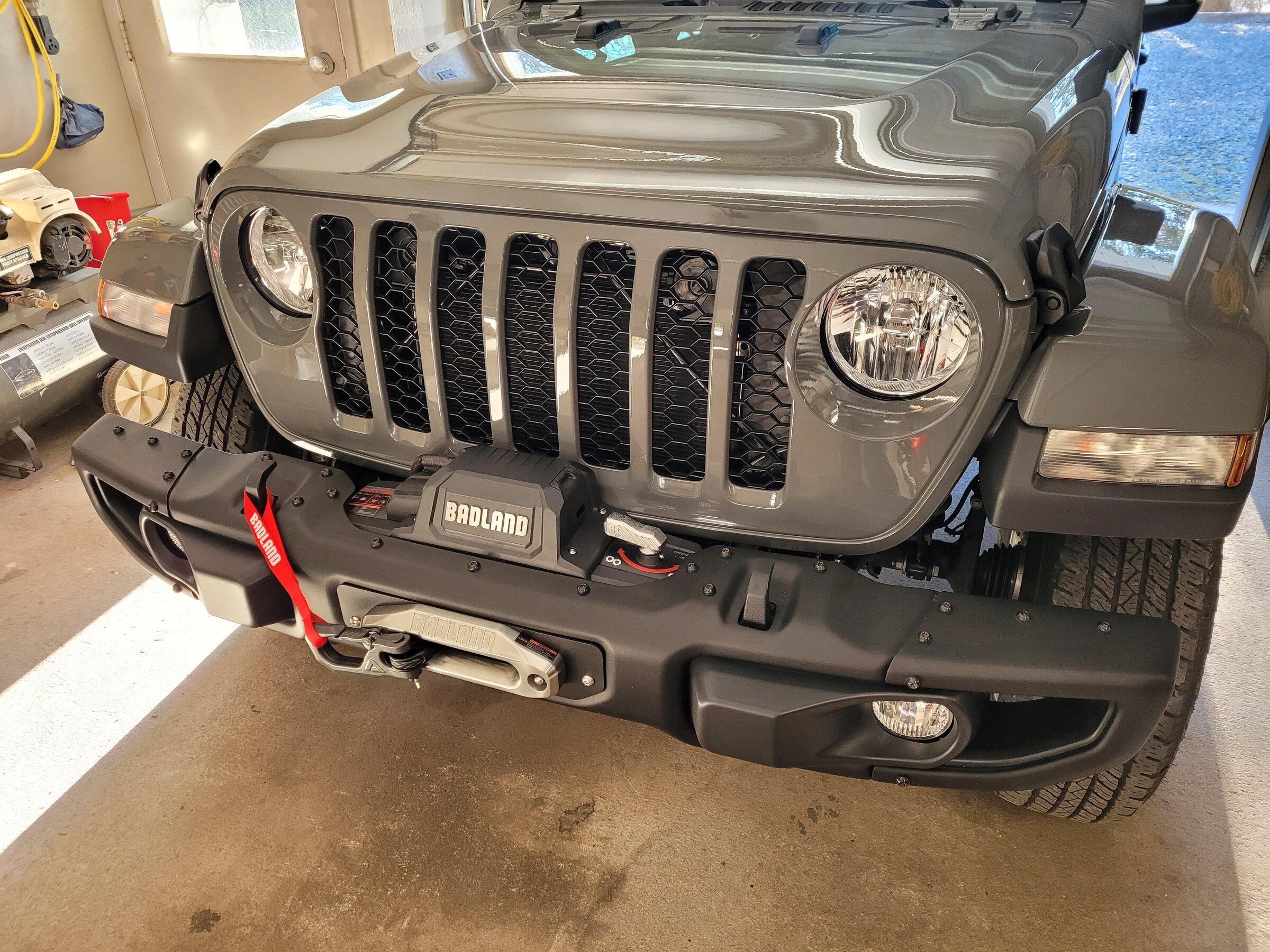

New winch, and got the grill insert in. Can't find my diesel to trim. Guess it's a wally world trip tomorrow.
Where did you pick up the grill insert ?

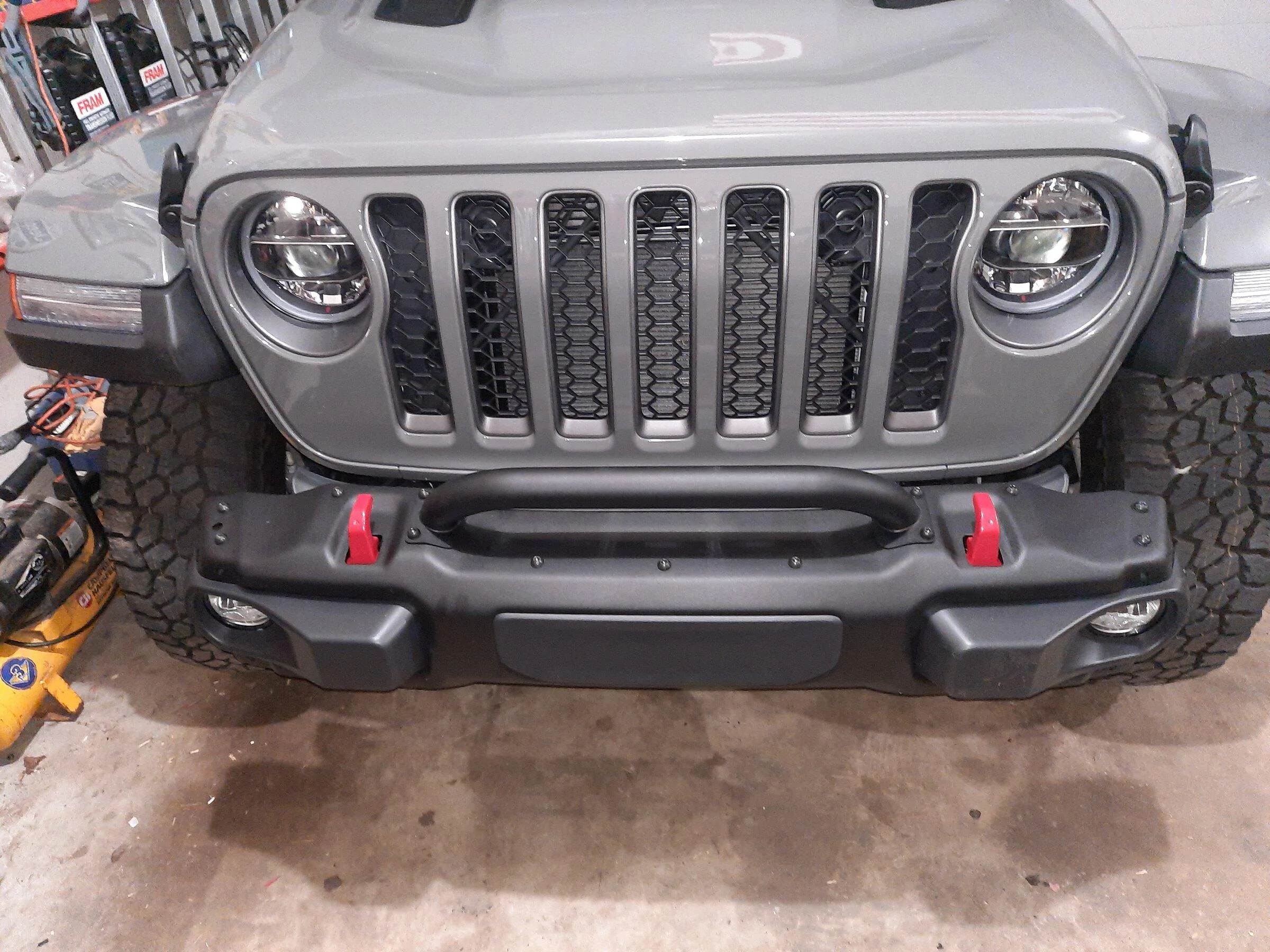

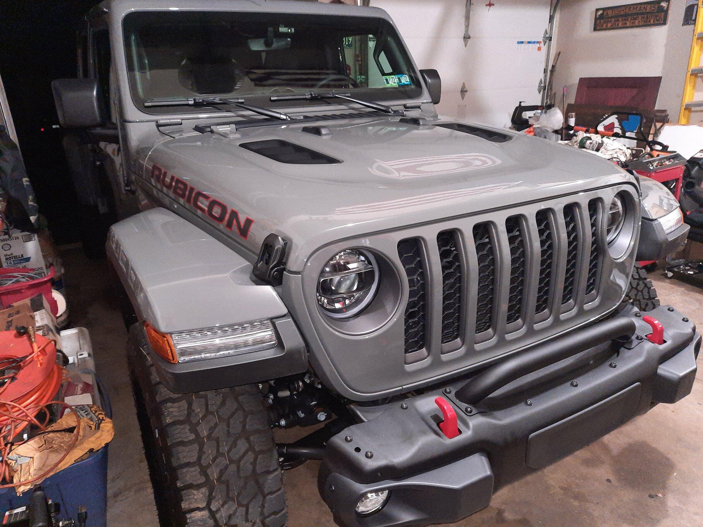

Today I added a mopar steel stubby bumper, skid plate and hoop. I reused the plastic trim piece from the plastic bumper temporarily...I'll be adding a JCOffroad winch plate and Teraflex leveling kit once I decide on the winch, probably end up with another Warn with synthetic rope.

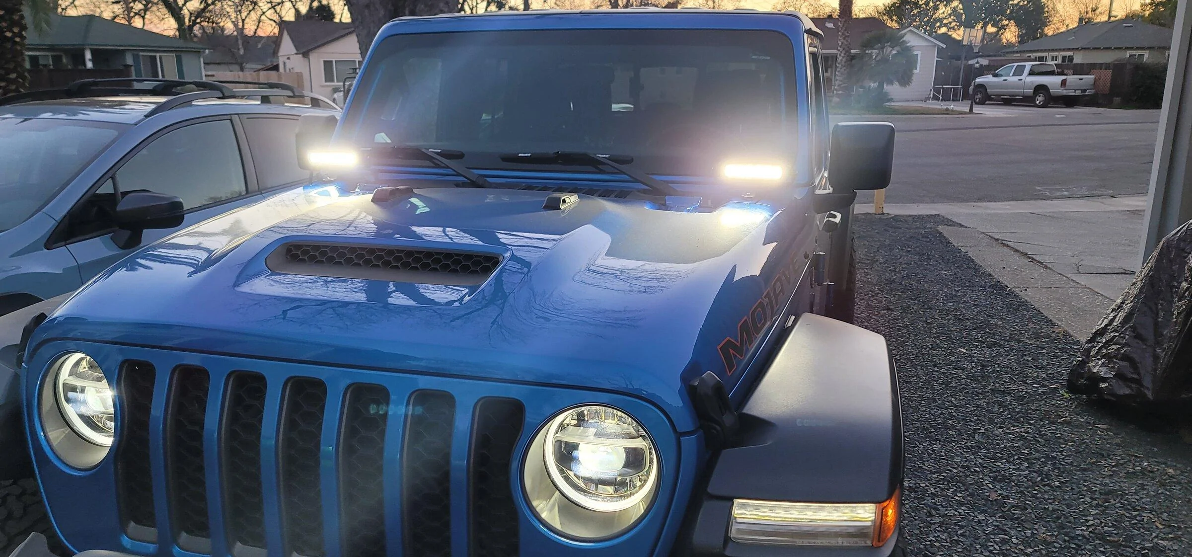

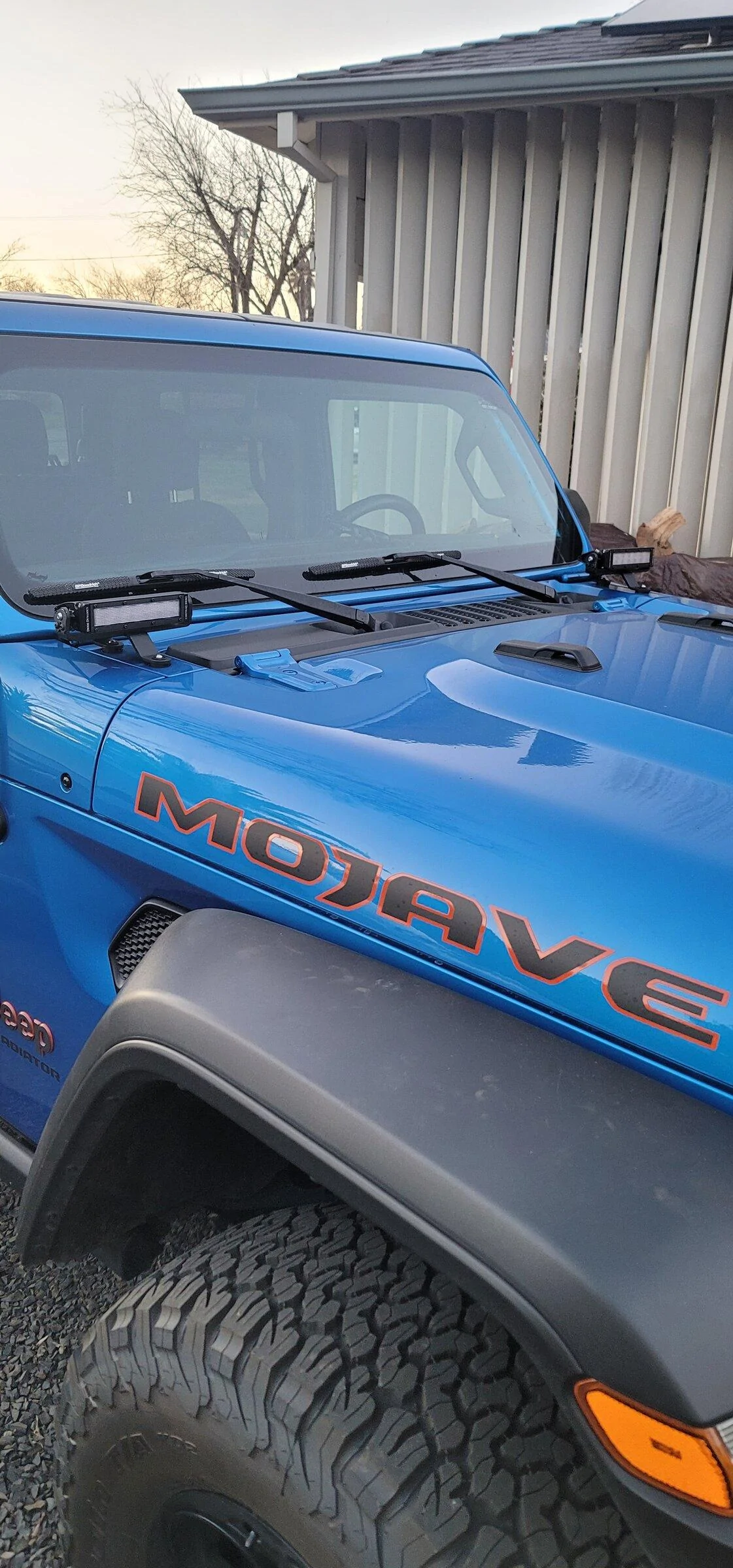

Added some forward ditch lighting today. Diode Dynamics 6" bars. I was going stick with round KC type lights and I love those but at the last moment I saw a member here that had these and I thought they looked great and inconspicuous.
