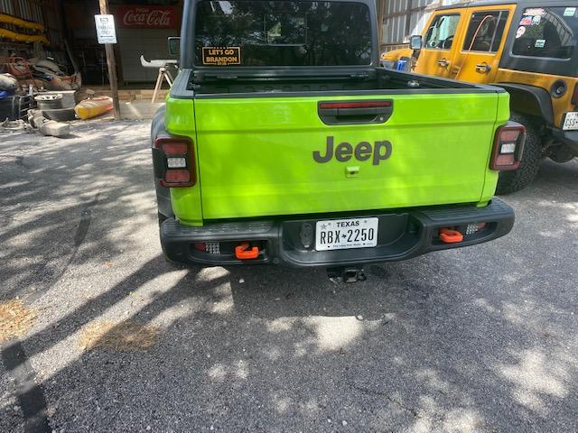

Looks like you have the ParkSense sensors in the bumper. Did the steel bumper come with the holes for them? If so, do you have the part number? Also, did you just move the sensors, holders, etc., over from the stock bumper? Benny at AllMoparParts.com said it would be pricey for all the little bits and bobs as there was no Mopar conversation kit available. Just hoping I only need the bump to change mine over.

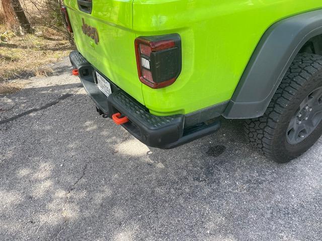

Installed a passenger side hook on my Willys. A bit of advice to anybody doing the same on a non Rubicon plastic bumper and installing a OEM bezel for the cutout, you will spend 95% of your time trying to figure out how to separate the two plastic cover halves trying to get the bezel insert swapped. Get comfortable with possibly breaking a tab or two if not careful.
Sorry for all the questions
The cost for the parksense brackets wasn't horrible when I did mine. First, when I did mine, you couldn't get a steel rear bumper with park sense holes unless it was a take-off ... I don't know if this has changed. The brackets for the steel and plastic bumpers were different and a couple of additional bolts were required. The total cost for all of this was approx $70 from all mopar parts a little over a year ago ...
I may be messaging you for advice once it warms up. The parts for this are in the heap in my garage

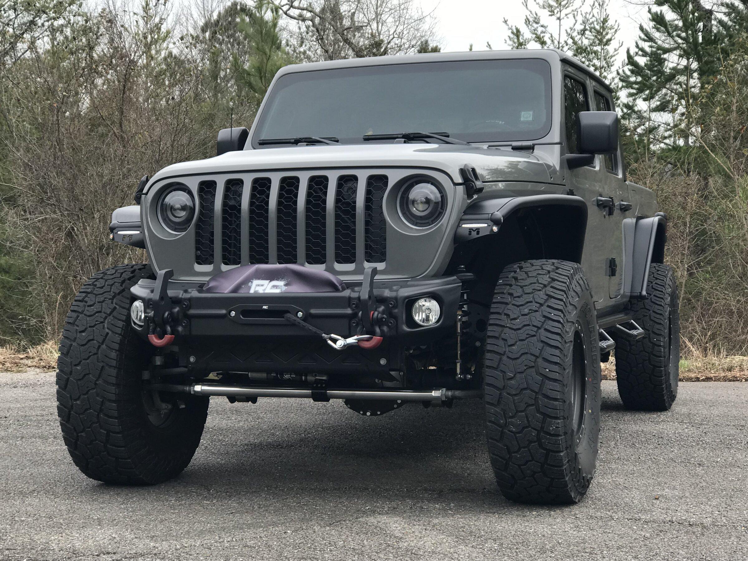

Never again on Jack stands! I will install a 2 post lift on the farm.
So I finally got around to installing my Clayton lift on the JT this past weekend and I think it looks great.
JT now stands 79 5/8 inches tall and 49 inches to the top of the fenders & 59 to the top of the bed rails.
The member I bought the bumper from had ordered all the parts and shipped them to me. It cost $100 from Bam wholesale parts. I can email you a copy of the parts needed if you DM me your email. HIs parts list was perfect, no more needed and none left over. I did also install the bedside rubi rails so the bolts for those is on the list. If you don't need those it would you about $20. The bumper had the sensor holes but the bezels for the sensors and plate light do not swap from one bumper to the other, hence the parts list. The sensors where the only part I reused.
