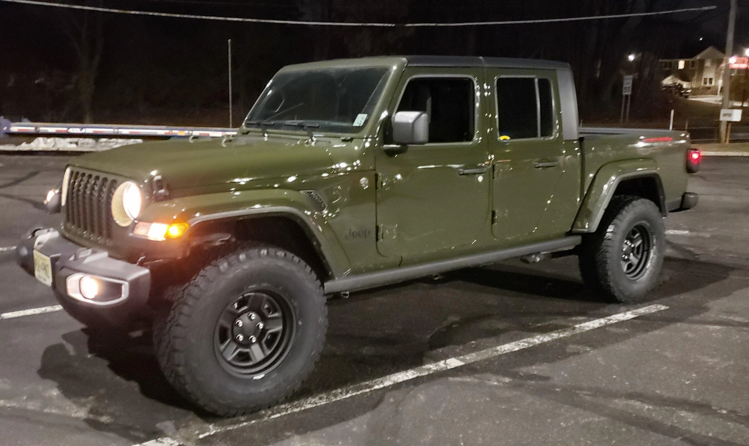

Better View of the Whip at night.

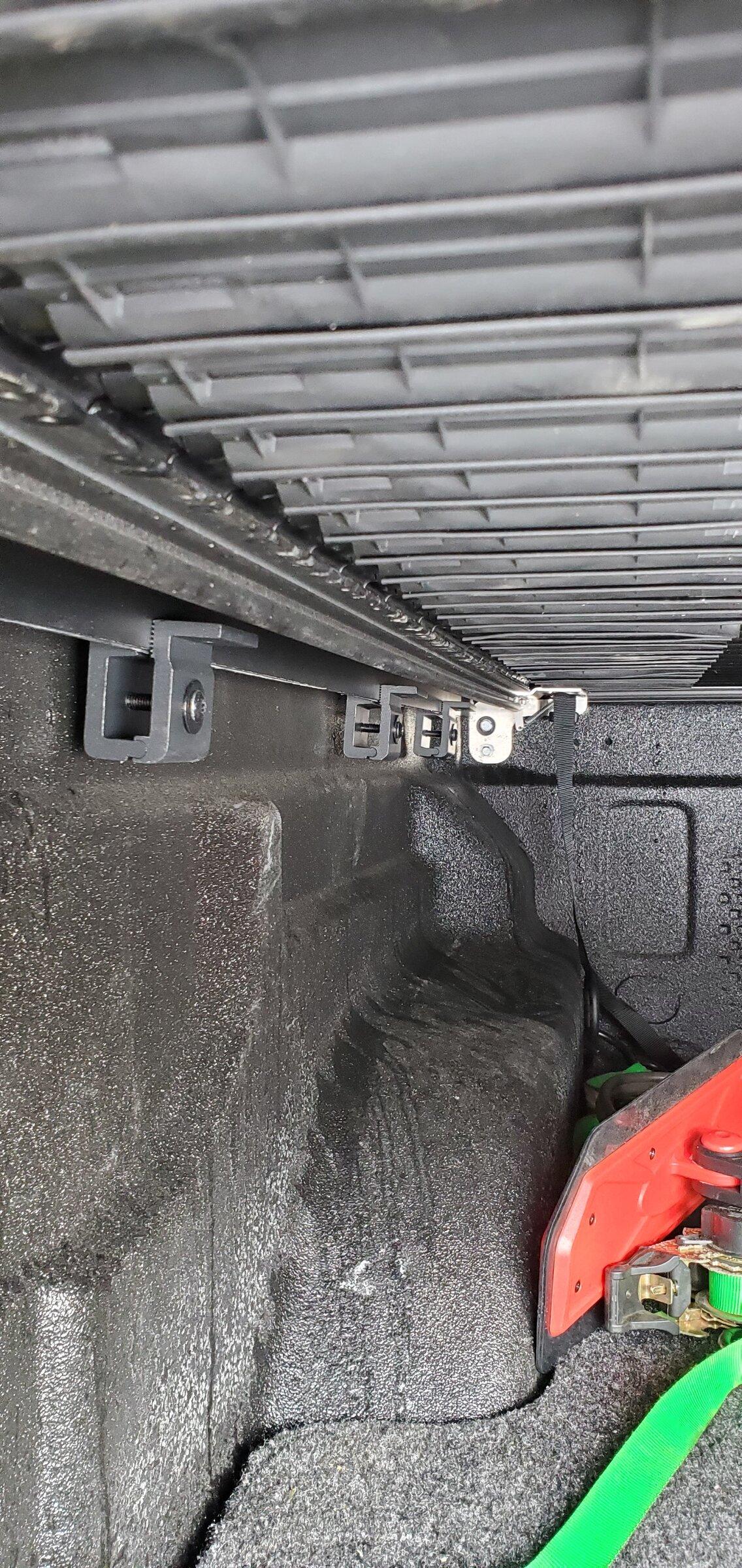

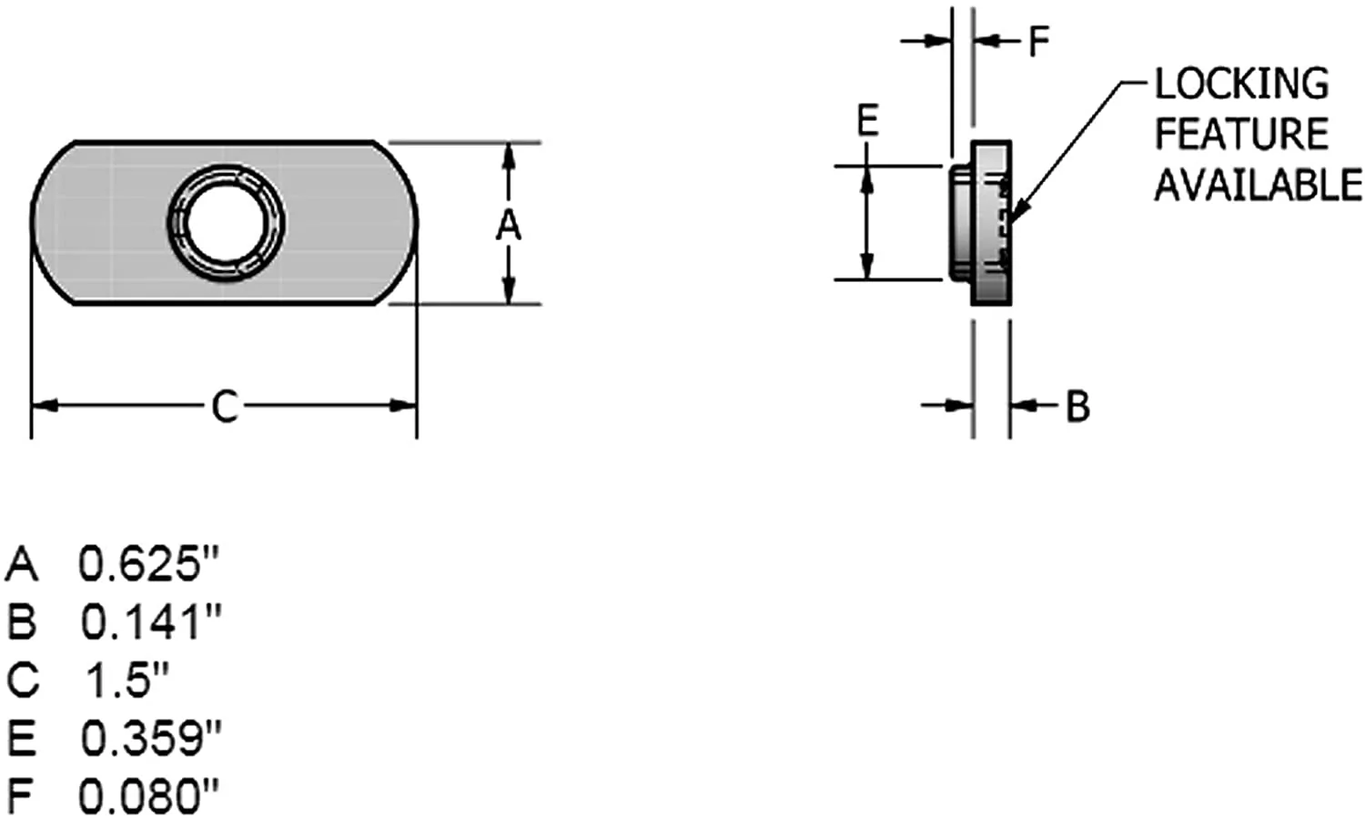

Does that OVs rack attach to the t-slots on the Bak cover?
I can’t find anything on their website that says it’s compatible. Only clamp mounts..
Yes, but I don't think the t-slot is a standard size. I had to get creative with the mounting hardware:
5/16-18 Spot Weld Nuts - Double Tab - Center Hole Design Spot Weld Nut (they are 5/8 (16mm) wide x 1 1/2 (38mm) long. https://www.amazon.com/gp/product/B07PWGJH59/ref=ppx_yo_dt_b_asin_title_o08_s00?ie=UTF8&psc=1
1 1/4" 5/15 Stainless Steel Bolts with a Flat Washer
When I attached the bed cover (I don't have trail rails) I drilled out the front insert nuts and replaced them with slightly larger rivet nuts and added 6 bed clamps to make sure the frame was secured to the bed (see photo).
I'm still looking for a better nut or a t-bolt, but haven't ordered anything yet. At a minimum I want to get the spot weld nuts in stainless steel so they don't rust. I also think a 1 1/2 or 1 3/4 t-bolt would work as well. I just need to find one that fits the slot. The actual t-slot is not much bigger than the 5/16 spot weld nuts I used.
Bak will not say that it will work. I don't think they've done any testing on the load rating and probably don't want the liability (neither do I so do this at you own risk:).
I can tell you that I took it on a 2500 mile trip thought the Badlands, Wyoming, and down to Breckenridge Co. We only did about 100 or so miles off road, but it was enough that I'm comfortable with the set up if I don't change anything. It wasn't really an off-roading trip, but I wanted to use it to shake down the truck and tent set up. We camped a couple of nights in the Badlands and took most of the off-road trails available there. In Colorado we took several random National Forest roads and went to the top of Peak 10 in Breckenridge. No super hard trails, but it was plenty rough to shake down the rig and I'm happy with it. Peak 10 was steep with some tight switchbacks and a few rough spots, but easily manageable even with my set up.
