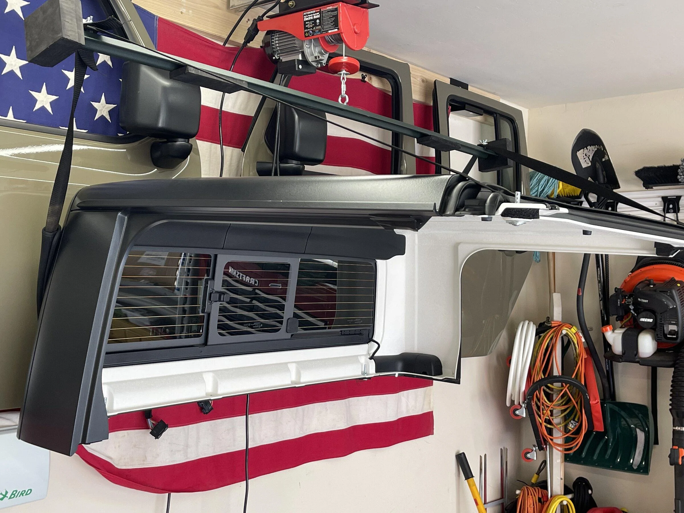

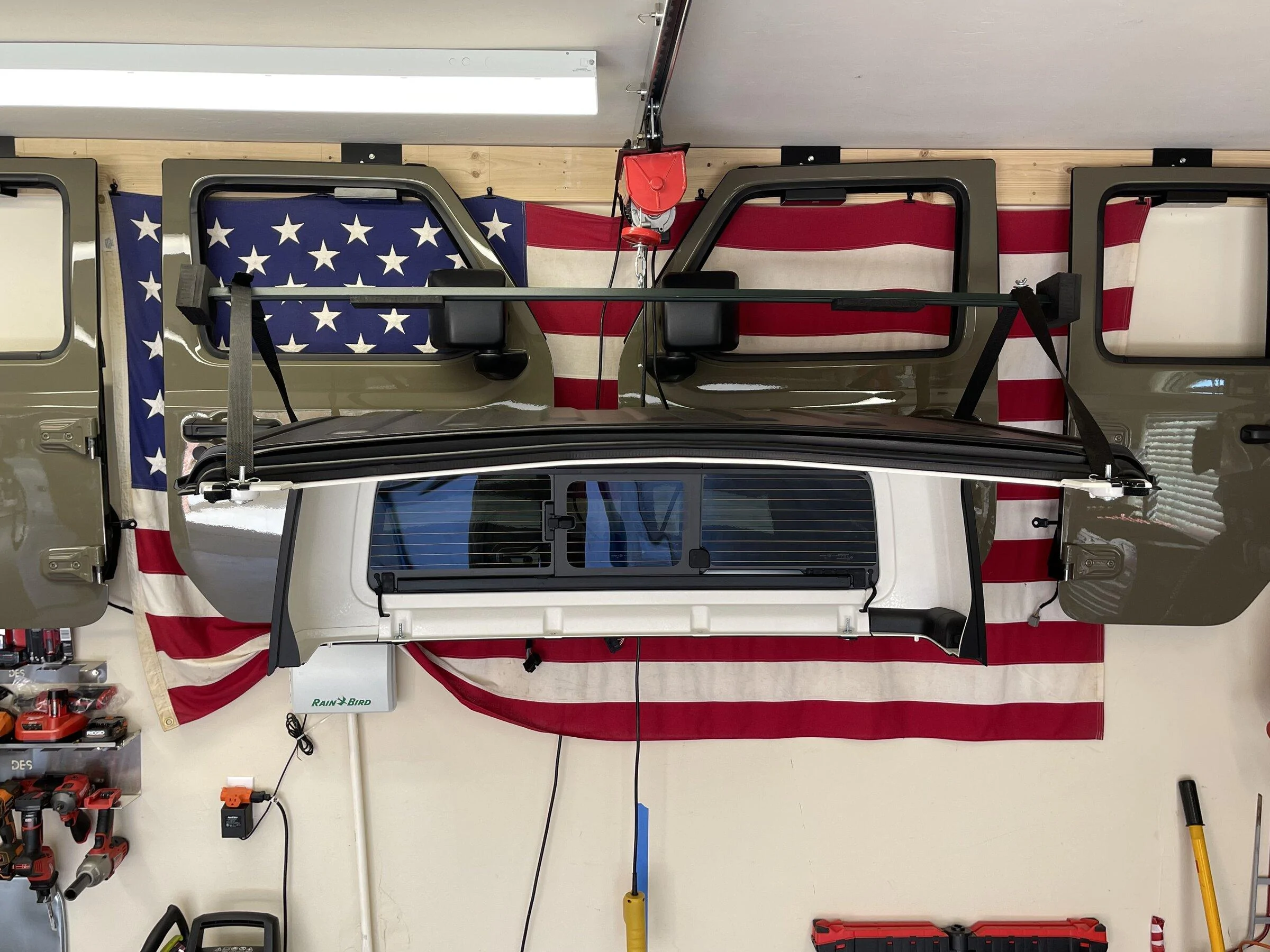

Took some measurement to see how much clearance I have to go bigger on tires. 38” or a small 40” will fit I am betting.
Which hoist system are you using?
FLUndertaker
Aug 9, 2020
83
1,049
1,244
Oklahoma
2020 Jeep Gladiator Sport, 1986 Jeep CJ7
Self made. Unistrut mounted to the ceiling. Couple of Amazon sourced trolleys with a HF electric hoist bolted on. 6’ sigh post with webbing and grommets. Couple of hitch pins to lift from factory bolt holes. Makes removal a 1 man 5 minute job and holds my top up and out of the way all summer.

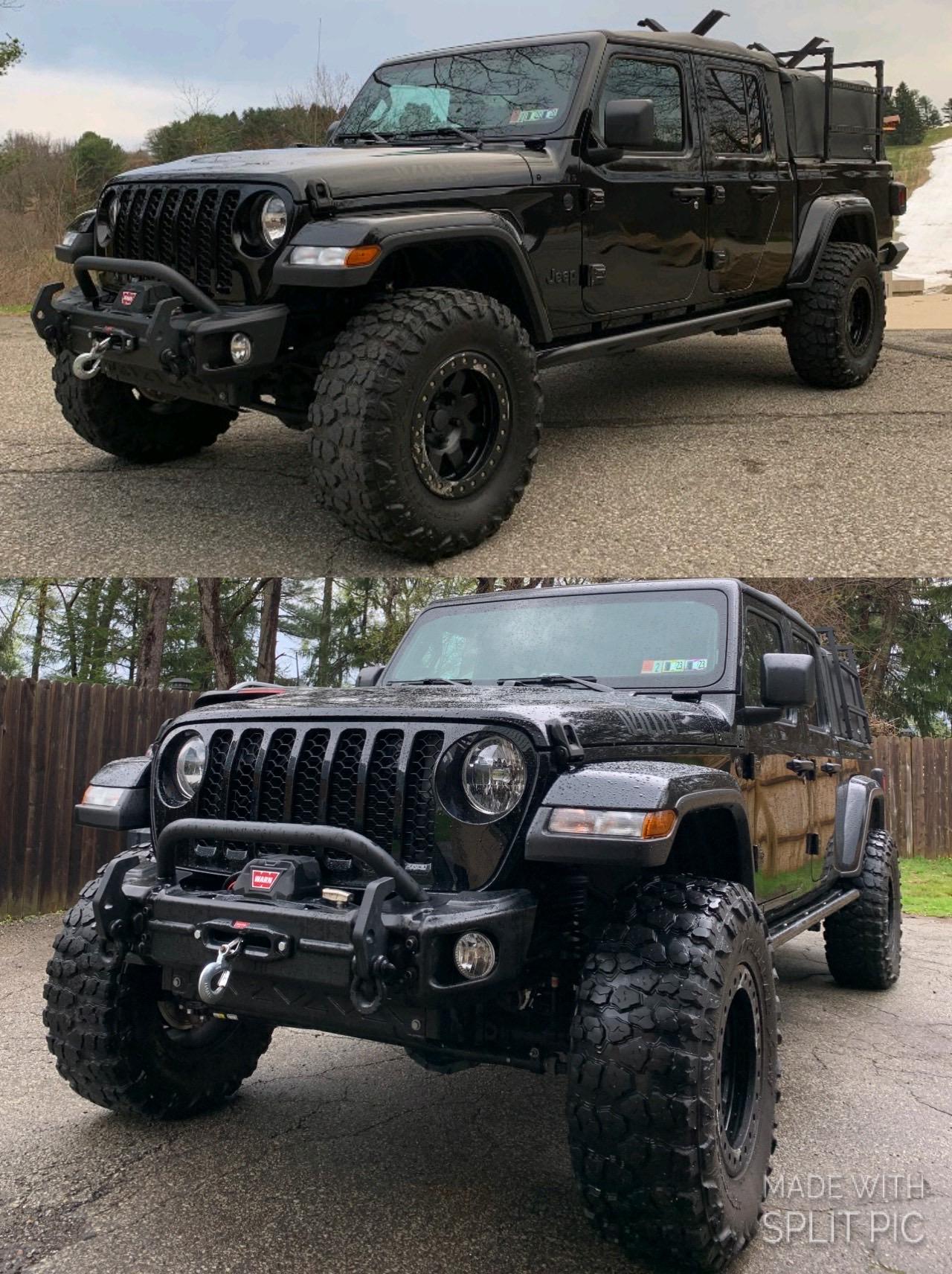

Reworked my DIY rack the weekend. I originally made it 90 degrees so my trifold tonneau could flip but that left it looking “off” now that I run the Softopper.

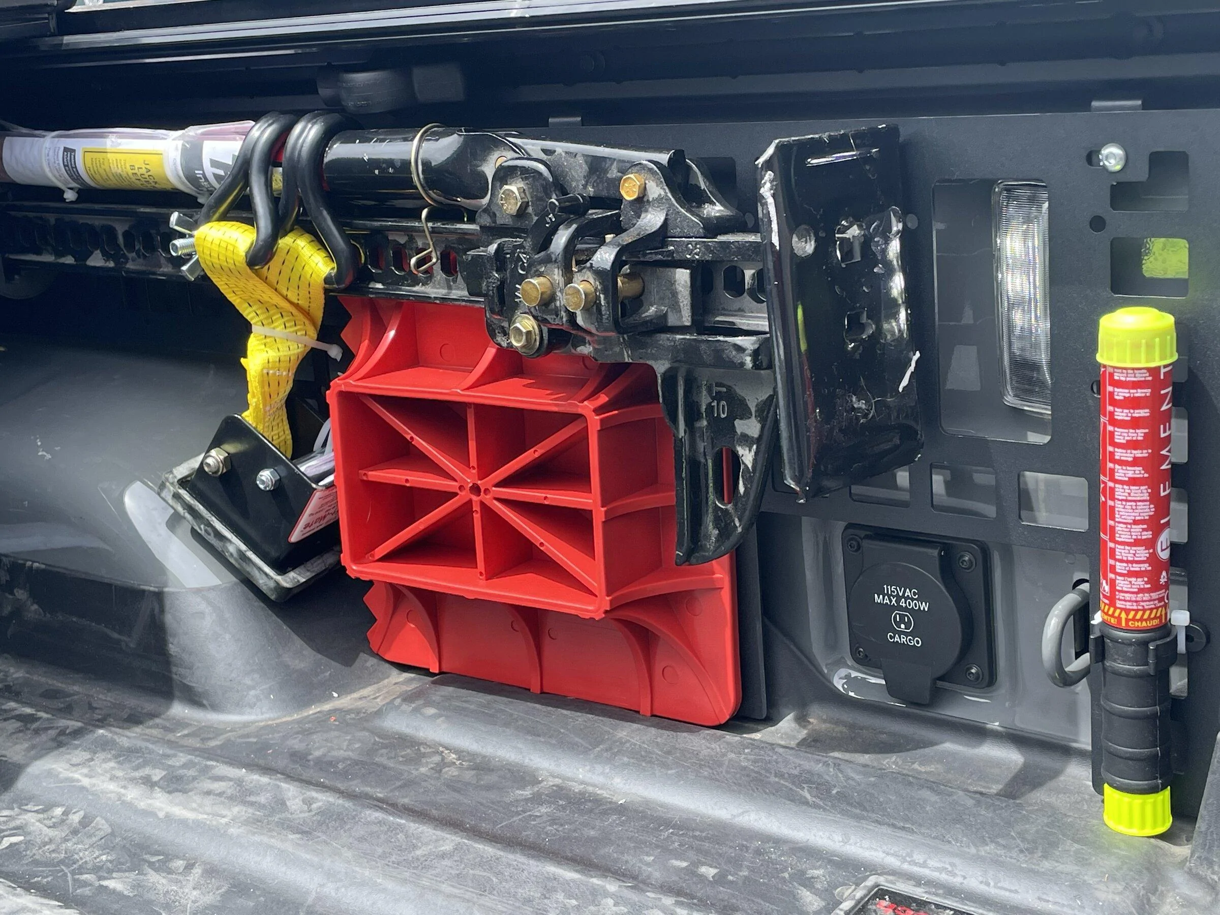

JCR Offroad, bedsides molle panels purchased from a forum member. Great quality and easy install using the cargo rail screws. Perfect place for the hi-lift jack gear and E50 fire extinguisher.
