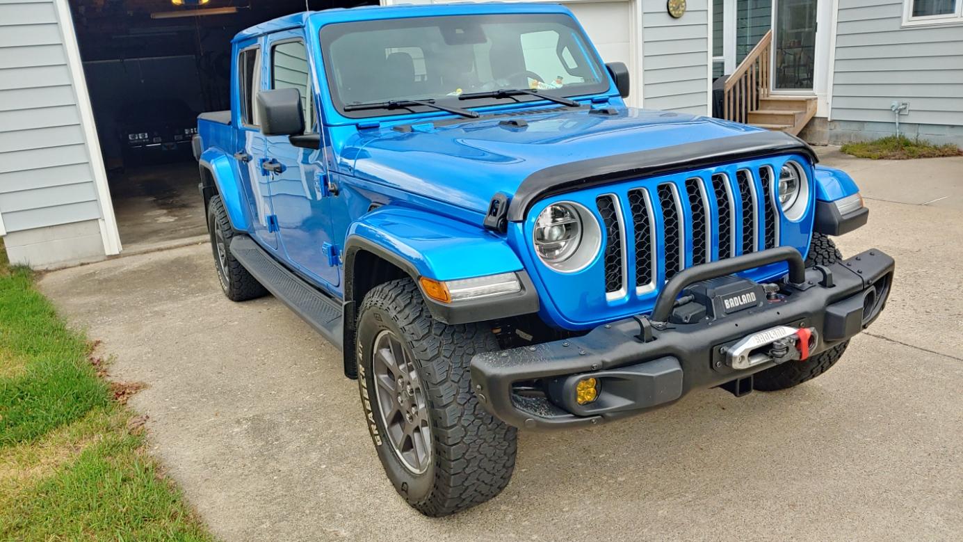

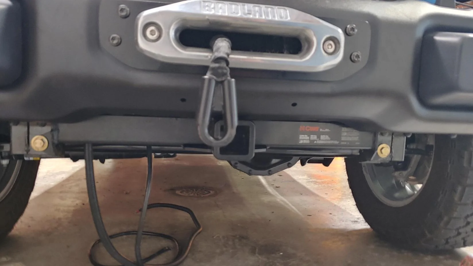

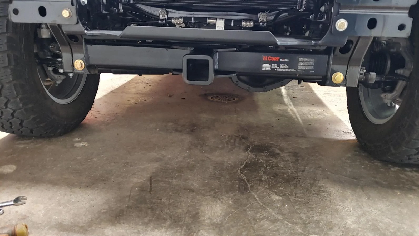

Can I get a picture of the front hitch when done? Been thinking biut adding one, but not sure how well it will fit with the bumper I have.

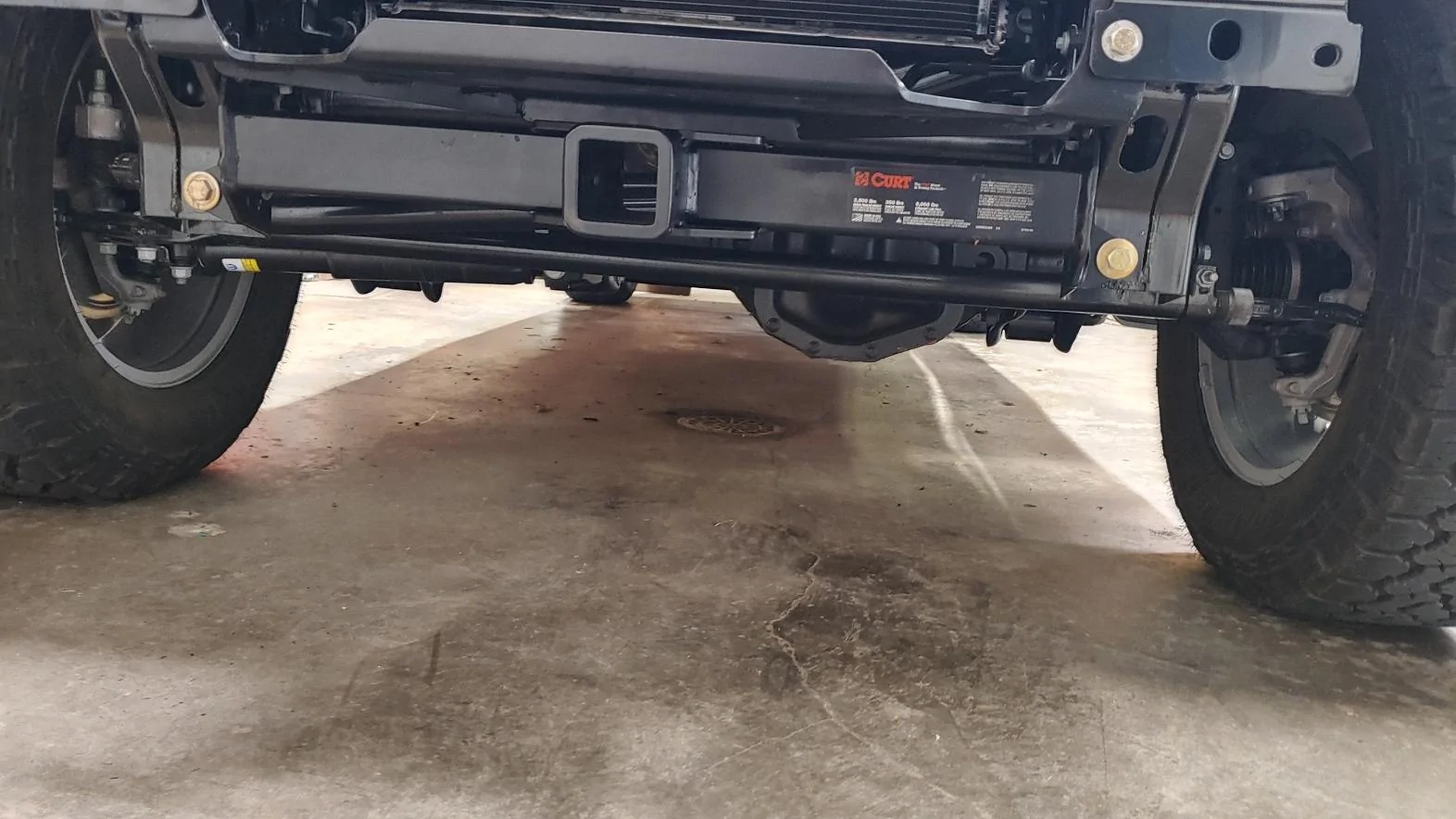

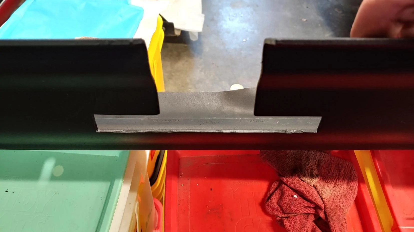

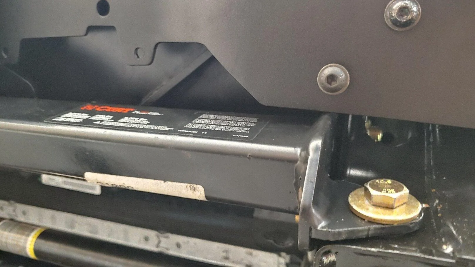

The odd thing is that I had the same bumper and same receiver on my 2020 and it cleared fine.
On this one I had to use spacers to move the bumper forward a bit -
So, there has to be a slight difference in the truck somehow, somewhere. Same bumper, same receiver, same bolts, same location - but it would not clear without bumper spacers on this 2022.

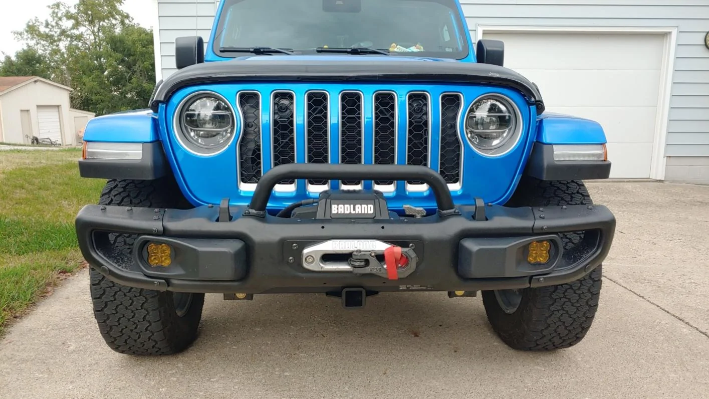

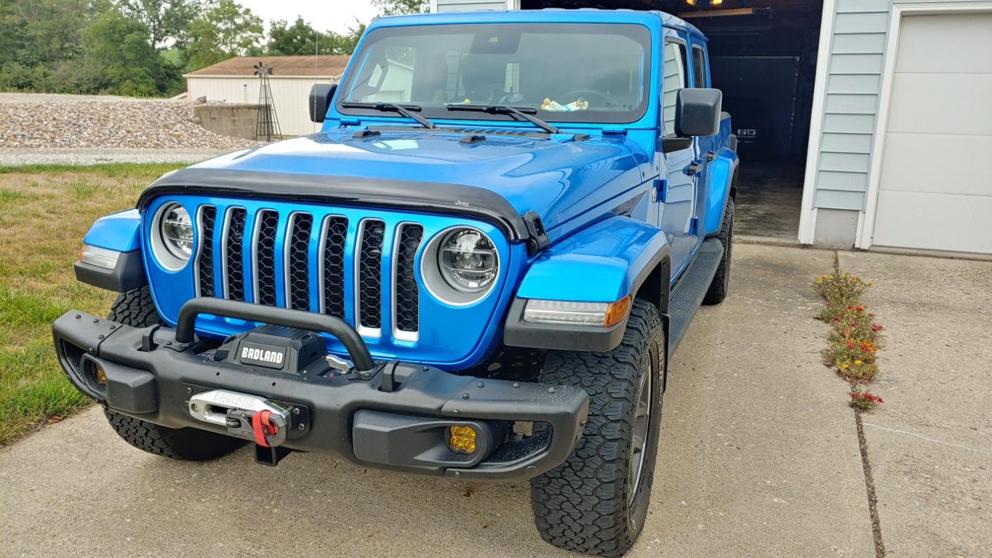

And as for what I did to it -
I put the ends back together and put them on the bumper.............
Skid plate not on yet and the front end settled 5/8" from the weight of the bumper, winch and winch plate.

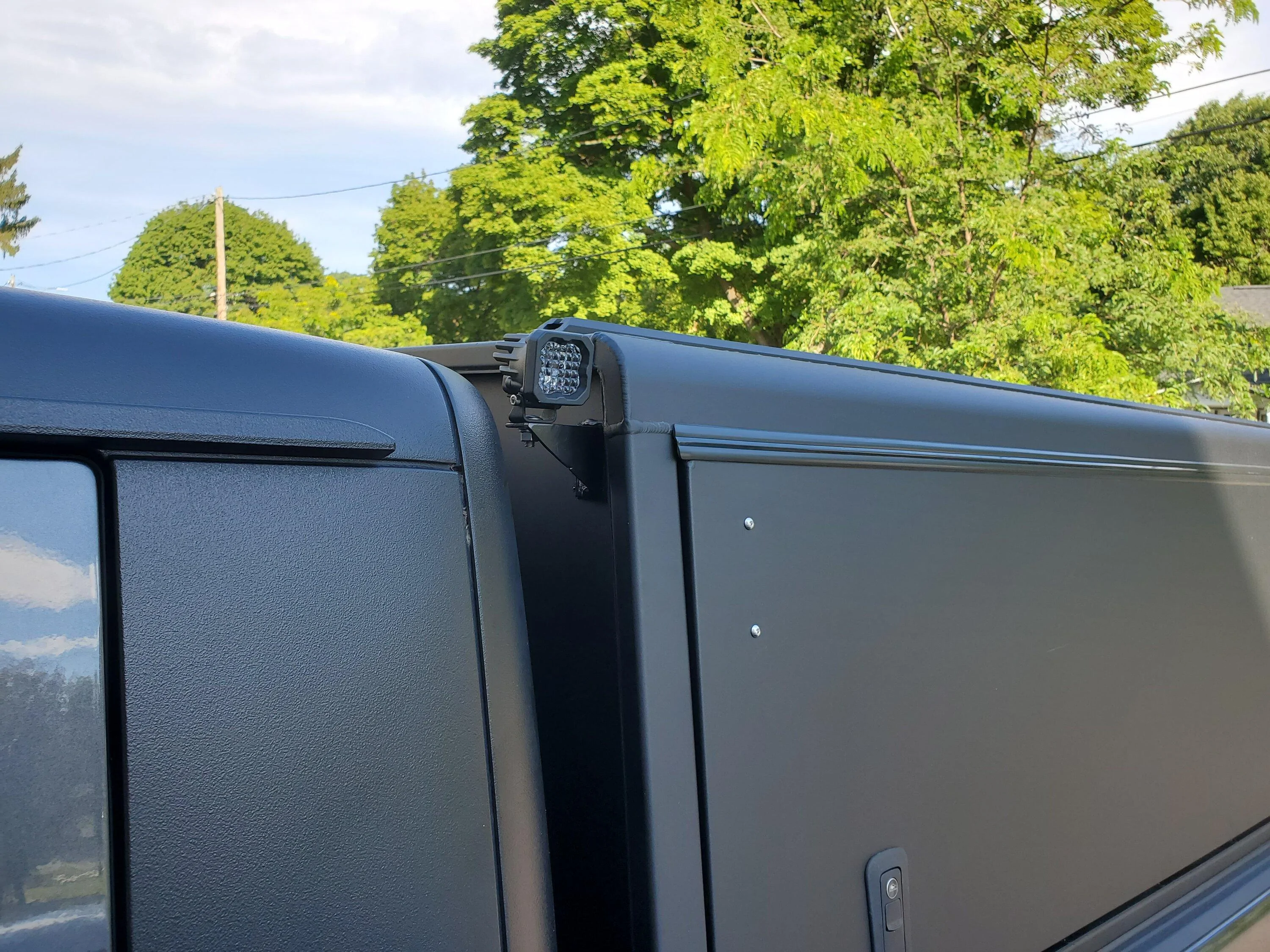

Installed and wired up my DD SSC1 rear lights. Should work pretty well as auxiliary backup lights.
I also wired in the red back light with the tail lights

I'll also be able to switch on the back light for general lighting when I'm doing astrophotography so it won't ruin my night vision or my pictures.
Since my previous post I also added another pair for general lighting. These are the same spec as the flush mounted ones, they just mount normally. I'll just be wiring the red back light on these into the switch though, not the running lights.

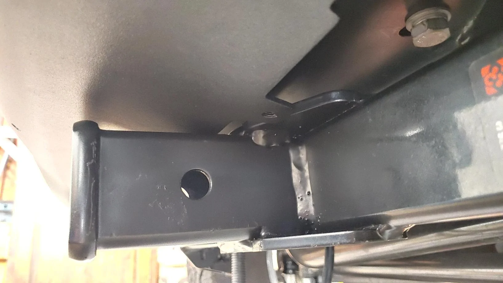

I just wanted to add that if anyone uses a front receiver with the steel bumper - the steel bumper sticks out far enough and the receiver is tucked under far enough that the ball mounts I had wouldn't stick out far enough to get my trailer on the ball without contacting the bumper at some point.
So I went out and bought a ball mount that has two holes, it's a dual-length ball mount.
When it's in the back I have it slid in to the shortest hole so the ball isn't sticking WAY out there giving the trailer even more leverage, and when I get home and switch things around to park the trailer, I pull the ball mount from the back, put it in the front and pin it so that it's sticking out and easily clearing the bumper.
So I can use the same ball mount for either end of the truck.
Those with larger spare tires may wish to measure first- when this one is slid in to the short or normal tow position it clears my spare tire but not by several inches. If you have a 37 tucked up in there, be aware you may need to go to a plan B. Or let all the air out of the spare and push the ball mount in although that may not be a great plan.

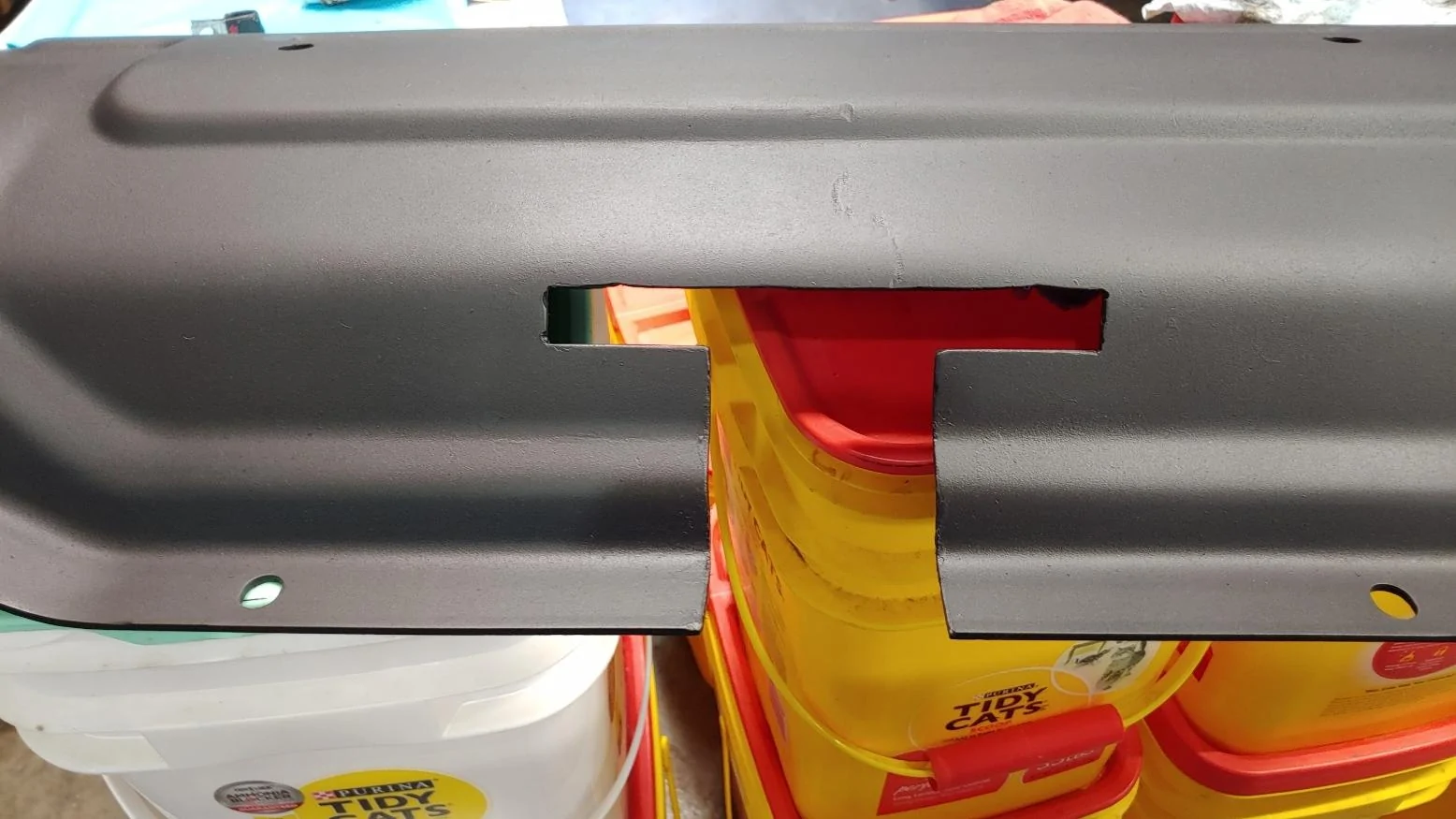

This is really slick!! Do you think you can do a cutout in the front skid plate and put it back on?
Yeah, I have just left it off so far due to the weight - the front has already dropped 3/4" just with winch and bumper without the skid plate mounted.
I did cut the slot a tad too far down - it's hard to project the size and shape needed back to a sloped surface, but it's not off by much. I could put a small edging on the bottom of the slot to sort of fill if it bothers me.
These skid plates are tough steel.
