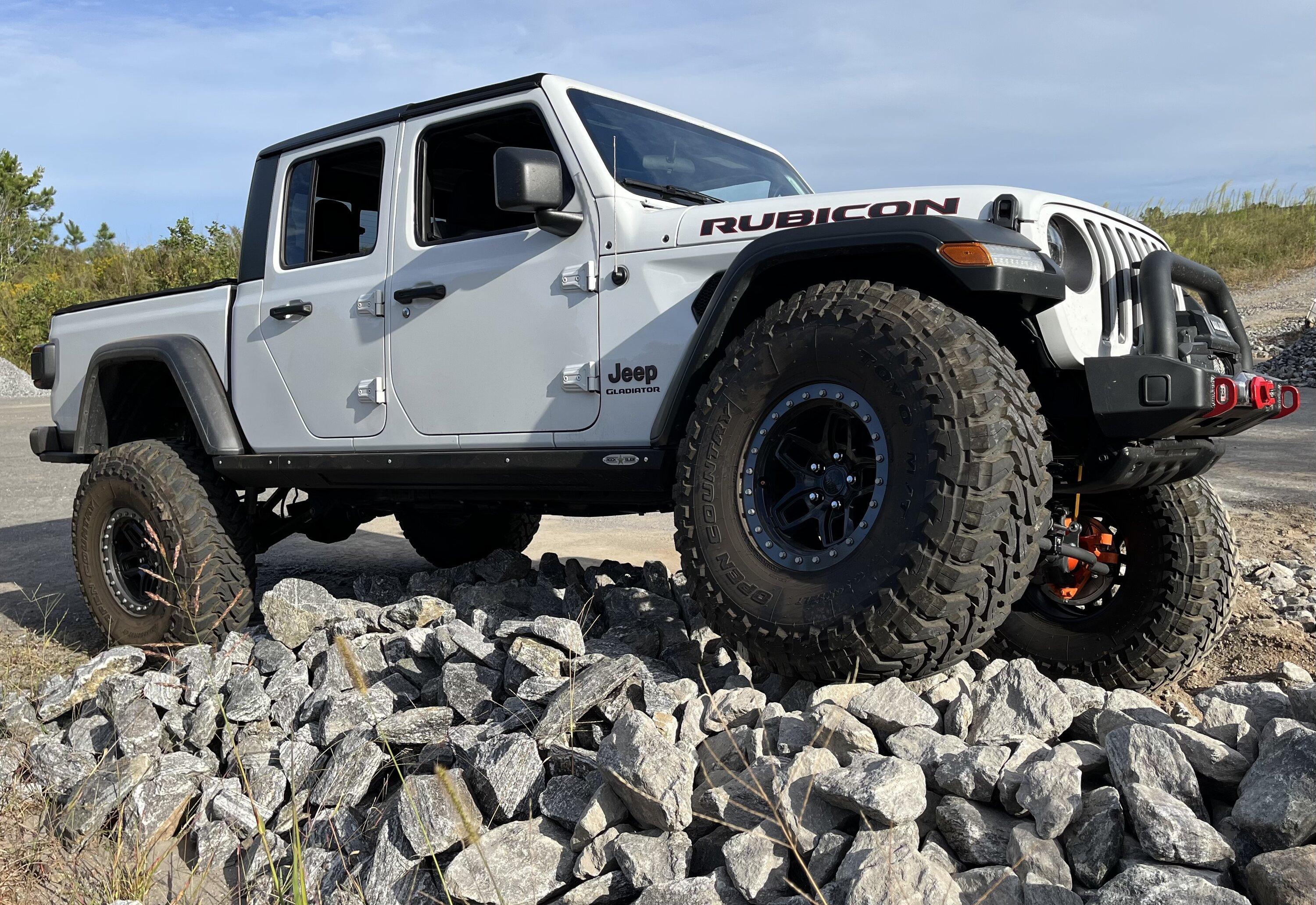

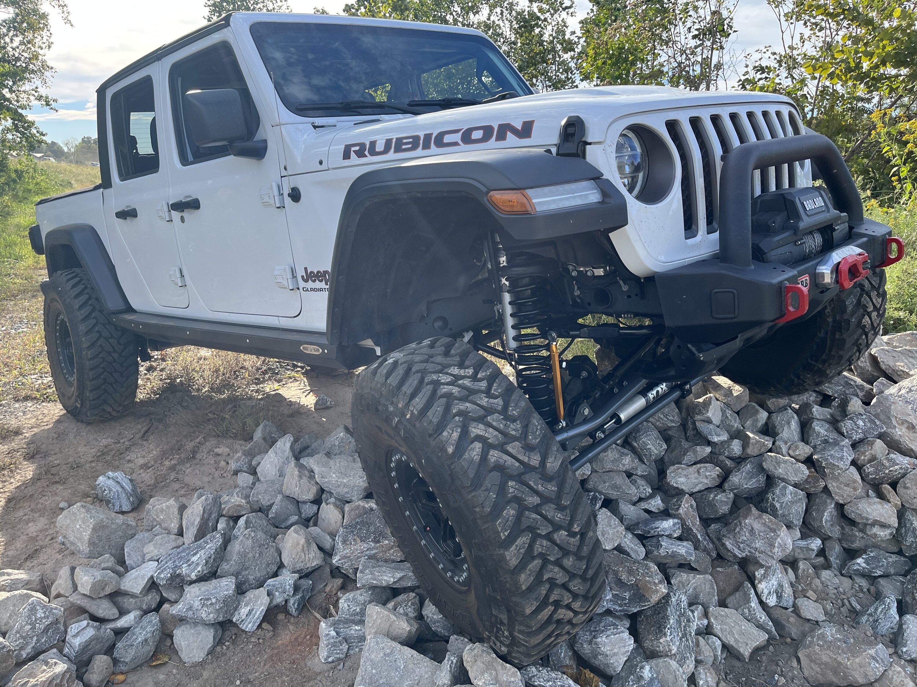

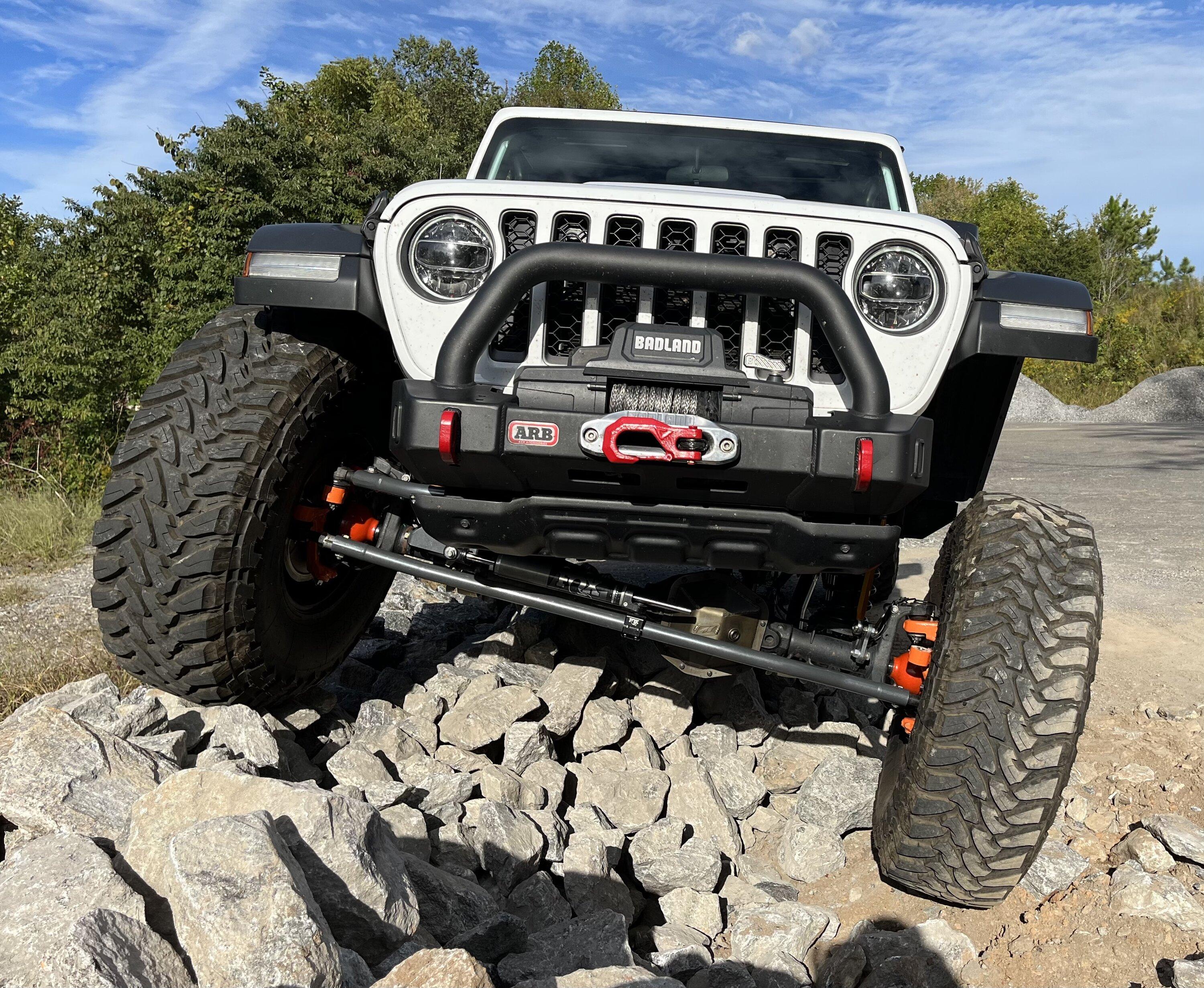

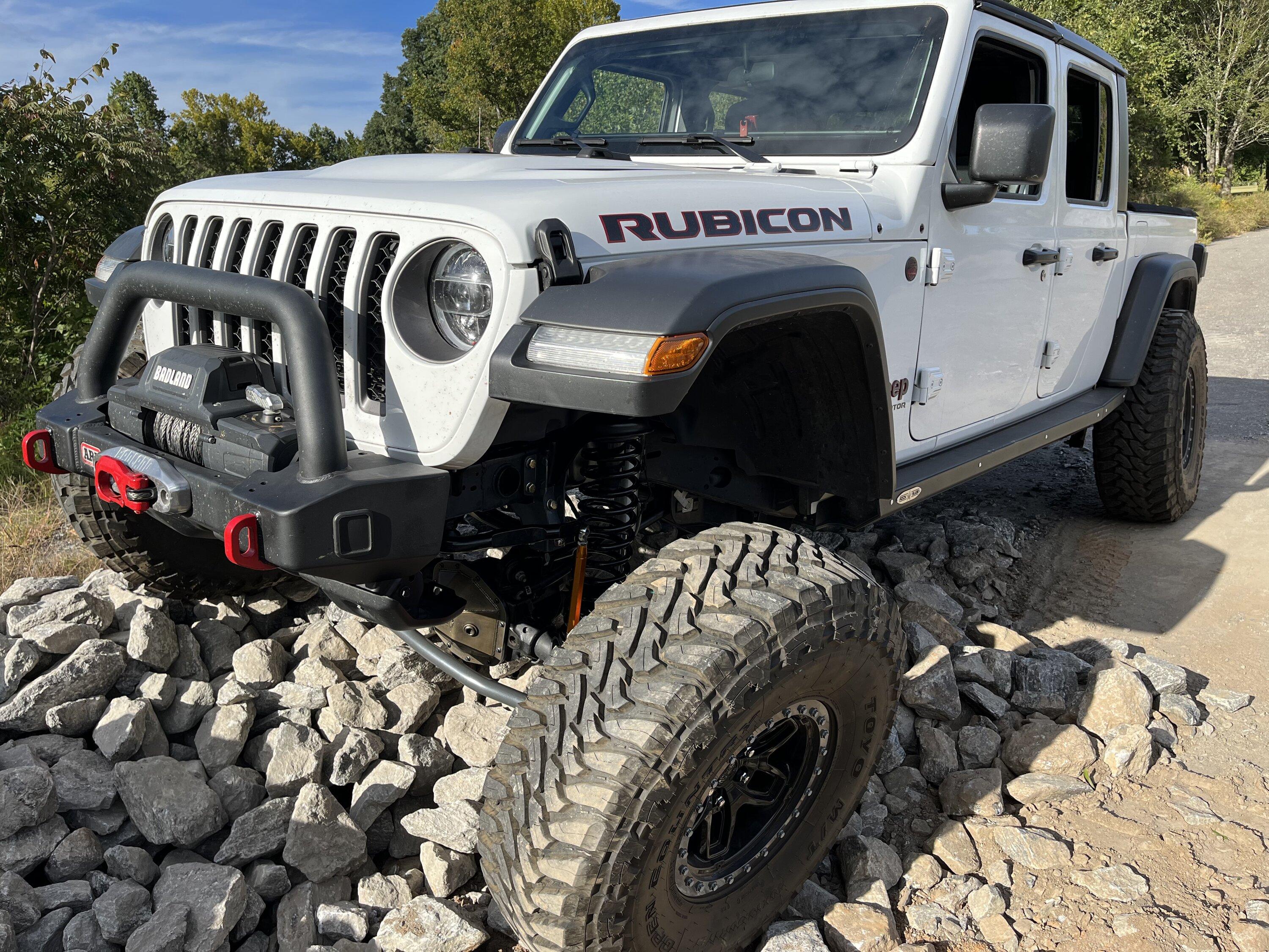

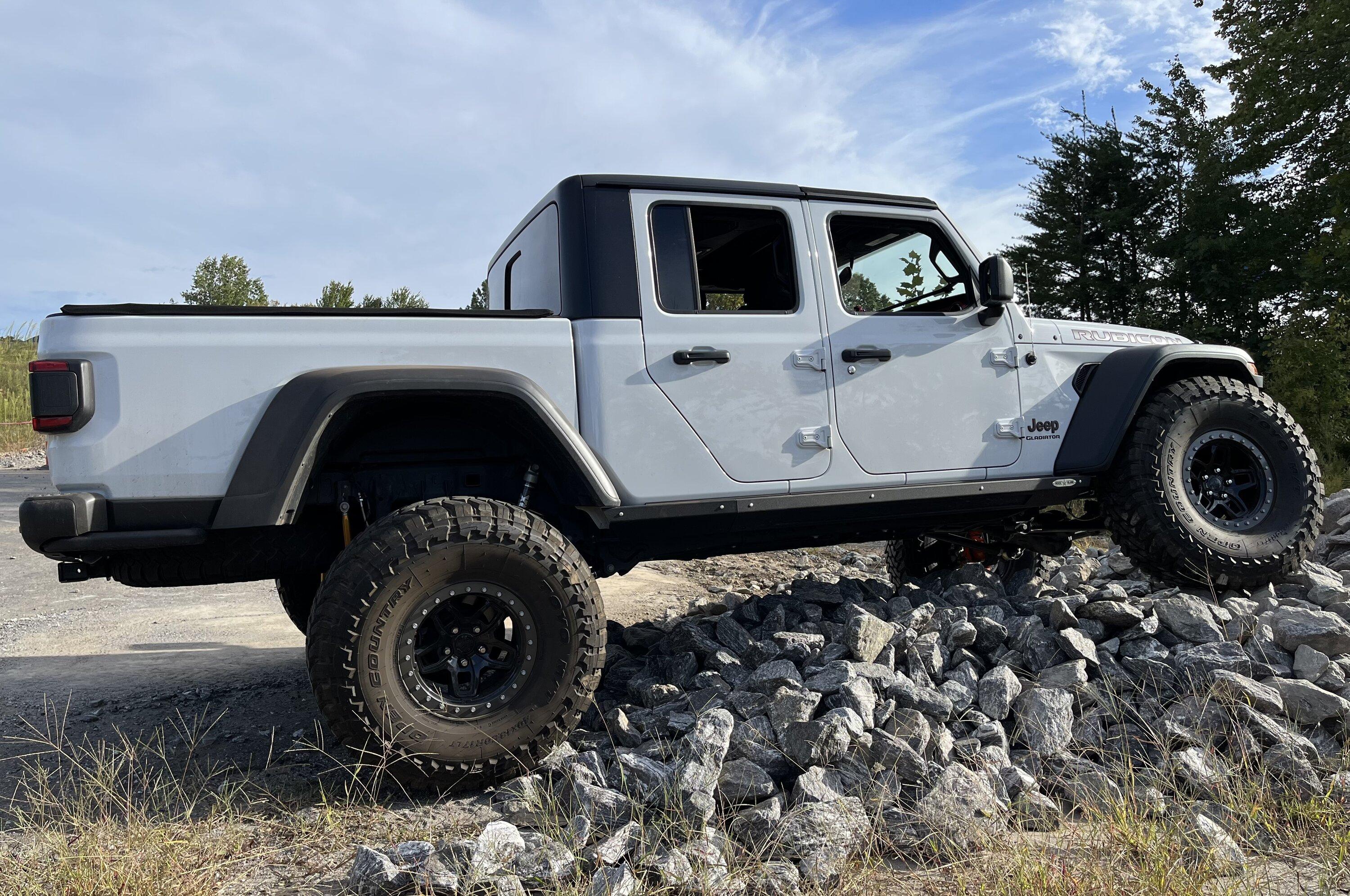

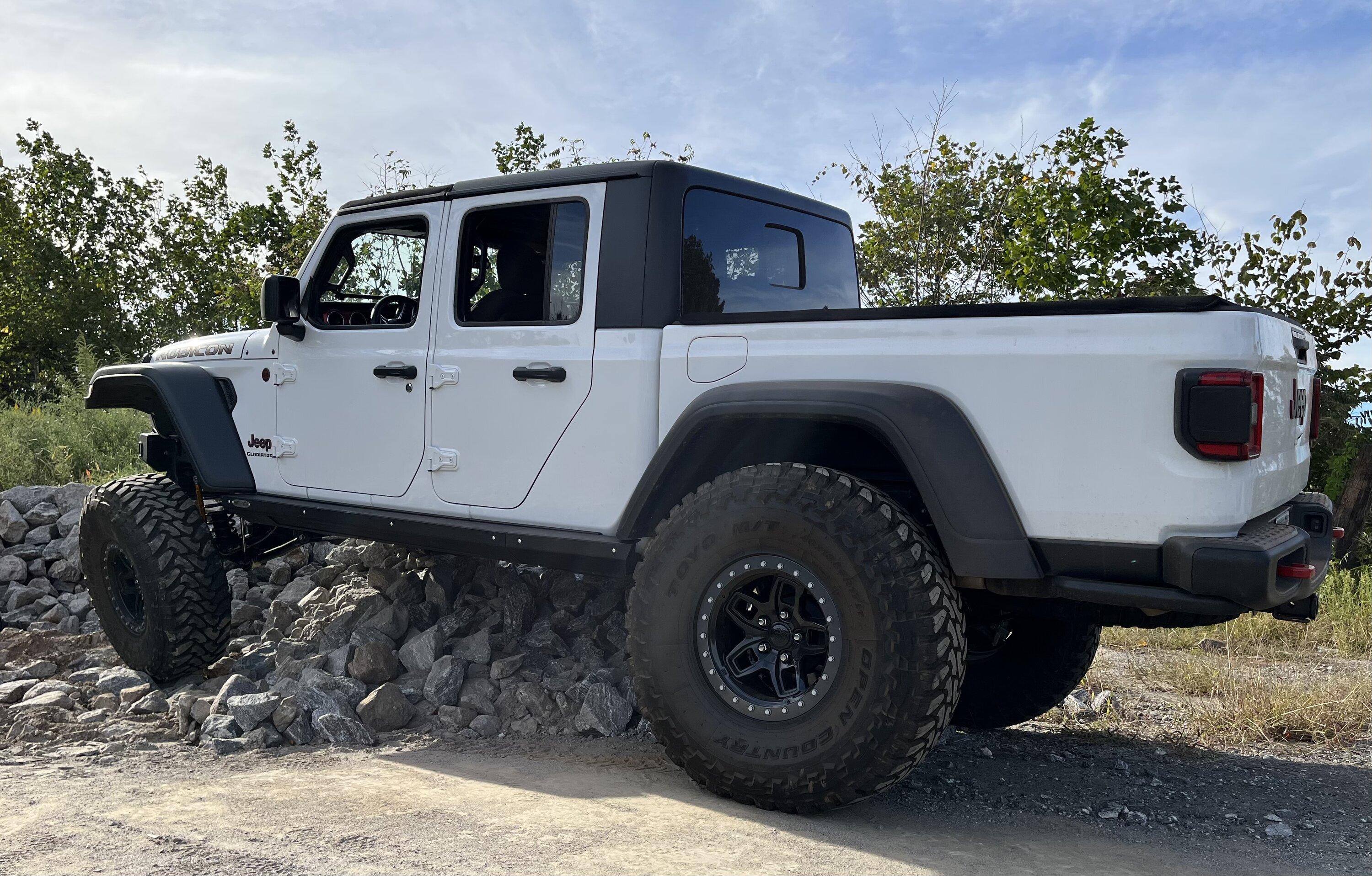

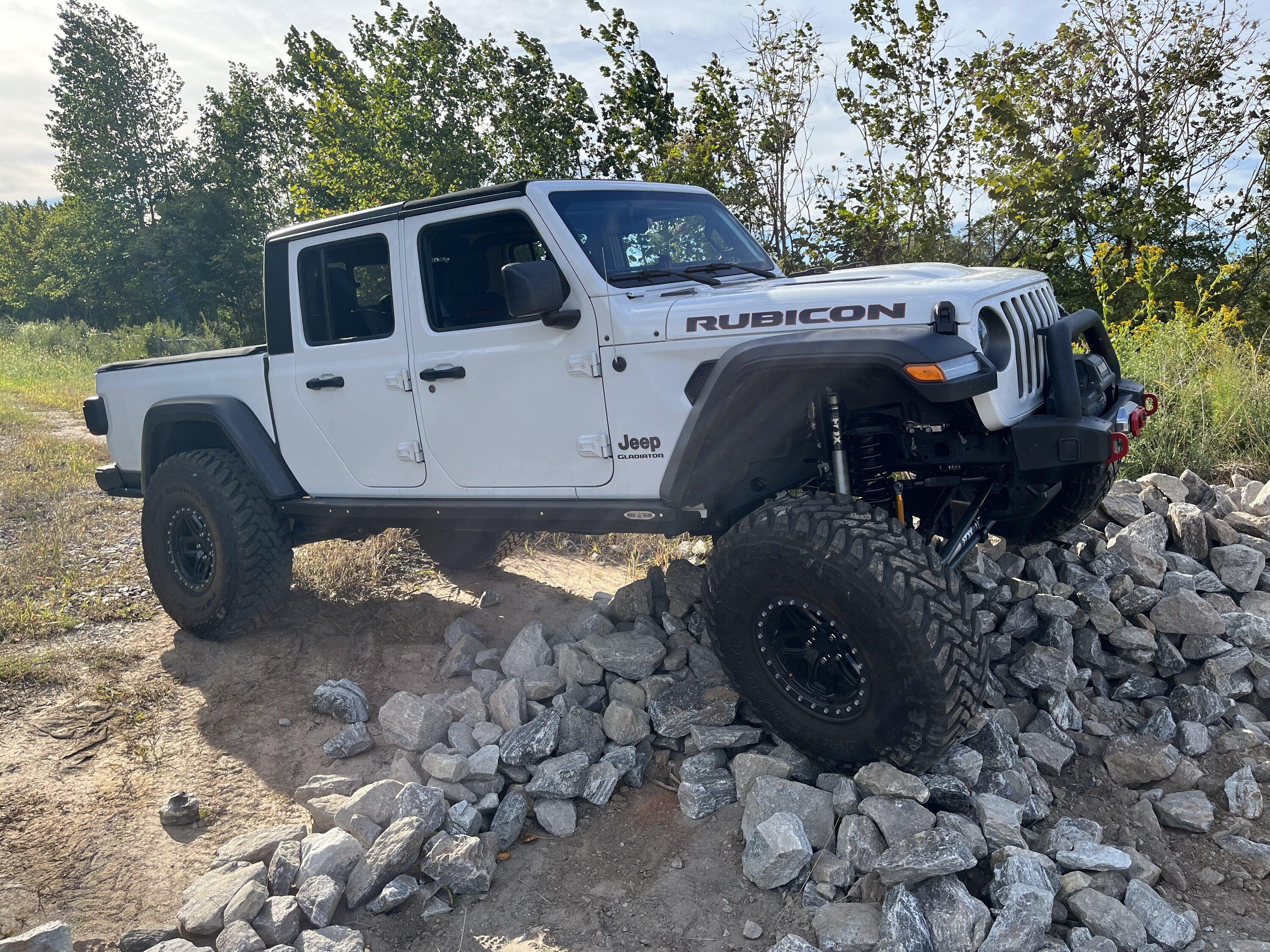

~Installed Reid Racing Knuckles.
~Cut the Rancho passenger coil spring isolator to get rid of bowing
~Installed a Trackbar Frame Brace but their sector shaft piece wouldn’t line up and their hardware was garbage so we removed/replaced the steering gear box and drilled out and tapped the holes to larger/stronger bolts. The sector shaft brace now seems unnecessary.
~Installed rear Evo Bump Stop pads.
~Installed front 4” Bump Stop pads that “snap” together and then “snap” apart during articulation (NOT supposed to come apart when articulating).
~Tested articulation to determine any areas that need adjustment. Found the front shock bodies contact the frame, limiting flex, and would cause bent/broken shock shafts. Will install Shock Relocation Brackets from Metalcloak. May need to install even longer brake lines than current ones.

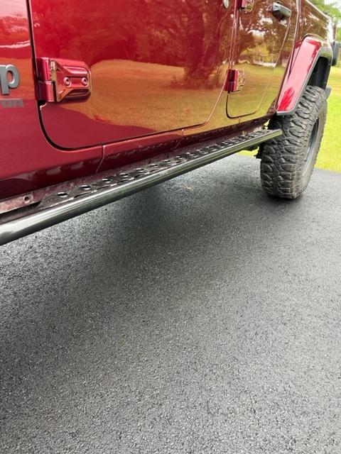

Got help installing new Shrockworks sliders. Talk about beefy. Destroyed my two previous brands, I believe these will survive.

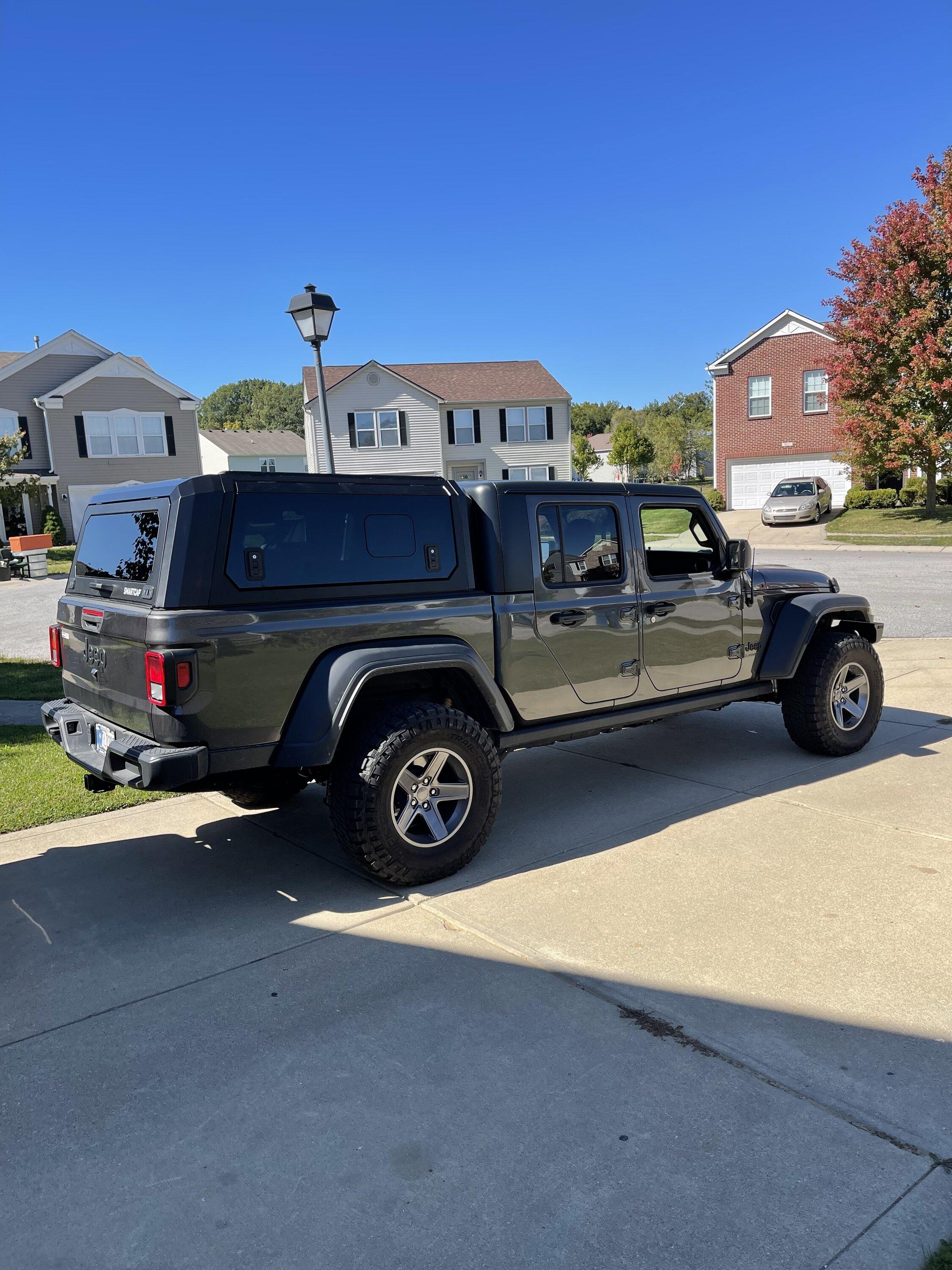

Set out to assemble the Smart Cap to make sure nothing was damaged. After that I realized I no longer could fit the boxes in the garage. So I had to rig up some pulleys and air down the back tires to get it on ??

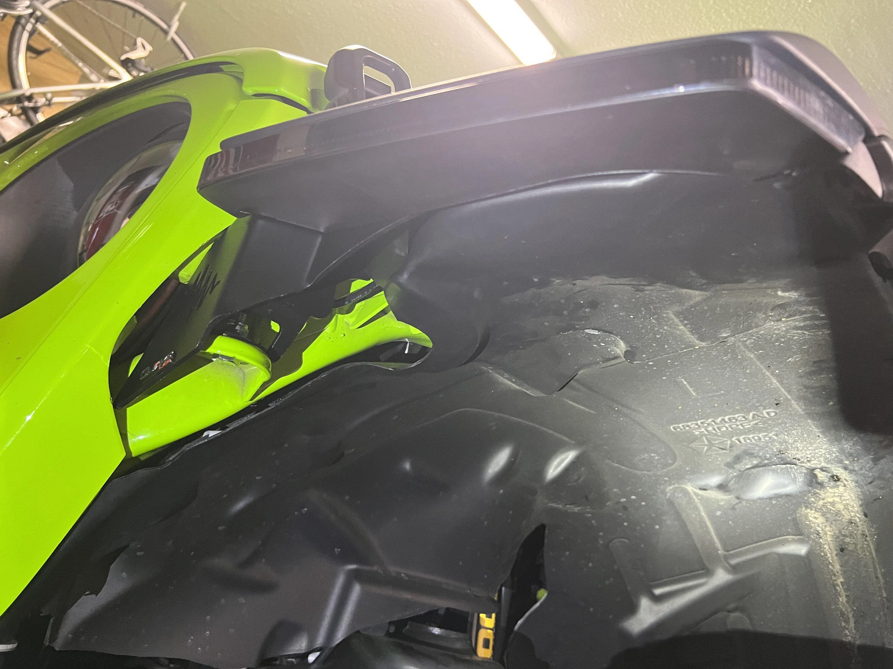

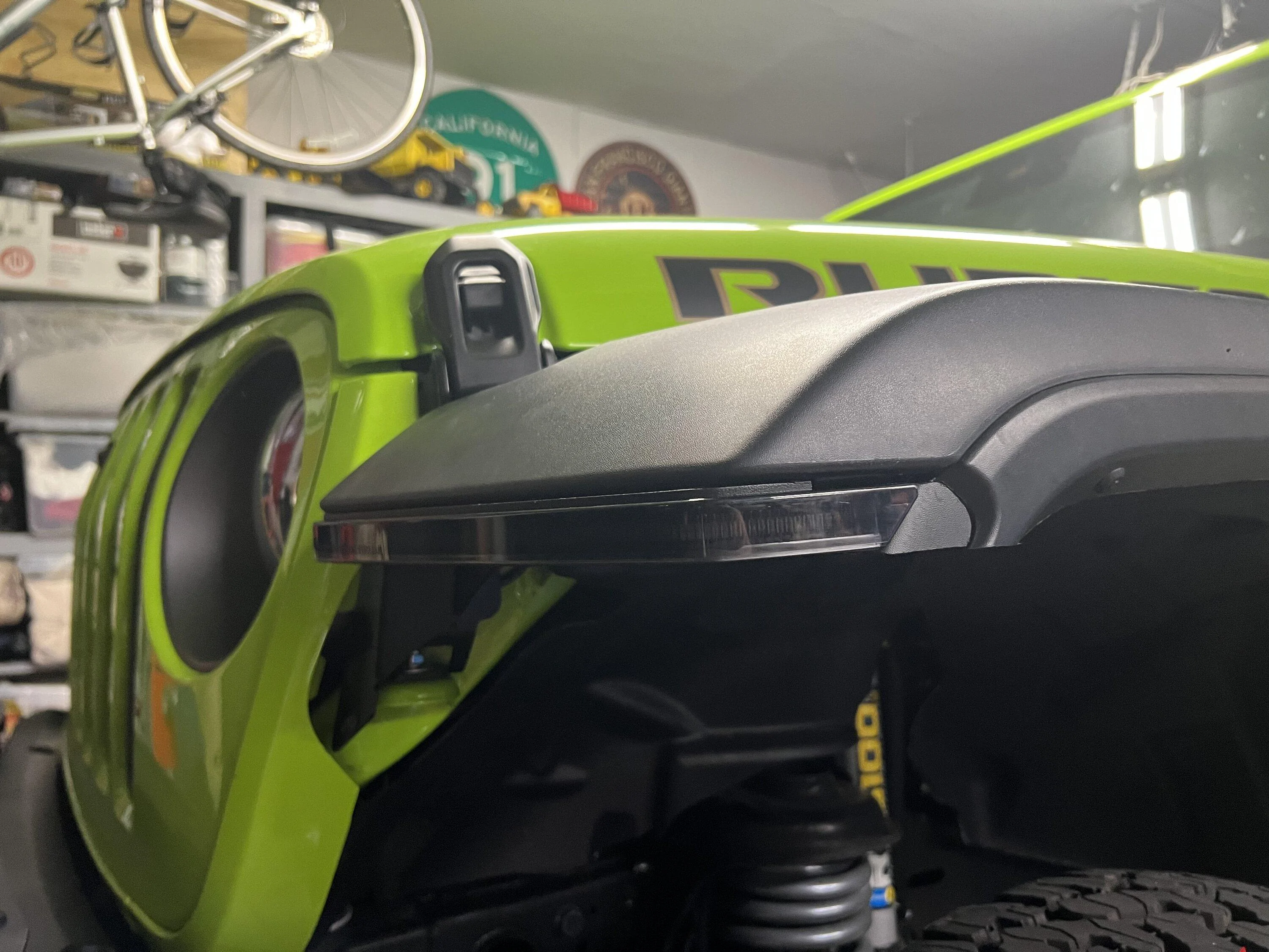

Quake smoke fender chop. I decided to keep the inner fender liner and trim it and tuck it over the light housing. Fabed up a little piece from the cut off fender as a closure piece. Wanted the whole set up to look as factory as possible (not a fan of the hacked up fender look … but that’s just me). At first I didn’t want the smoke lens (they were OOS of the standard kit) because I typically don’t like dark lens but thought I’d give it a try. I think it looks pretty clean with the factory black fenders.

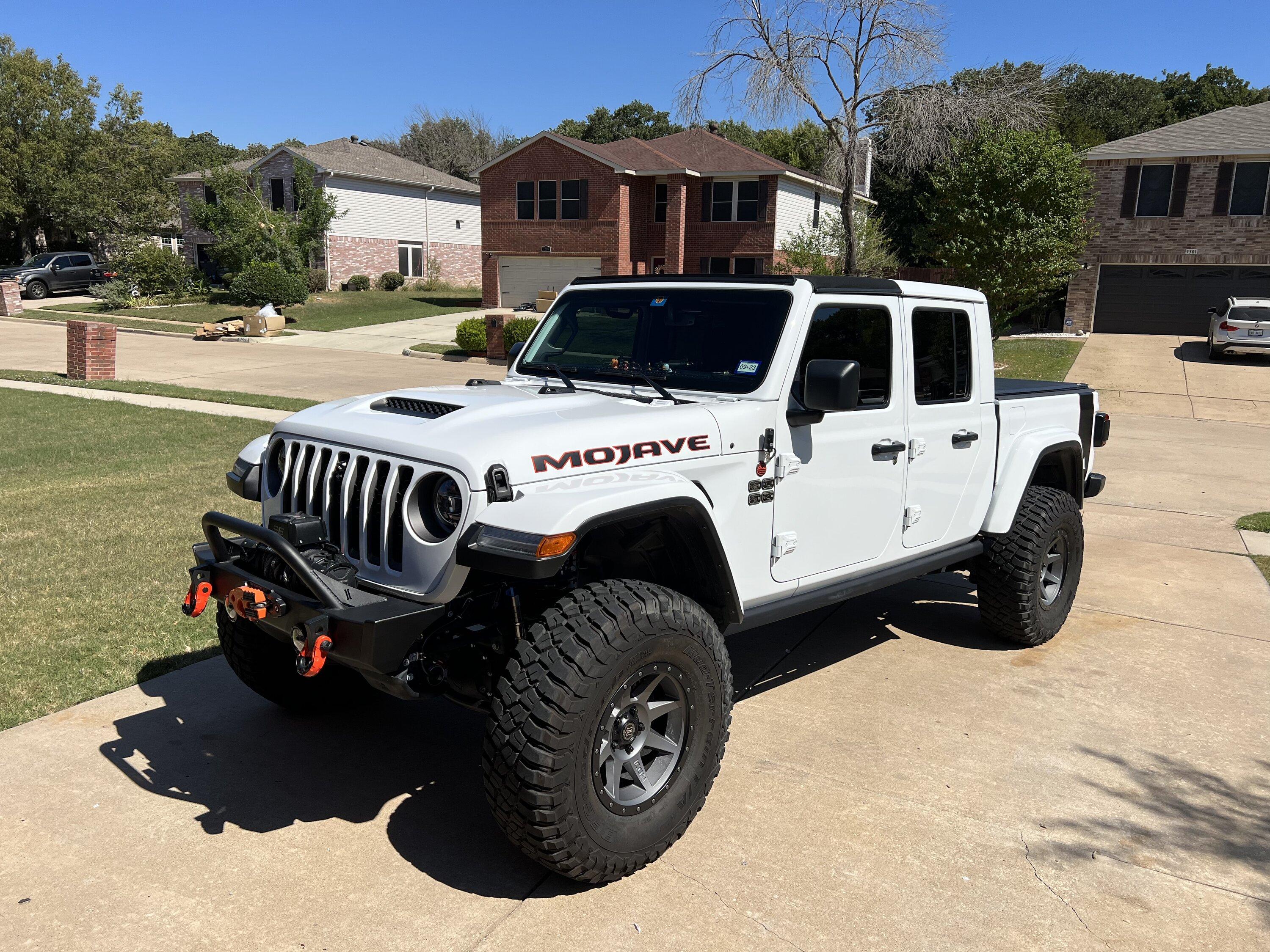

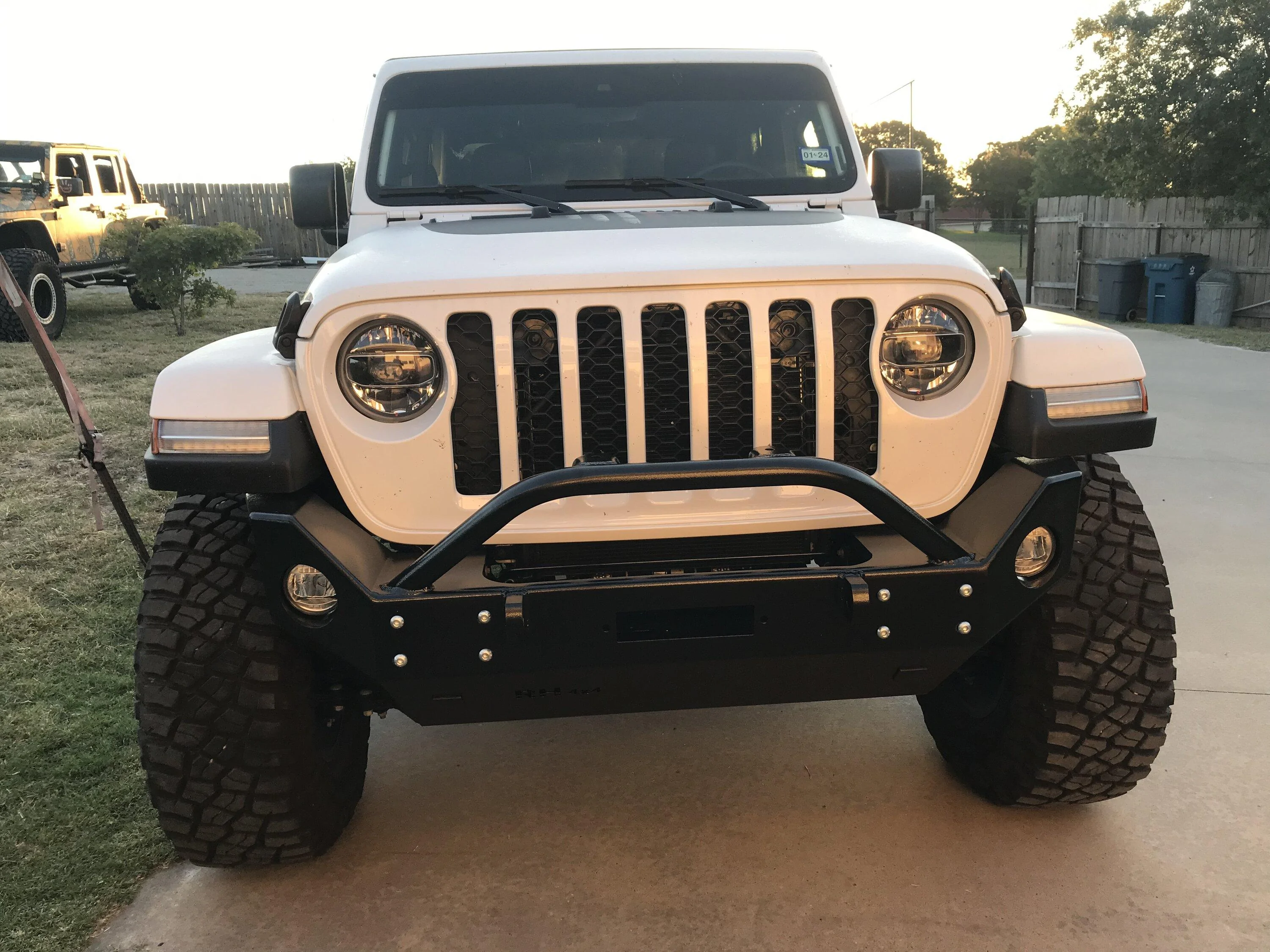

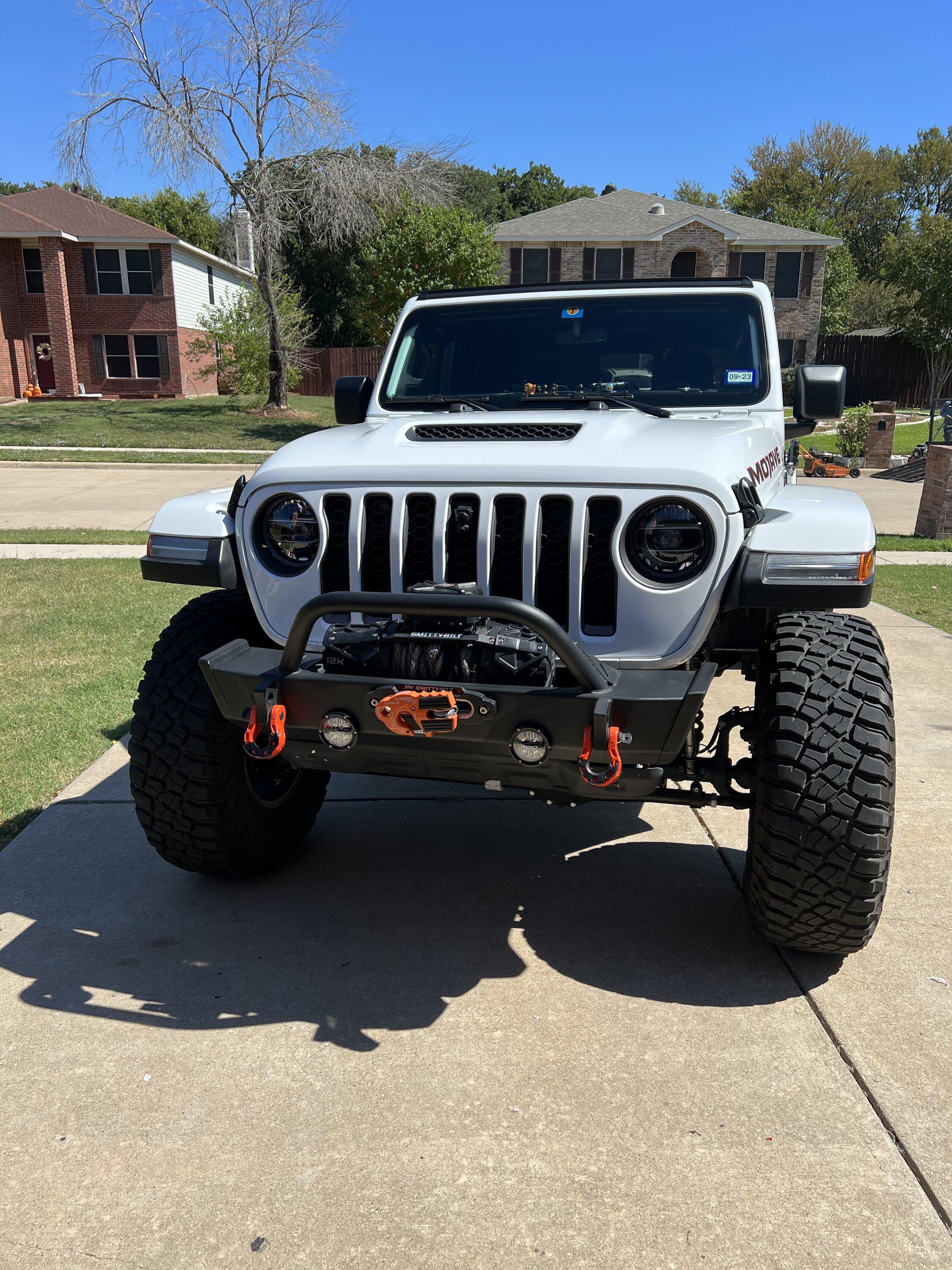

Installed front bumper yesterday and wired up fog lights this morning
Rockhard Mid Aluminum

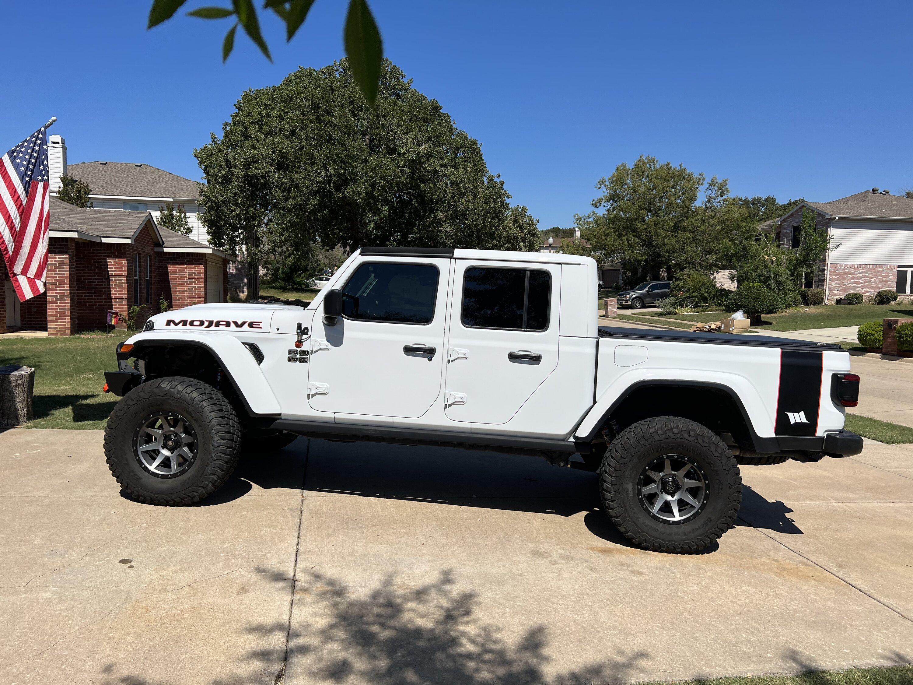

polarisTXguy
Aug 10, 2021
122
377
Denton, TX
Gladiator Mojave, F350, Boss 302, Mini, Ram1500
Polaris Industires

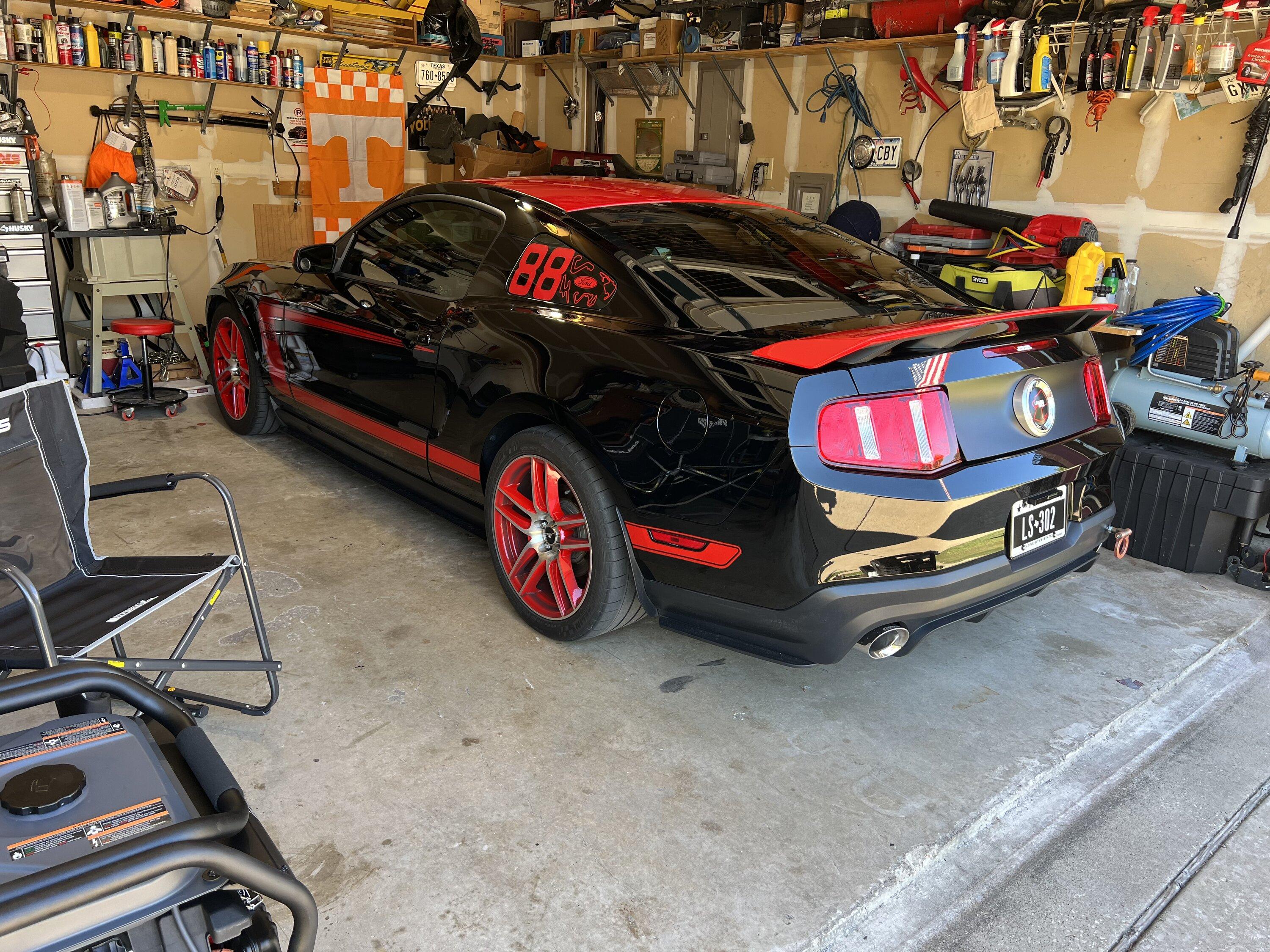

Full detail in and Out over Saturday & Sunday! Clay bar and Ceramic coating. Also washed the other toy.
Plus oil change, front and rear diffs yes I am a fluid maintenance fanatic.
Now to go for a drive ?
Jeep Gladiator What did you do TO your Gladiator today? [ADMIN WARNING: NO POLITICS, NO GUN TALK] 0AD99EA3-C021-4EE1-98FE-E869C30CCC5B
Jeep Gladiator What did you do TO your Gladiator today? [ADMIN WARNING: NO POLITICS, NO GUN TALK] DA34A0C2-8DB7-4908-91CB-8DAE47877EF8
Jeep Gladiator What did you do TO your Gladiator today? [ADMIN WARNING: NO POLITICS, NO GUN TALK] 4D8930F0-D3CA-4A51-822B-9EF180553BA0
Jeep Gladiator What did you do TO your Gladiator today? [ADMIN WARNING: NO POLITICS, NO GUN TALK] D94E47CD-8635-4962-A757-2BA82DDE59B5
Jeep Gladiator What did you do TO your Gladiator today? [ADMIN WARNING: NO POLITICS, NO GUN TALK] B044B97F-E1C9-4306-93ED-38C43BA610FA

What front bumper do you have?
