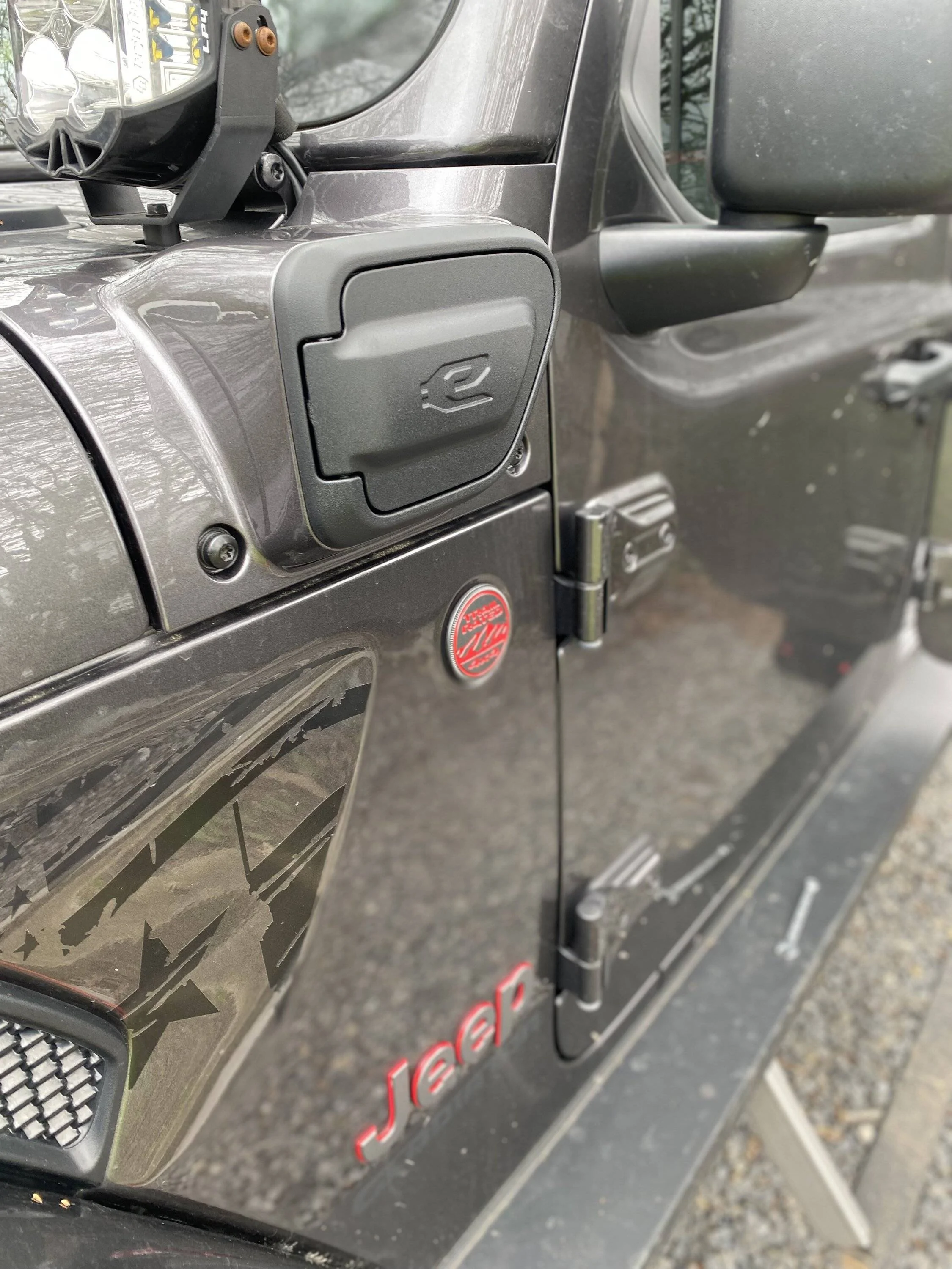

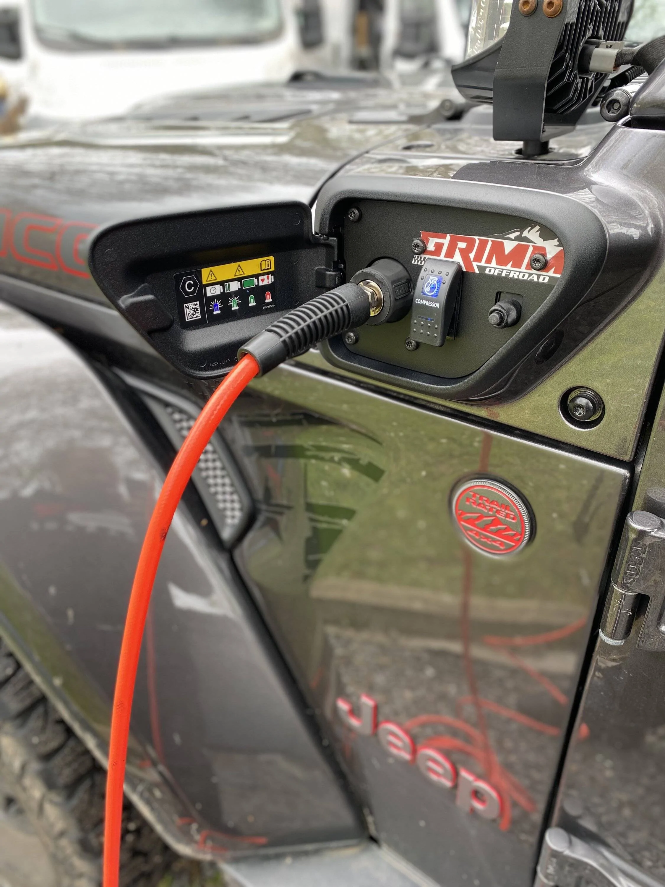

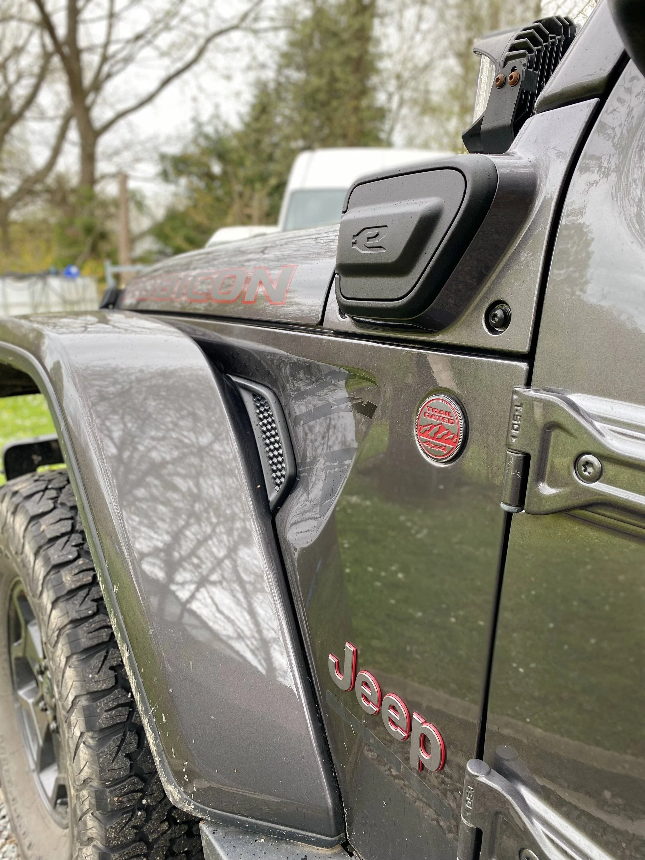

finally got everything to add this epic mod. one of the clever mods I did tbh ...
https://www.grimmoffroad.com/Jeep-W...arge-Port-Air-Chuck-Conversion-Kit_p_138.html
Installing the charge port air chuck from Grimm Offroad.
Super nice product . 99% perfectly plug and play ... I have to add 2 spacers behind to have a smooth open and close door.
The only mod I did is to paint the mopar part. wasn't sur to be super happy with all in full black then I just kept the door in OEM textured black .
this and the compressor bracket behind the fender is absolute nice.
Super happy with the result .
don't know if they follow the forum, but I would like to salute the amazing Grimm Offroad customer service.
PS: Don't kill me for the rusty bolts on the A Pillar brackets ... those fucking cheap amazon Chinese bolts doesn't like the salt used on our road. I changed it today for new one waiting to receive some nice anodized bolts (not from amazon this time ;))

I think that method of using the part - and making a convenient place to connect and operate a compressor is really neat, great idea, looks so factory.
But I wonder about the future - how will we 4xe owners do such a thing LOL.
MAYBE a company will make one for the right side so the compressor ports could be on the right and the charging port left on the left side.
I thought - this would be great for my JT - won't work for our Wrangler, though Bummer, because I think it's a perfect solution and looks so clean and factory.
Nice.

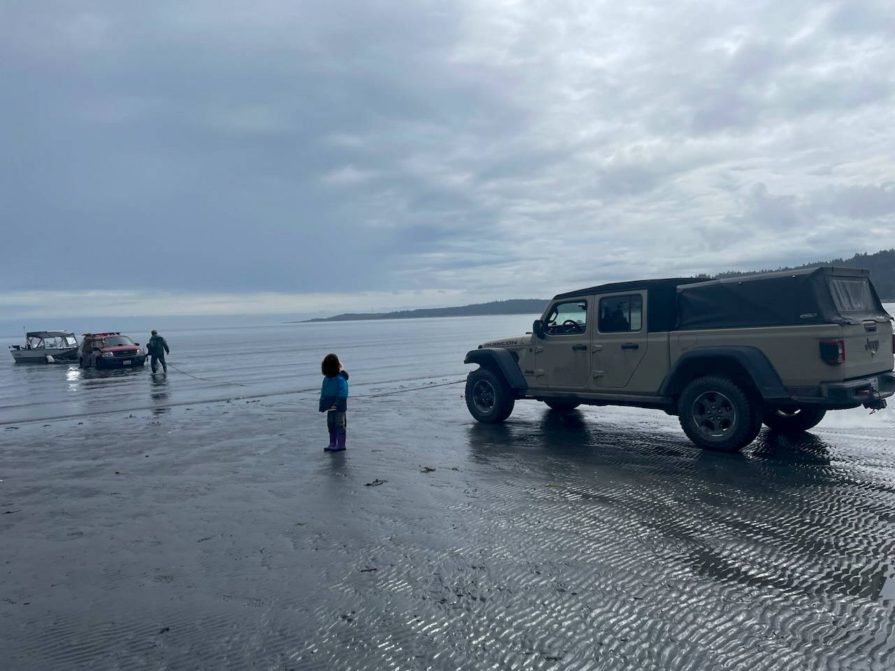

Down at the beach, we were heading back to the parking area when I saw two blokes struggling with a boat and truck. The tide was coming in fast and caught them unawares, water up to front hubs and I could see they were stuck. One starts running for the parking lot, maybe cause it's the only place with some sort of cell signal.
I offered a winch which they jumped on and was able to get them out in a jiffy. The camera skews perspective so it's hard to tell but unless they had an especially long tow strap I would have had to put my wheels in the water to pull them out.
Easy peasy except they couldn't find their tow point. Bonus points - the better half is now convinced of the merit of the winch.
Nice.
I think ( but I never saw the hidden side of the 4XE with electric wires and plug) it’s possible to adapt this for a 4XE . With some tiny mods . A air coupling isn’t a big thing … what takes the biggest place is the switch . So I’m pretty sure it won’t be a problem to create a plate with the big hole for the charging plug and another tiny hole for the air connector …. I checked to right hand drive market and apparently they don’t even have 4XE line up … only available engine in UK is 2.0 and South Africa nothing about hybrid . I thought they could eventually have the plug in door on the other side … as well it could be nice to adapt but … nothing .
I guess the new inboard system present on the Rubicon 20th anniversary will be a valid option as soon as those parts are available on the market …
