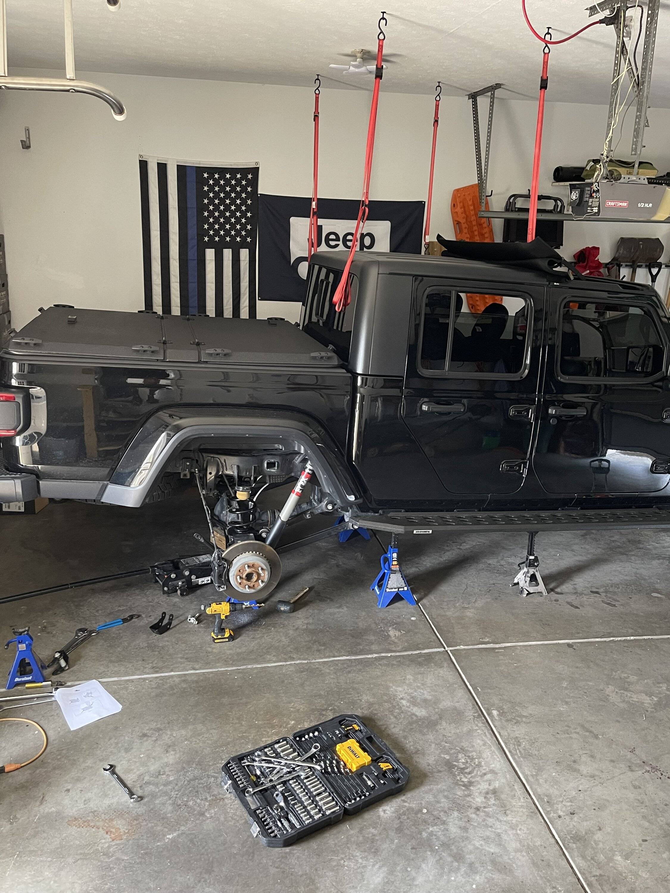

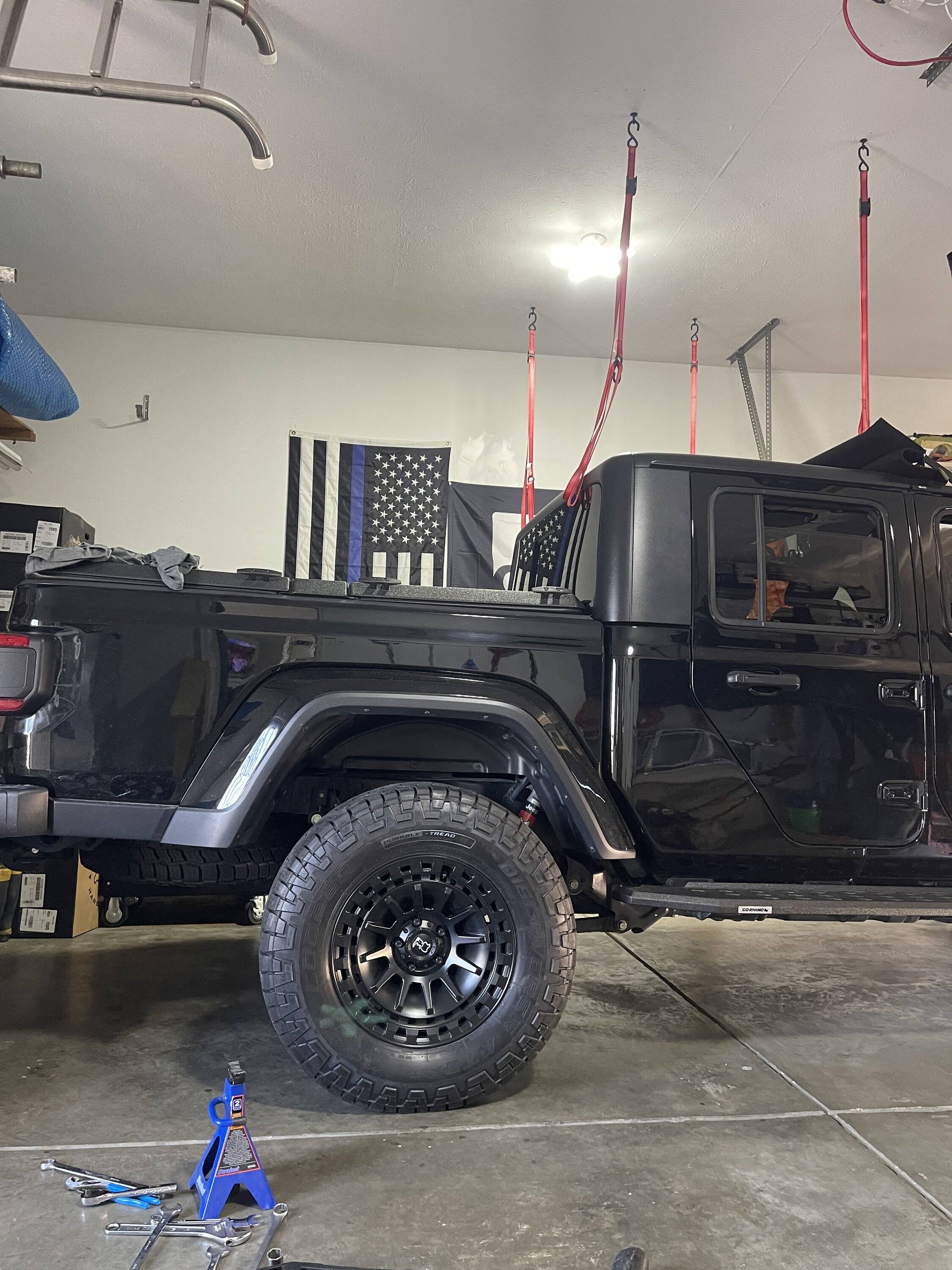

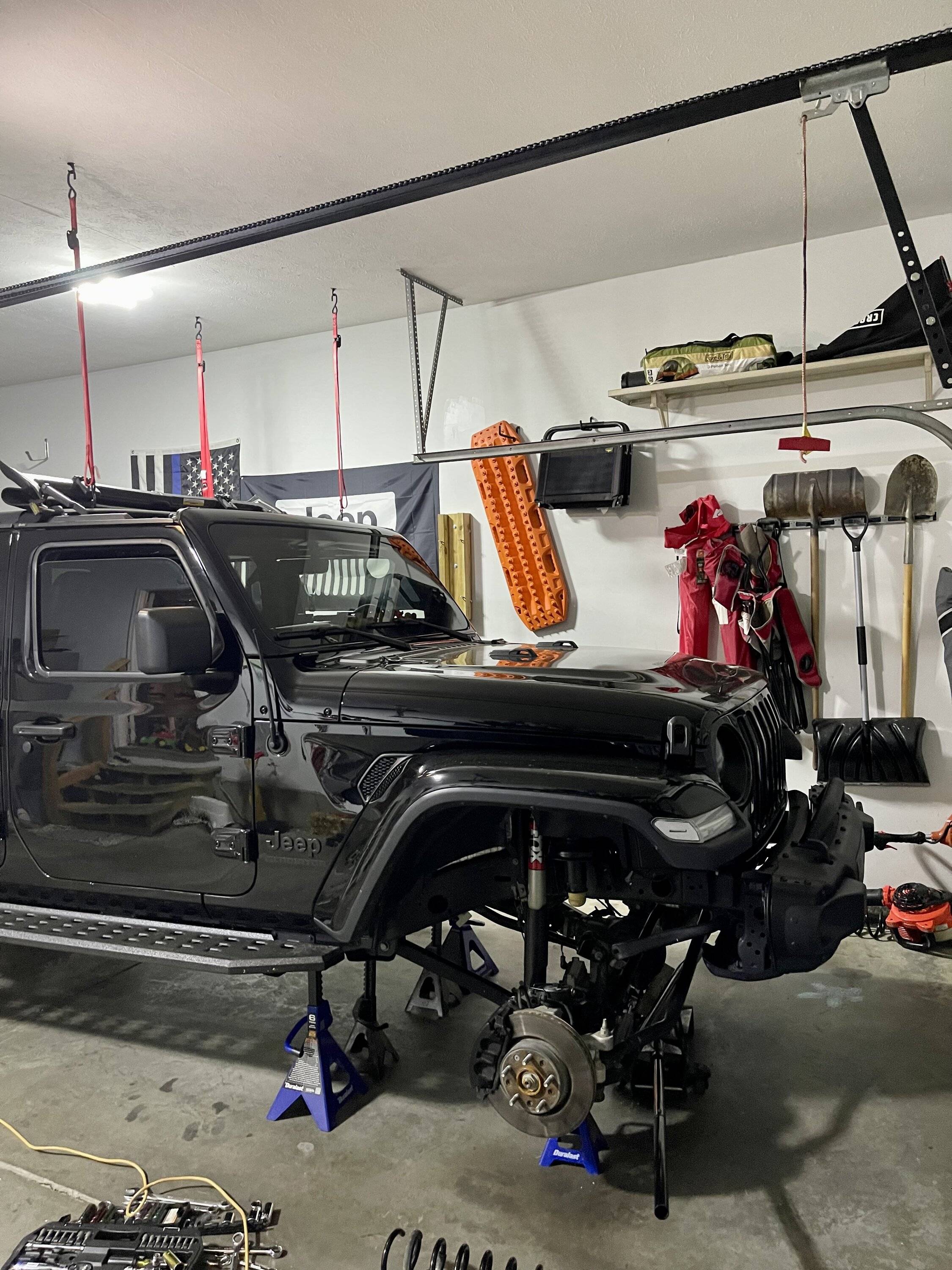

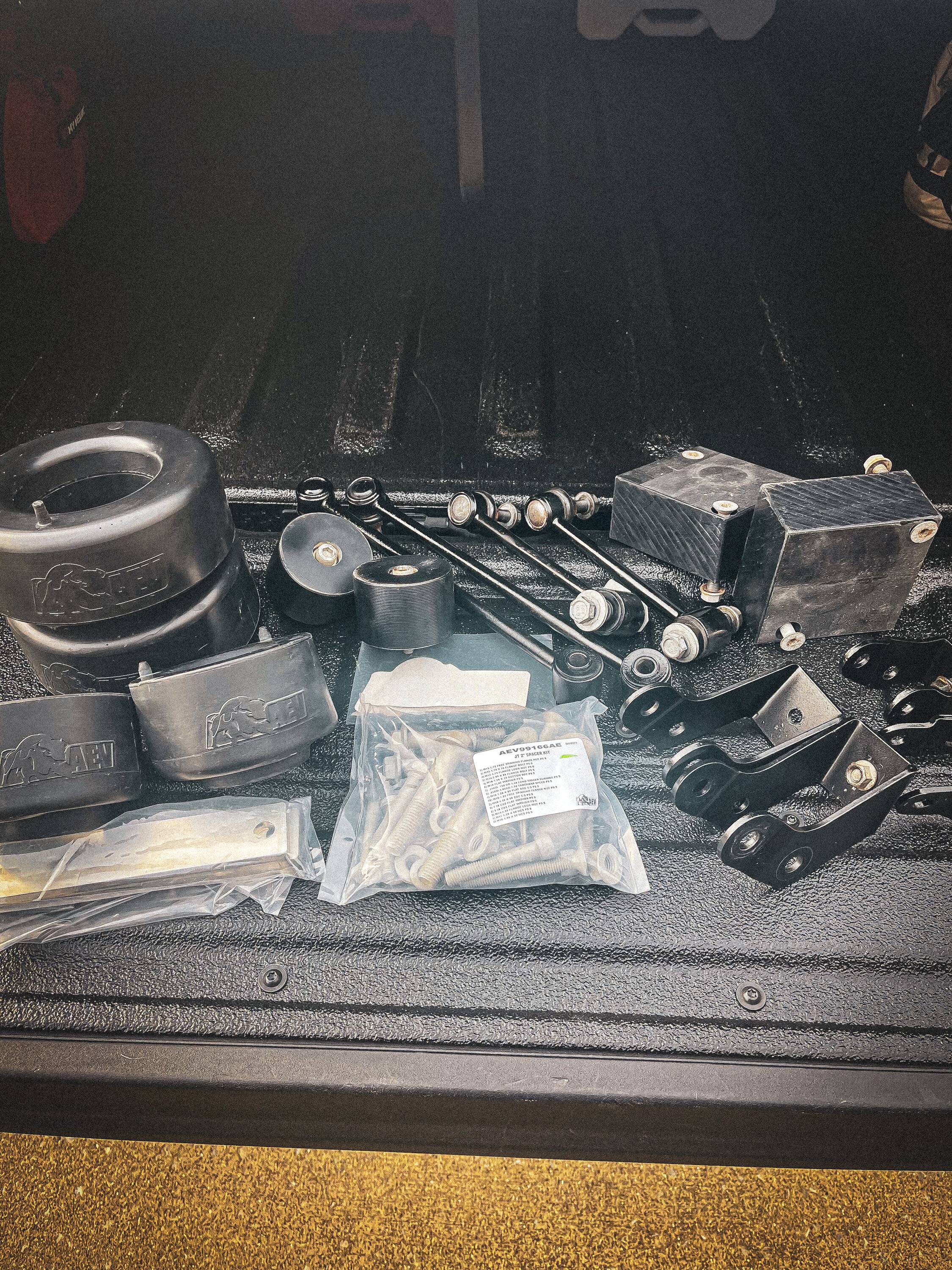

Finally got around to installing my AEV 2" Spacer lift
clever how you suspended your JT from tHe ceiling using ratchet straps while working on the lift install… LOL!
haha kinda does look like that huh. Wish it were that easy.

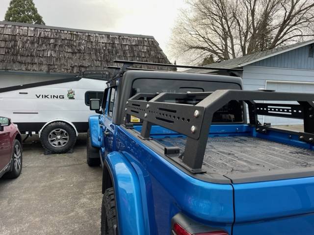

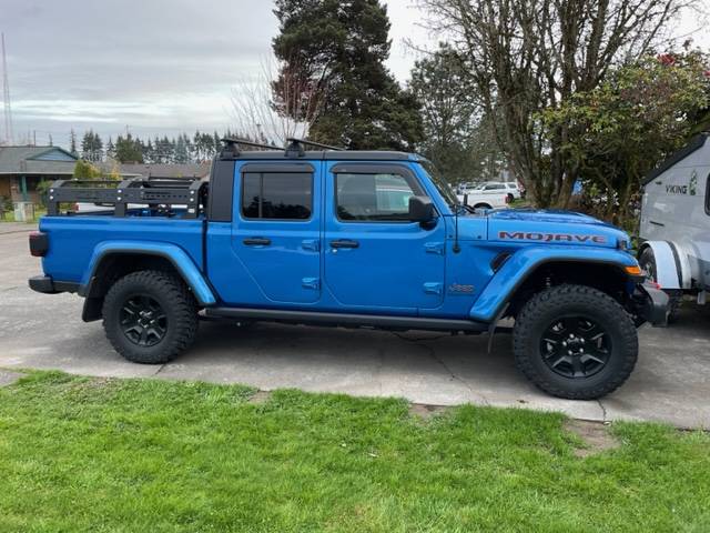

Since we finally had a dry day I continued installing some things!!!

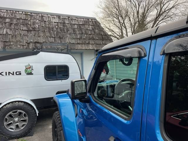

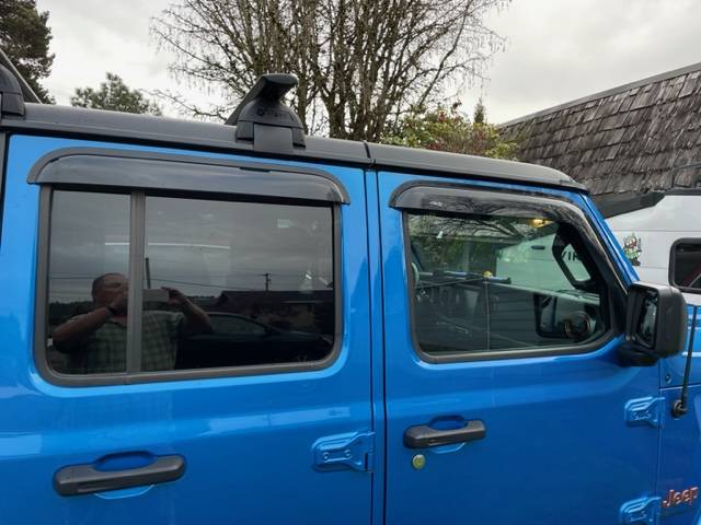

Month ago AVS for windows, these are awesome they really help keep the road spray off the side windows and side mirrors.

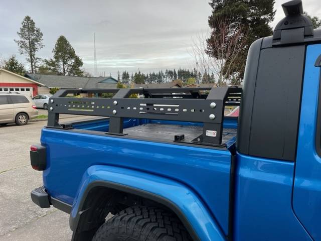

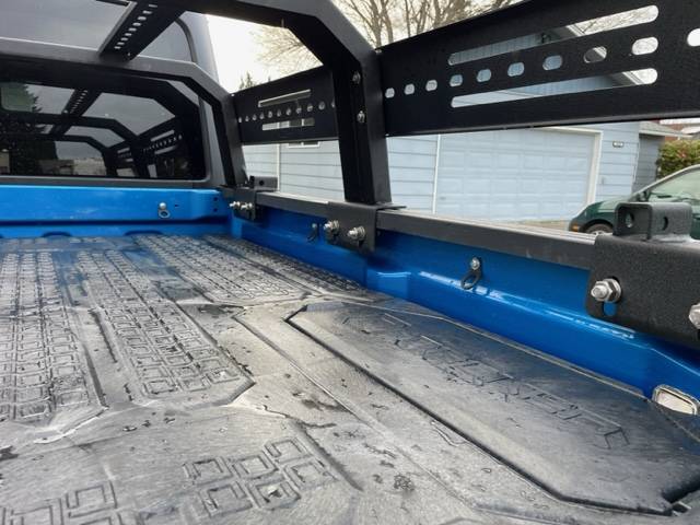

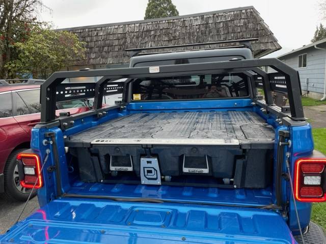

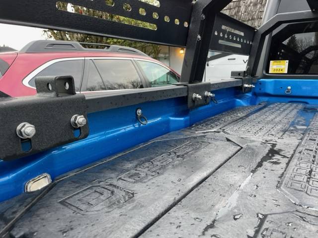

Today, Fishbone bed rack to compliment the Decked system.
Today, Tie hooks installed into the bolt mounting holes for trail rail system.
Next DIY seat delete.
Getting excited to begin our summer overlanding trips.

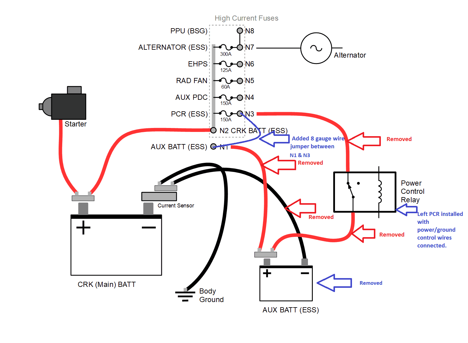

Any lights on dash after deleting?
been considering it.
do you have a link for the how to?
No lights. There has been few threads on the subject. You have to search those out. There is a couple of methods but doing the full wire delete is the more tougher of them. There is no "A to Z" instruction sets. You just have to follow some common sense and dive into it and be mechanically inclined and not afraid. The method I used involved having to remove the fuse box, battery tray and air box to get access to the wiring for removal. Plus you need to fabricate a heavy gauge jumper to go between N1 and N3. Only difference I made from the diagram below is I ran the ground cable that went to the aux battery negative to a body ground rather than removed it as it saved me the hassle of having to hack it off the "current" sensor.
Below is a link I used to get a 6 gauge jumper cable made with 1/4" eyelet terminals installed. Cost me less than $10 to get made and delivered.
https://www.batterycablesusa.com/

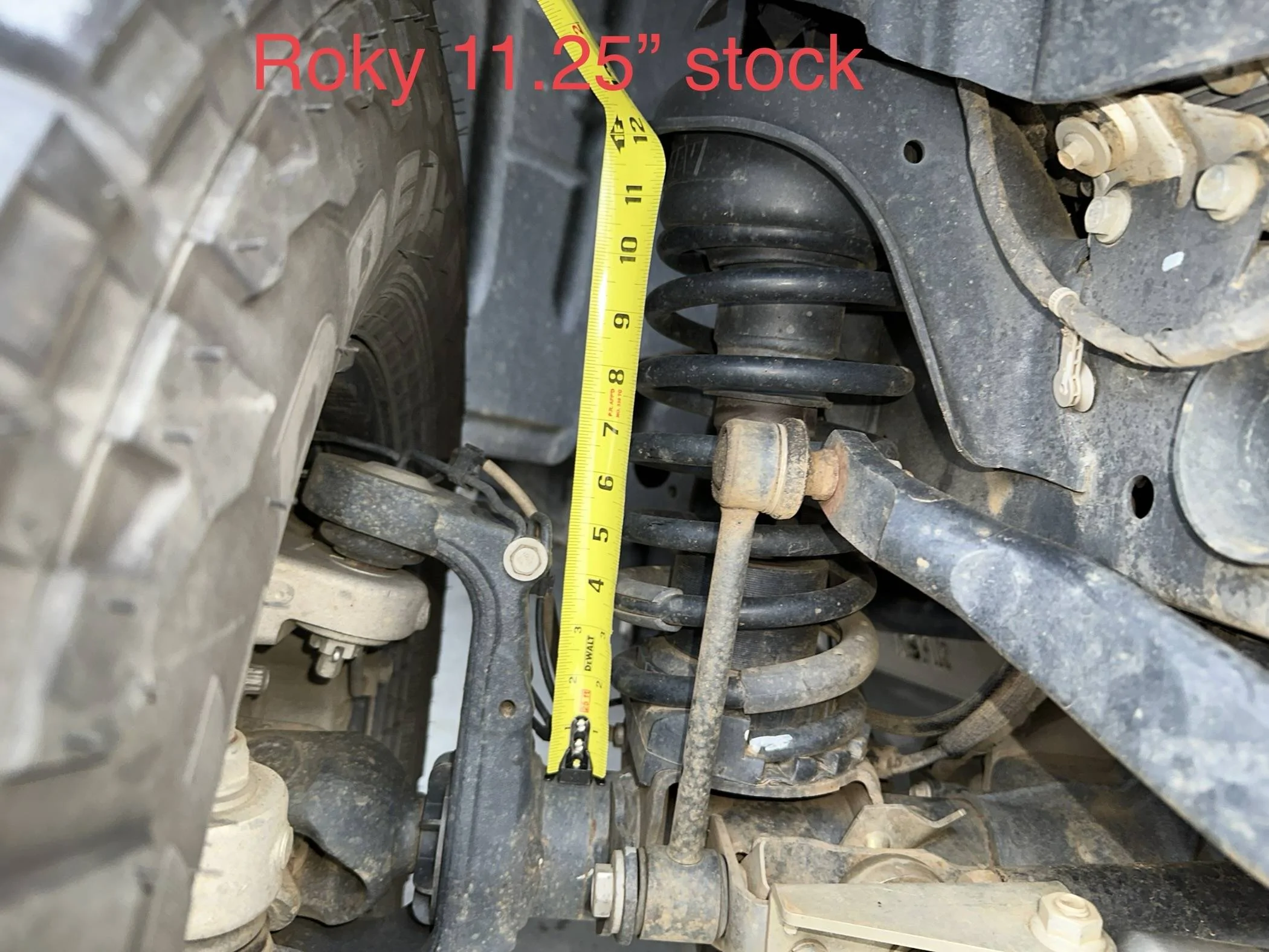

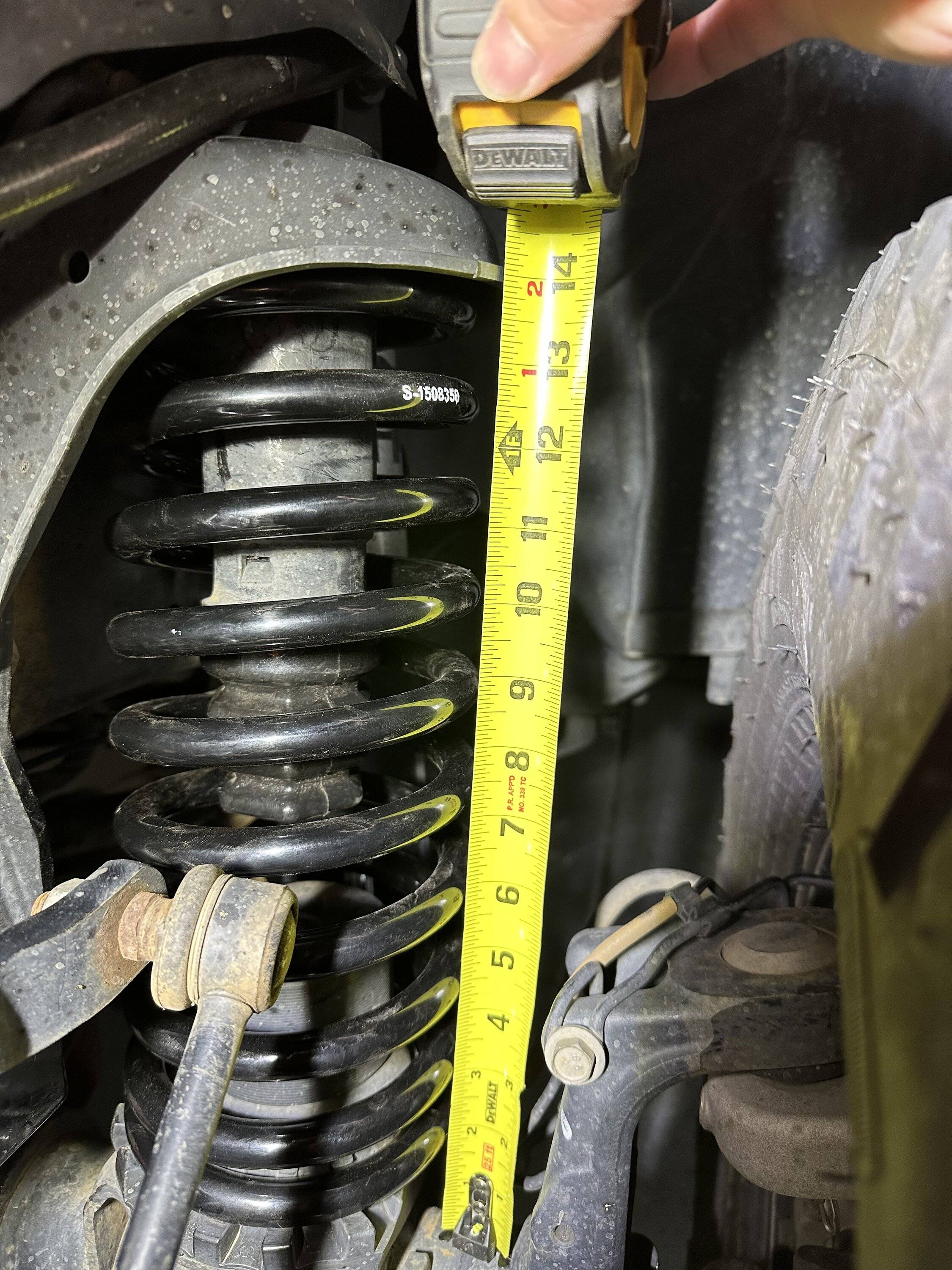

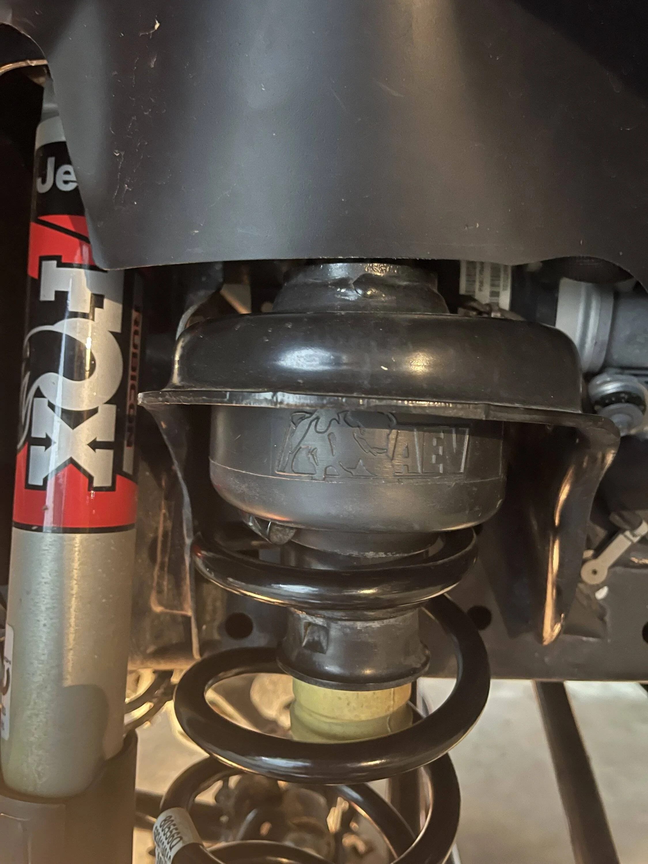

Stock springs with spacers 20.5” to Clayton ~22” (21.625 +\- .25)
I think I gained ~2.5” over my OEM Rubicon springs with 2” AEV spacers. I’ve gotten too heavy and I only had ~2” between the bumps stops and the pads, which is why I got the Clayton springs. Otherwise I had been content with the spacer lift.
Now
I think the pinion angle looks pretty good to me (I have a carrier bearing spacer from my spacer lift).
now to find a day to put the front Clayton springs in.:puke:
Took some time to throw the front 2.5” springs in, though I didn’t quite finish before had to reassemble and pick the kids up.

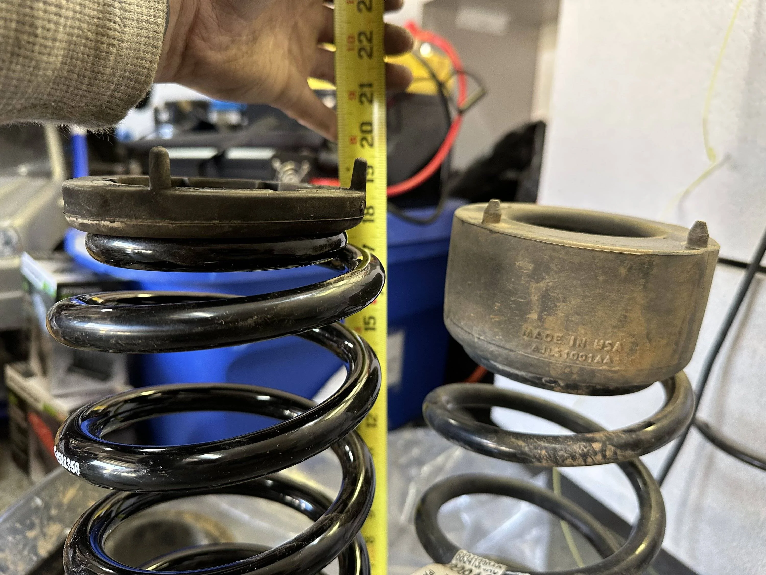

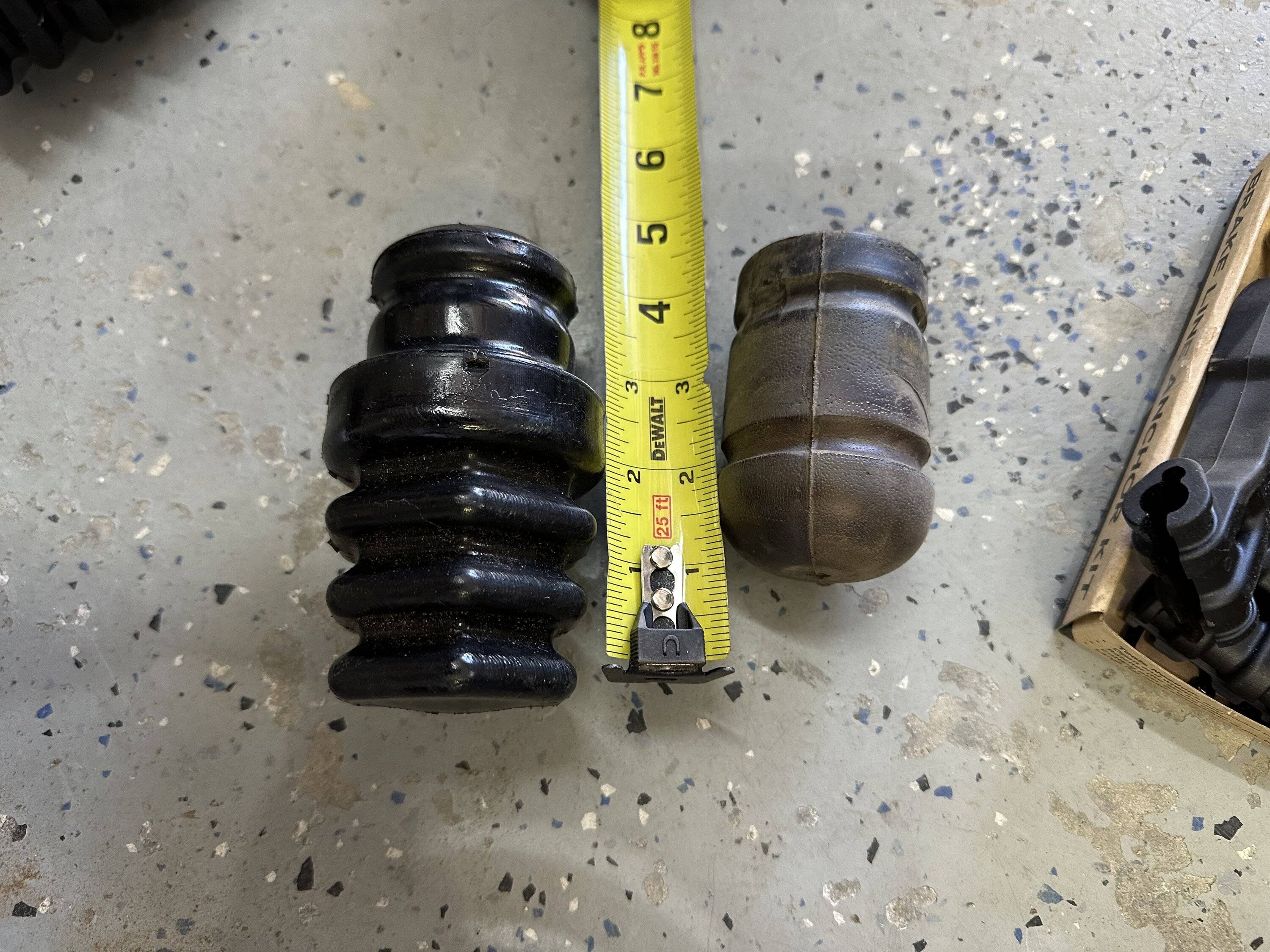

Clayton 2.5” (~19.375”) compared to OEM with AEV spacer
Jeep Gladiator What did you do TO your Gladiator today? [ADMIN WARNING: NO POLITICS, NO GUN TALK] IMG_3048
Metalcloak durospring bump stops about 1” longer… though I’m not sure if they add an inch or are they supposed to compress to the same length?
Jeep Gladiator What did you do TO your Gladiator today? [ADMIN WARNING: NO POLITICS, NO GUN TALK] IMG_3047

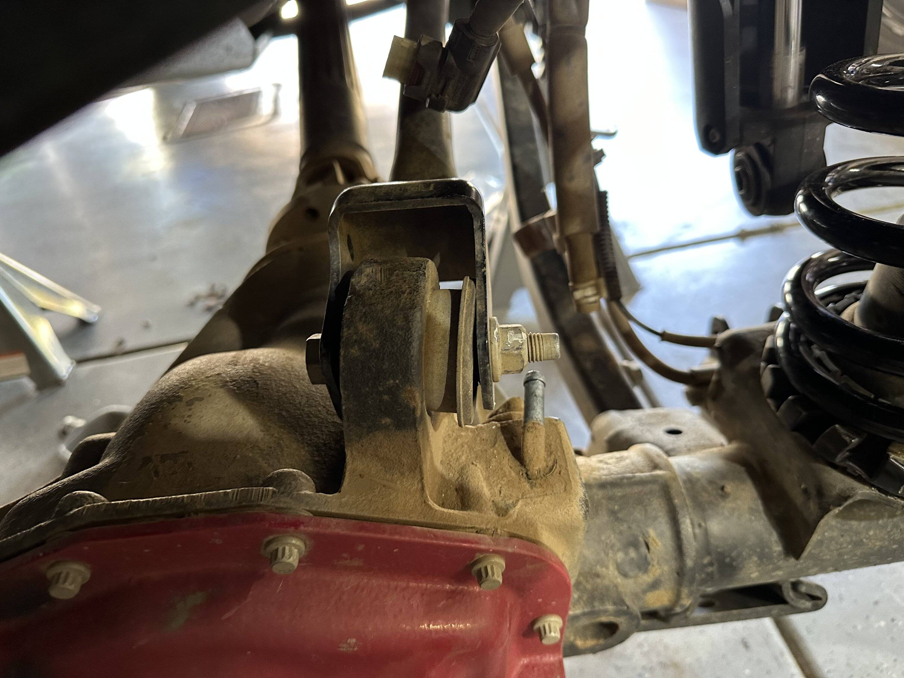

Jacking up/dropping the axle with the track bar attached led to the axle pulling so far driver that it pulled the left upper control arm bushing half way out! Think next project will be putting in the RockJock JJ bushings and some other control arms.
Jeep Gladiator What did you do TO your Gladiator today? [ADMIN WARNING: NO POLITICS, NO GUN TALK] IMG_3049
I’m a little confused because by the coil bucket measurements I gained 2”, but there was about the same gap between the bump stop with the 1” longer durospring so I would’ve thought it was only 1”… can’t ignore the coil spring measurement though.

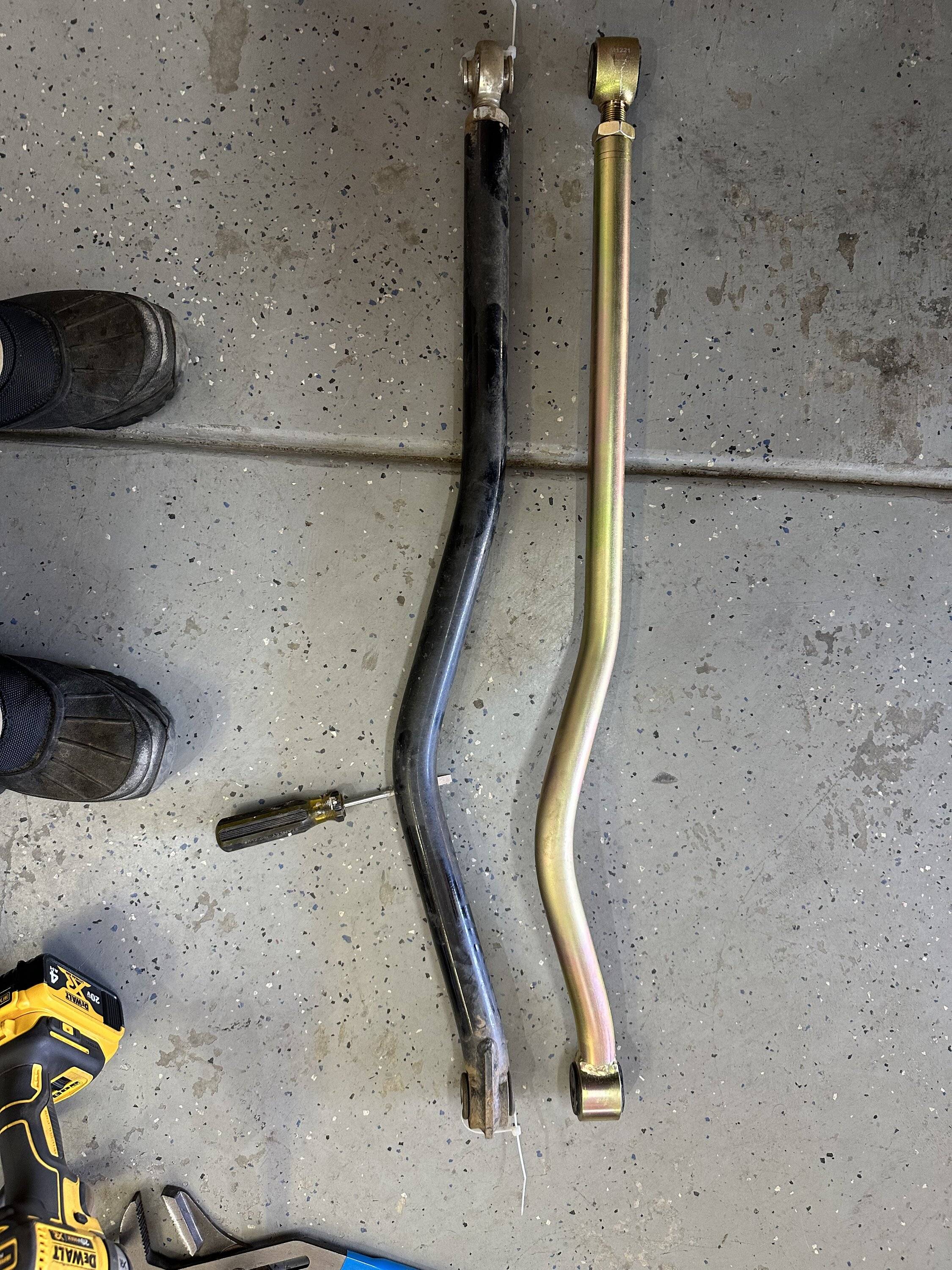

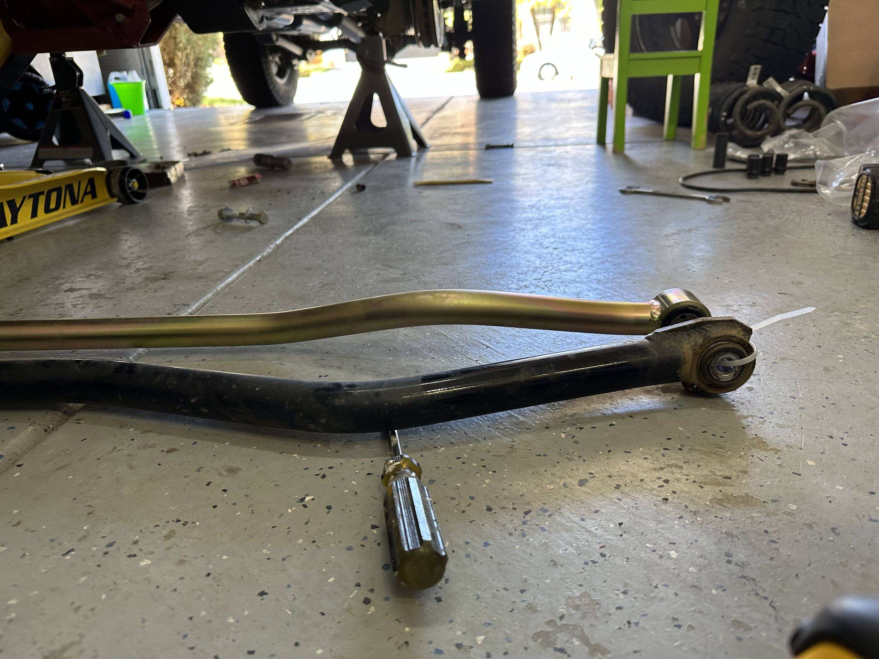

On a related note, I was waiting to do this to swap out track bars to see if that helps clear my AEV stabilizer, has been hitting either Rock Krawler track bar or drag link depending on placement.
Well, I didn’t finish grinding out the track bar bracket to fit the Metalcloak Bar:angry:
So I’ll have to find another day to do that when I can make noise.
Side by side Rock Krawler and Metalcloak:
Jeep Gladiator What did you do TO your Gladiator today? [ADMIN WARNING: NO POLITICS, NO GUN TALK] IMG_3051
Jeep Gladiator What did you do TO your Gladiator today? [ADMIN WARNING: NO POLITICS, NO GUN TALK] IMG_3053
The diff bend is waaay more driver and up higher on the Metalcloak.

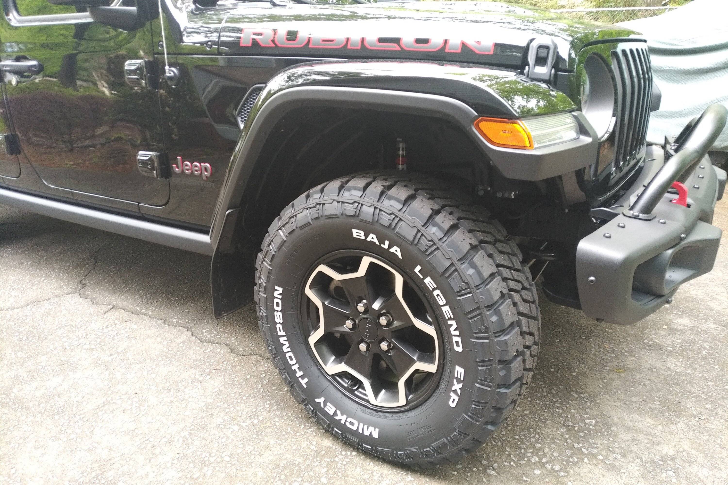

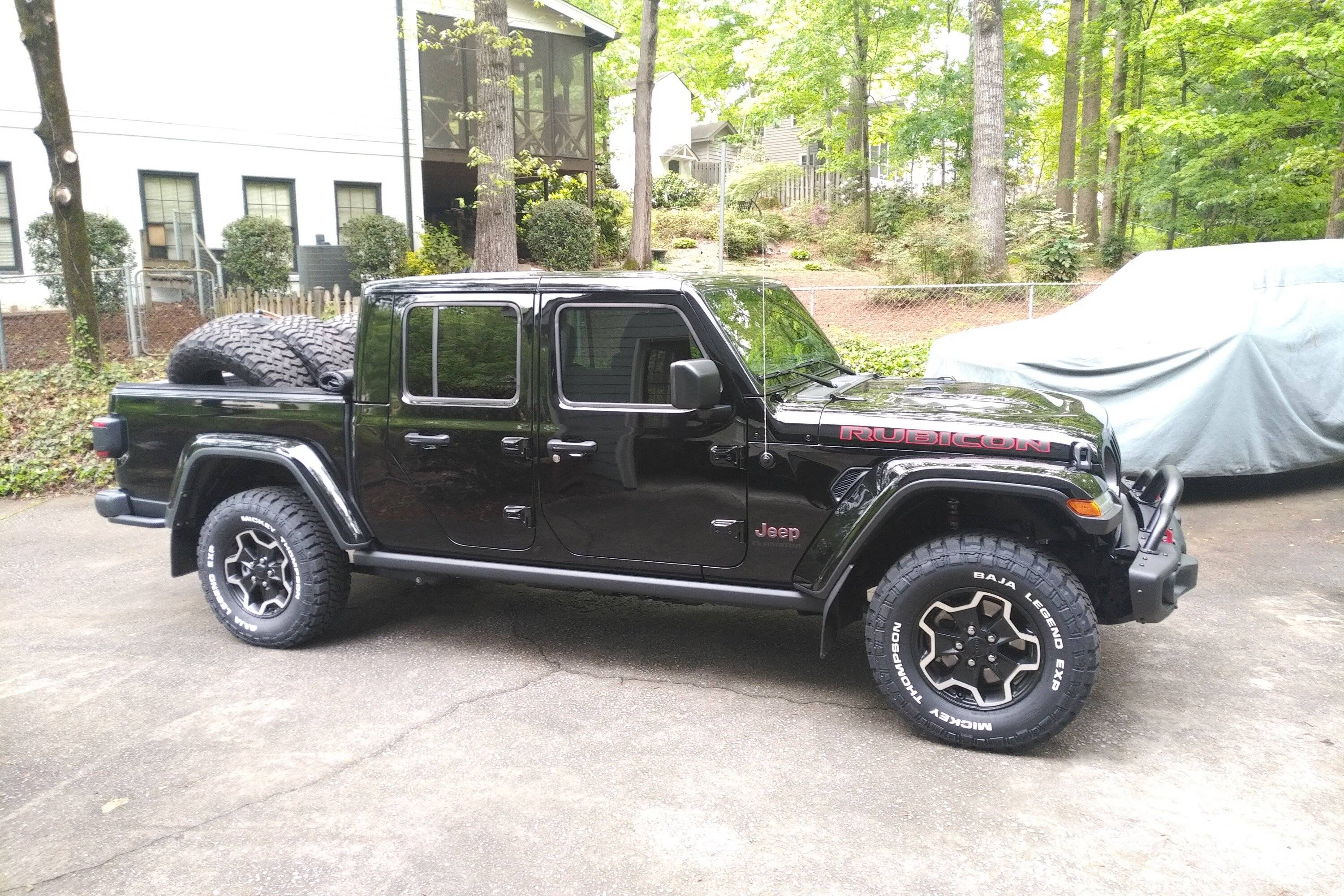

New shoes today. Dropped the Falken MTs (soon to be on the marketplace ;) ) for Mickey Baja ATs. Rides much better and I love white walls. Showing signs of getting better gas mileage too. Wussed out on going bigger as I was worried about tire poke and more spray.
