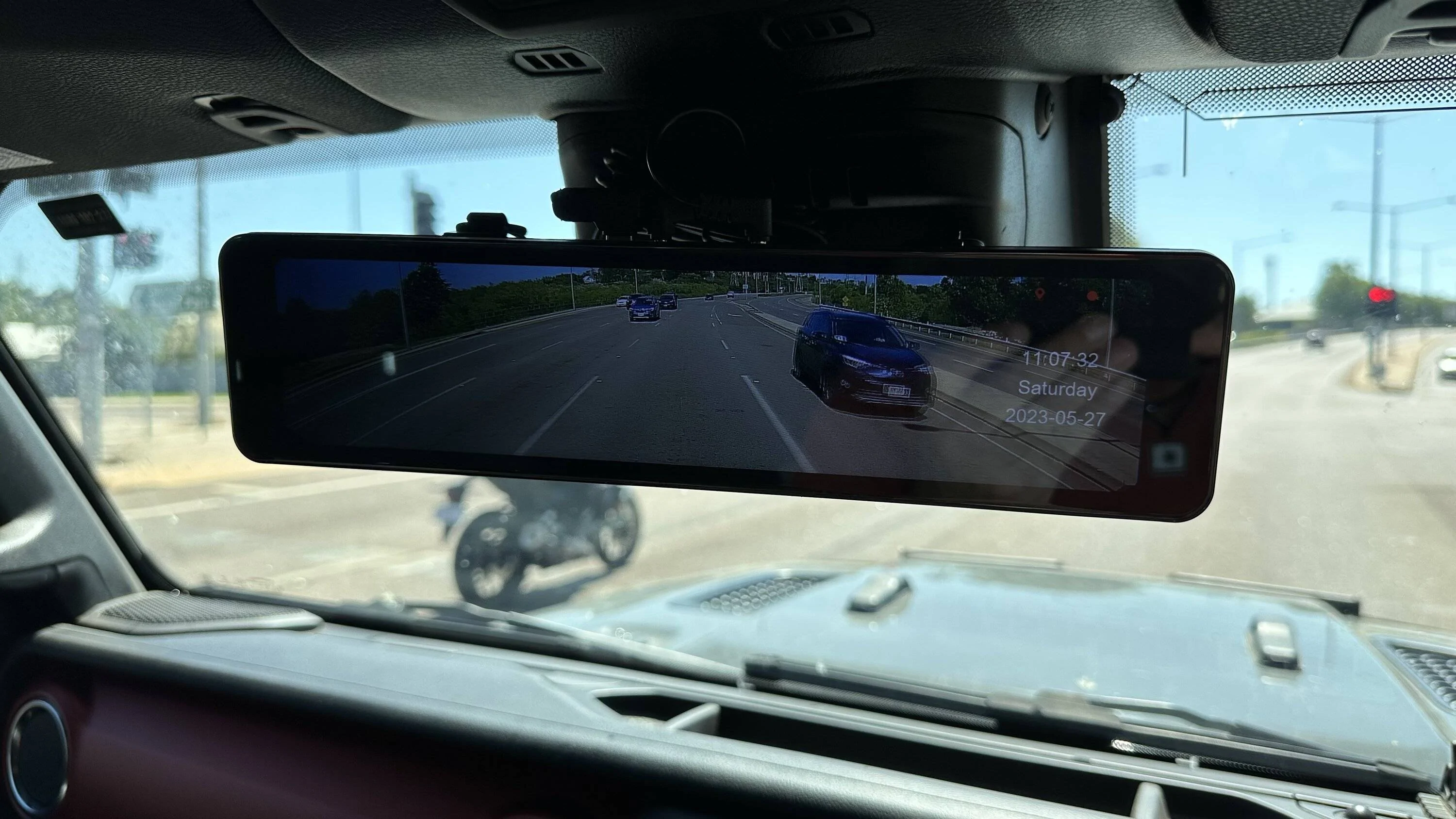

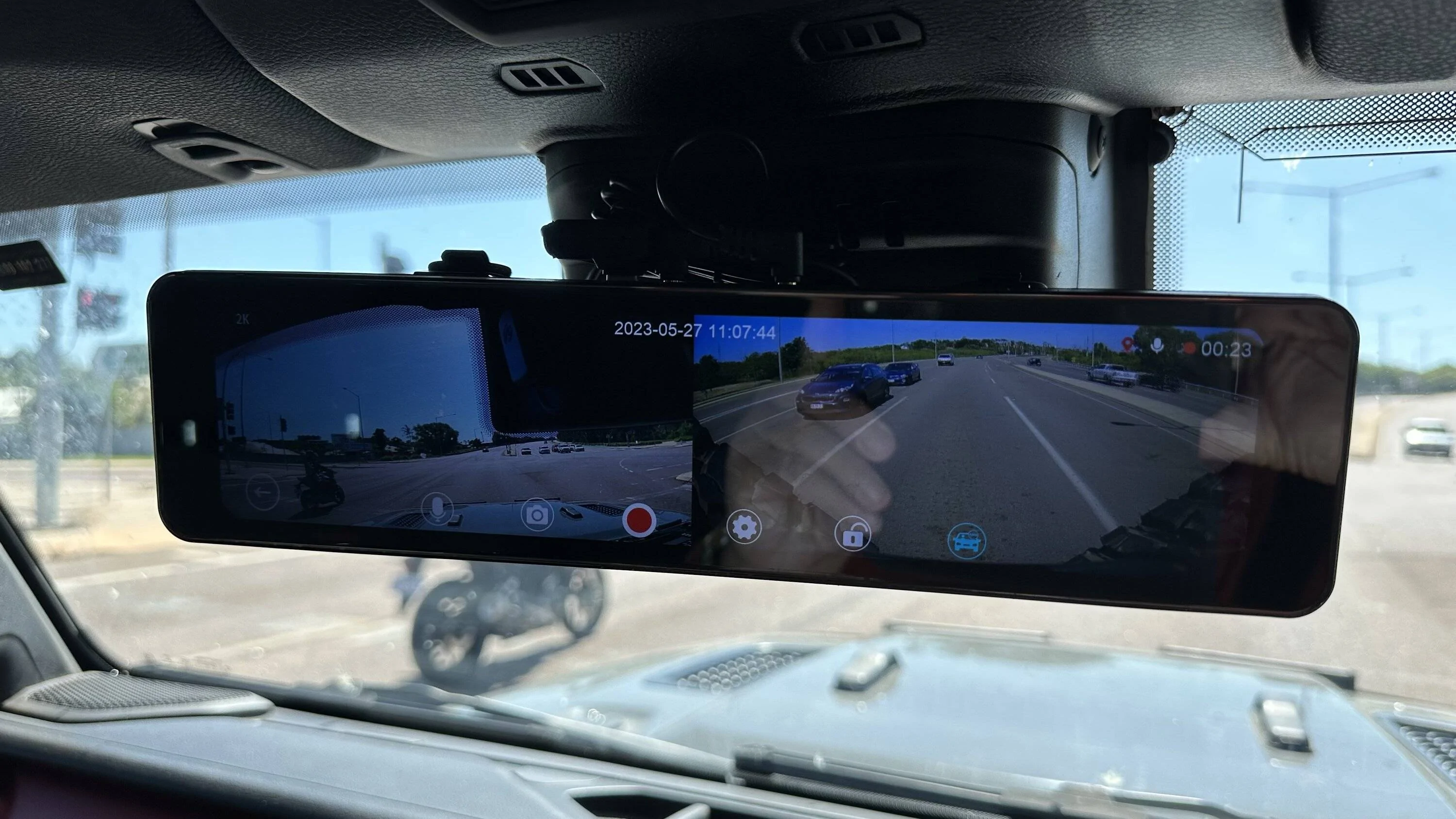

Installed a rear vision camera and electronic ā€œmirrorā€. Have installed a pod on the back of my Gladiator which replaces the tub so had zero visibility. Turns on with the ignition and as well as displaying the rear camera, it can also show the front facing one on the back of the unit, has wireless CarPlay, GPS, collision and lane departure warnings and acts as a DVR for both cameras.

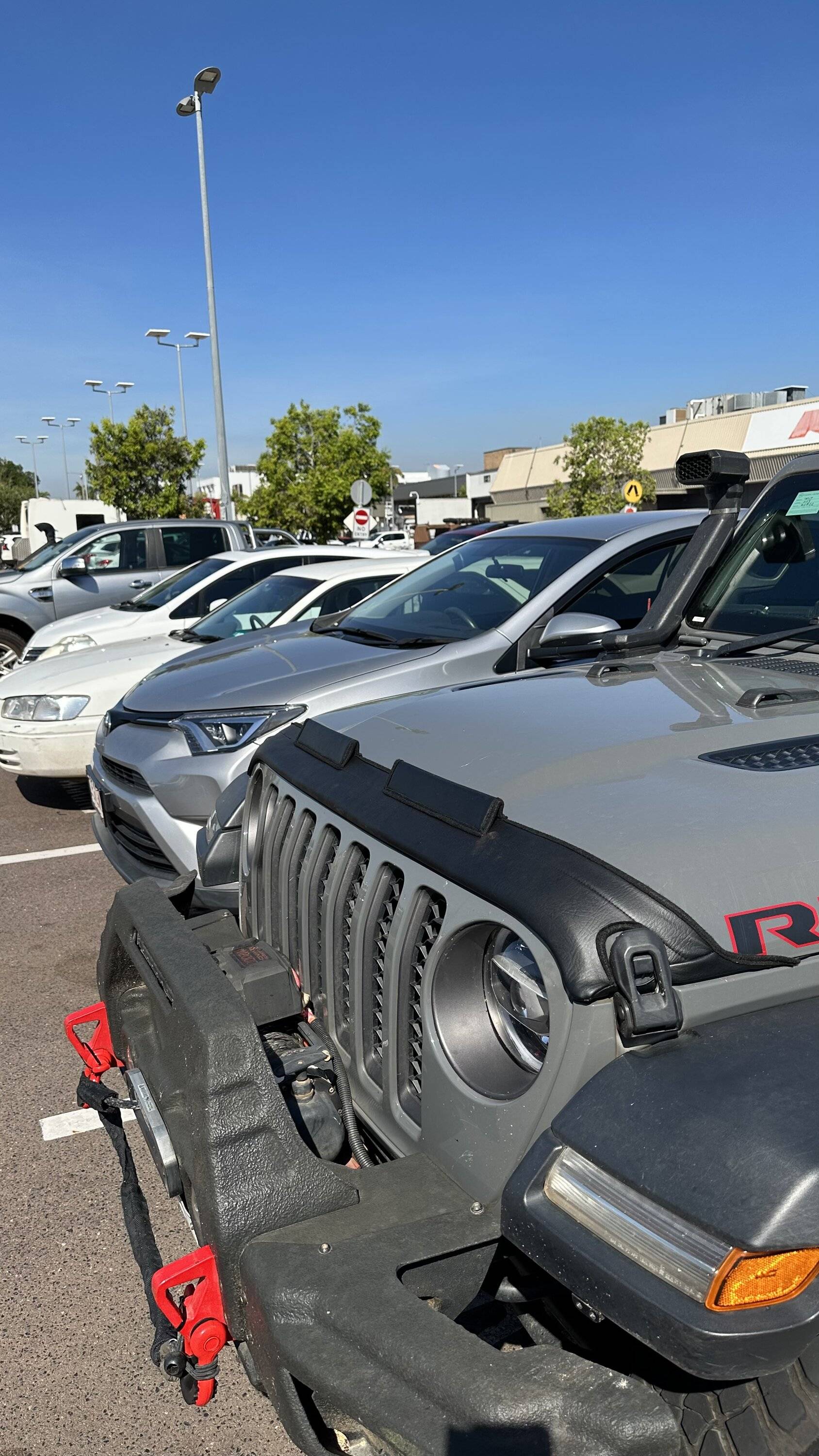

Also added a bonnet protector. Cheap item picked up online, but fits perfect and looks good.
Who makes this mirror?

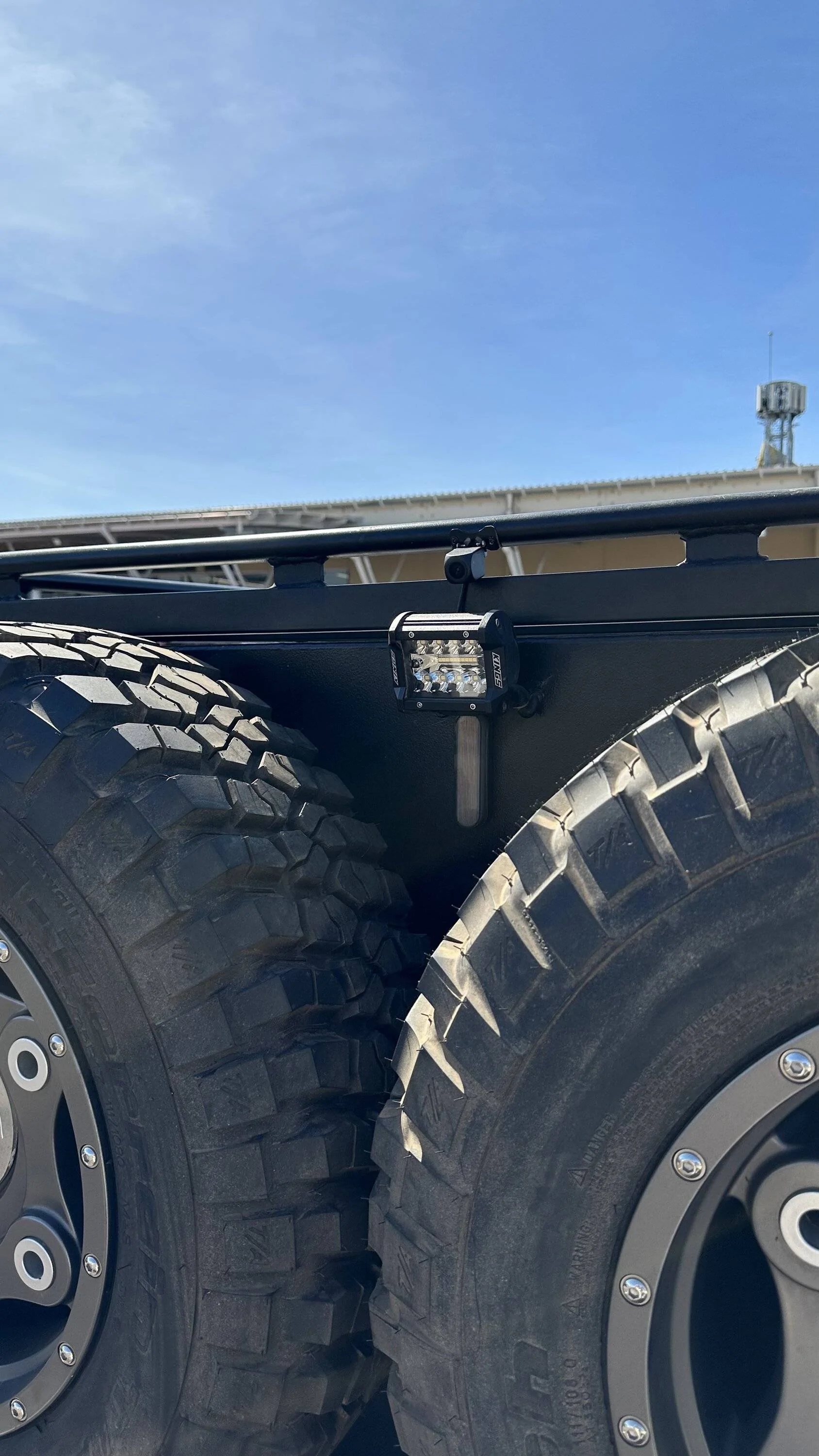

Might be the angle of the picture, does your hood scoop get in the way of the light bar? the light looks low in the picture.
Technically...the whole hood gets in the way of the light bar...well...at lleast half of it.

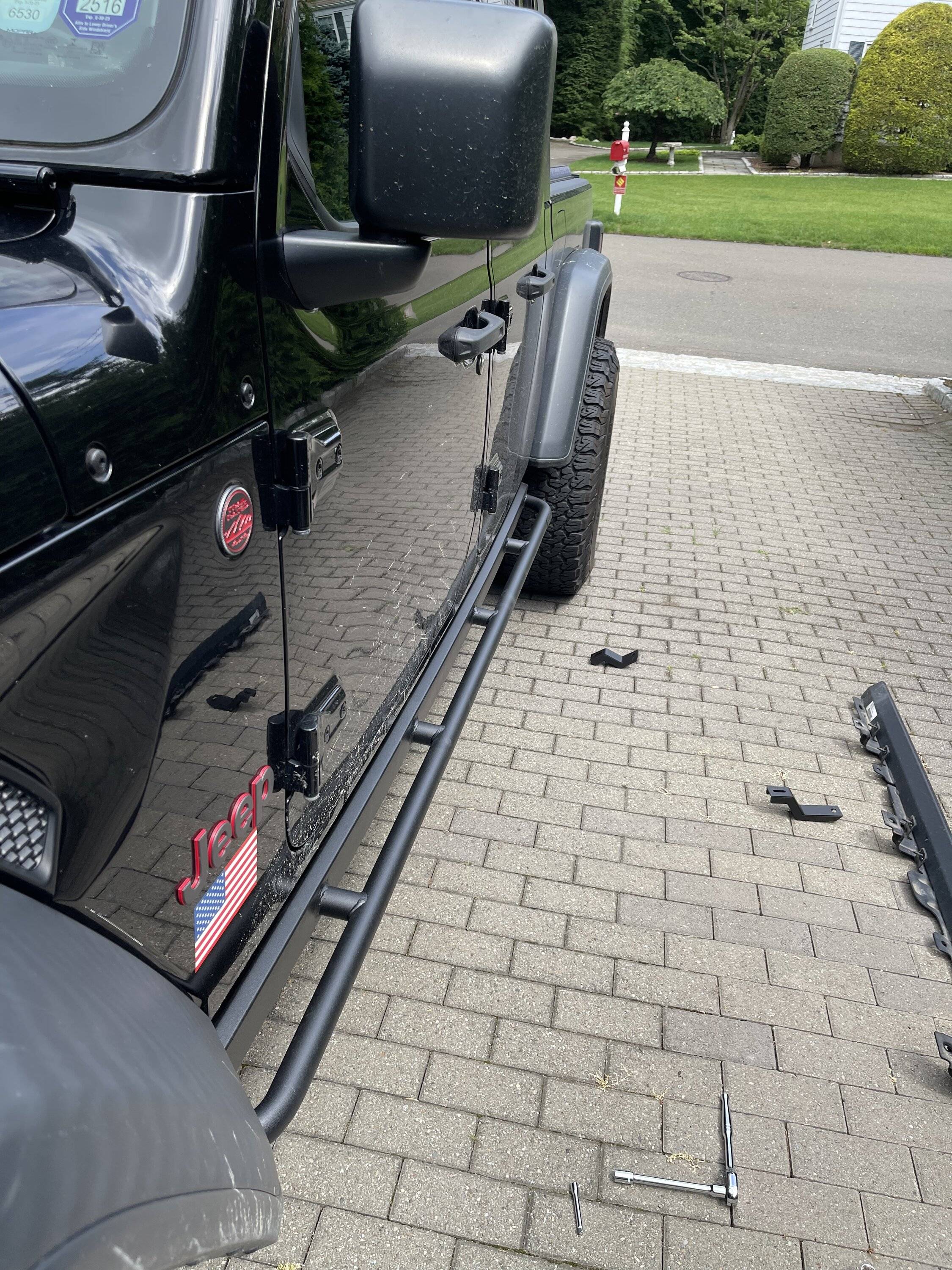

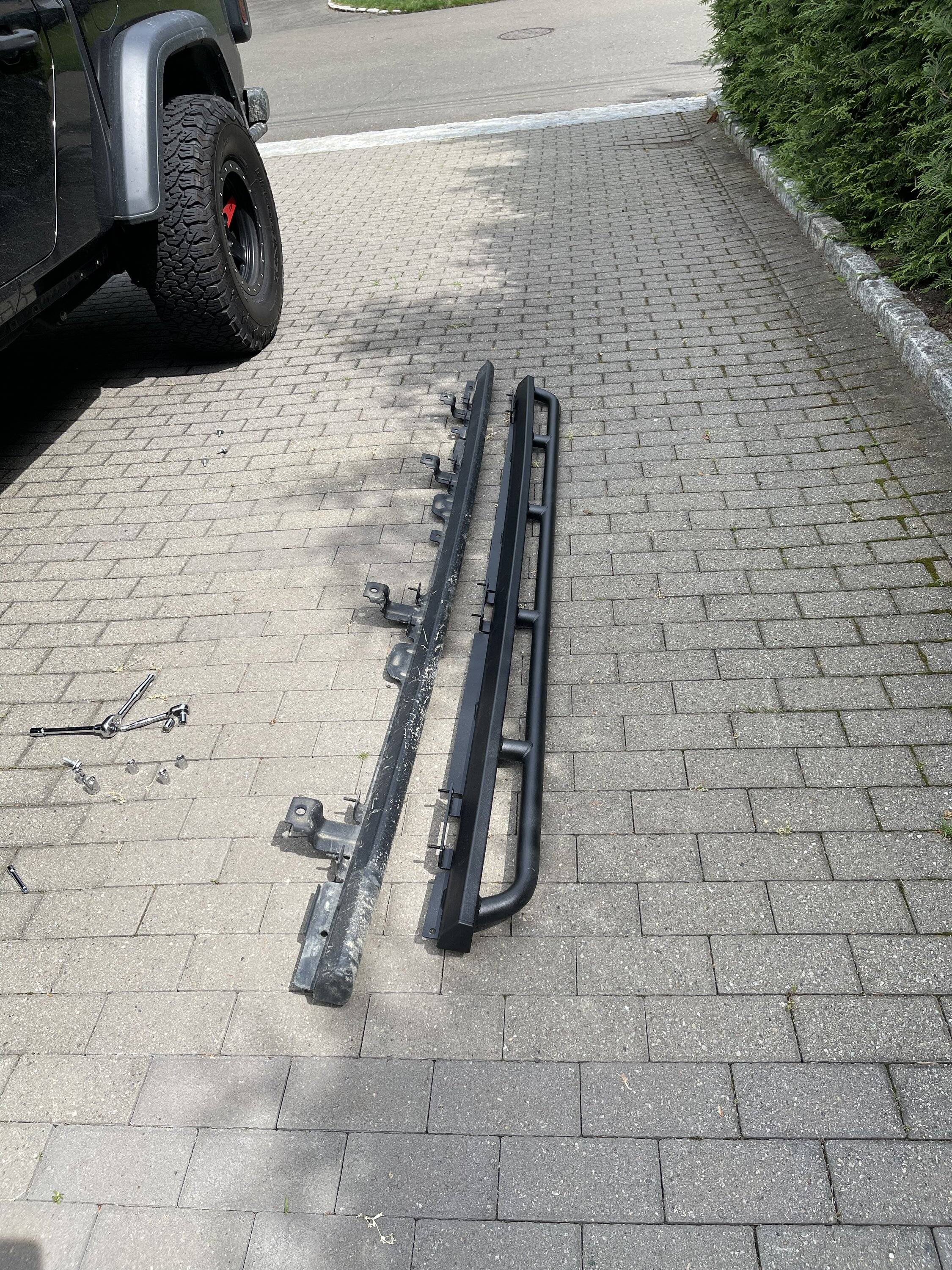

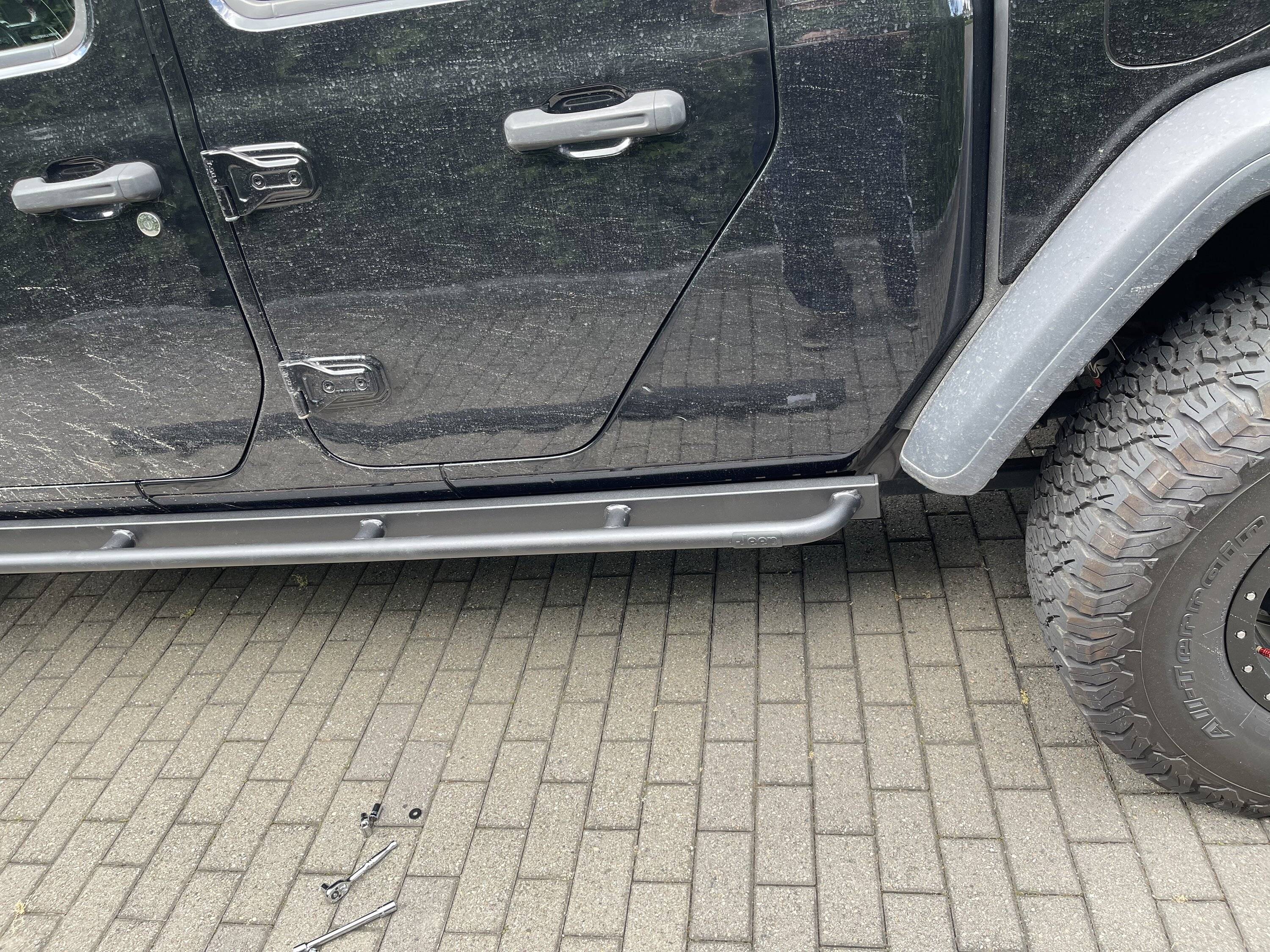

Installed the new Barricade Enhanced RubiRails today
Really nice finish, easy install
wait, those attach to the existing stock Rubi rails? Me likey, what's the website?
