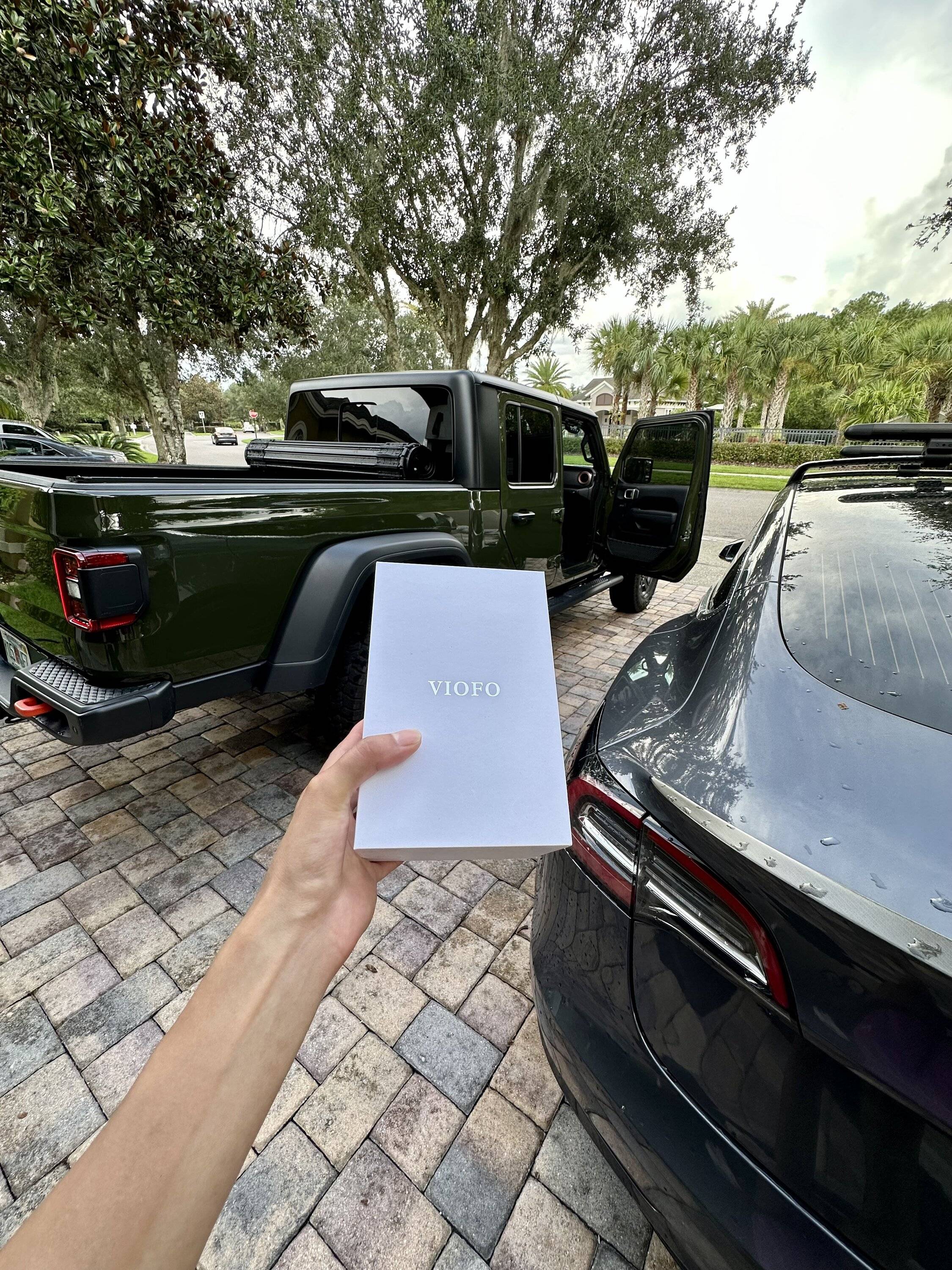

Installed the VIOFO 139 pro dash cam and rear camera. It was stupid hot today but finally got it done!
Good job. Bet that was like working in a steam room during the installation.
Now .... come hook mine up .. lol.

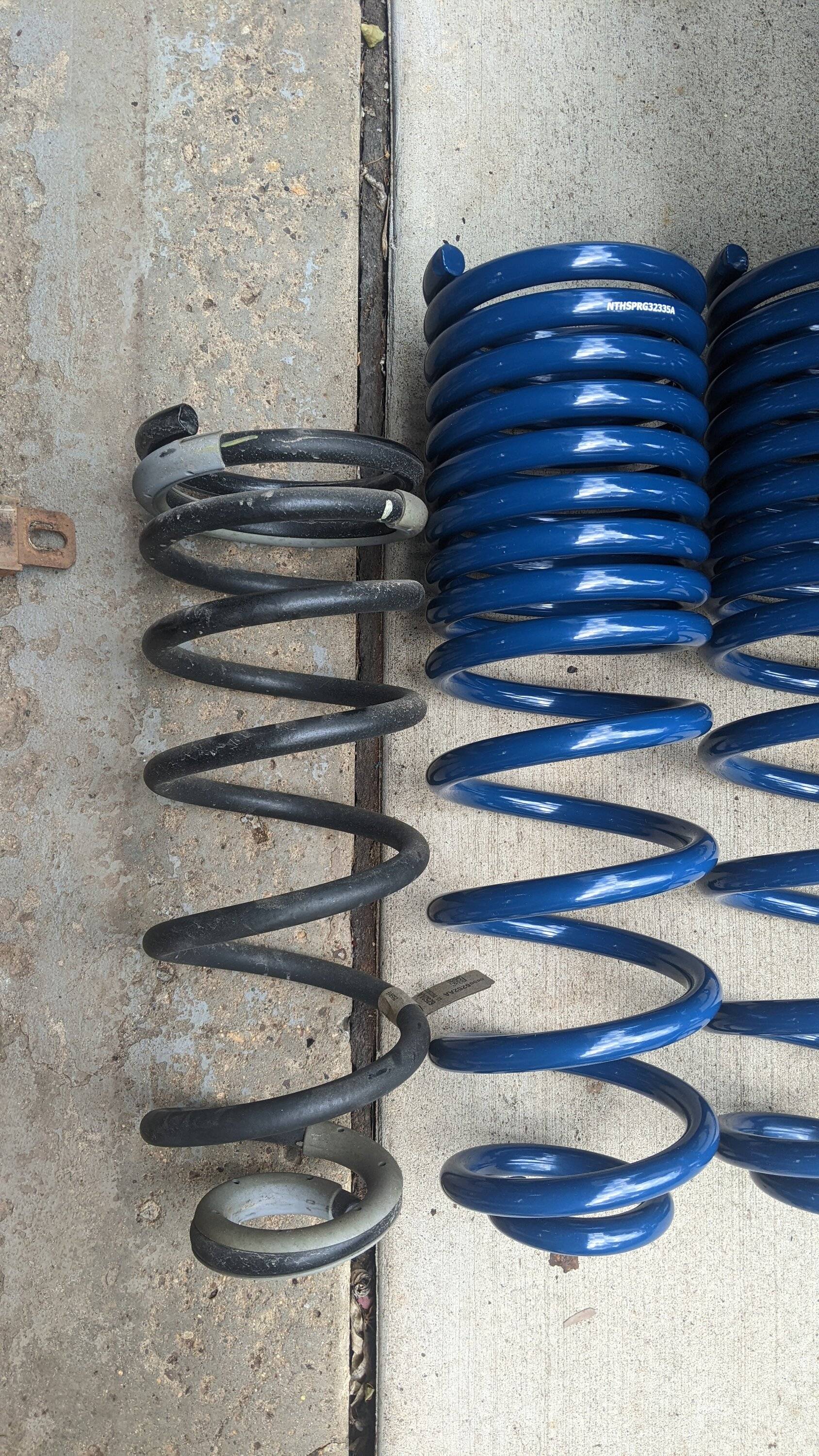

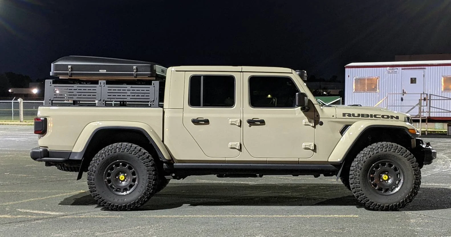

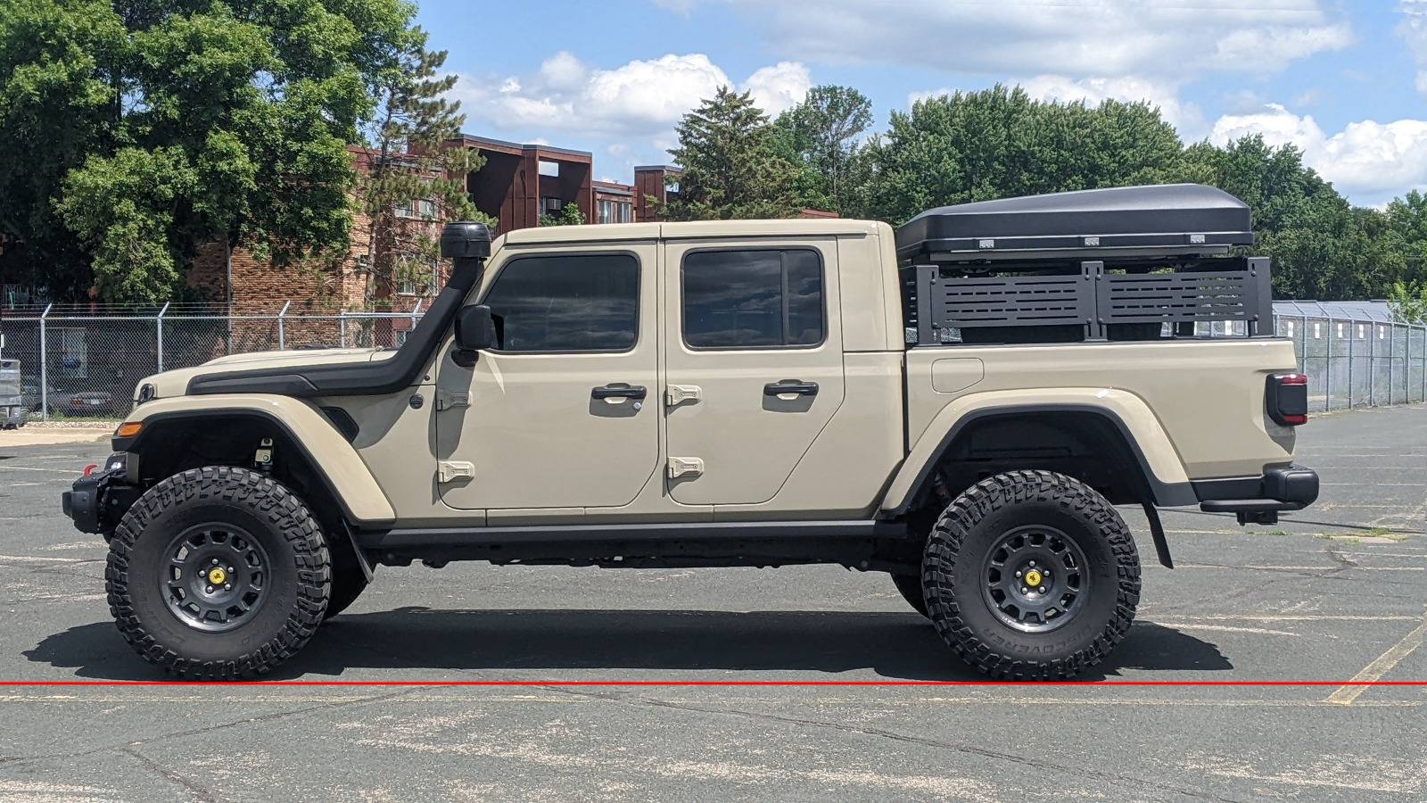

Installed a set of AEV High Capacity coils. They're intended for a constant 400-700 lbs of rear cargo. I'm at about +375 rear but I also want to be able to hook up the TJ which is an additional ~625 lbs on the hitch and have it sit level and not wallow all around. Prior setup was a 3" front spacer and 2" rear spacer.
I think I'll probably add a 1" front spacer to take a smidge of the excessive rake out. It rides surprisingly nice on extended factory Rubicon shocks. I'm undecided on what I'm doing in that regard.
Jeep Gladiator What did you do TO your Gladiator today? [ADMIN WARNING: NO POLITICS, NO GUN TALK] PXL_20230728_212725644
Before:
Jeep Gladiator What did you do TO your Gladiator today? [ADMIN WARNING: NO POLITICS, NO GUN TALK] IMG-20230729-WA0010
After:

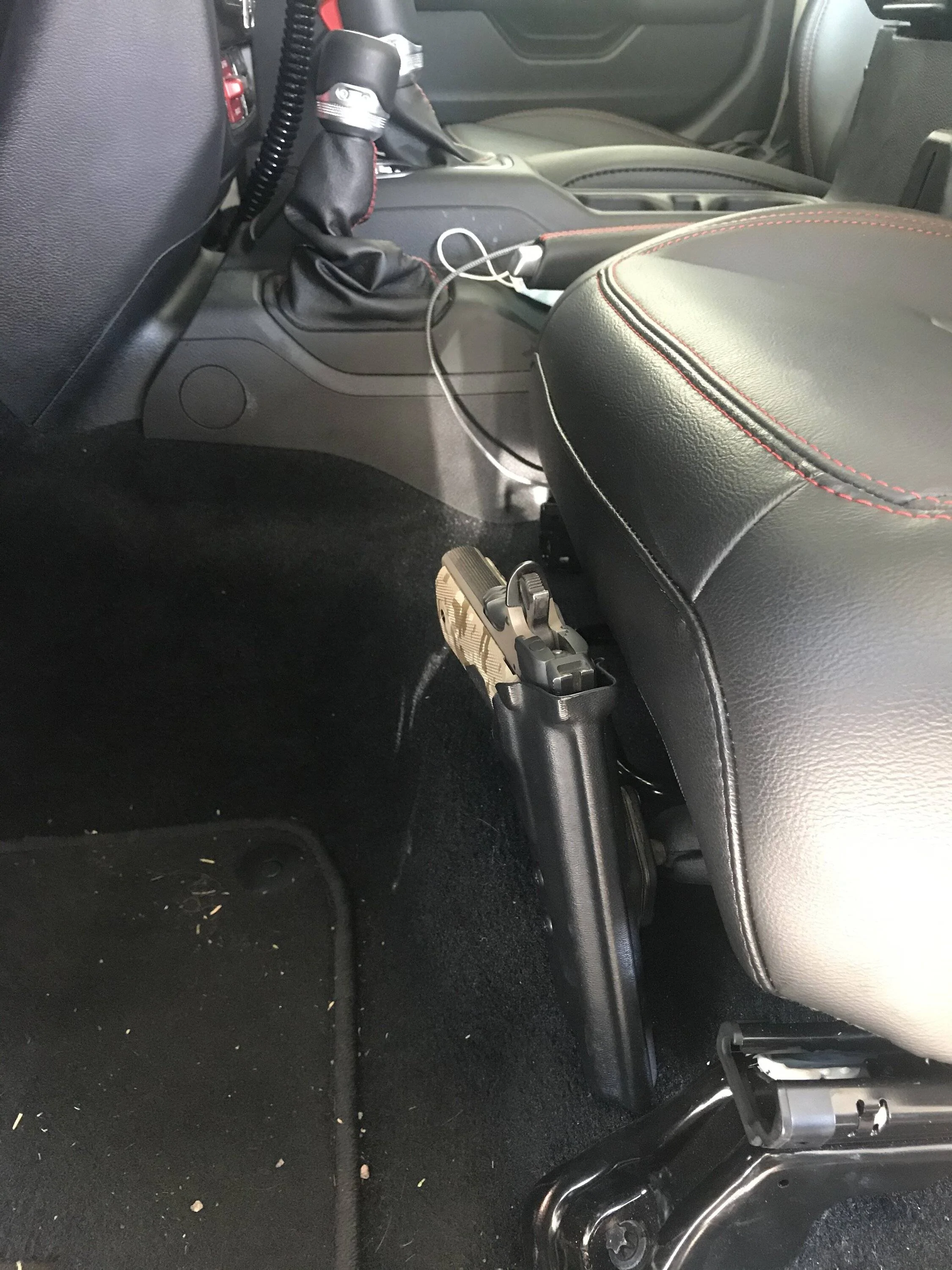

What did you attach the mount to?
Details were just a bit further down the page...
It is a Kydex holster from Dara Holsters that comes with a RAM ball mount already attached:
https://daraholsters.com/standard-ram-mounted-vehicle-holster/
I then used a series of RAM arms and a ram clamp to attach to one of the cross members under the seat. The details on this are a bit sketchier as I can't find my actual order info right now, but it would have been something like this (you might want to do some measuring before you actually take my memory as gospel):
https://rammount.com/collections/popular-components-b-size/products/ram-b-201-201u-c
https://rammount.com/collections/popular-components-b-size/products/ram-b-408-37-62u#
The seat is still very much adjustable and since the whole rig is attached to the bottom of the seat, it just moves back and forth with the seat.
RAM makes something like this that you might be able to use under one of the front seat feet bolts with a shorter arm, but that would then interfere with seat adjustment:
https://rammount.com/collections/popular-components-b-size/products/ram-b-272u#

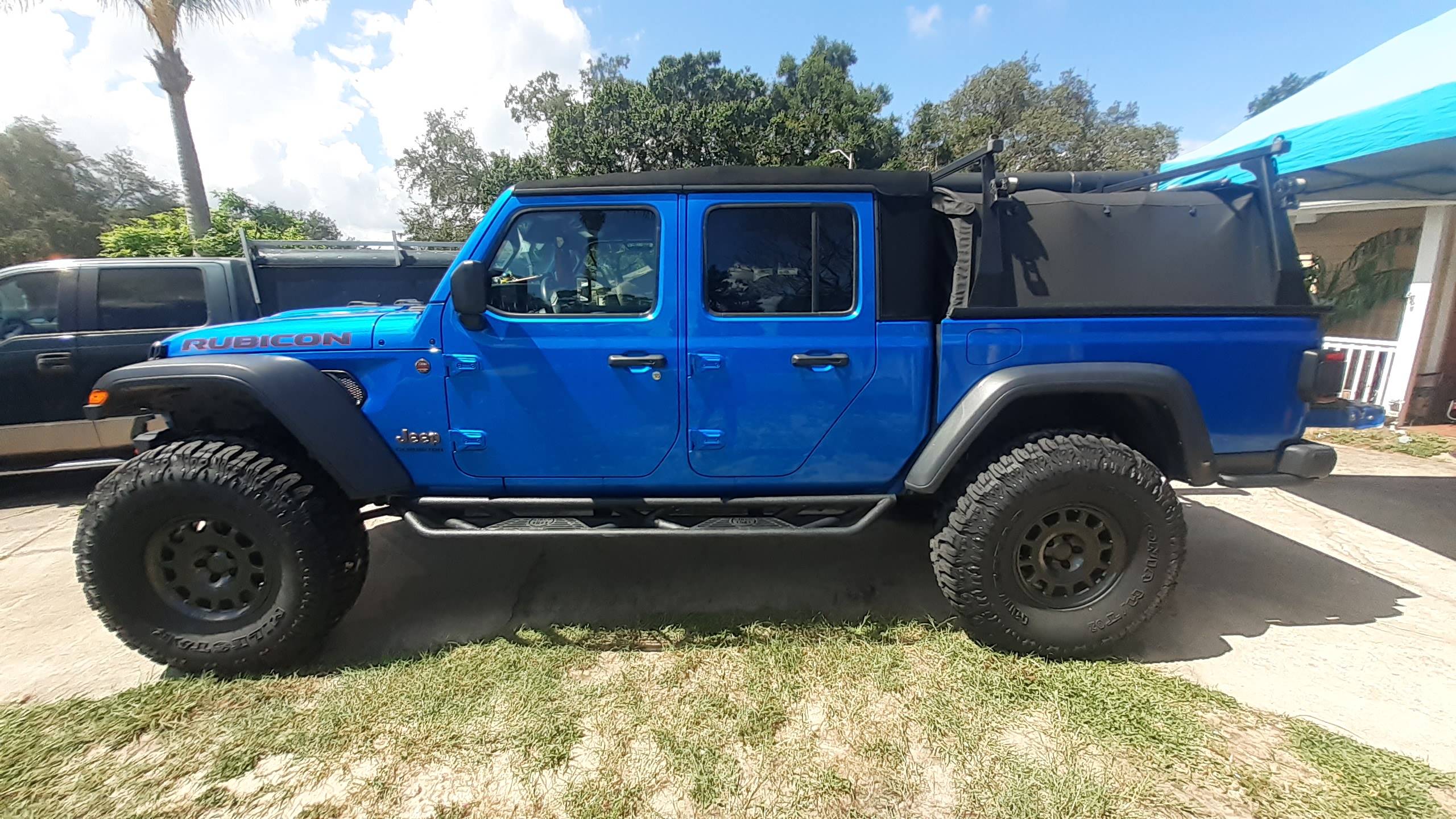

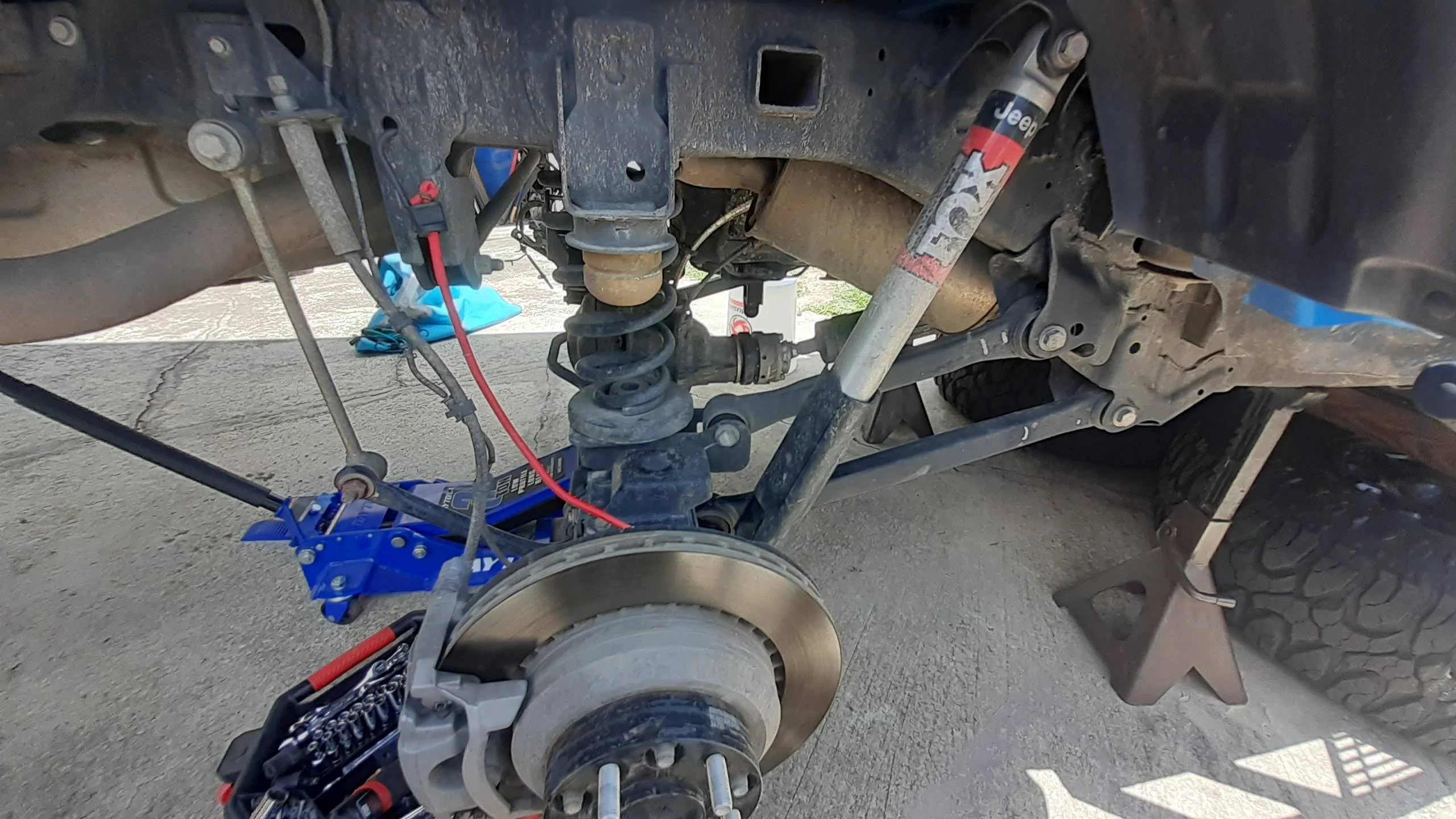

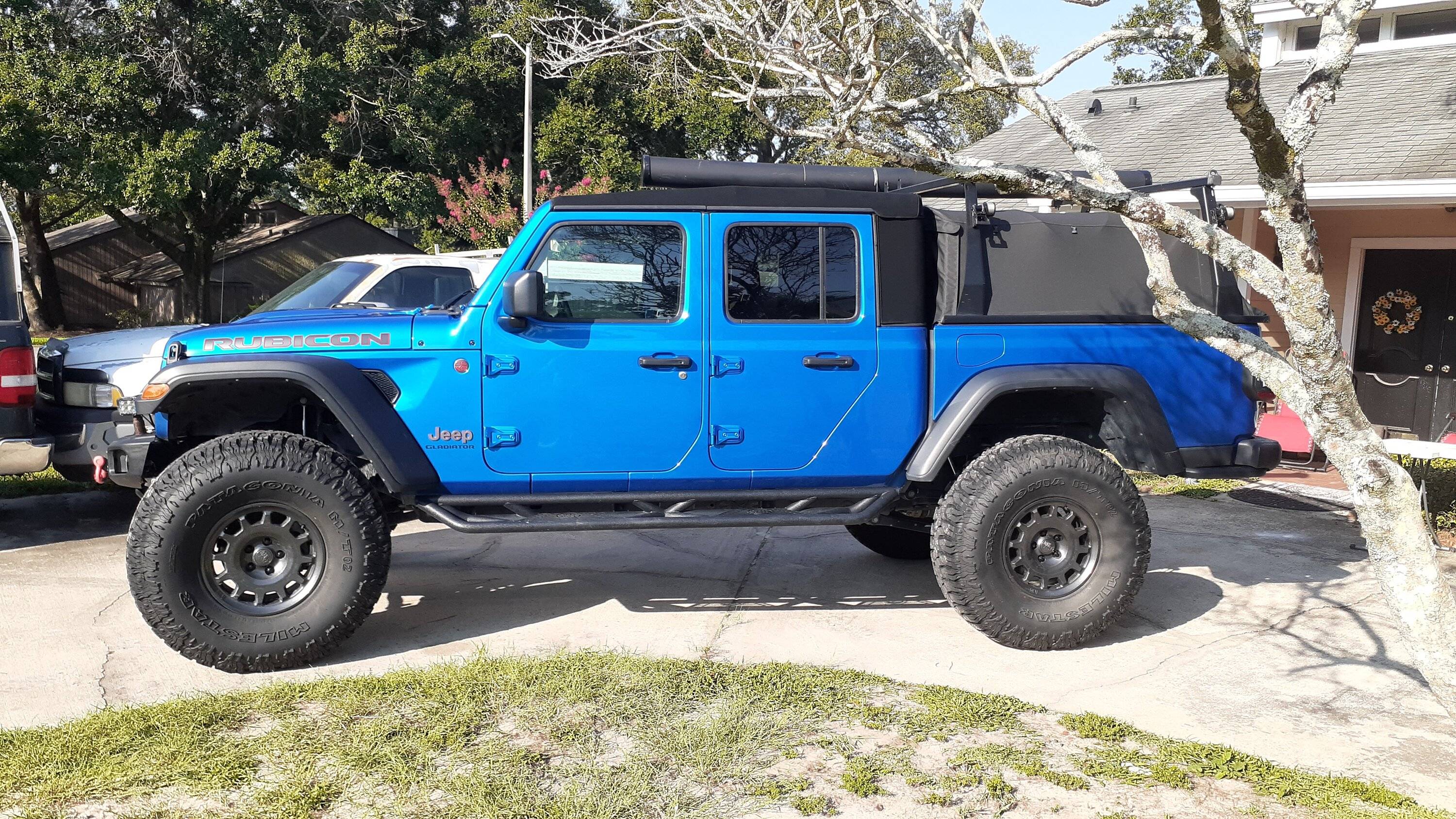

Got a new butt lift. Do you like it?? (Insert Instagram pose here.)
Went from 2.5" rear springs to 4.5" and got exactly... 2 more inches of lift.
I was expecting more given that older springs were replaced with new, and the company markets them as their "HD" version. We'll see how/ if they settle.
It's also interesting to note how the ride was affected by the rear suspension lift:
With fixed 3.5" lift Skyjacker front lower control arms, the front end/ steering had always felt "planted" even with 4.5" springs and a 1" spacer. After install and driving to the sports bar to watch the UFC fights with some friends, the front end felt a little wandery, and I'm assuming that little bit of frame rotation in relation to the front axle axis was enough to finally get the caster angle out of firm range.
Before:

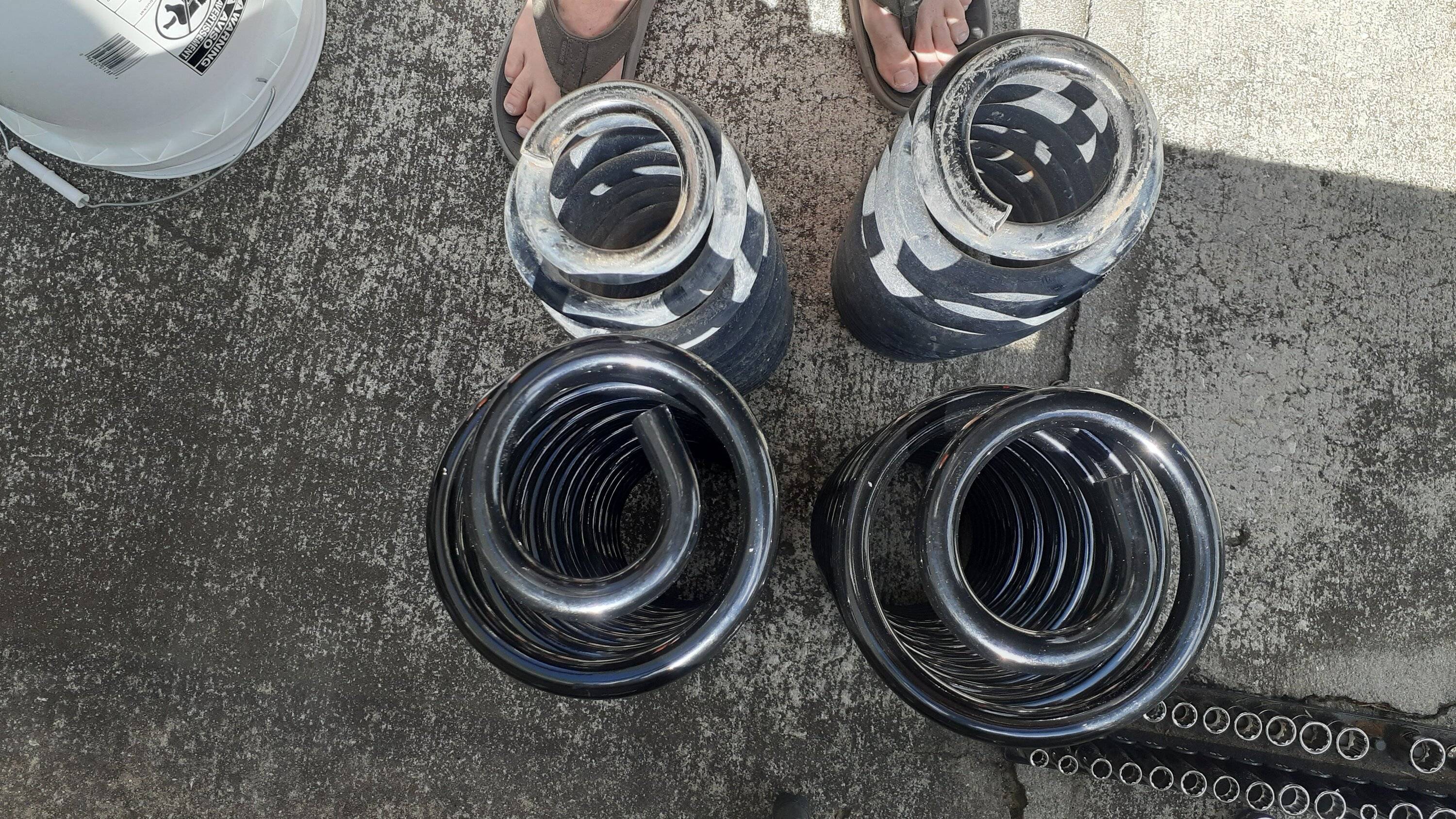

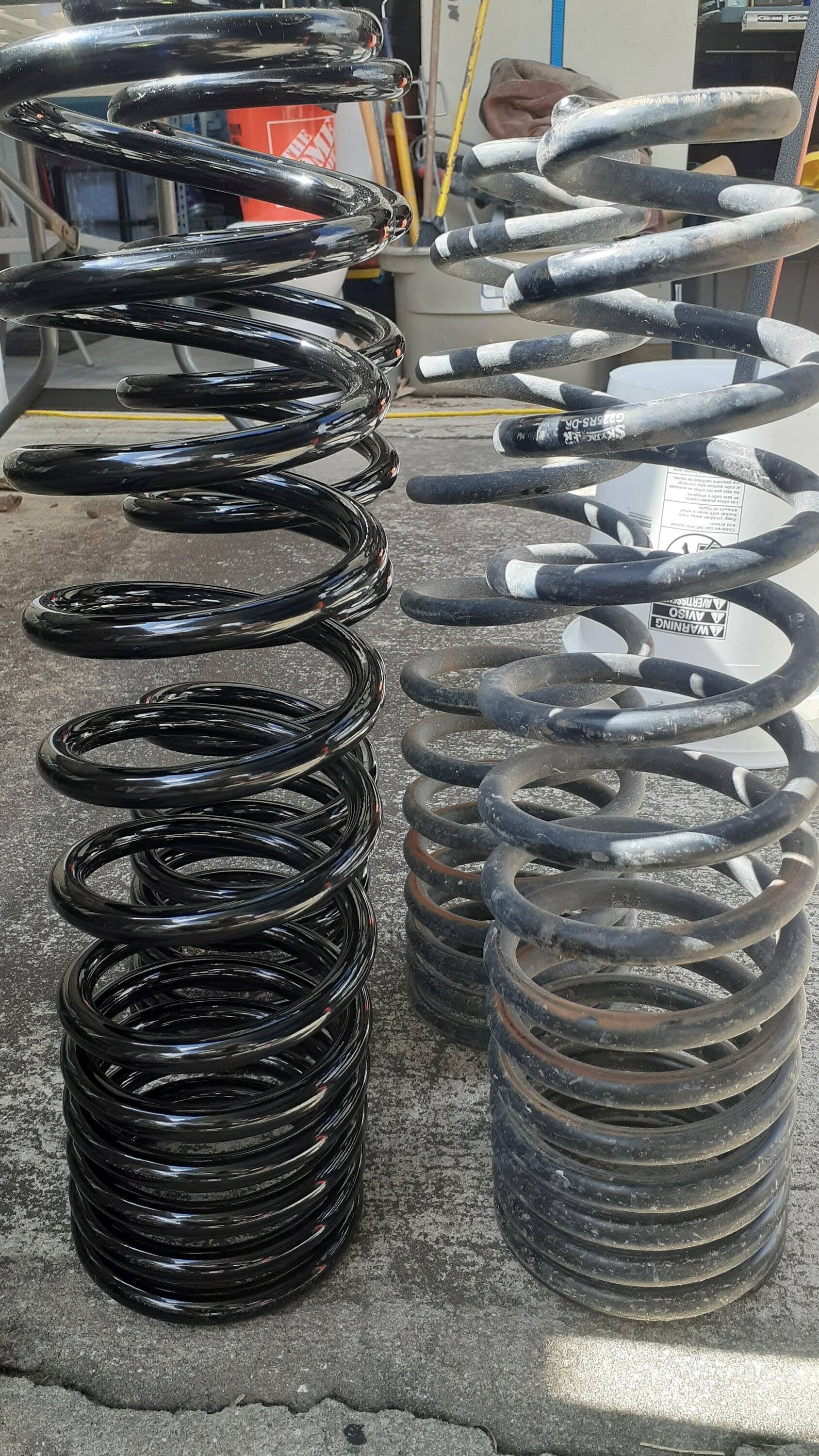

Out with the old, and in with the new.
I'm a little (not) surprised, that the springs are the height difference of their advertised lifts, and resulted in such, even though the Evo is a much beefier looking spring.

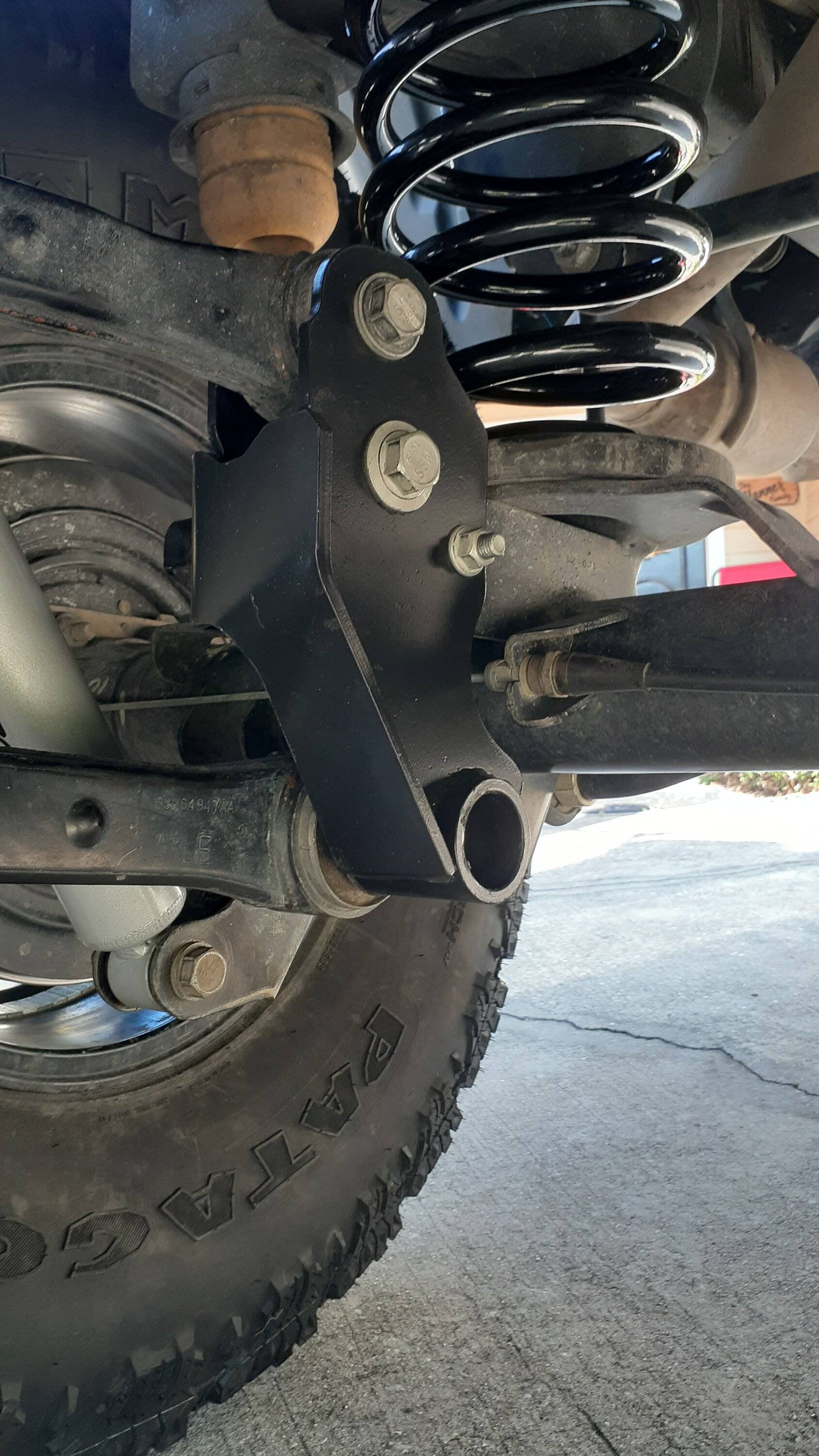

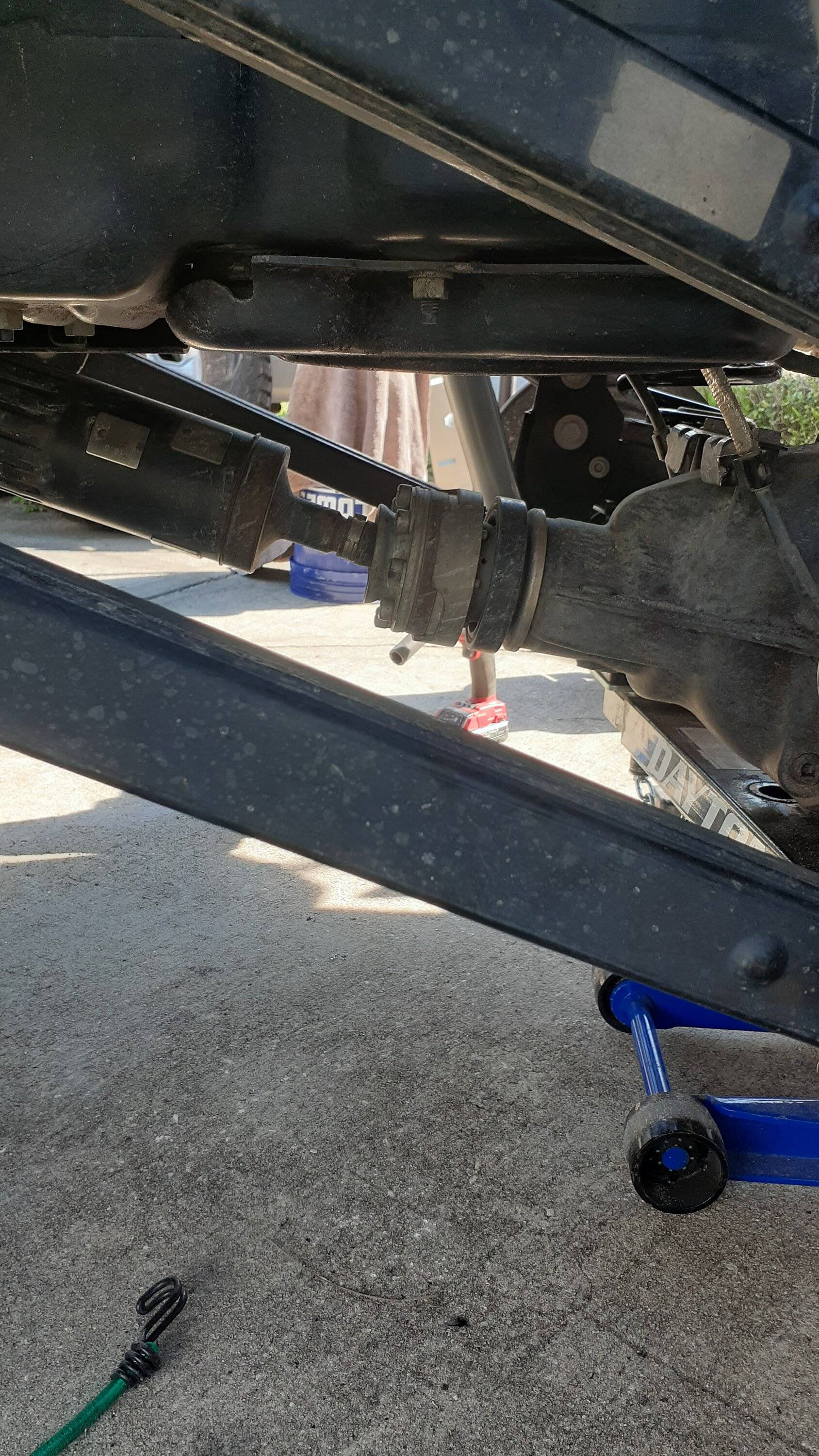

Other mods:
Installed Teraflex rear upper control arm relocation brackets.
They're designed to preserve driveshaft/ pinion angle during suspension droop and they appear to work as advertised.
Pro tip: When installing, tighten the small bolts first if you're not on the ground.
Installed:
Jeep Gladiator What did you do TO your Gladiator today? [ADMIN WARNING: NO POLITICS, NO GUN TALK] 16907254612903901919533779526172
Also added extended length brake lines. It appears both the brake line and accompanying (ABS sensor?) are good for 4" of drop. This won't be enough. I know where to source longer brake lines. How does one go about lengthening the abs sensor (?) line?
