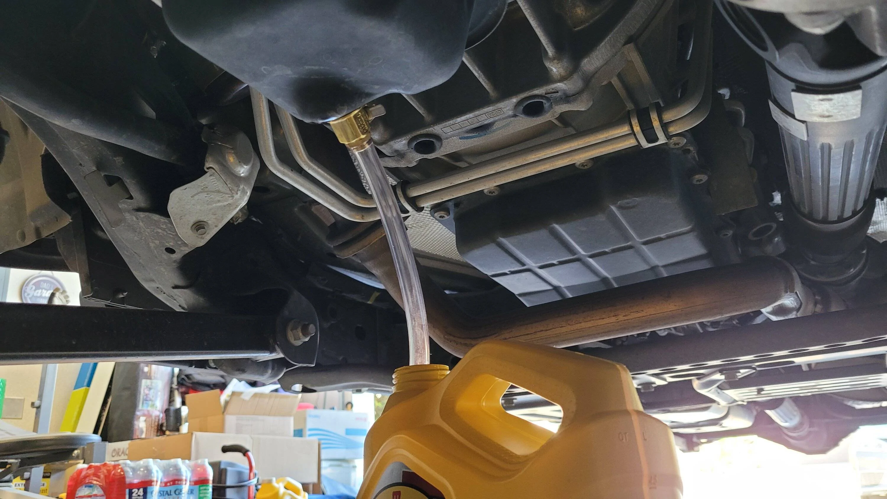

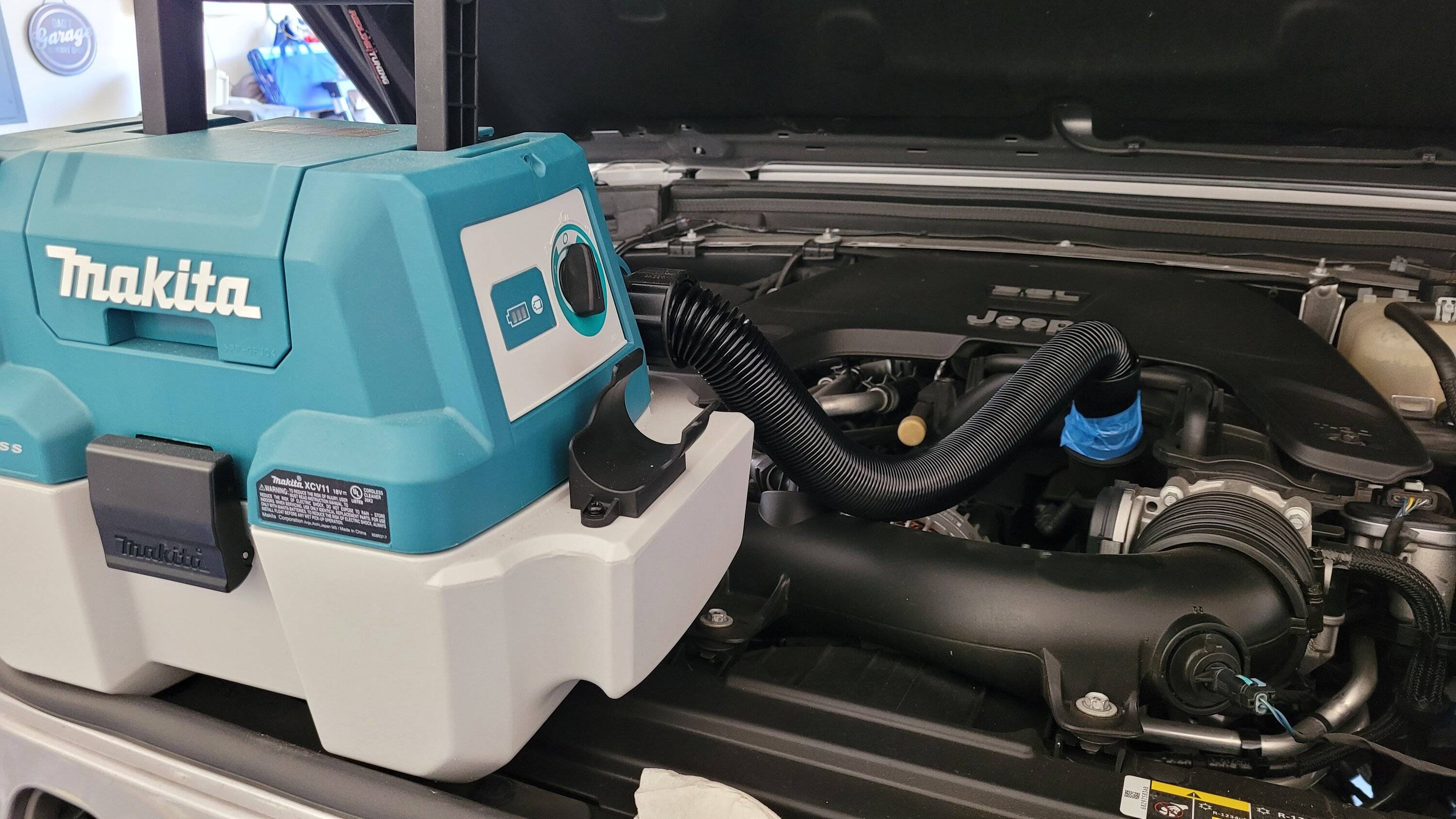

Installed a Fumoto oil drain valve right before I changed the oil. I used a vacuum cleaner to draw negative pressure (taped the nozzle to the fill neck) on the crank case while I removed the stock drain plug and installed the Fumoto valve. Not a drop of oil- completely dry while I swapped it.
Jeep Gladiator What did you do TO your Gladiator today? [ADMIN WARNING: NO POLITICS, NO GUN TALK] 20230828_104059
Then, I proceeded with the oil change, using the new valve. Wow, I should've done this earlier. It was the easiest, cleanest oil change I've ever done. The only oil that dripped a bit was when I changed the oil filter.

^^^^ Why wouldn’t you just remove the oil drain bolt, drain the oil then install the fumoto?
Why all the trouble?
It was actually no trouble at all. It took just a couple minutes to tape the vacuum hose to the oil filler neck. Changing out the drain plug with the Funoto prior to draining let me drain directly into the empty container instead of draining to a drain pan and then transferring to an empy container. Saved a few rags and paper towels for clean up. Next oil change will be even easier.
