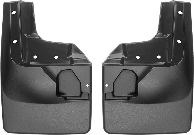

Installed the front WeatherTech No-Drill mud flaps. They reuse the factory holes and have cutouts for the rock rails. They look factory, fit like a glove, provide good cover and secure tightly! Much better than the Mopar splash guards I had on my JL.

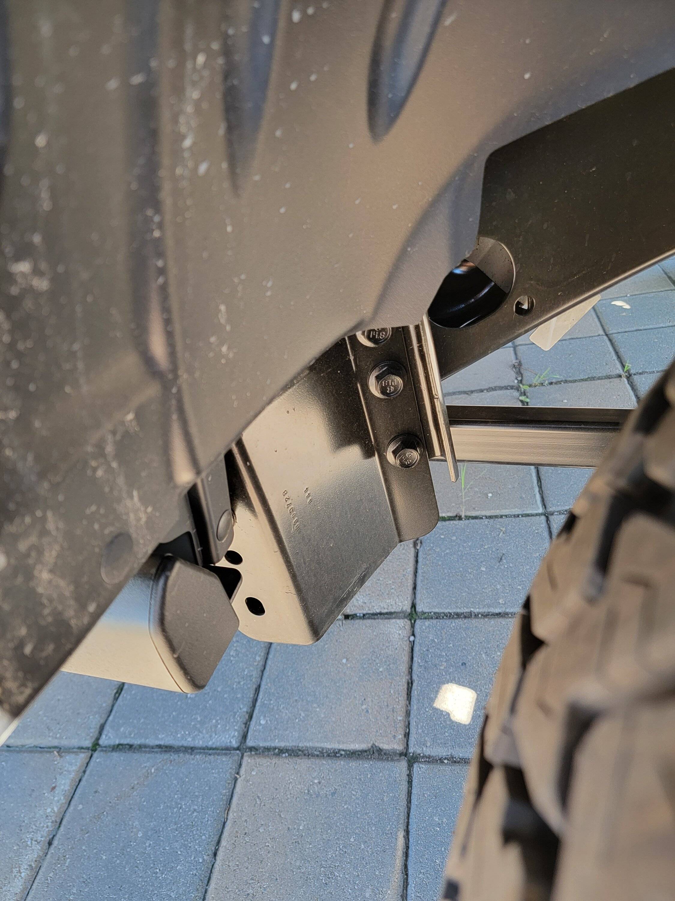

One minor installation issue: my 2023 Gladiator came with that new “safety bracket” on the passenger side of the frame —see below; photo @Mr.volleyball13 It made mounting the passenger mud flap a bit difficult.
I ended taping the nut onto the wrench to hold it in place behind the bracket, while I fumbled with the bolt from the front. Took a few tries but eventually went in.

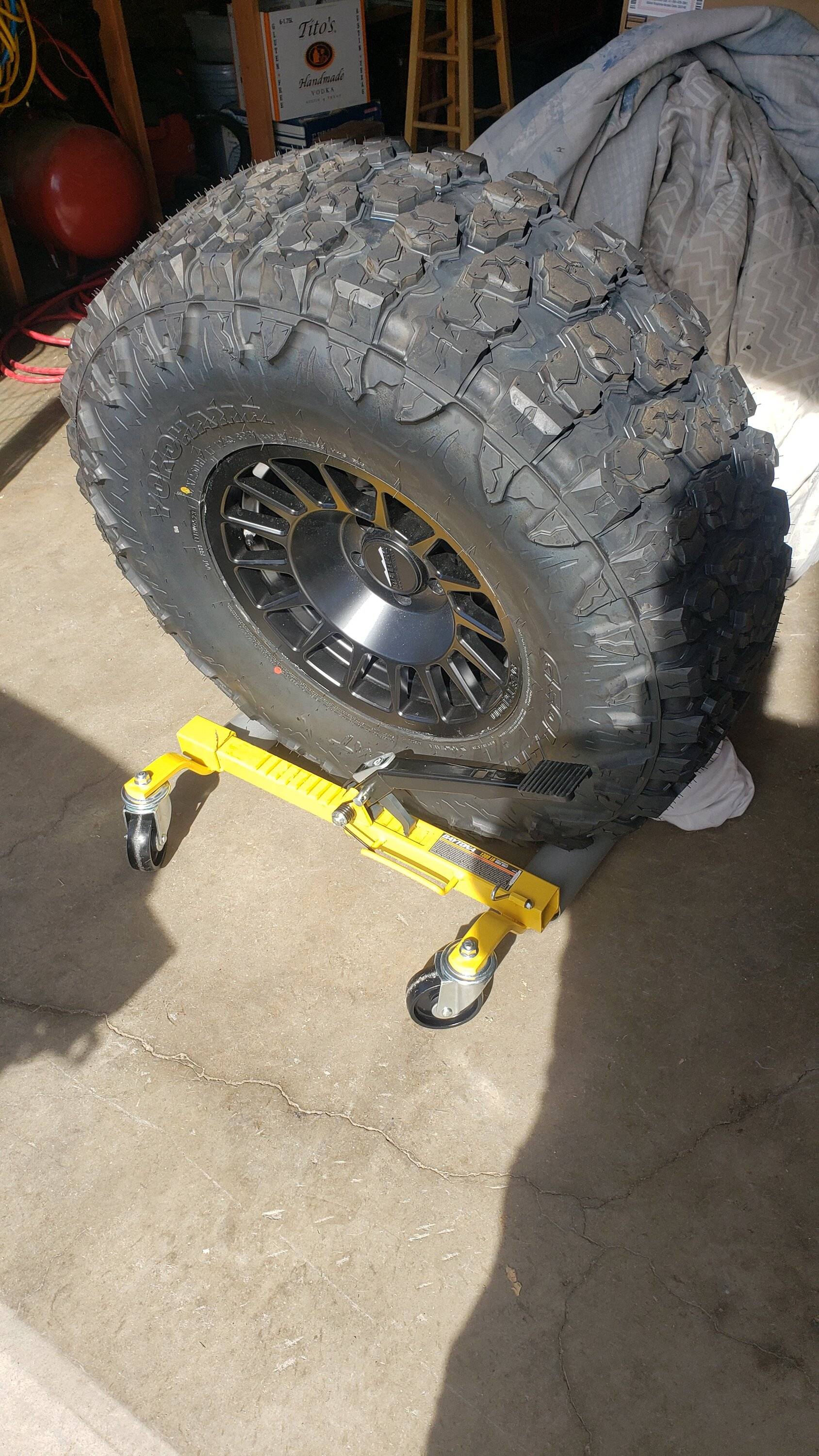

So much easier!!! ? and holds the tire!
Are those Method 707s? Got picts of the wheels on the truck? I've scoured the interwebs for a shot of them on a Gladiator with no luck.

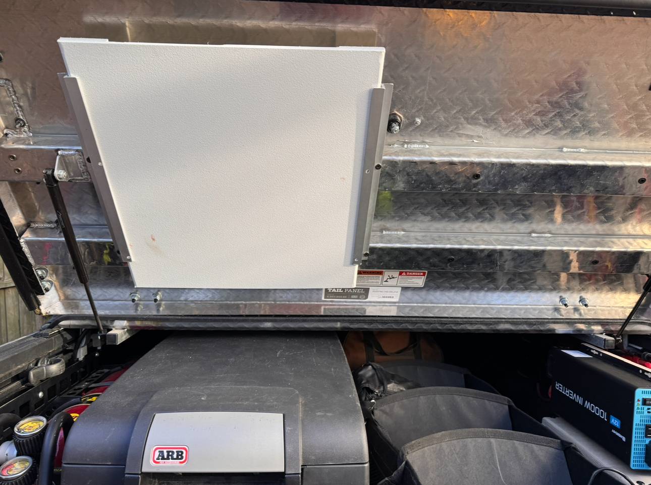

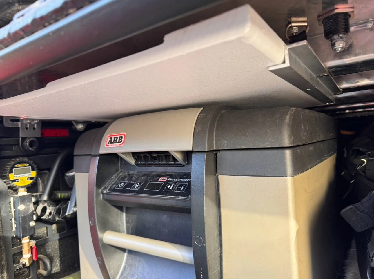

Also got around to a mount for the over sink cutting board on my slide out.
https://www.jeepgladiatorforum.com/forum/threads/diy-slide-out-w-sink.74944/
I’m posting this here because you could use this same concept for larger cutting boards, tables, etc. it’s $26 in Z channel and some M6 rivnuts/screws mounted to the Diamondback Cover. The fridge clears.
I couldn't tell, is that fridge on a slide? or just like a pull out sheet of plastic? Doesn't seem like many fridges fit under these bed covers.
Yep. It’s a 63 Quart ARB. I think that’s the biggest fridge that actually fits. It’s a great unit and I can monitor it from my dash mounted Garmin Tread.
It’s mounted to a DIY HDPE slider that locks in place. I did it this way so that nothing is mounted to the floor blocking stuff behind it and because typical fridge sliders are too high to fit and are not compatible with tailgate covers. This solution works really well. The slick HDPE slides easily on the bed liner. It’s captured in two places and locks so it can’t slide around once it’s in.

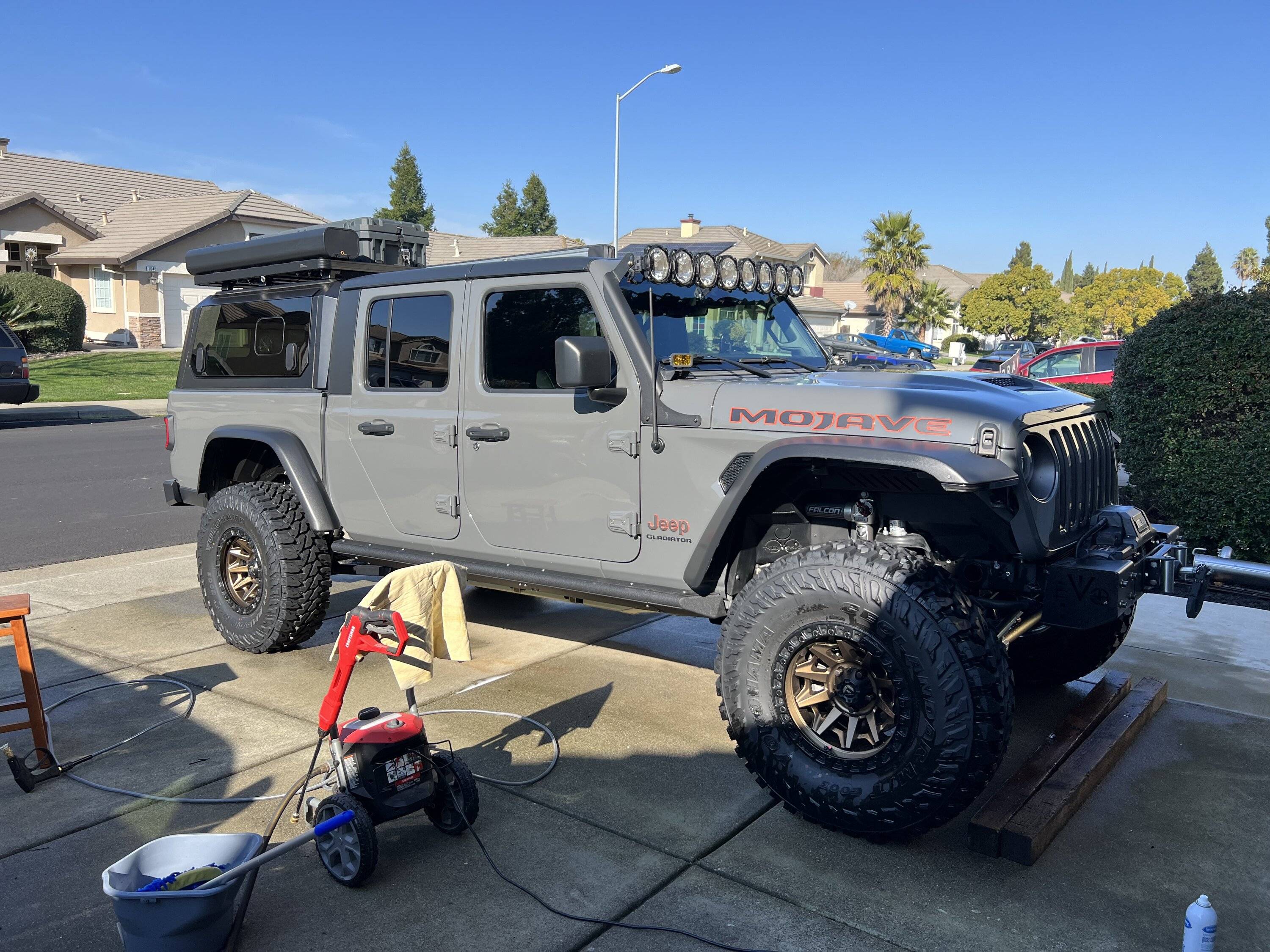

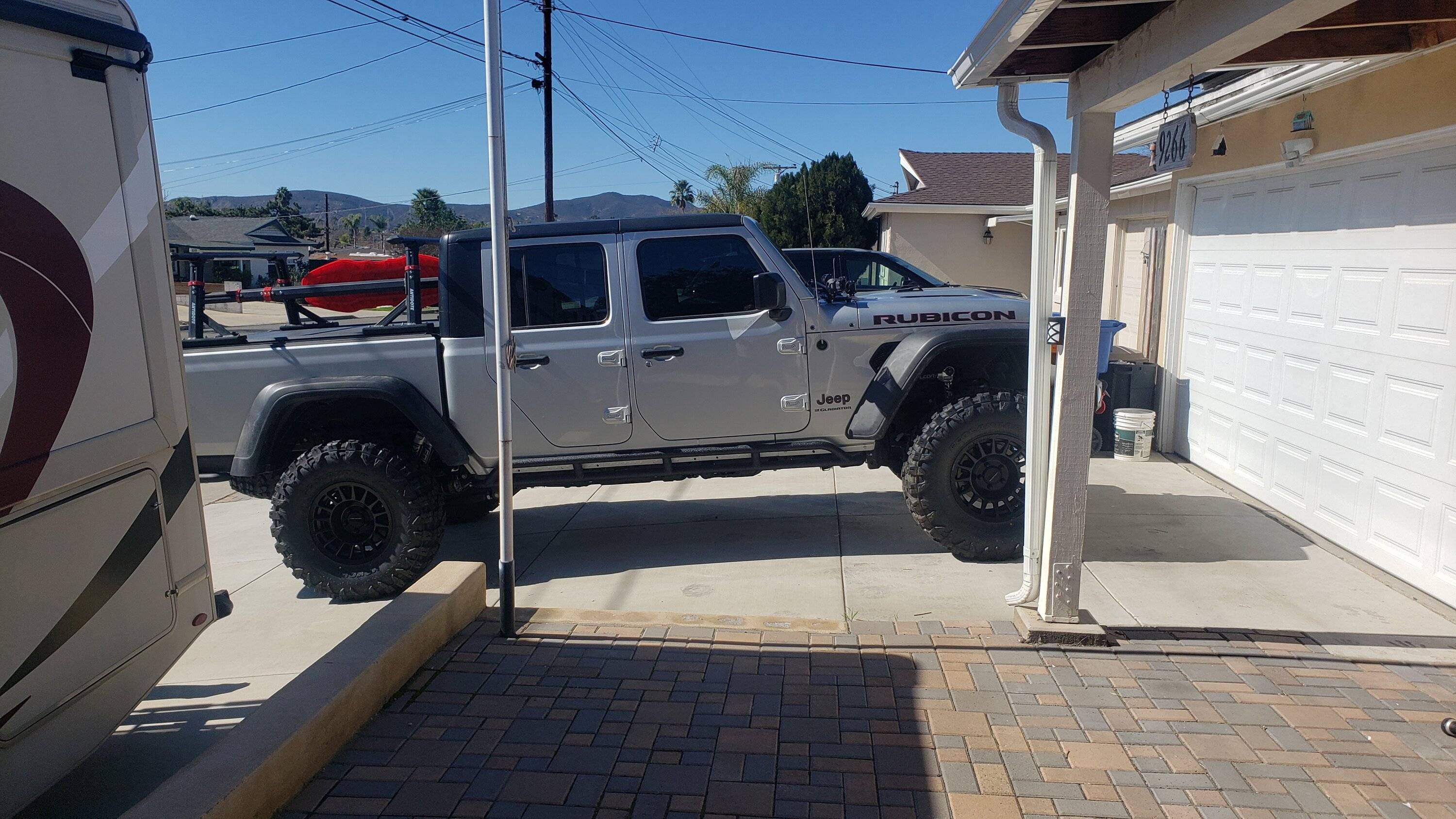

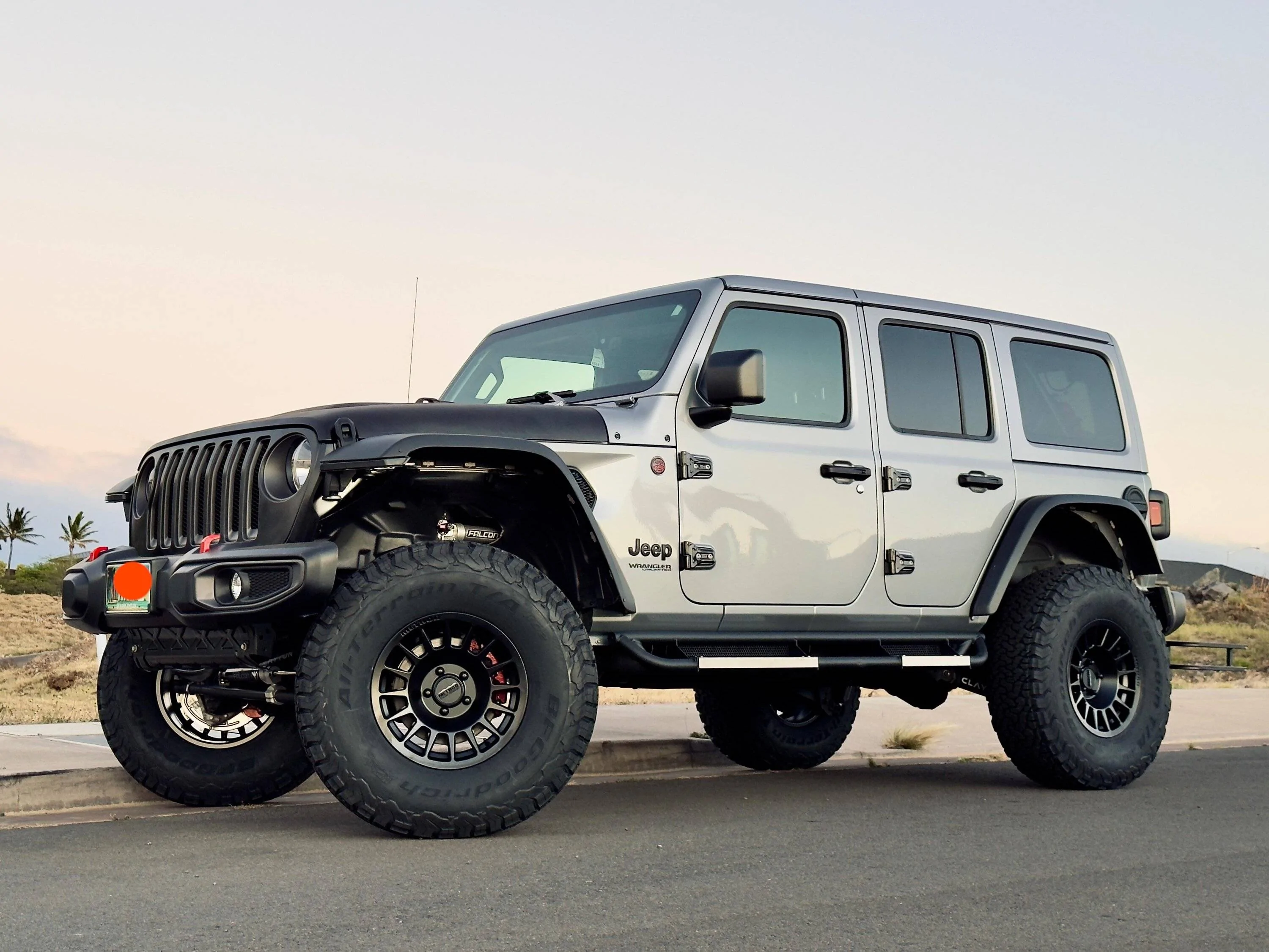

Yes they are Method 707 Bead Grips.
Check out my build page for more pics.
My patio and flagpole are in the way in this one.

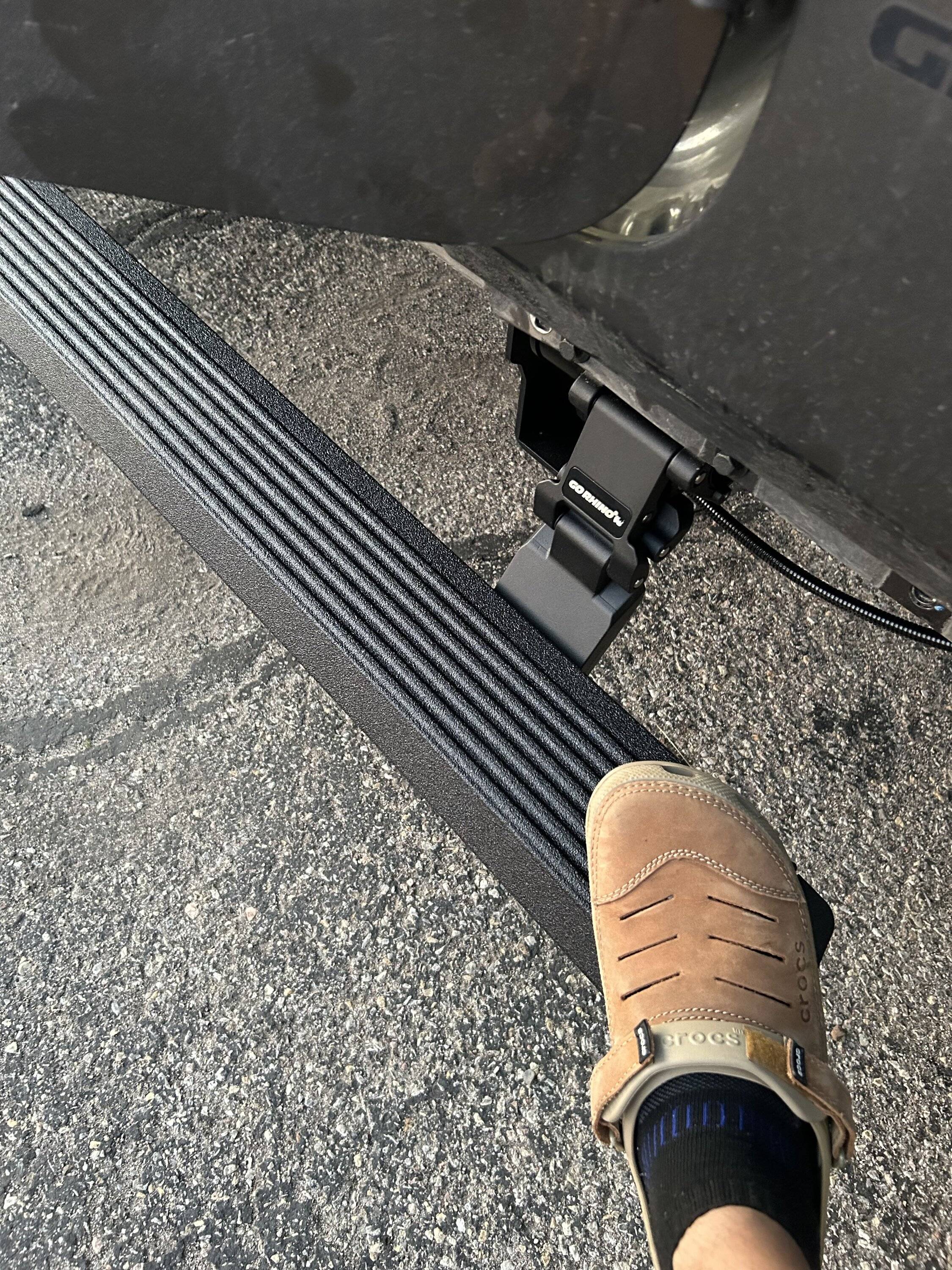

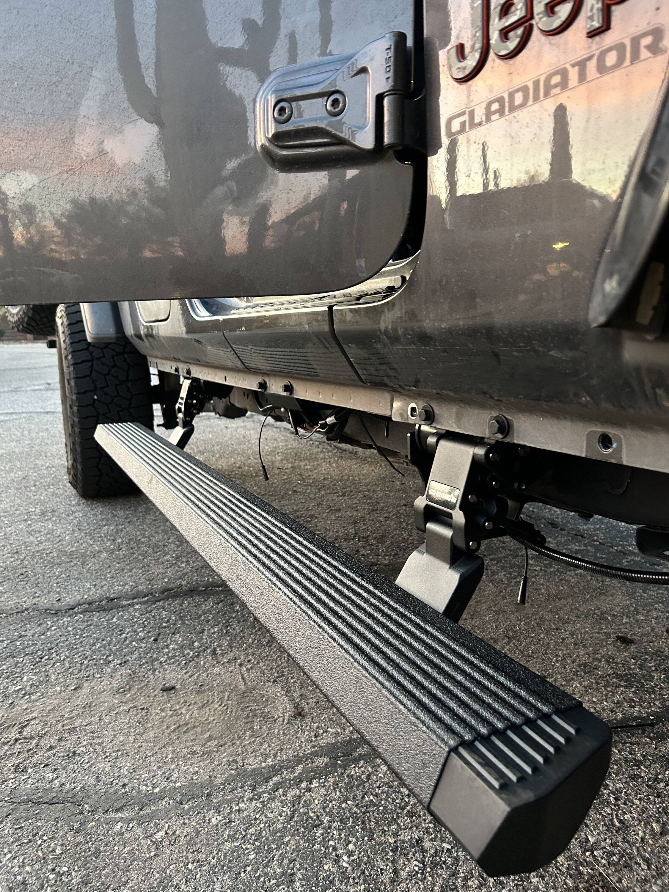

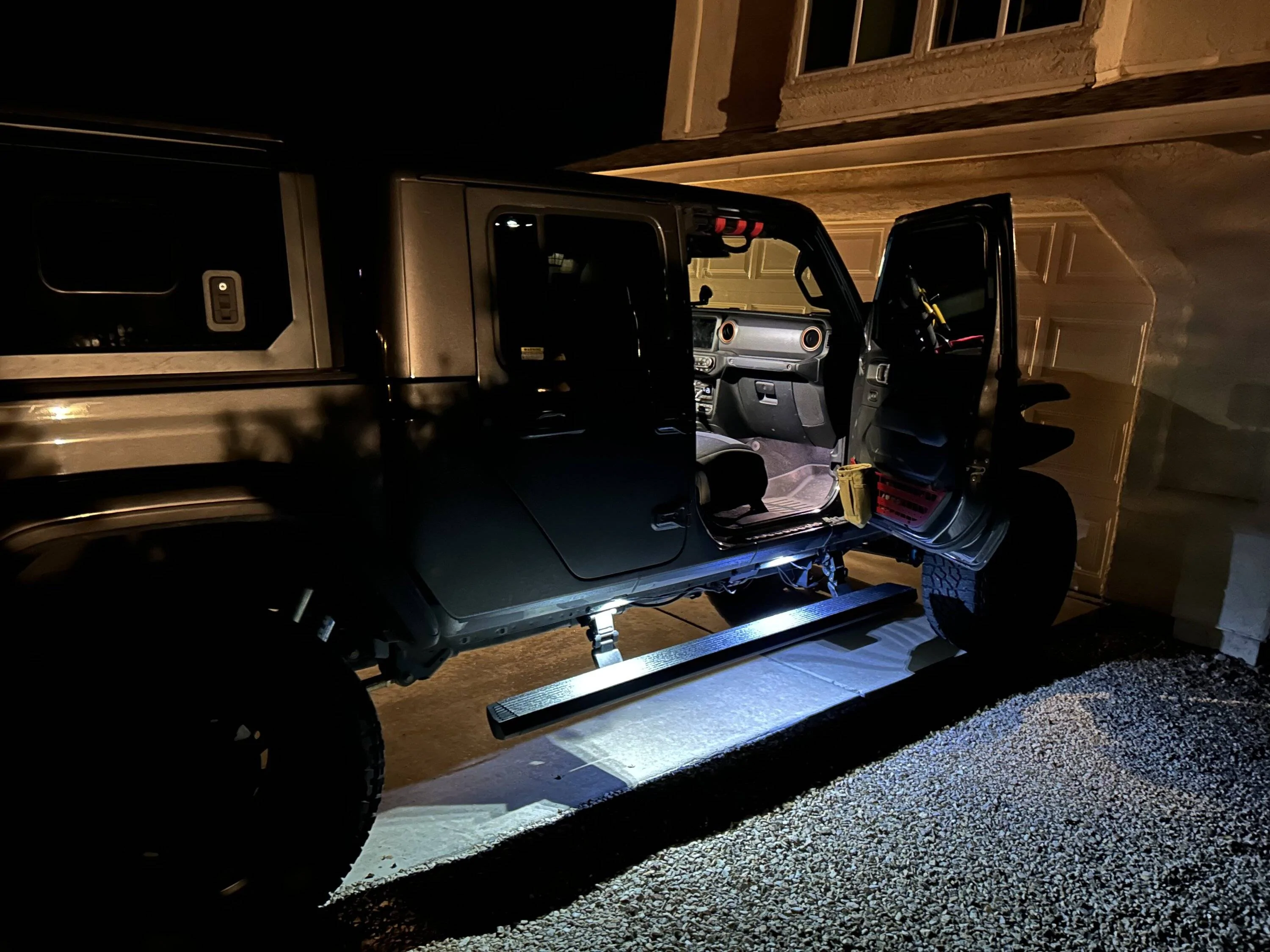

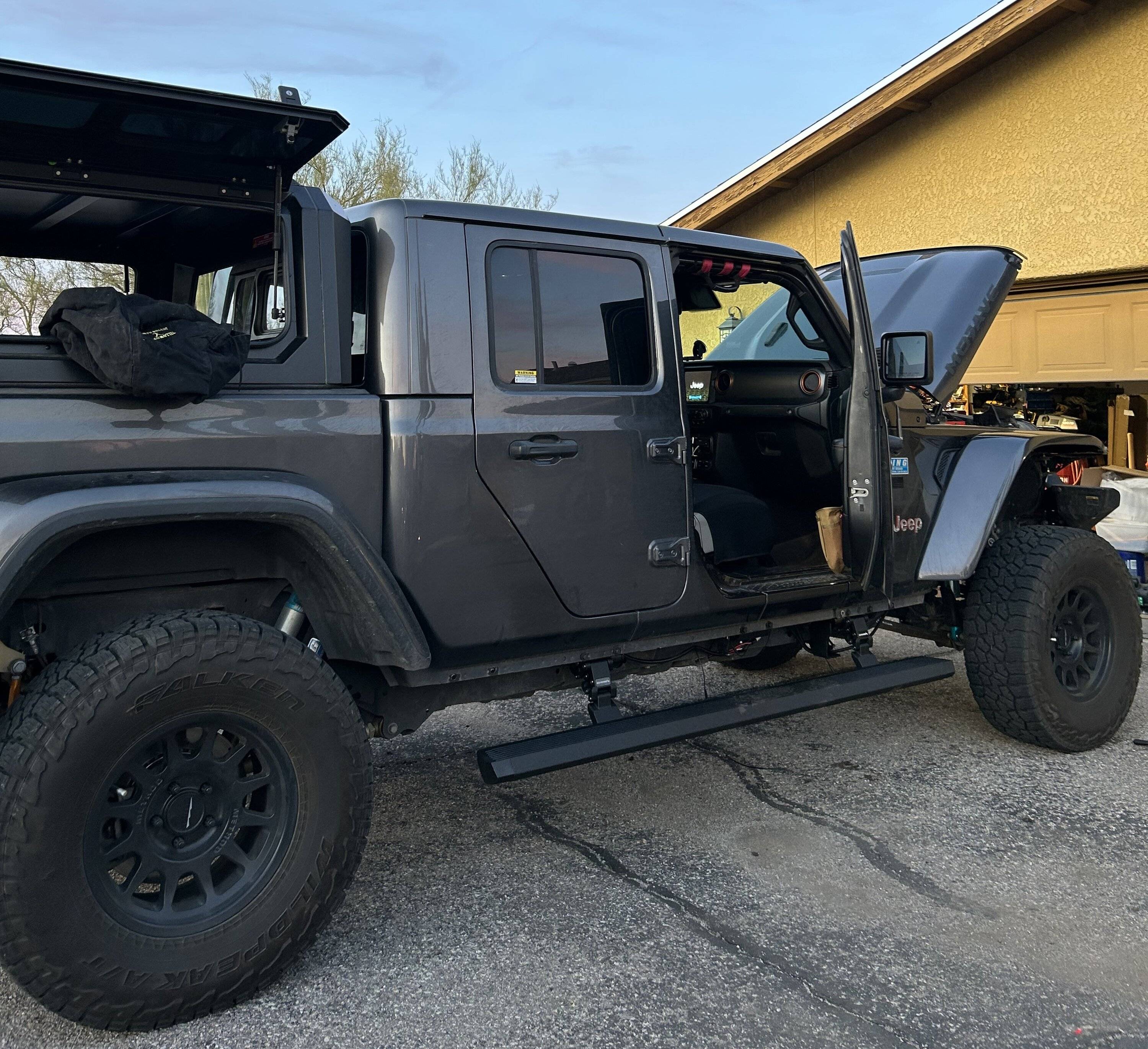

Spent a nice Sunday Funday with my ol' man, and we watched the Chiefs/Ravens game while trying to put these on. 2 hours turned into 5 hours... Too many beer breaks. Always enjoy these times with my Dad. ?
Will clean it up that bird's nest a lil later.
GoRhino - Bedlined Steps (E1)
Cheers..
