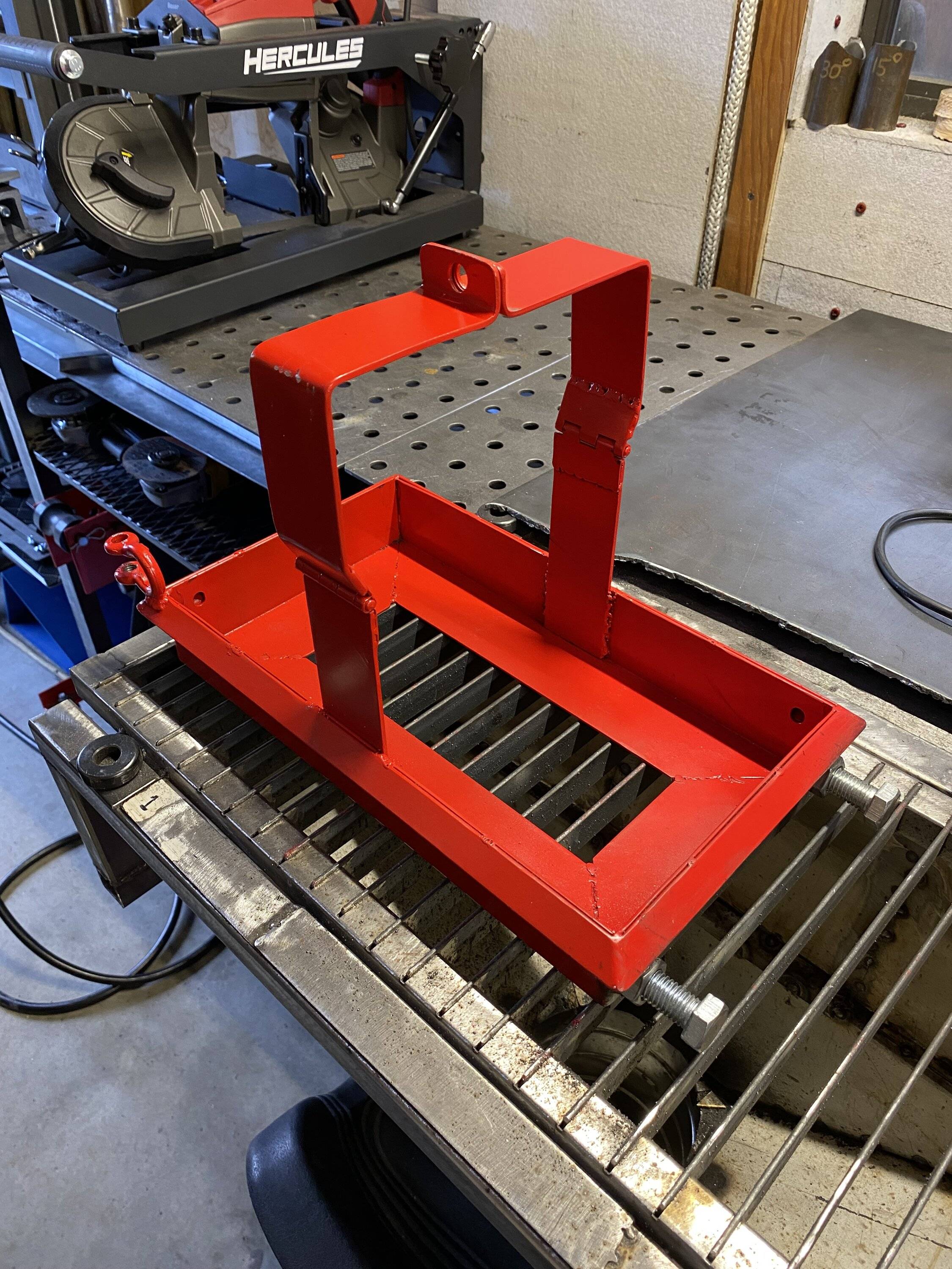

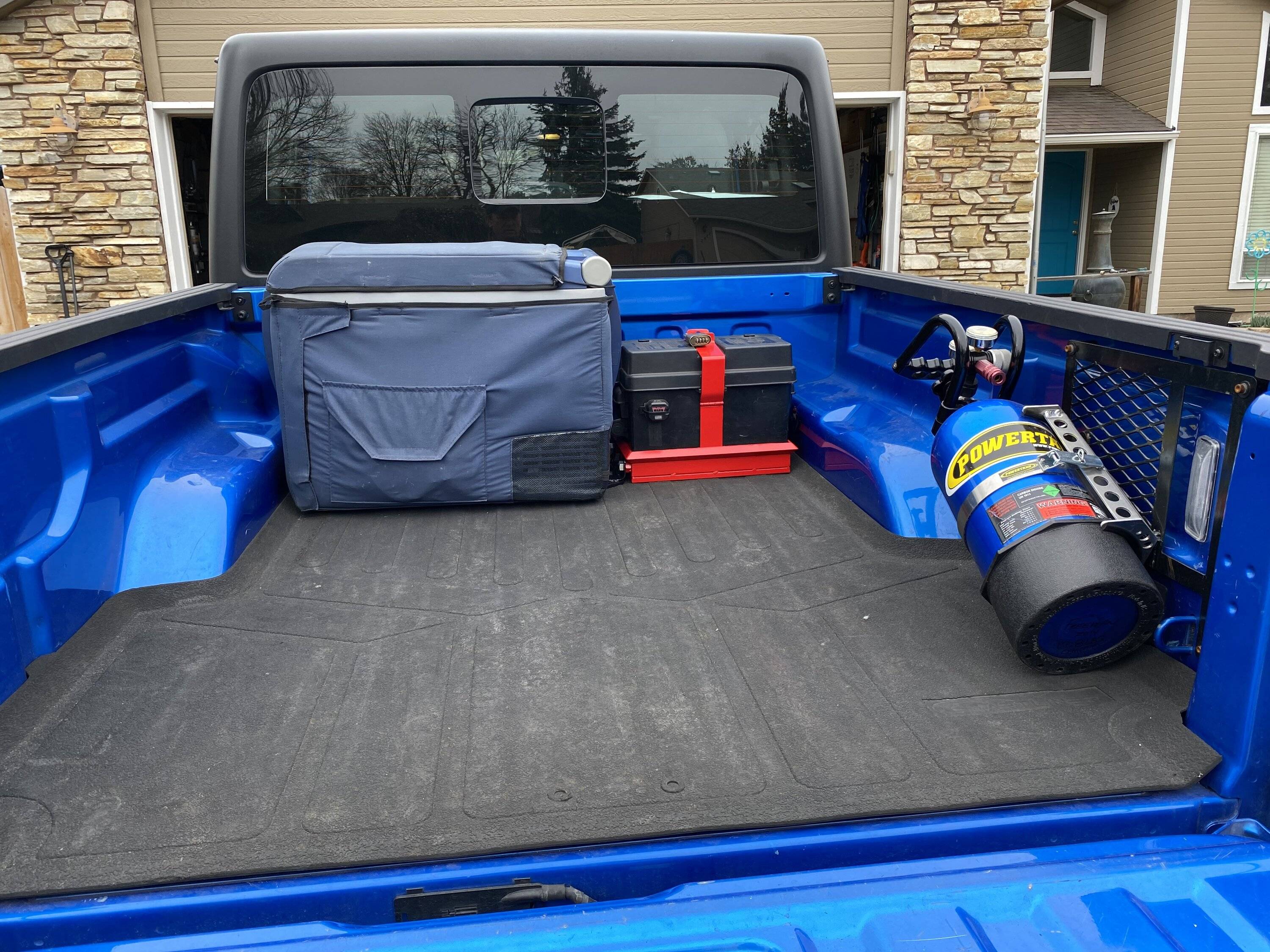

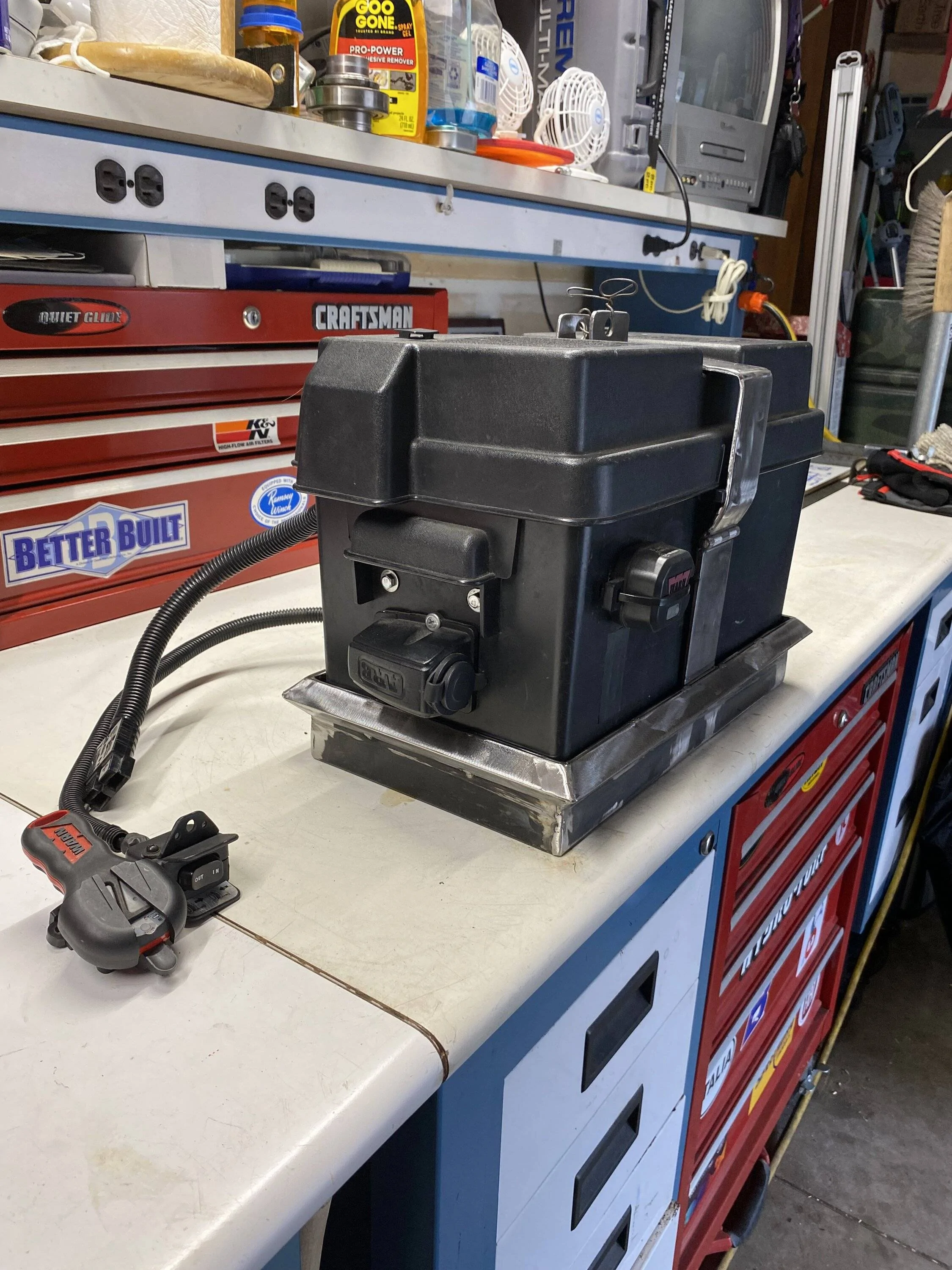

Been working on a way to safely install a house battery in the bed without punching holes in the bed using only factory holes.
I’ve always liked the Norco styled polymer battery boxes, good vents, can be sized for the battery to be installed and the price is excellent. Needs some bulletproofing for living in the open bed of a pickup though.
One goal on this project was to not run to the metal yards and hardware stores for anything putting this together. Scraps and repurposed metal only.

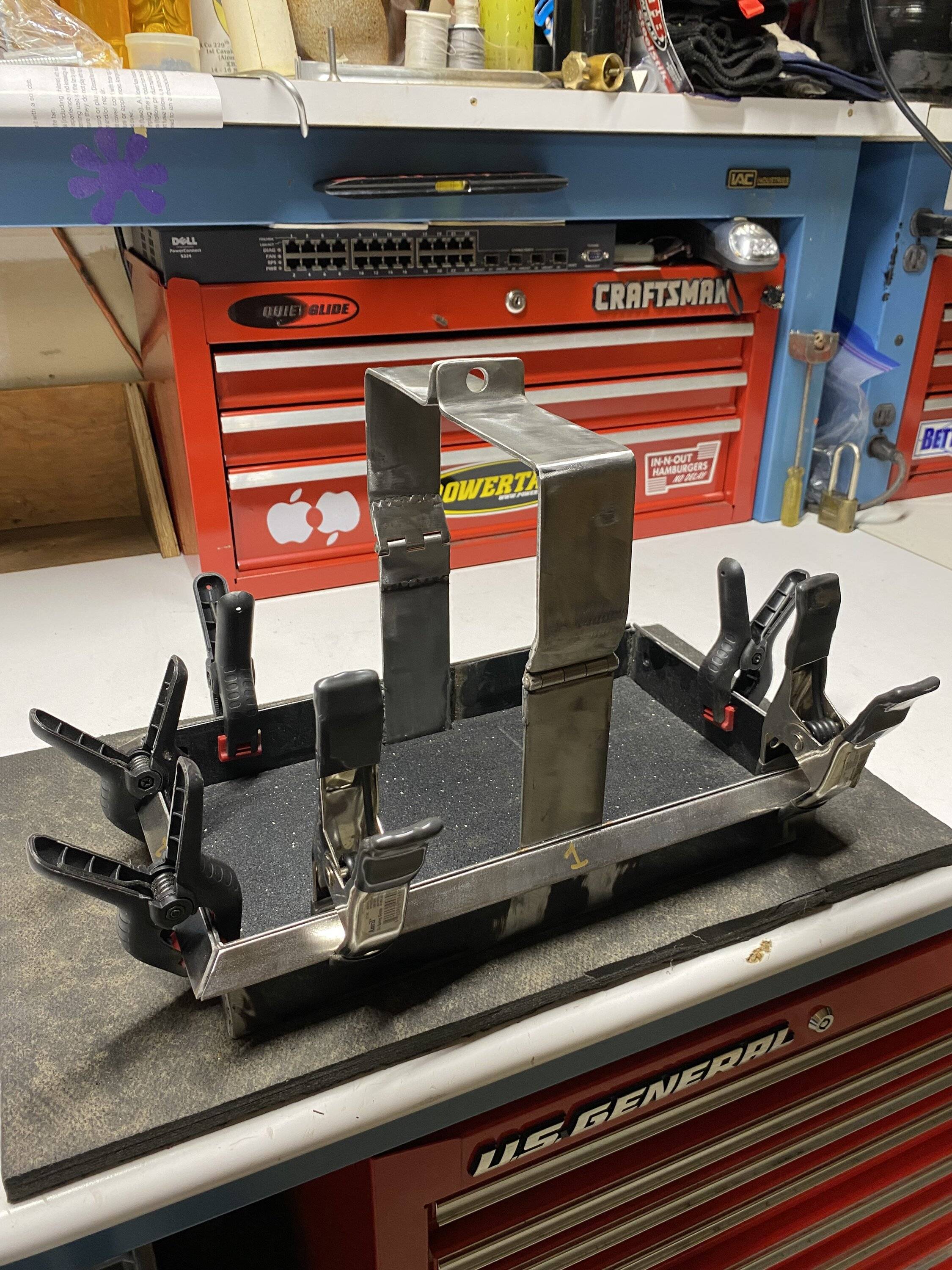

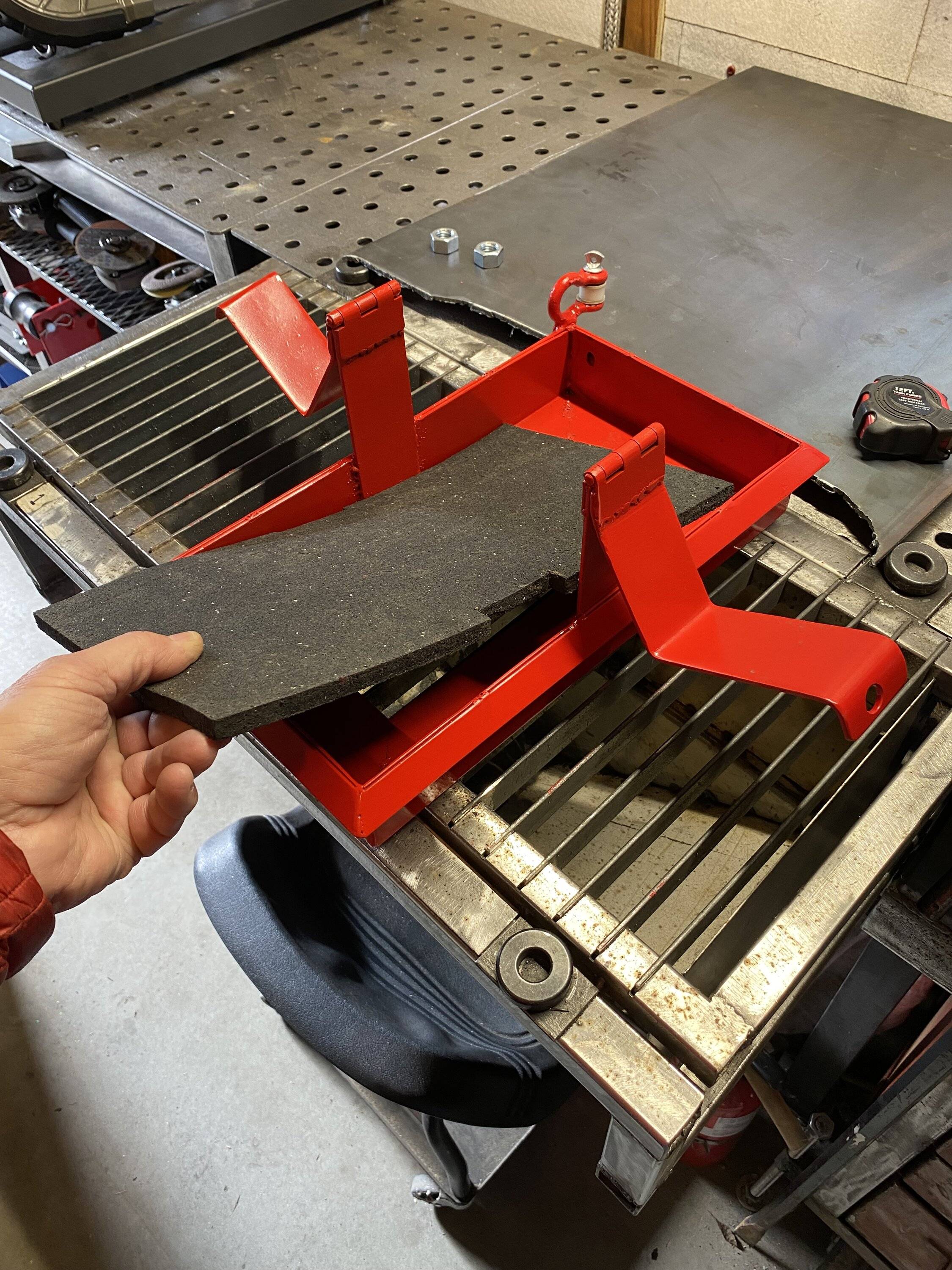

Had some old Klutch table legs 18 gauge, cut and welded them into a bottom for the poly box. Added a boarder of 3/4” x1/8” angle for bumper protection. Added 2” flatbar for lock and hold down of the poly box with battery. welded a shackle to the box, for connecting and holding to factory front tie down. Also added a 3/8” chunk of horse mat, for longer battery life.

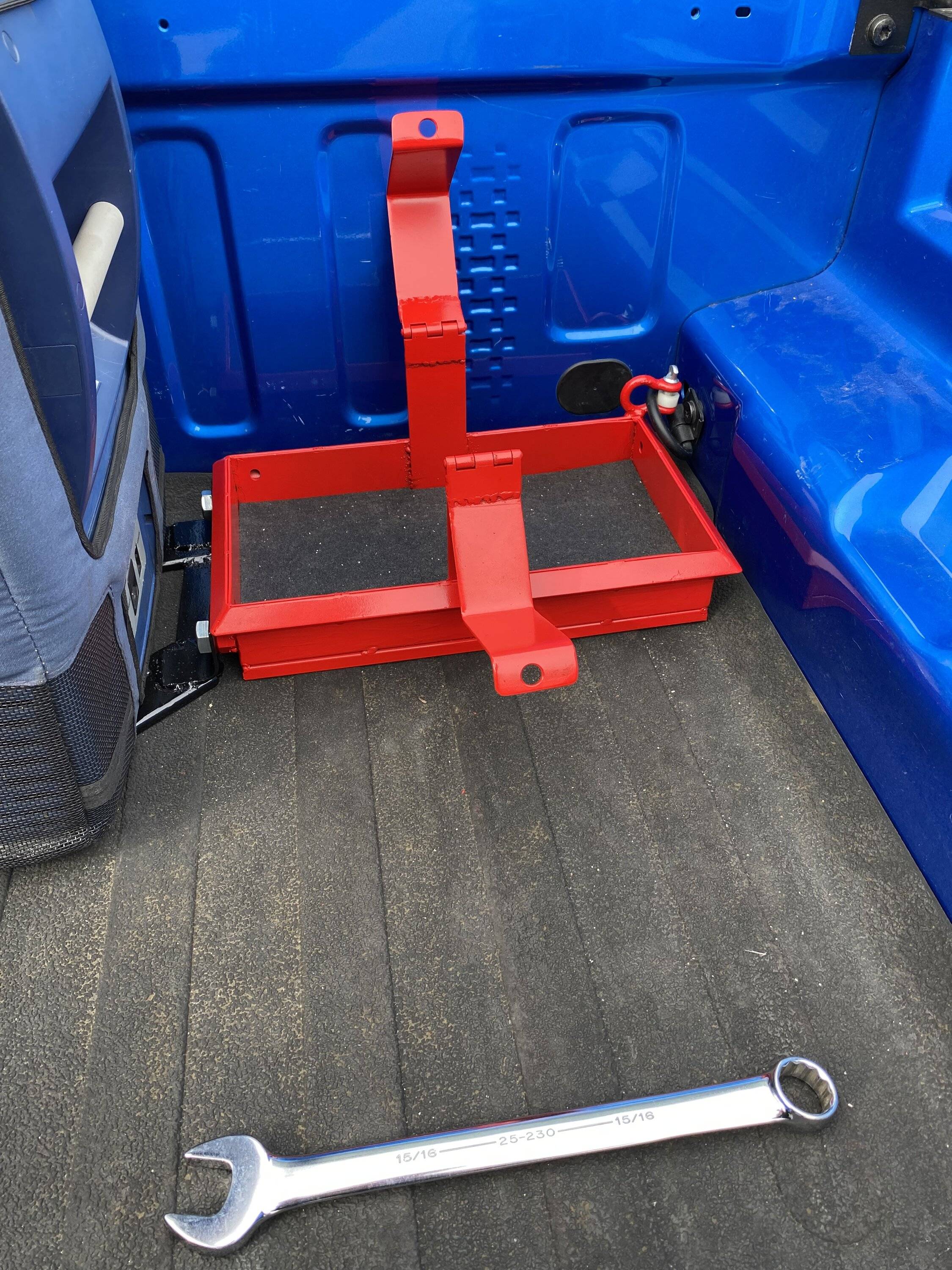

It occurred me during fit up of the new box that my ARB fridge would fit perfectly between the new box and the opposite side of the beds front tie down. Measured the ARBs 4 rubber feet mounting bolts and connect those to the battery box via 2 each 5/8” bolts and another shackle to the front foot mount and the drivers side front tie down.
it’s in there solid, took a wash board road test yesterday with virtually zero movement on the bed pad.

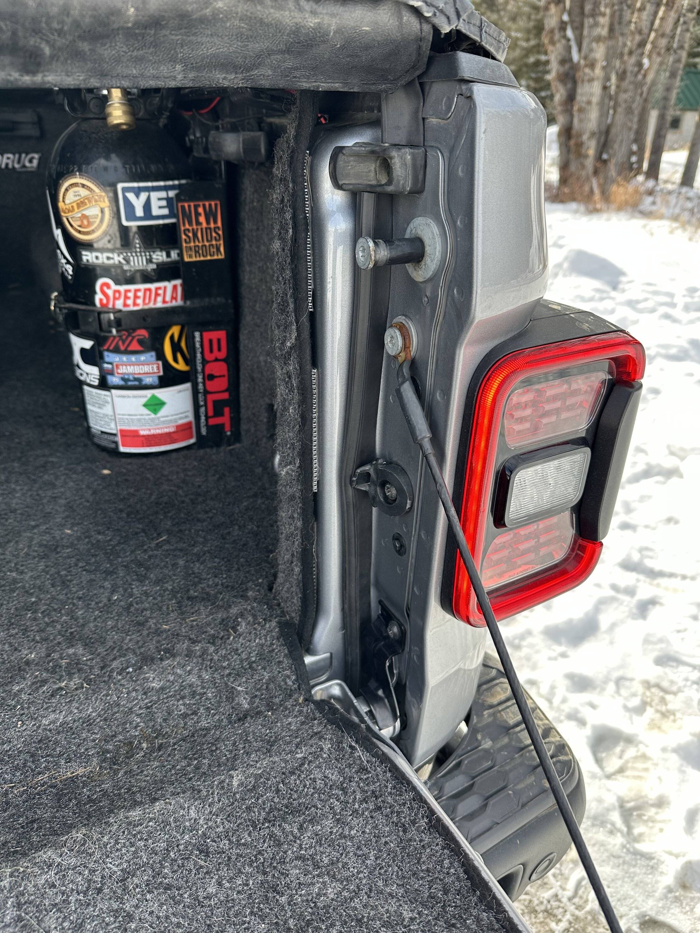

I like the angled co2 mount. I’m assuming You welded that up with some diamond mesh and bolted into trail rail holes? Mine is less elegant.

Yep you’re right on my PT mount.
I almost did full vertical mount, but my bed cover had other ideas
Yep. I didn’t do a 15lb because the 10lb nestled under the bed rail enough to not be too far inside the rail, wasting space. Now that I’m filling my own tanks at home, I’m considering a second tank, minus regulator and handle.
It’s a great system, a friend has several really small tanks, he’s into cart racing…new air lockers front and rear this summer for my jt, already have a manifold for that and it also runs air tools.
