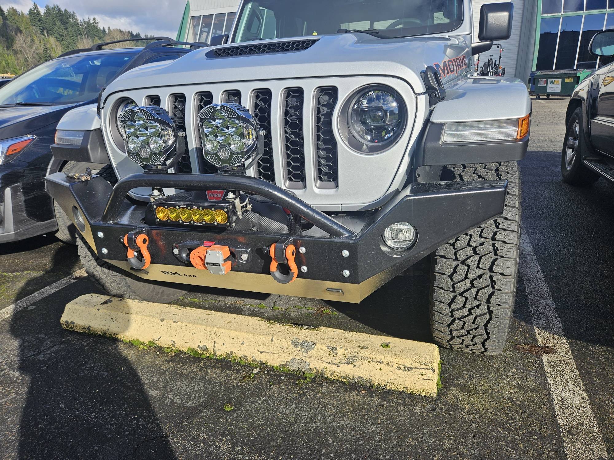

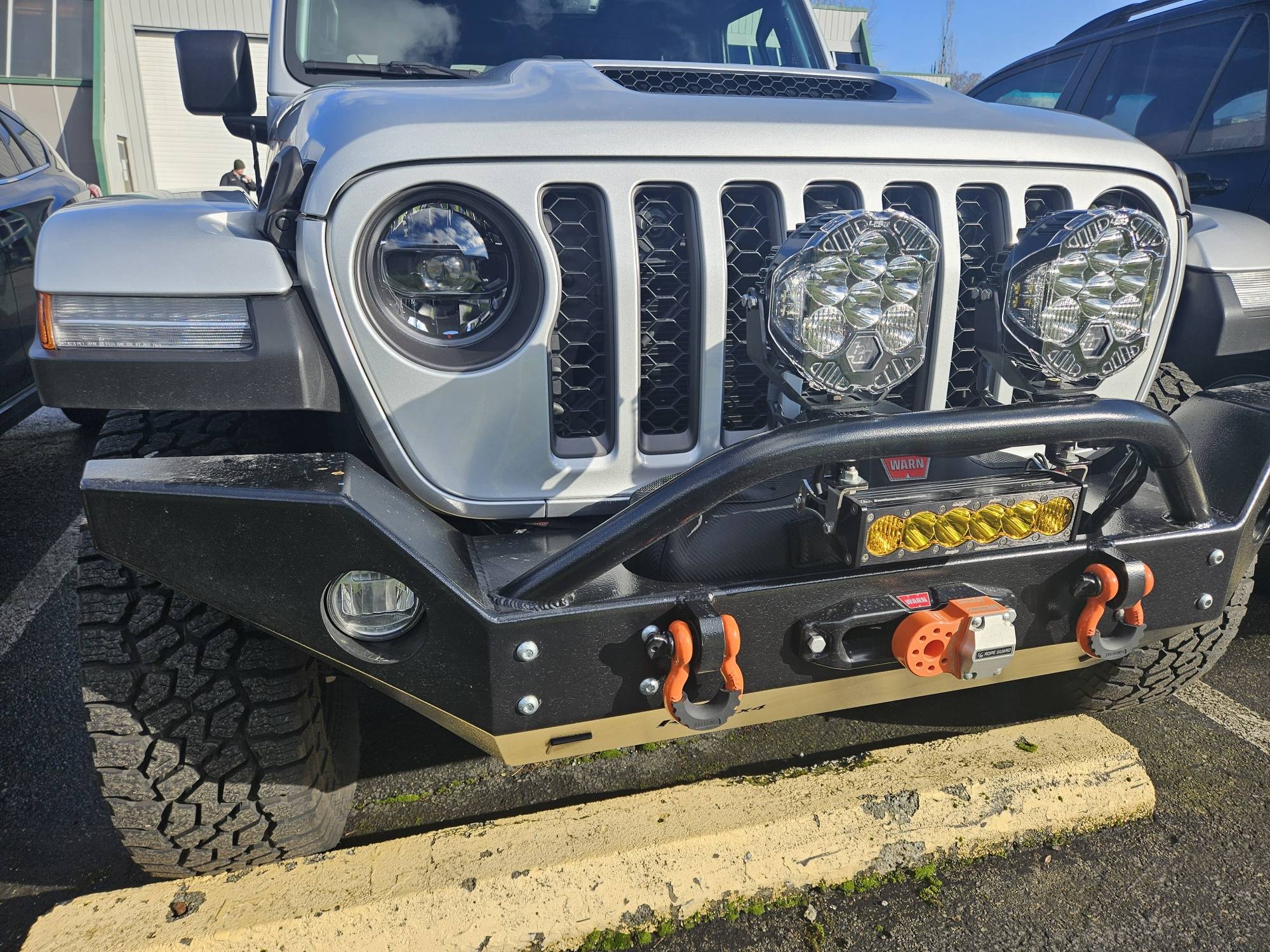

Been working on final touches of installing an Spod BantamX with lights. Baja Designs LP-6's on top, and the OnX6 amber fog light underneath. I fabbed an aluminum bracket that captures both sets using 1 through-bolt, which I will change out with a security bolt. The bull bar and bumper are a Rock Hard 4x4 all aluminum plate bumper (it only weighs 37 lbs!). The HD control panel I mounted overhead on an overhead ACR Molle Panel in the cab.
What kind of hook is that in your authentic line ?
