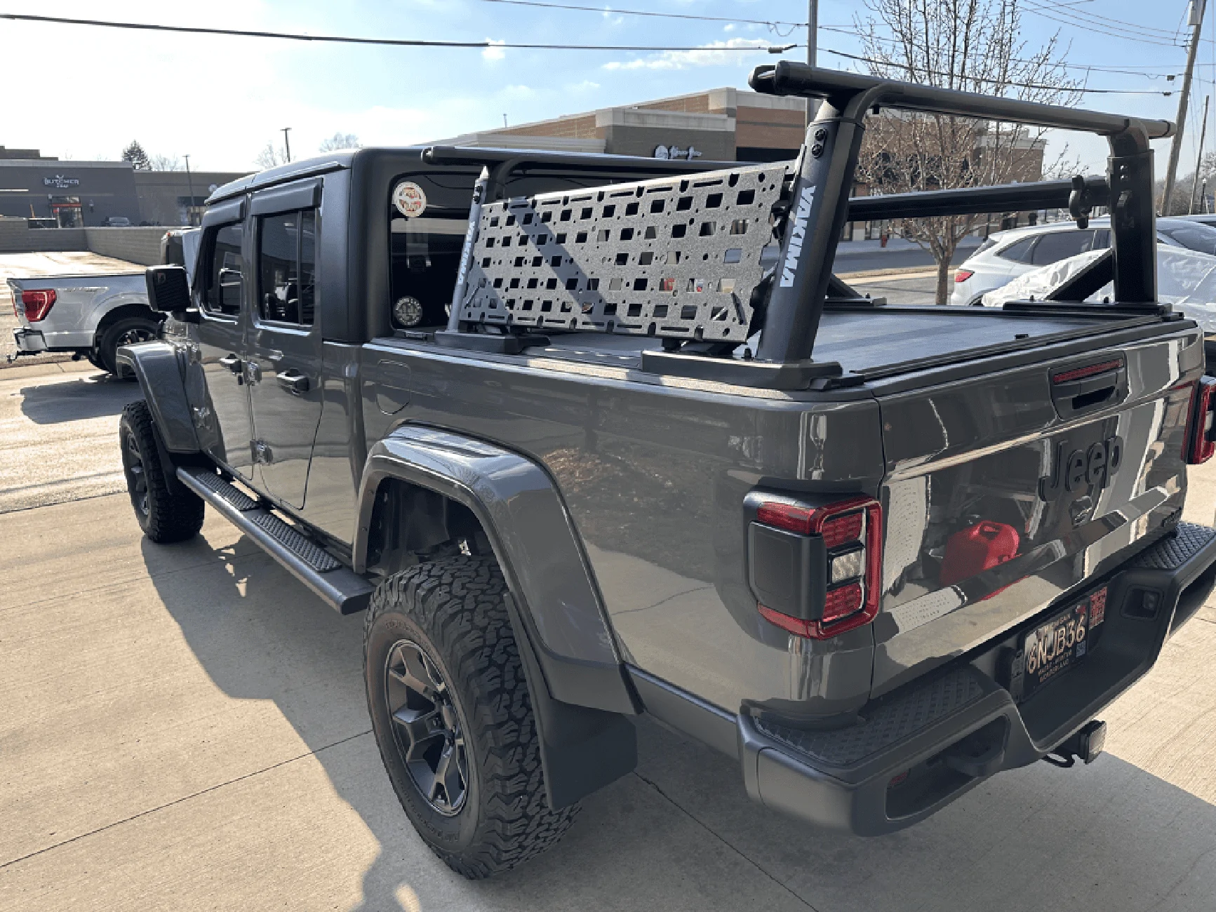

Yakima Rack doesn’t have too many options for mounting gear so I DIY’d a Go Rhino gear plate. Came out awesome. This will be for recovery boards. I’m going to pick up another for the other side to mount various things too.
Jeep Gladiator What did you do TO your Gladiator today? [ADMIN WARNING: NO POLITICS, NO GUN TALK] IMG_8663
