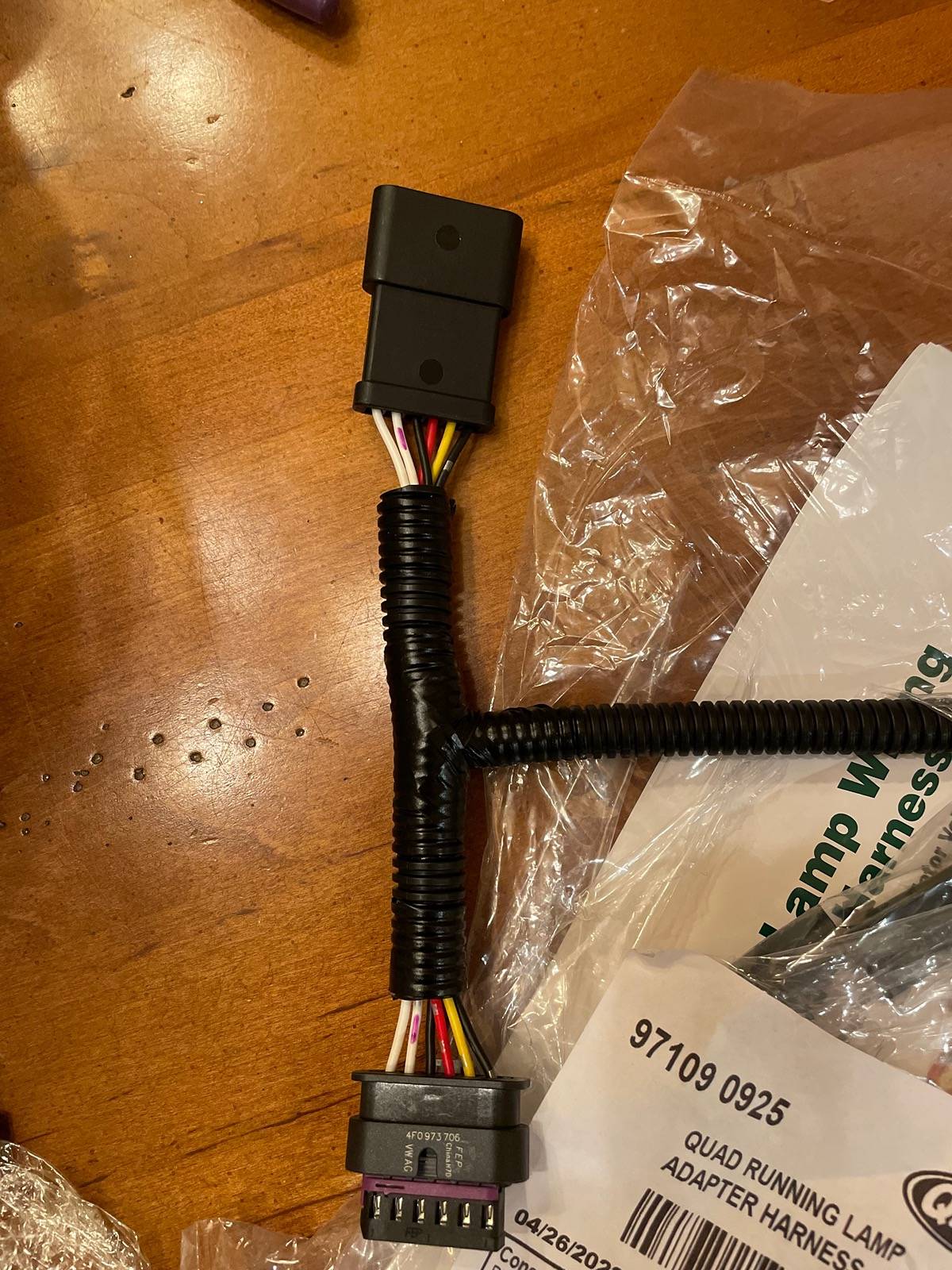

This one works great from quadratic. I have LED.
Here is a picture of the correct wire for the blinker circuit, marked with purple sharpie.

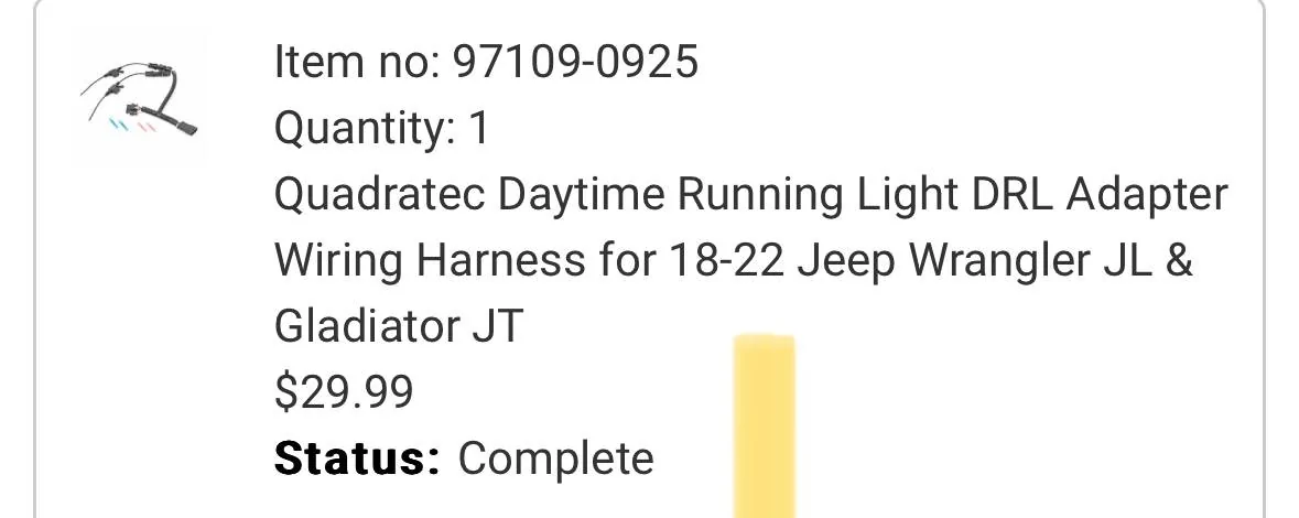

I ordered the
American adventure labs used to make 1. That's what I have.
JCappy
Oct 19, 2023
661
869
Canton, Ga
2023 Sarge Green Mojave
I do have factory LEDs, and I had just noticed that as well. I sent them a message. Do you have your invoice somewhere that might have a model number on it?
OK so here's the scoop. Apparently I'm a bonehead. So I found my invoice and the part number on the invoice is the same as the part number listed on their website that states it's for non LED headlights. I guess I missed that when I placed my order. But the harness works flawlessly with my LED headlights. I guess I got lucky. Either that or they updated the harness and not the description. Who knows. I actually called them today on my break to see if I could get more information about the harness listed but the person that answered the phone didn't have an answer. She gave me another number to call for technical issues but I didn't get around to calling the other number. It's also interesting that the price is $10 less now than what I paid back in March. Sorry I don't have any other information that can help you.
