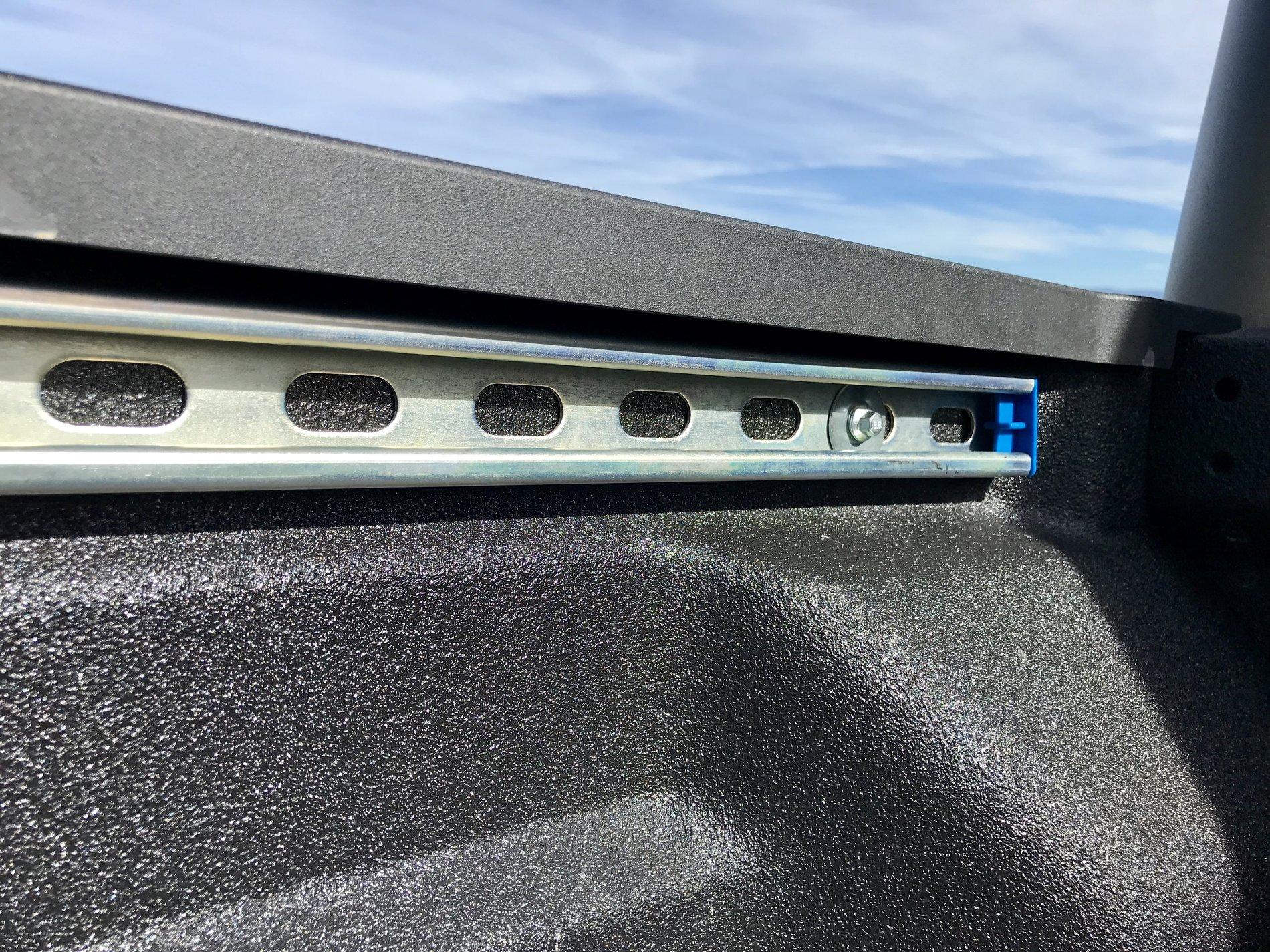

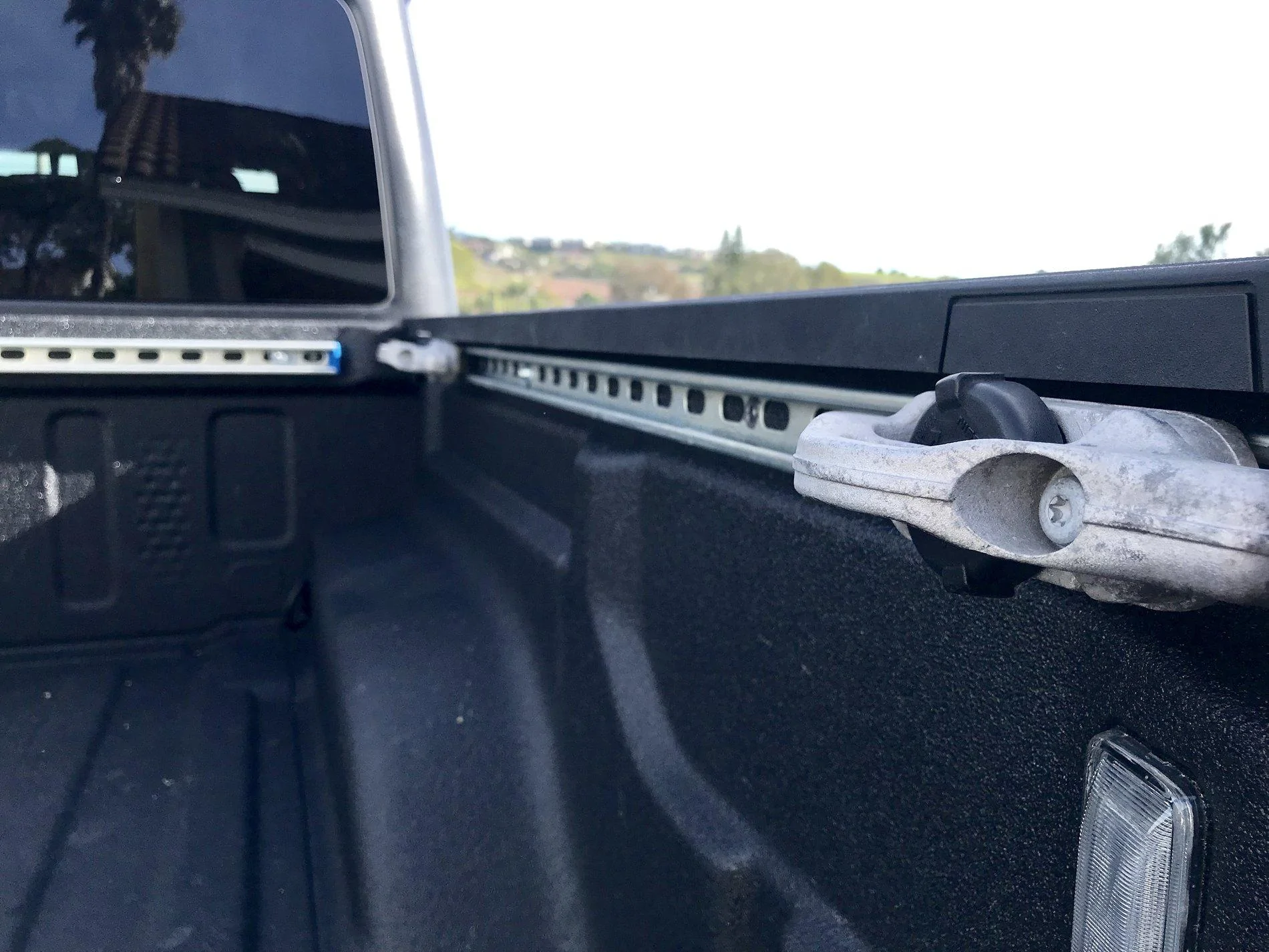

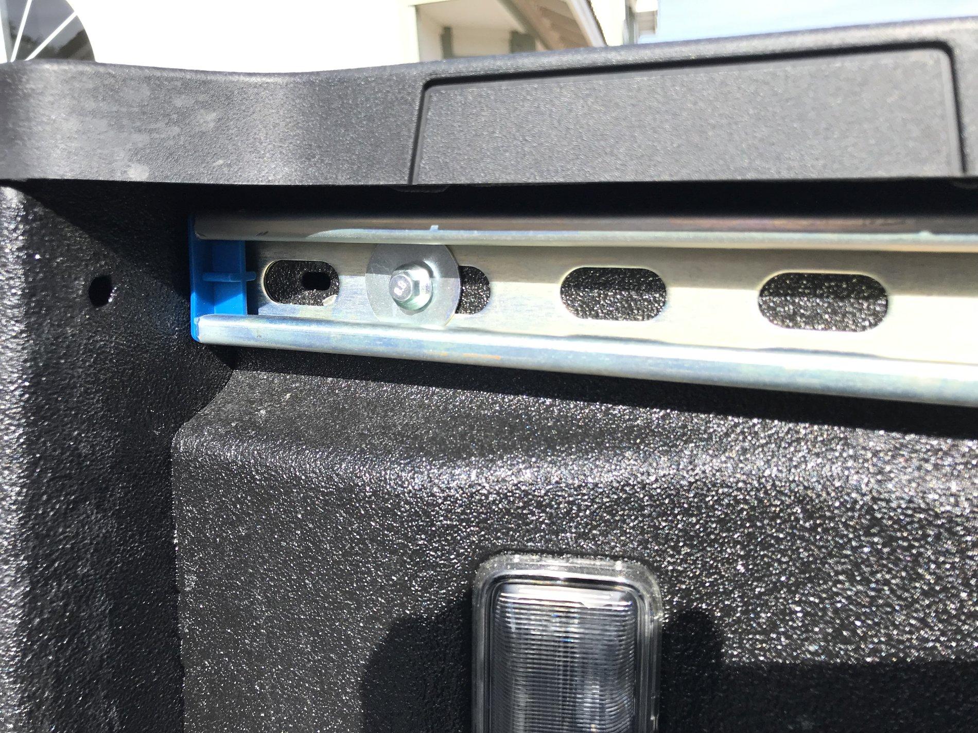

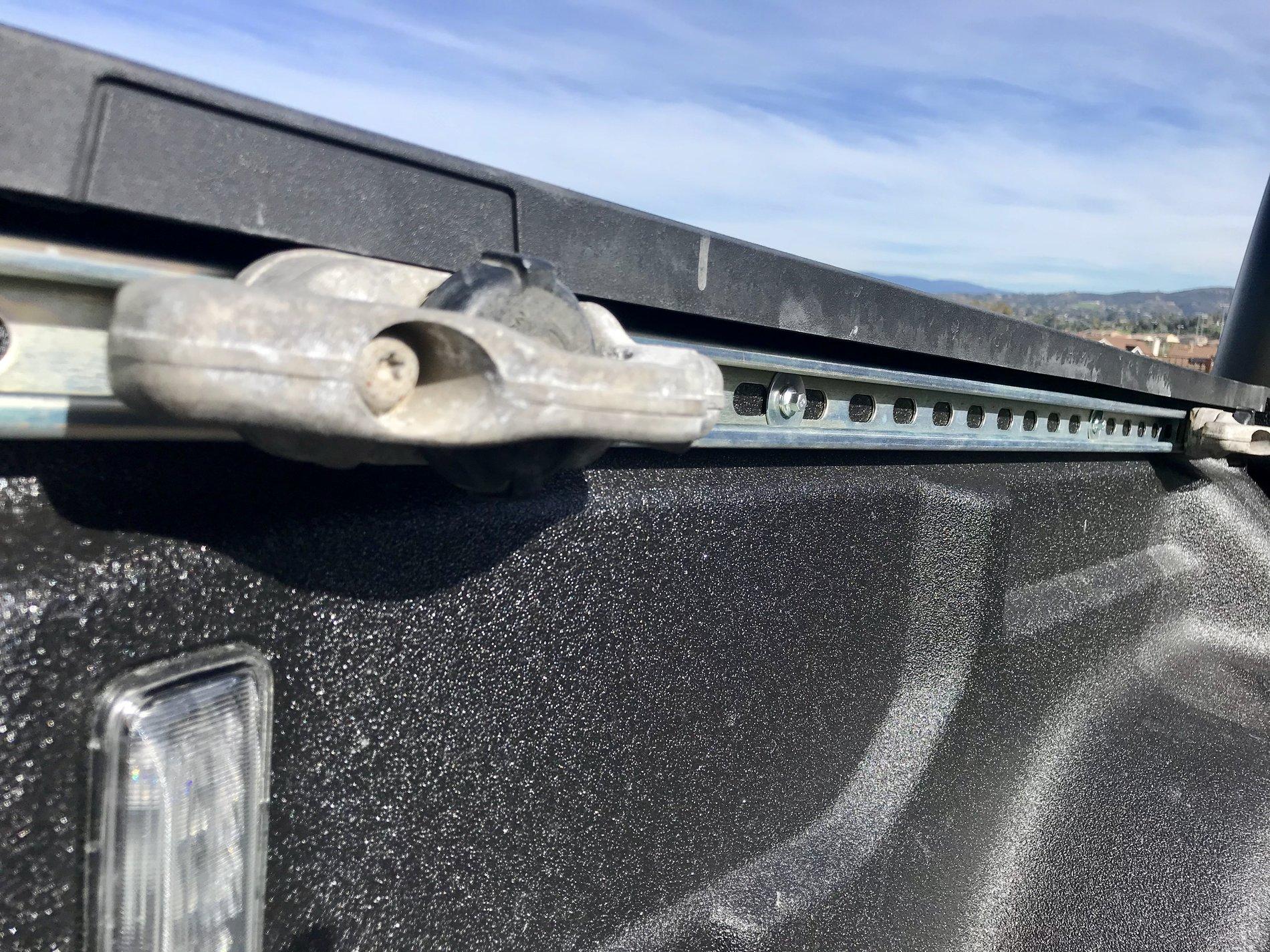

curious if you have a parts list for the rails, endcaps, and bolts you used?
I have a parts list here, I posted a half-arsed DIY
The rails are are standard Super Strut B, at the big orange home improvement store they come in 10’ lengths. So I had to by 2 of them, not bad considering all in the cost was around $50 for the rails, end caps, bolts, split washers and washers.
https://www.jeepgladiatorforum.com/forum/threads/bed-rails-on-the-cheap.26238/

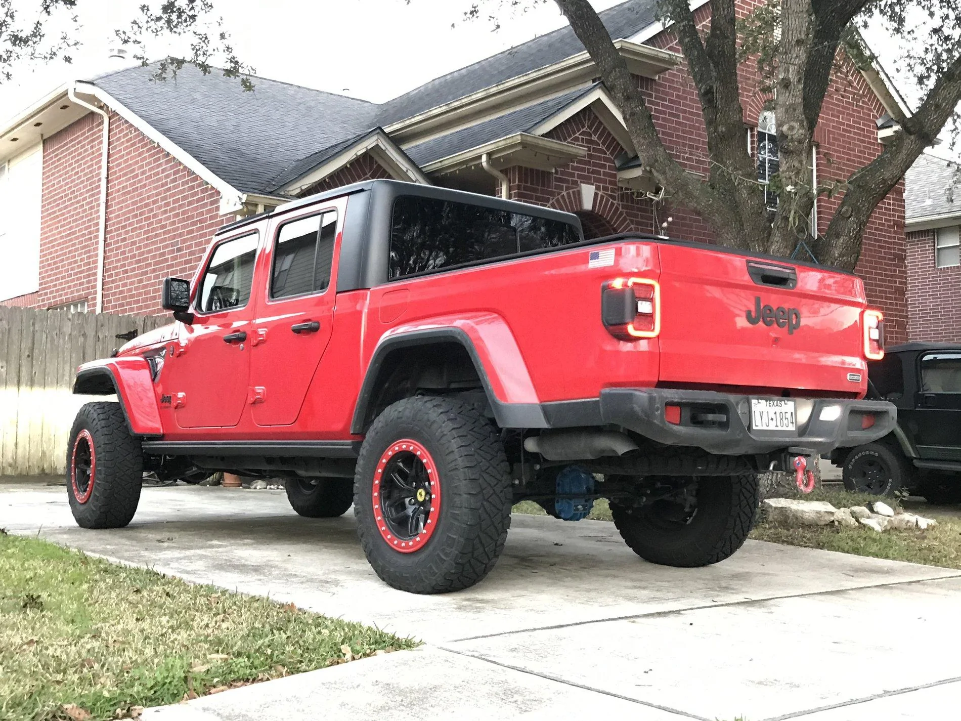

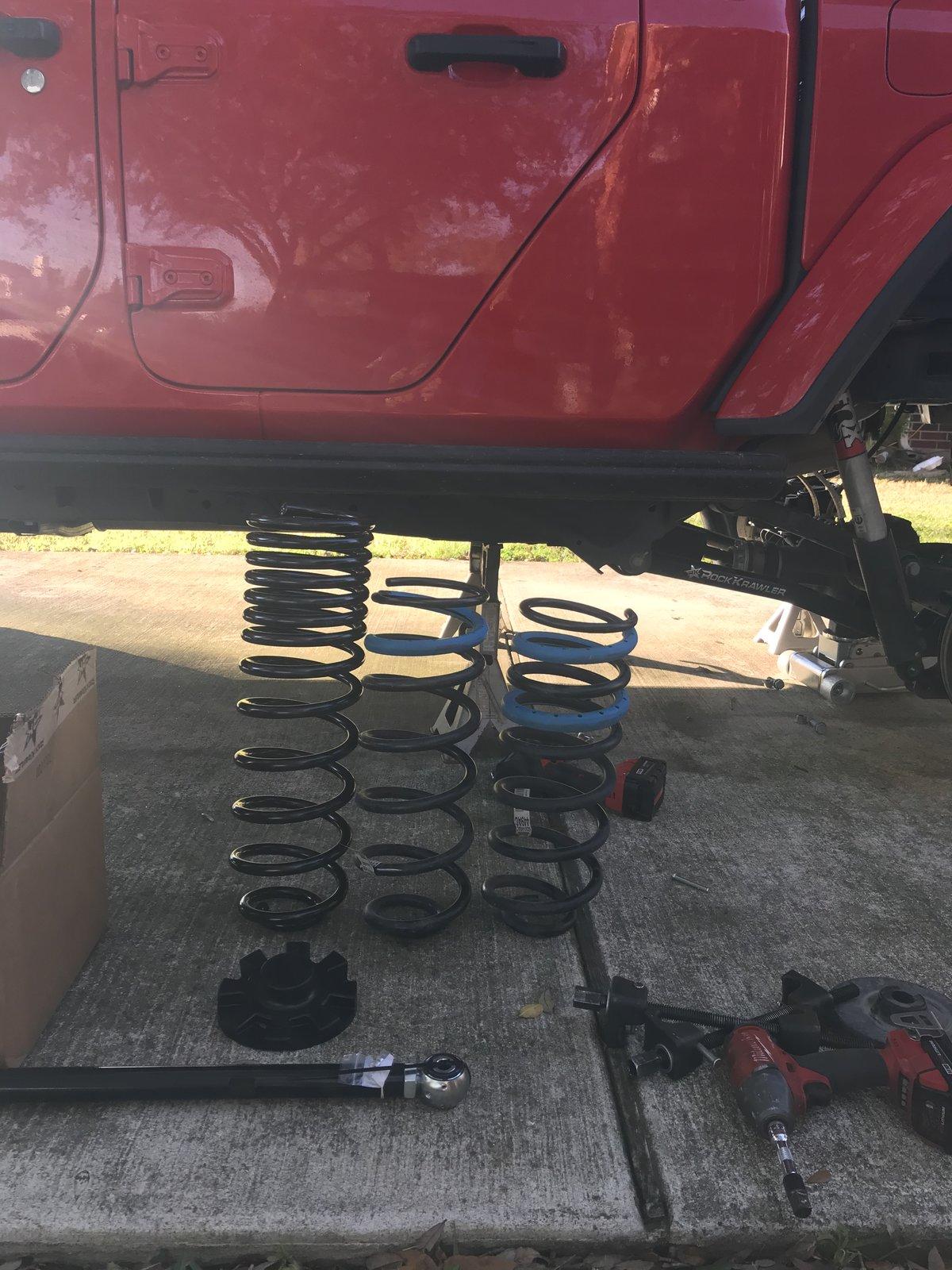

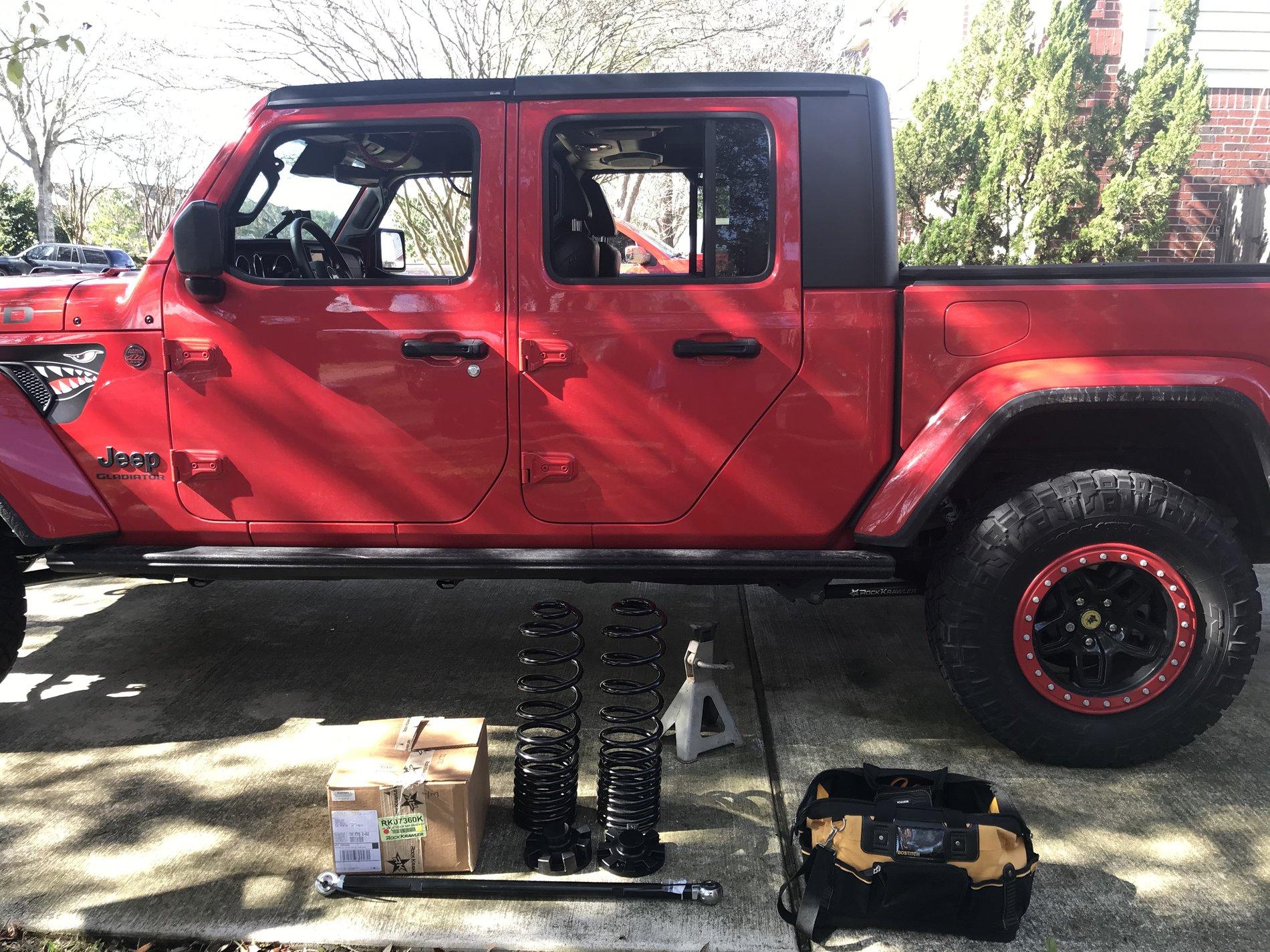

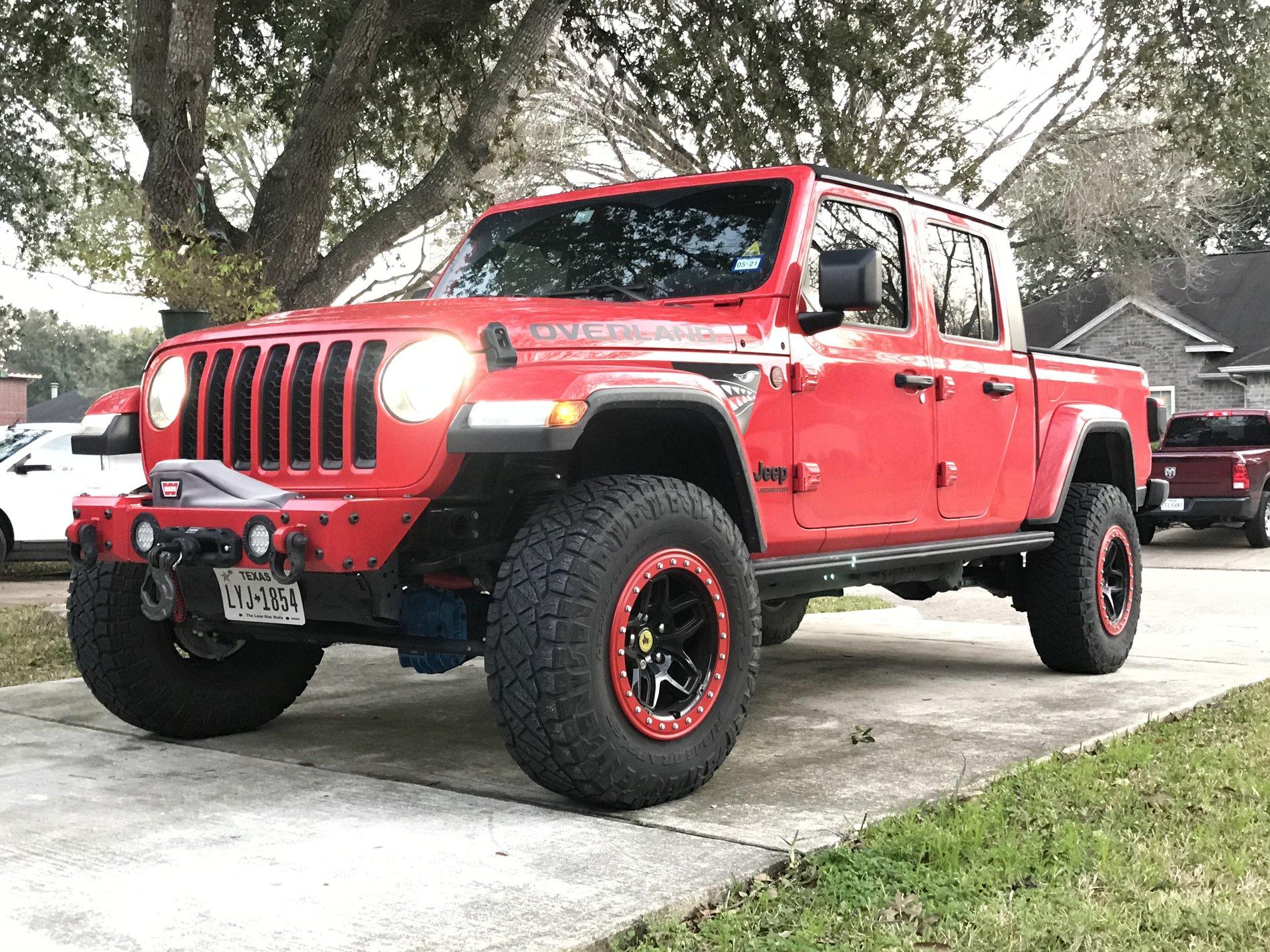

Installed my Rear Rockrawler 3” springs and spring correction pads these springs are long & being bigger around than any Wrangler spring, i just used my spring compressor. I ran out of time so i couldn’t install trackbar relocation bracket & my adjustable trackbar. So now i have these 3” springs all around & it drives super good.
I'm hoping to "re-spring" mine soon - what compressor did you use? I'll have to check and see if any of mine will work - they may not because mine are car specific to some extent. The springs won't necessarily be longer but compressing is faster than more disassembly and jacking it higher.

You can use ratchet straps, too

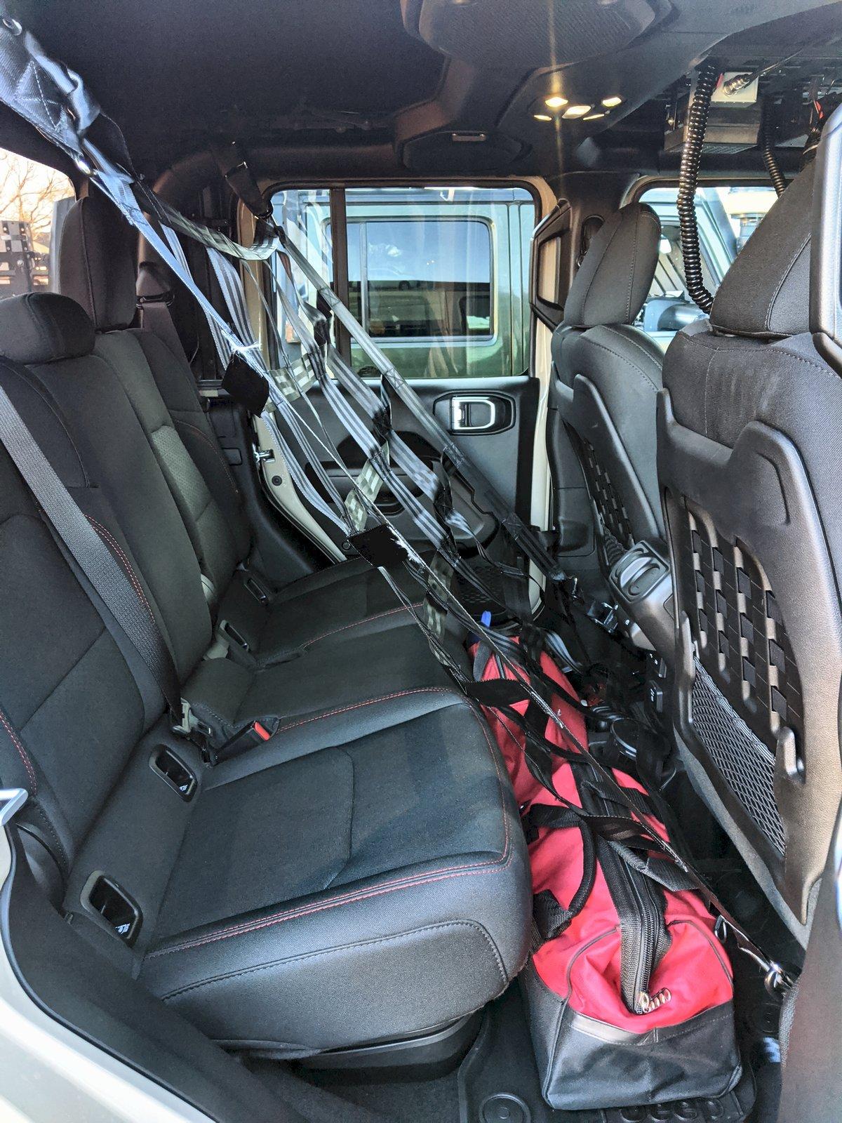

Rigged up a cargo net in the rear seat. This area is used during my overlanding trips for clothing stuff sacks and photography gear (I carry lots of photography gear). The net gives me a touch of assurance that in the event of a sudden stop, the gear will mostly stay in place. This one is from Amazon and made of seatbelt material. I have another one from Safari Straps which is made from heavier canvas material. Sadly, Safari Straps no longer offers the size suitable for this.
