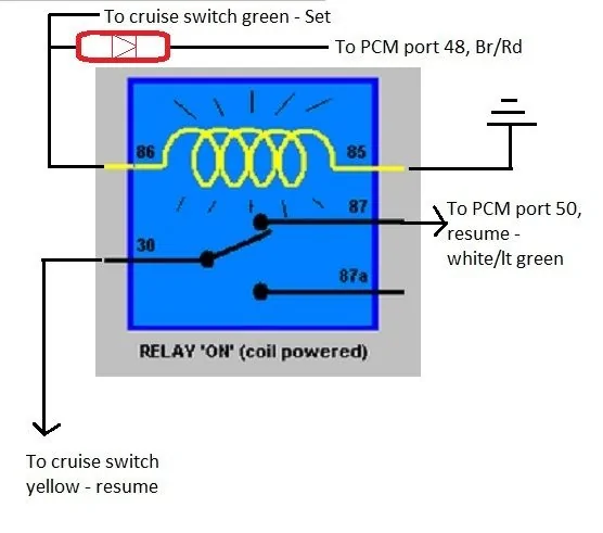

Yes that's the ticket, but I would use a normally closed contact (NC) to run one side of the the license plate light circuit through, the reverse light would power the coil that would trigger the NC contact to open thus turning off the license plate light when the reverse light came on.
LOL - yeah, I should have typed NC because you can't OPEN NO contacts. I screwed that up.
The back up lights coming on would energize the coil, and open the contacts breaking the license plate light circuit.
A GOOD relay will come with a diode built-in across the coil to prevent "feedback" into the circuit when the field collapses around the coil so it should be ok in that way.
This is a schematic I came up with to make an AMC cruise control switch operate a 94 Jeep cruise control - the switches were VERY different - the PCM expected very different signals, they were not just opposite, but some were combined in different ways. I wanted to use the Jeep cruise in my car but use a stock NOS switch that I had - so I put this circuit in. I had pics of the end result somewhere, but bottom line, my cruise works perfectly now, the PCM gets what it expected and yet people see the correct factory switch on the stalk.
Thanks, this helps my brainstorming on a similar “great idea”: making aftermarket rear lights come on in Reverse or with Aux switch, while the backup lights only on in Reverse and NOT with Aux. Essentially adding additional rear white lights that serve as a second set of Reverse as well as scene lights, while the backup lights only energize in Reverse.
