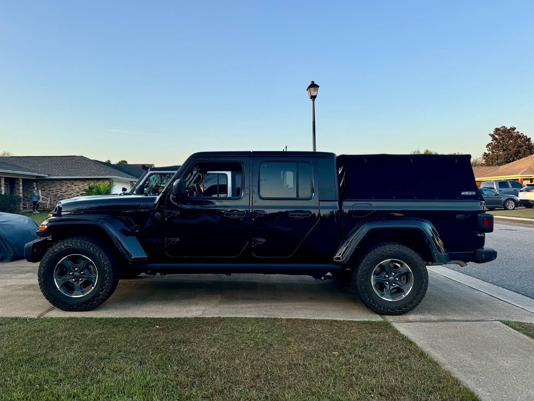

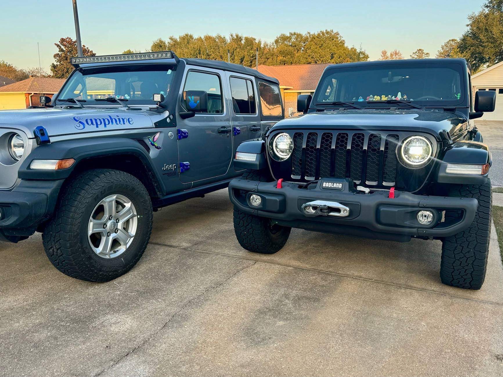

Today I installed the Teraflex 1.5” leveling kit on my Gladiator. After installing a new bumper and winch last week the front was drooping a good bit - hence adding the leveling kit. I went ahead and did the full inch and half.

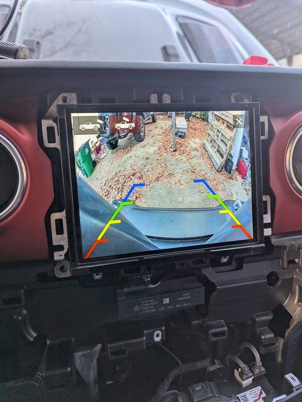

Installed an front camera, I put the dash back together after the pic was taken.
Just need to adjust the camera in the morning after the epoxy dries for the camera mount.

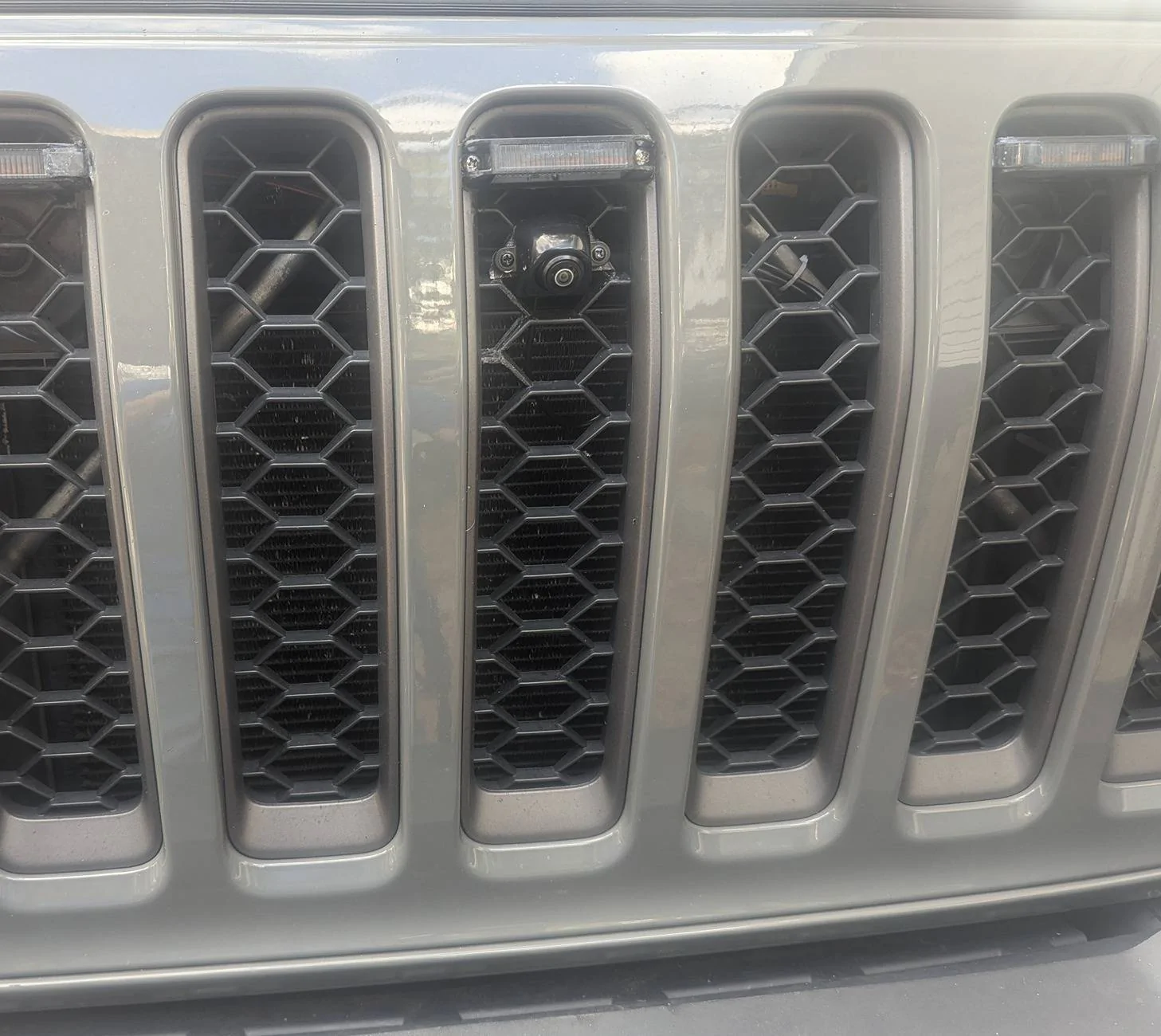

Finished the camera install!. Not bad for $65-ish.

I see yours is running through the vehicle's camera system. What camera did you use?
Its a $30 Amazon camera )GeenYi brand) to get the feed to the screen I ordered the $30 ZAUTOMOTIVE RCA pigtail that will plug into the radio harness. Then I used jscan to activate the cargo camera and then good to go!
