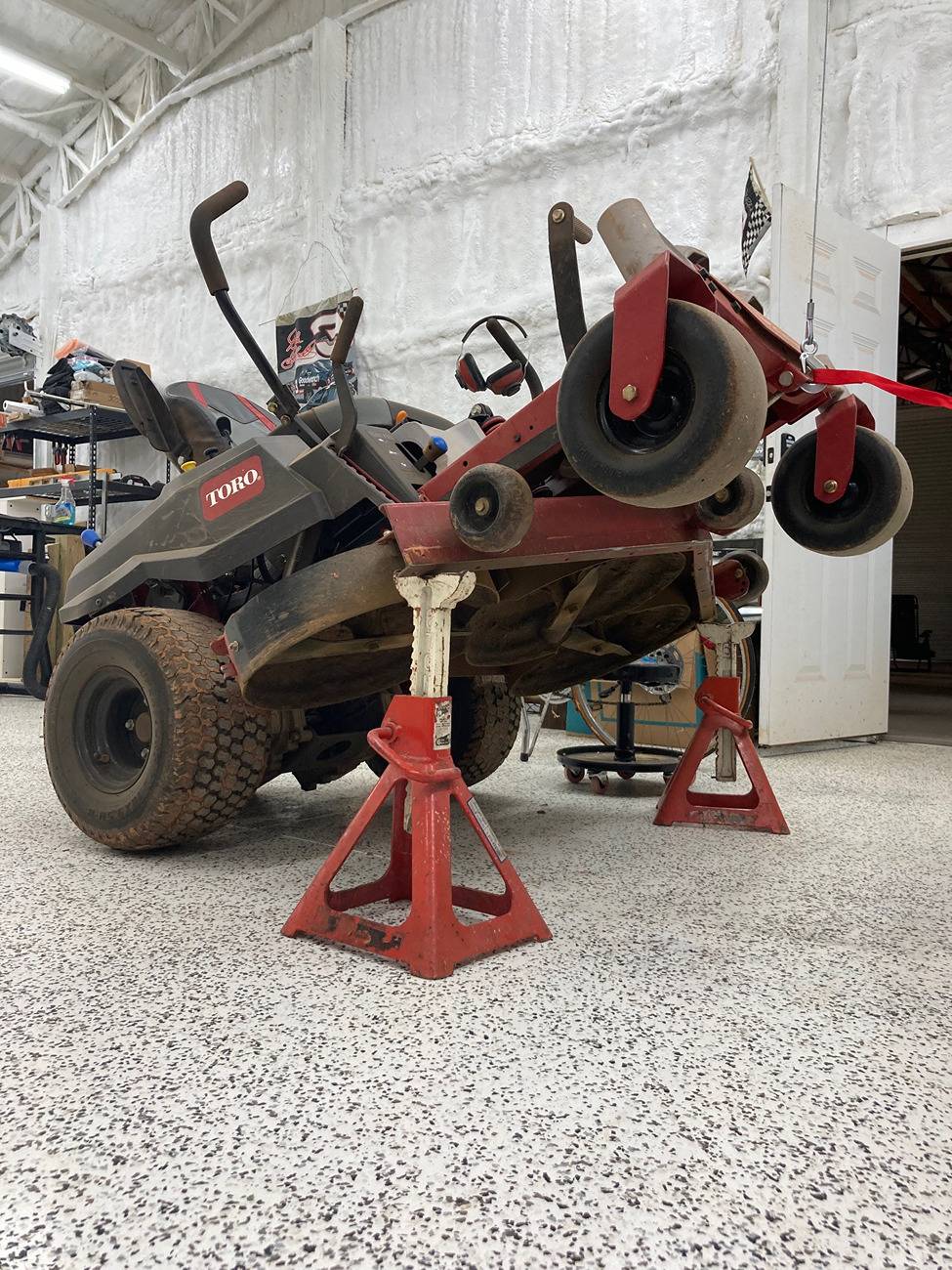

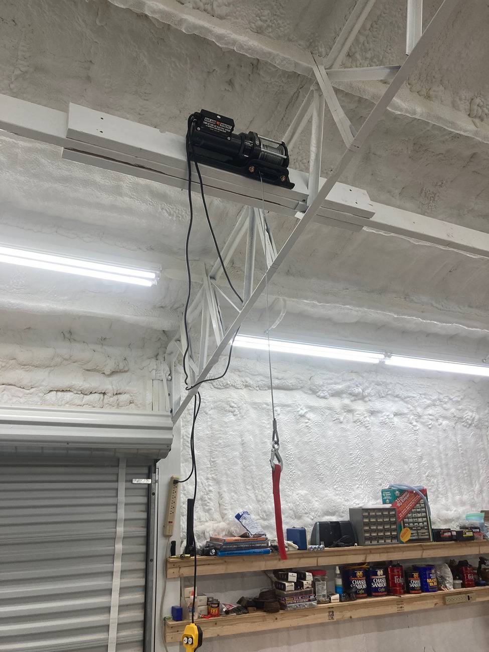

The gantry crane itself will lift a whole sprint car straight up - but the seller kept his chain hoist so I bought this one - good enough for my use - it could lift my SX4 (minus the drive train) up so I could slide the engine and drivetrain under the car and install it all as a unit from the bottom like the factory did.
I have an engine hoist, too - people call a "cherry picker" although I don't know how it would help in picking cherries........... I made that one from plans in a Popular Mechanics many decades ago. It doesn't fold or some apart and takes a ton of space in the shop but it works well for my uses.
Mine definitely won’t lift that much. Super cool.

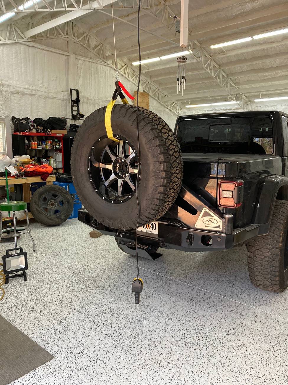

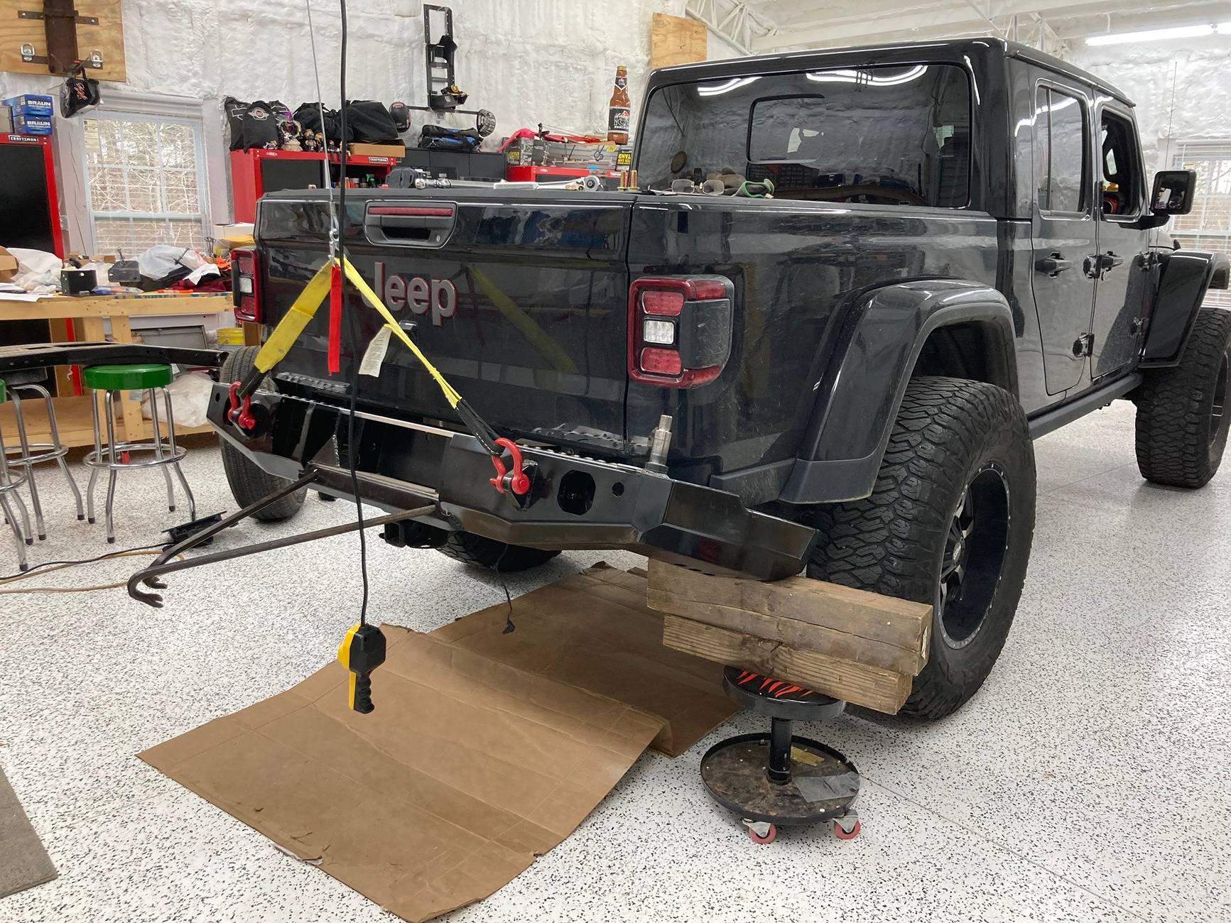

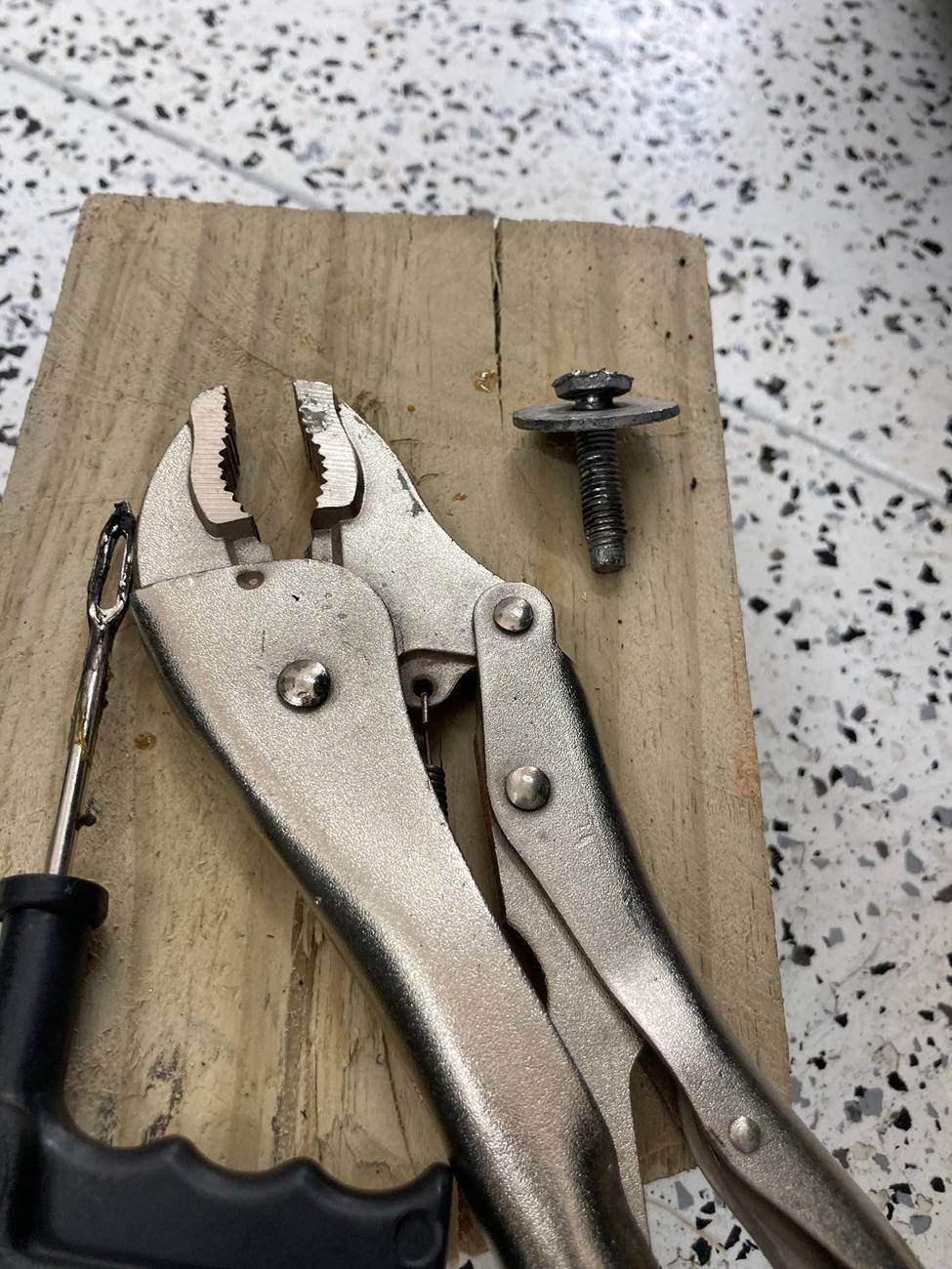

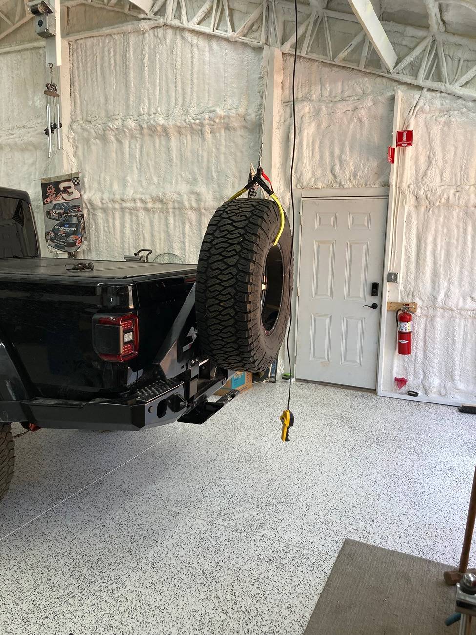

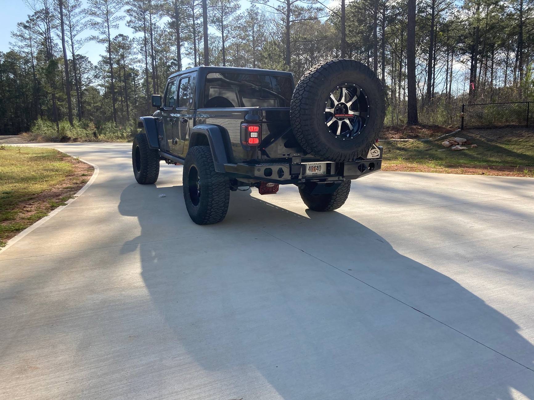

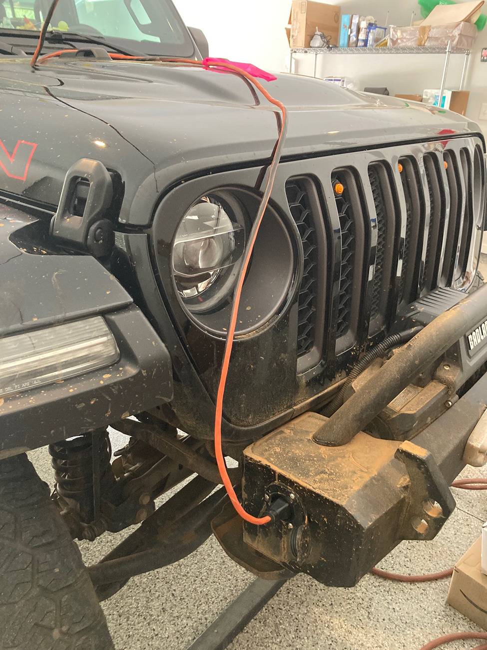

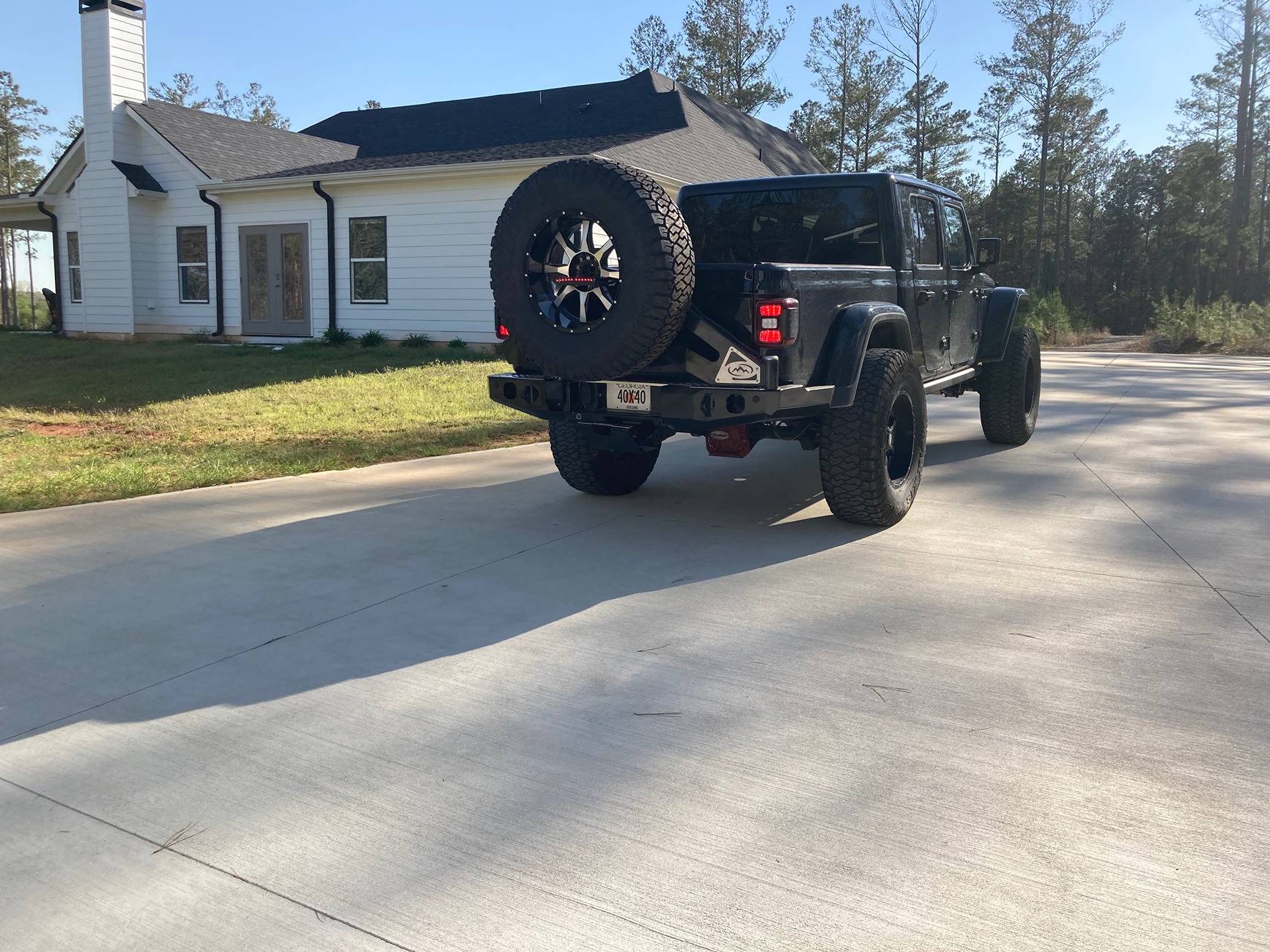

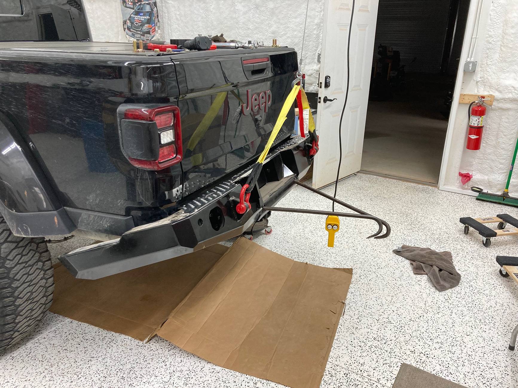

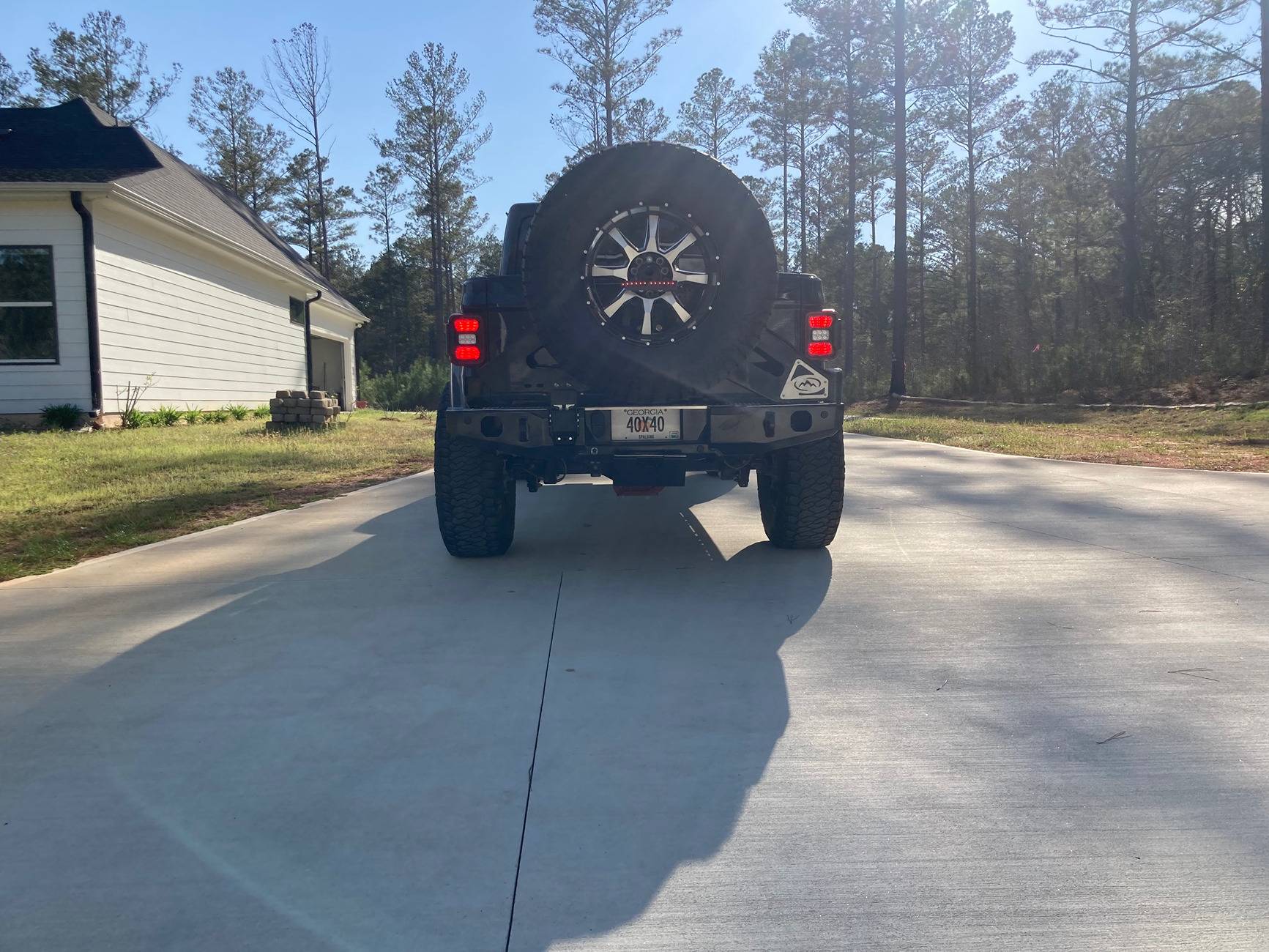

this isn't so much of what i did today but the last 10 days. around memorial day 2024 i ordered from expedition one their bumper mounted tire carrier. they were correct when they said delivery in eight weeks. i painted it immediately with vht rollbar paint and then got involved in a multitude of projects with the house, yard and barn. part of the workshop build out included a 1500 lb electric winch from harbor freight. its primary use will be for mower maintenance but would come in handy for this project. the oem rubicon bumper removal was easy however exp 1 required cutting the harness to add new license plate lights. i opted to crimp on a pair of open spades on each new light, cut one leg of each and insert them into the oem plug. a little wire shrink wrap and black tape later, all was good. when working alone it is easy to develop a 3rd and 4th hand when installing heavy or bulky parts. at about this time the bride comes out and asks "what's in the tire?". so after a brief interruption i finished the spare tire project. i topped it off with a hitch mounted skid plate from body armor. it got a workout at morris mountain off road park in AL this past weekend. it is an excellent venue that the Georgia Jeep Alliance recommended. the 3rd brake light is two 4" exterior LED strips that i got at a parts store. i wired it into the oem 3rd brake light in the same manner as the l p lights. the oem camera is now in an unused sensor hole in the bumper. yes it is low, yes it is off centered, yes it does see the side off the hitch skid. from 1977-2021 i never owned a vehicle with a backup camera. i'm ok with what i have now.

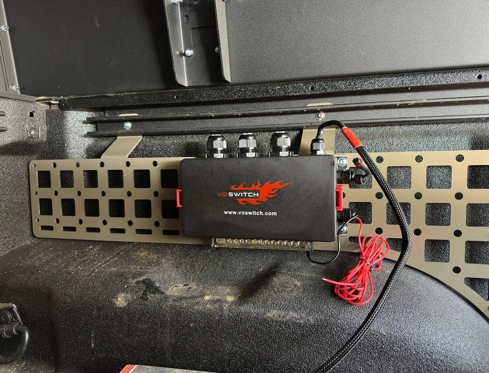

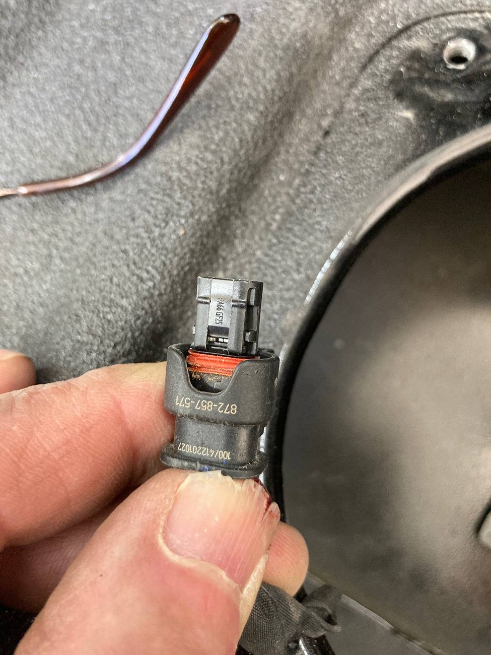

a second delayed project was installing the noco genius 2d charger and AC port plug. i bought this last summer to stave off the inevitable battery death, primary or auxiliary. regrettably the primary gave up the ghost 3 months ago. my new 74 series is on charge every night while the aux was bypassed.
a project i started a year ago was installing an ecomoment gt801 camera system. i did everything then except hard mount the rear facing camera as i wanted to do it after the tire relocation. the unit was wired so it would turn on when the vehicle was turned off. the motion sensor will fire it up if the jeep is jarred. think motel parking lot at 3am.
now before the haters start hating i know about extra weight behind the rear axle. view it if you will as constantly pulling a trailer with a 250 lb tongue weight. additionally i do not engage in high speed whoopie-doos so i shouldn't fold the jeep in half. it is a nice piece of mind knowing that i now carry a full size spare. 40" spare.

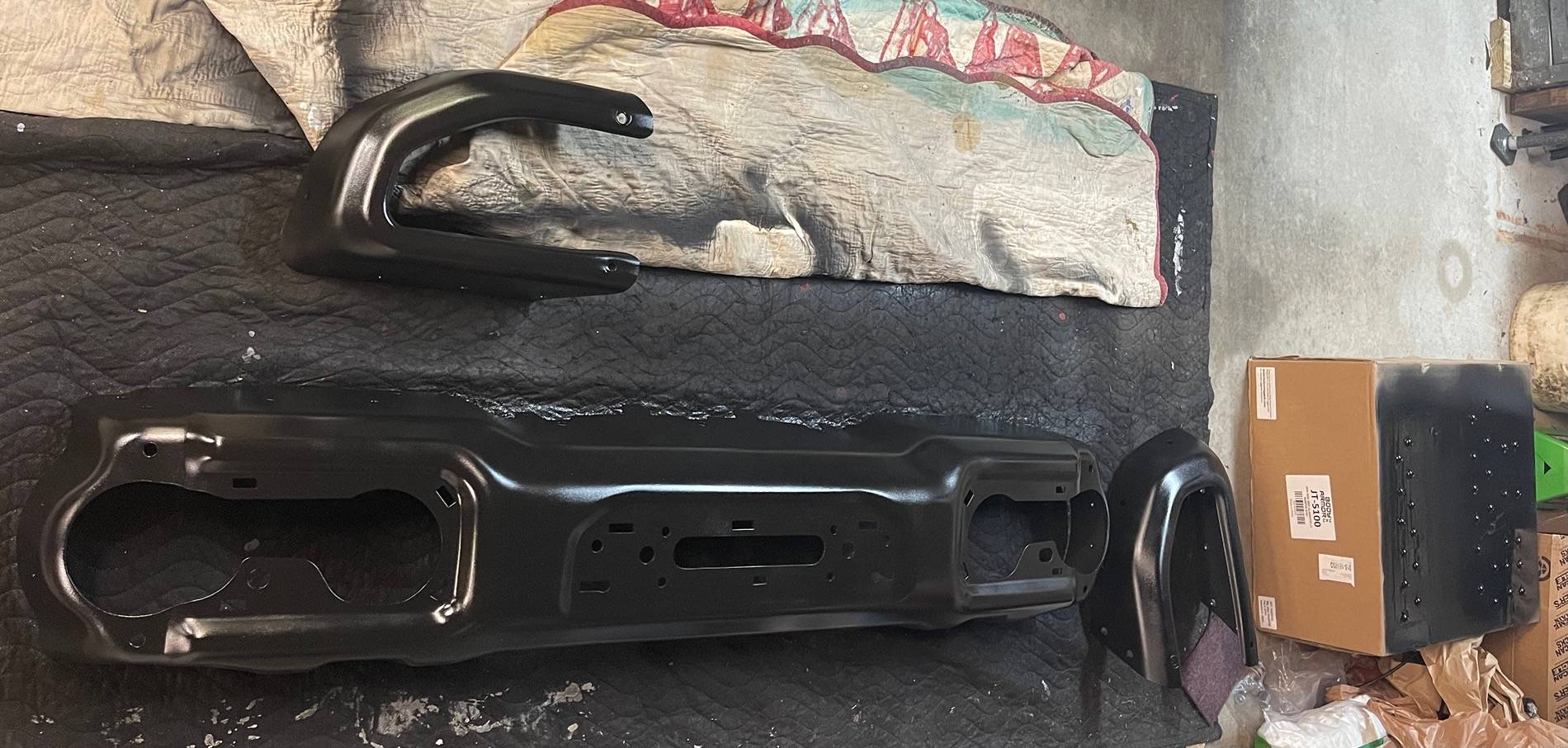

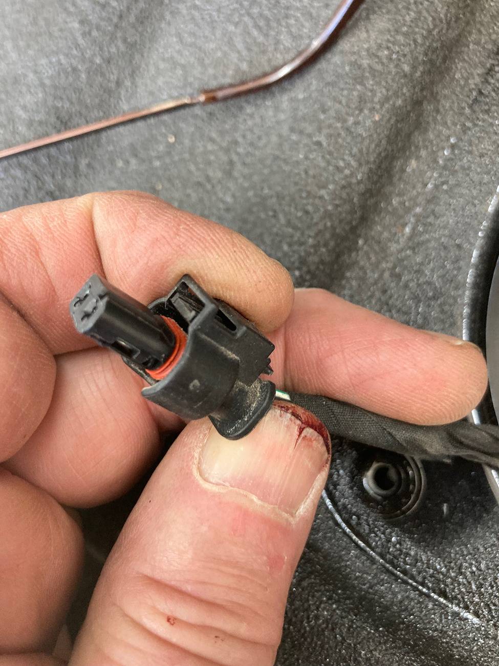

Very minor continued stripping and returning to stock for trade-in.
But the front license plate back on
Finished taking off hood struts, put the original non-locking hood latches back on, removed the diode and auxiliary backup light pigtail from behind the right tail lights. Tried working under to take out the bumper-mounted backup lights but the damn dizzy sickness set in again so didn't get them out.

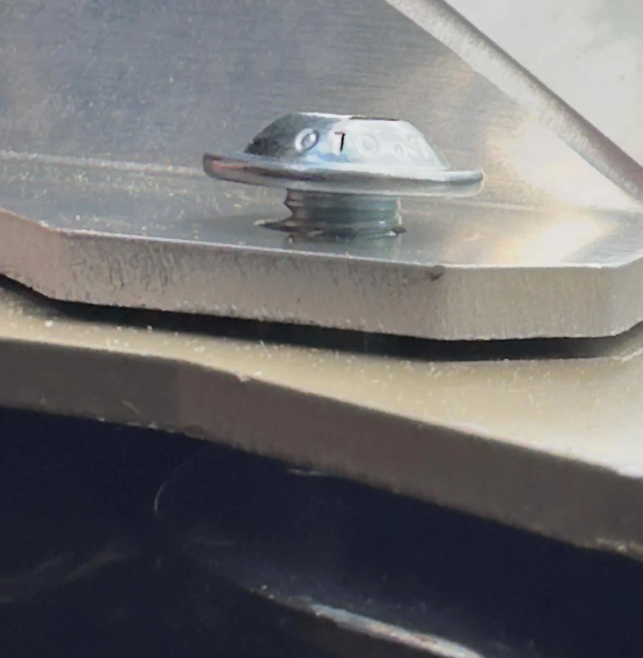

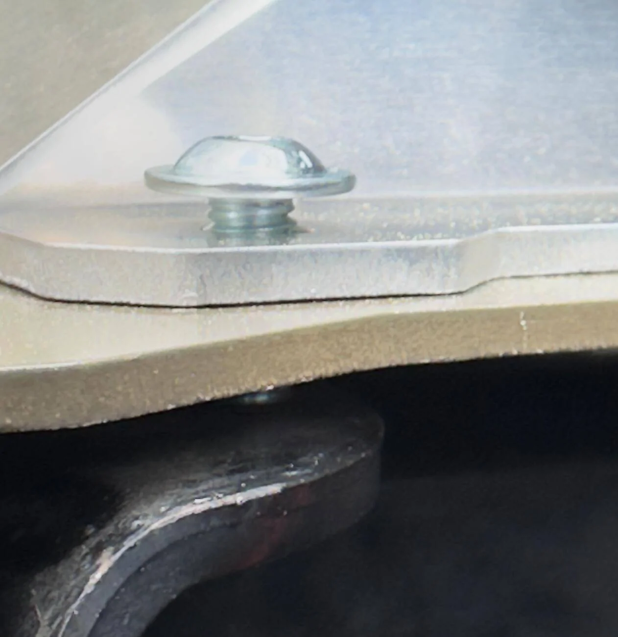

I’m regretting purchasing this MP concepts bumper. It’s been nothing but a PITA. The winch plate is junk and I couldn’t get it to line up after many hours of messing with it and even modifying it. For my sanity, I order a Warn winch plate. It’s stronger and a better design. Now, I’m really not happy with the finish. The flat powder coat scratches super easily. Since, I’m waiting on the new winch plate, today I pulled it all apart and repainted it. I’m on the fence if I’m going to clear it. I might let it cure for a week and clear it or I might leave it. Anyway, several hundred dollars later, I should have just bought a different bumper. $400 for the winch plate and $80 worth of paint and supplies. It’s a sunk cost now and I’m making the best of it. I’ll probably end up clearing it. I already bought the flat clear and that semi gloss is shinier than my rear bumper. Oh yeah, I painted the bolts too because the finish was poorly adhered and coming off.
I’ve been really pleased with the quality of my body armor rear bumper, but I cannot recommend this MP Concepts front bumper. I wish I’d read more reviews. I saw a lot of similar complaints when I was looking for some work arounds to the issues I encountered.
