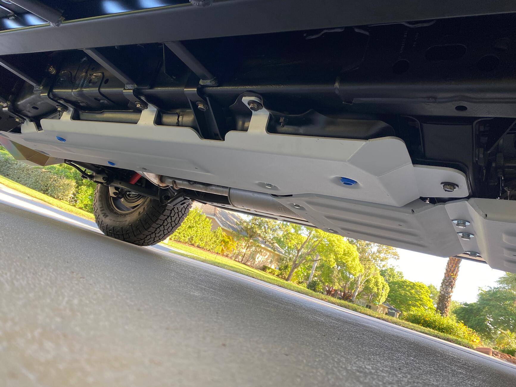

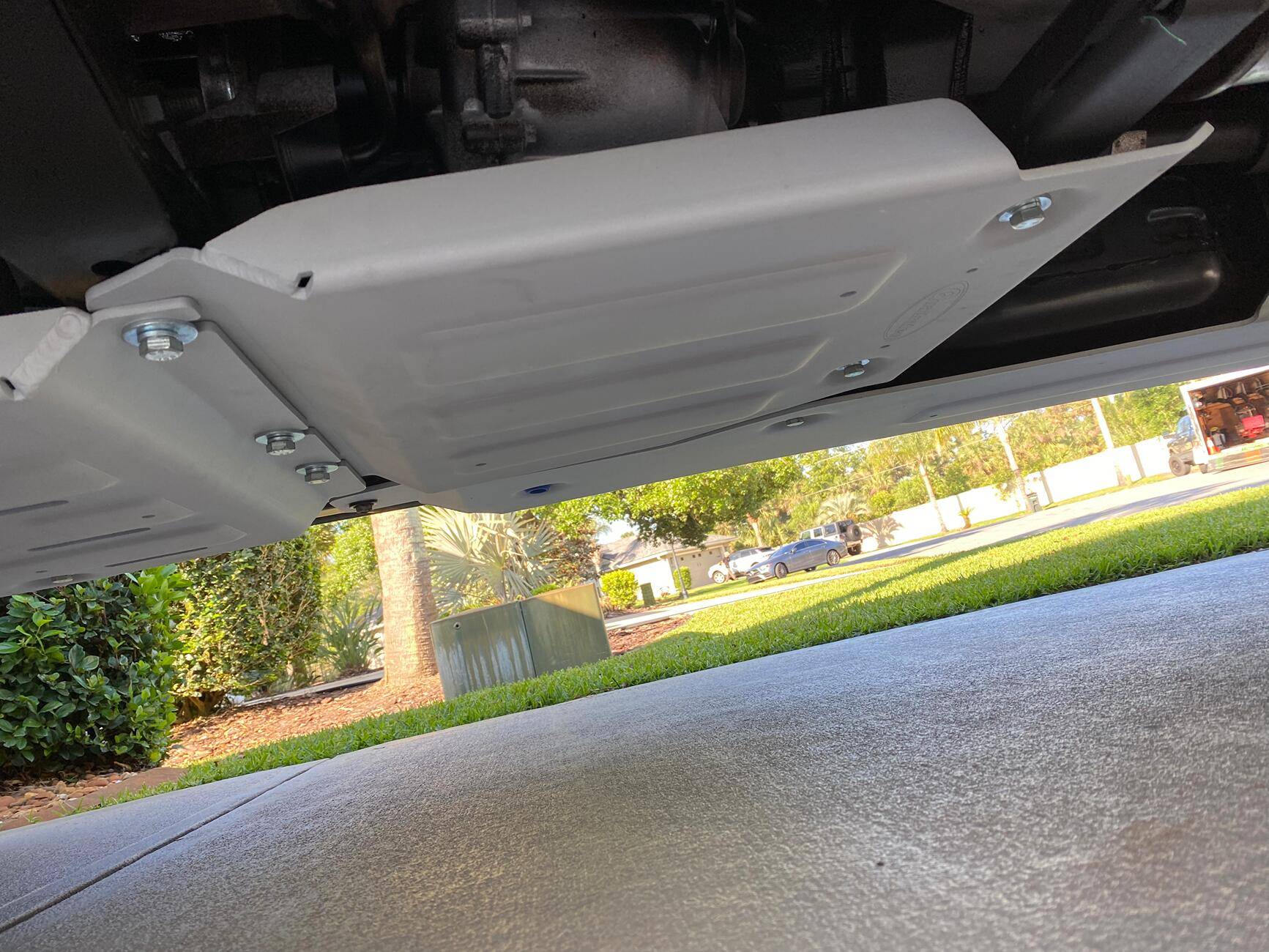

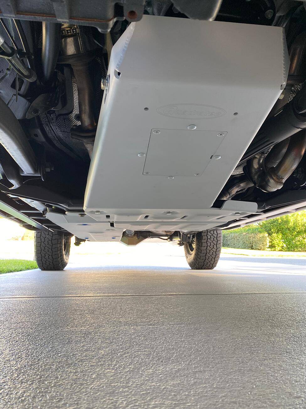

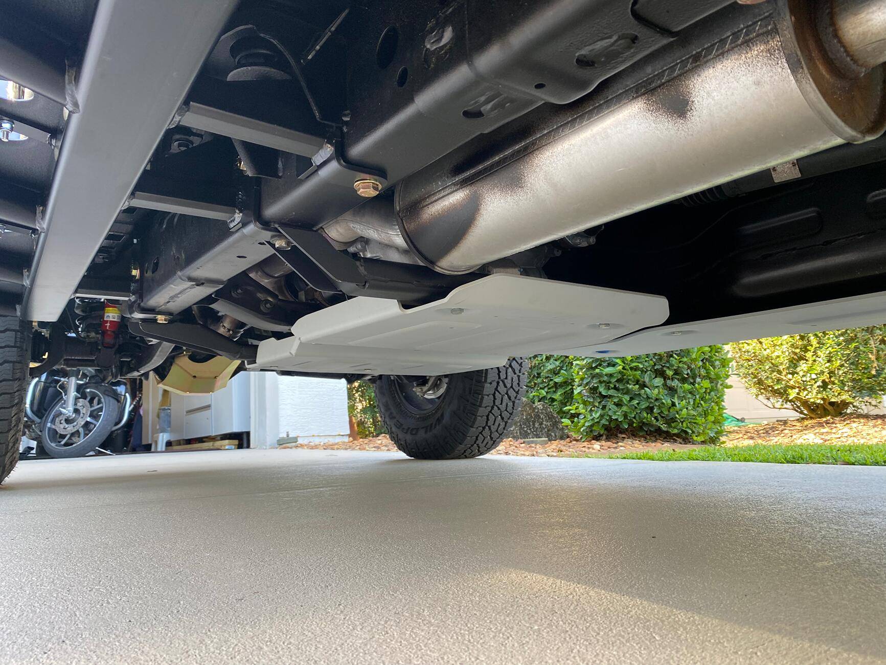

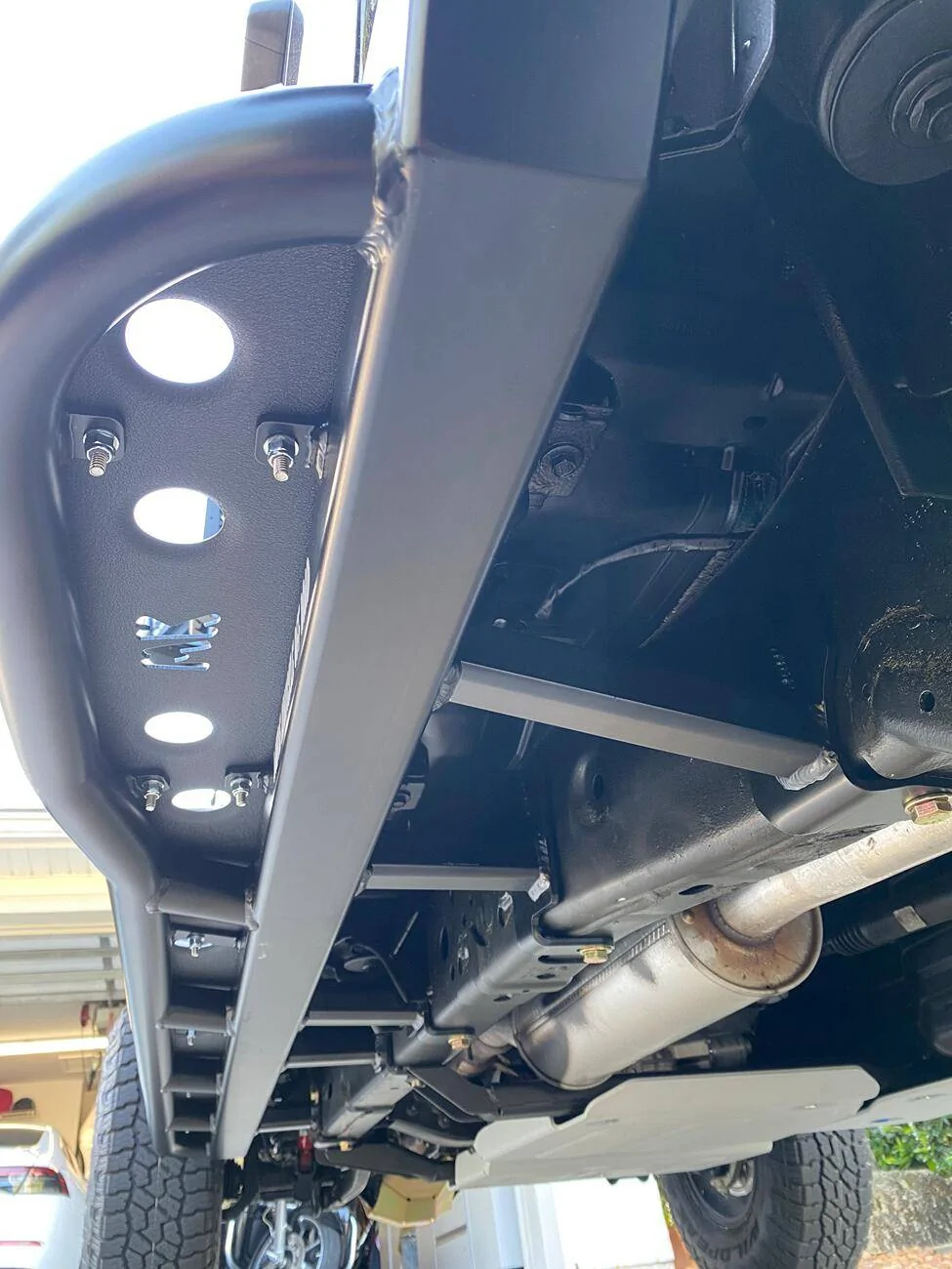

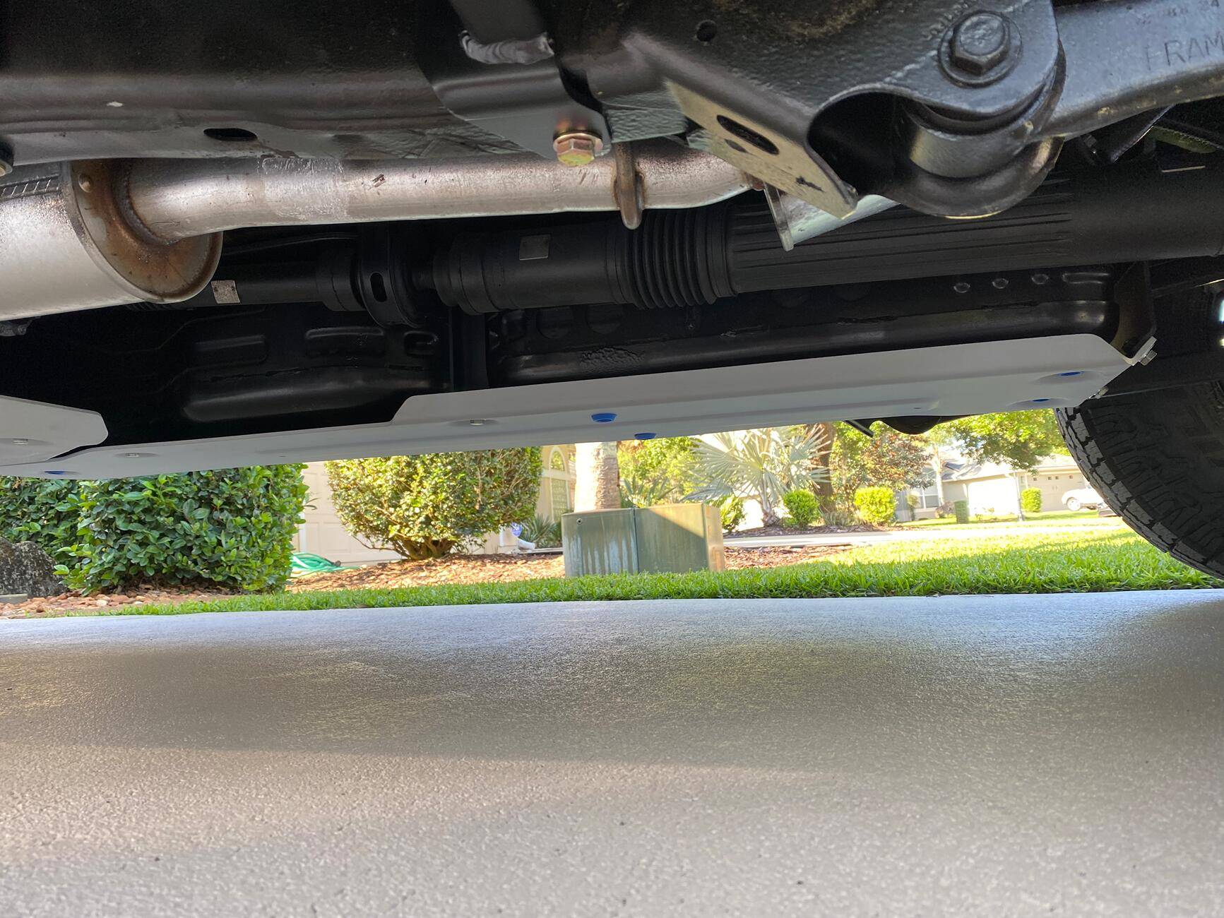

Here's the Quadratec skid plates and the underside frame mounting points of the White Knuckle Sliders.
Little tip on the WK sliders. Spray the under side of them with rattle can undercoating. Rocks from the front tires will chip the powder coat.

I’m on it! Thanks! I have several cans of undercoating.

I had mine LineXed. First time off road, I peeled some of the LineX off. So I used rattle can bed liner spray for touch up.

The bedliner in a gallon can (Napa) or Summit is good stuff

My entire undercarriage was LineX sprayed immediately after purchase. The undercoating still looks like showroom. I will definitely coat the underside of the sliders.

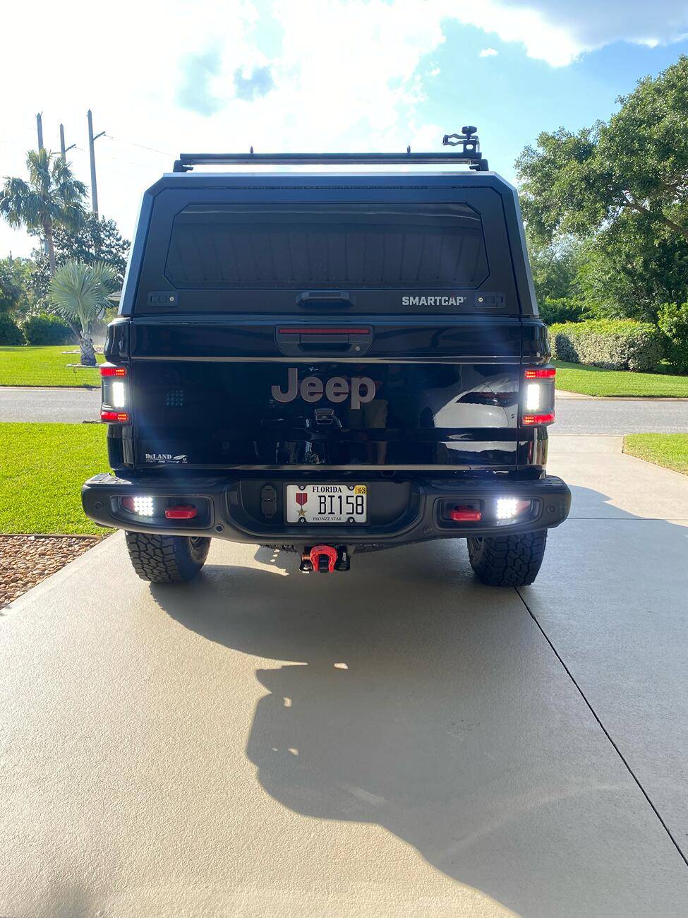

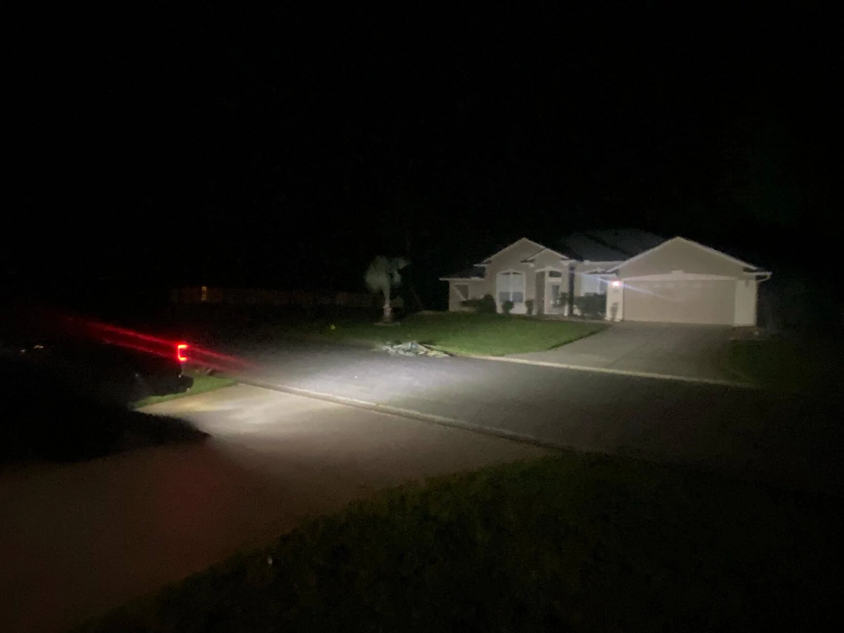

Just completed my Oracle Lighting flush mount tinted tail lights (https://www.jeepgladiatorforum.com/...tics-no-gun-talk.23705/page-2243#post-1492097) and bumper reverse lights (https://www.oraclelights.com/products/rear-bumper-led-reverse-lights-for-jeep-gladiator-jt). I had an issue with the reverse lights acting strange, blinking and sometimes not illuminating. I talked with Oracle and between them and my troubleshooting he figured out that the system needed a second wiring harness adapter on the right side light pod. That fixed the issue and now I have daylight in total darkness when I backup on the trail. The tacked in oracle lights look badass combined with the bumper mounted reverse lights. A super easy installation too. Here's a pic after dark. These things are brighter than my high beams.

Wow, those are awesome!

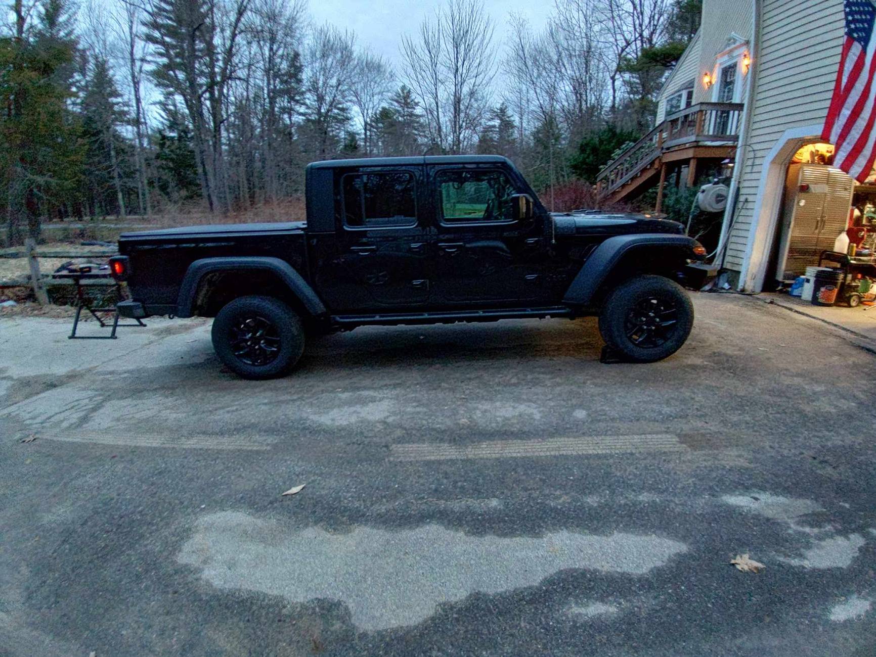

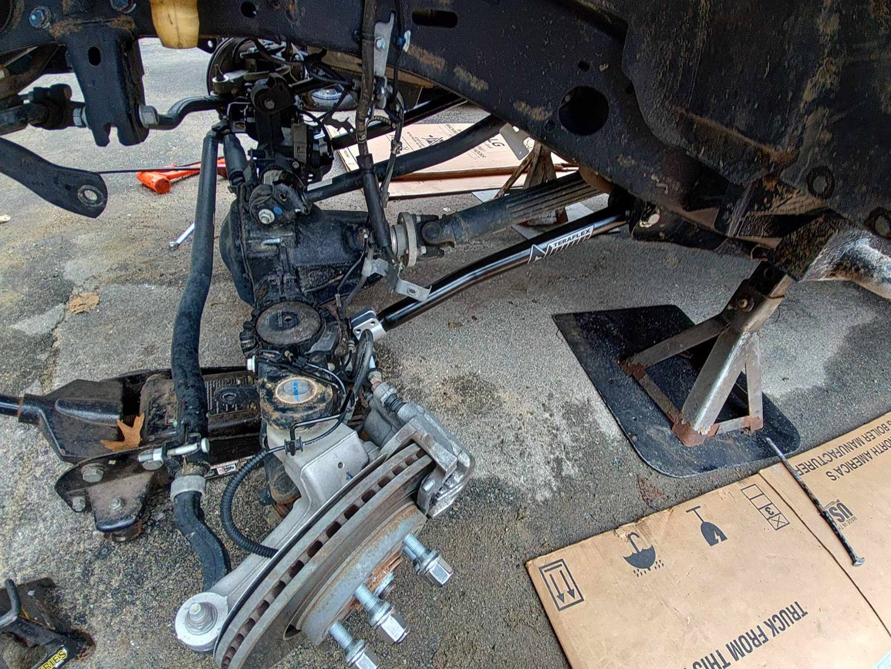

installed terraflex 2 spacers up front with lower control arms and track bar, bump stops and swaybar links
At the time I took this picture my wife came home... looked, shook her head, and said "Oh we are already at this point, well I know where this is headed "
Jeep Gladiator What did you do TO your Gladiator today? [ADMIN WARNING: NO POLITICS, NO GUN TALK] 1744432556334-mm

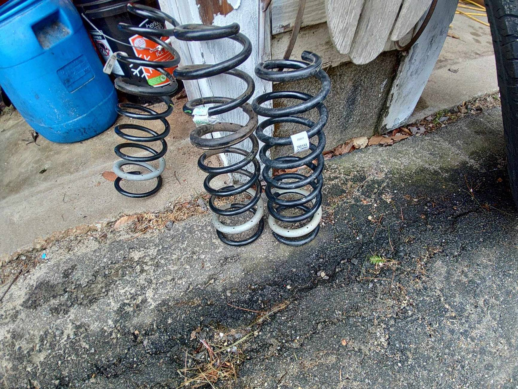

On top of That I swaped out the sport S max tow front springs for JL rubi springs . Here is side by side pic of front rubi springs and sport springs:
Jeep Gladiator What did you do TO your Gladiator today? [ADMIN WARNING: NO POLITICS, NO GUN TALK] 1744432501531-f4
and a pic before I did the rear 1 inch spacer:
Jeep Gladiator What did you do TO your Gladiator today? [ADMIN WARNING: NO POLITICS, NO GUN TALK] 1744432662302-d0
Now it sits nice and level. I will post more pics after I finish adjusting the front trac bar ( front is off center 1 inchto the left) and torquing it all down!
I Know it looks like the JT skipped leg day! Monday I'm having 35x11.5r17's mounted on the factory rims (will be good for winter wheels)
The eventual plan is 37's and wider wheels but have not decided on what rims or back spacing / offset. and I will want gears
