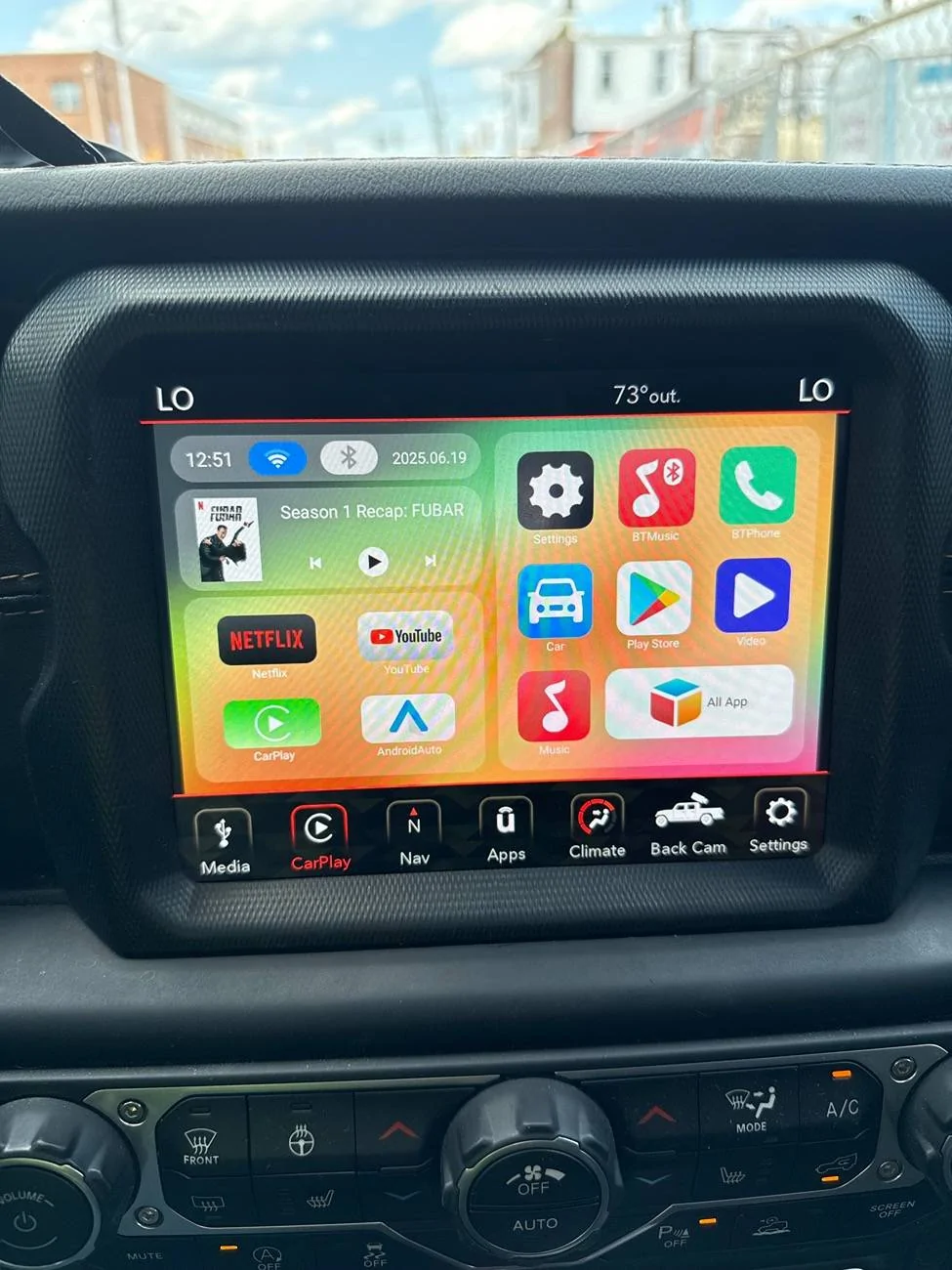

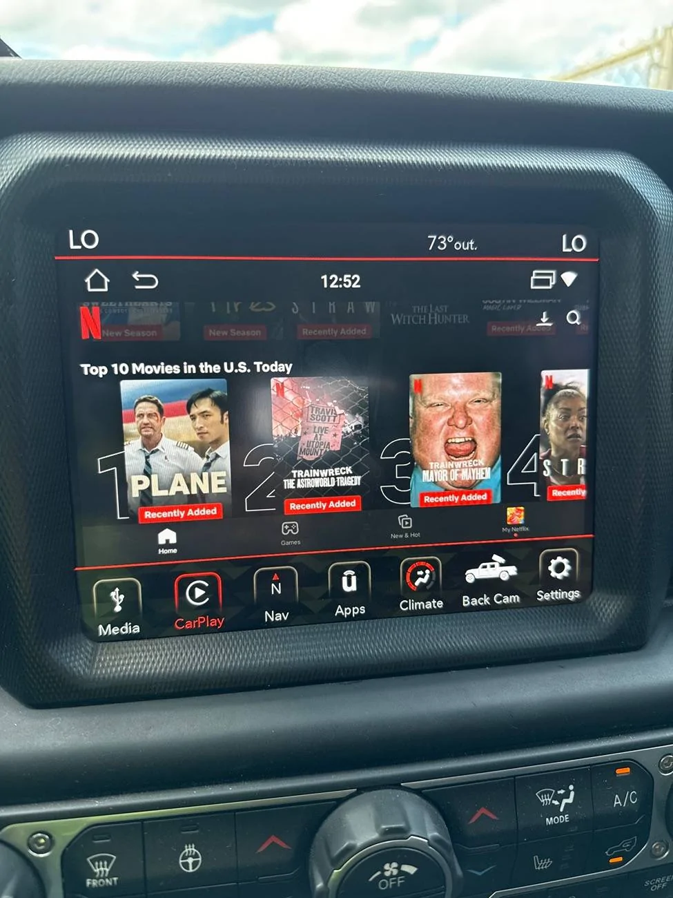

Wireless CarPlay and Android for the kids on road trips
What!? You can play Netflix movies on the stock radio?
