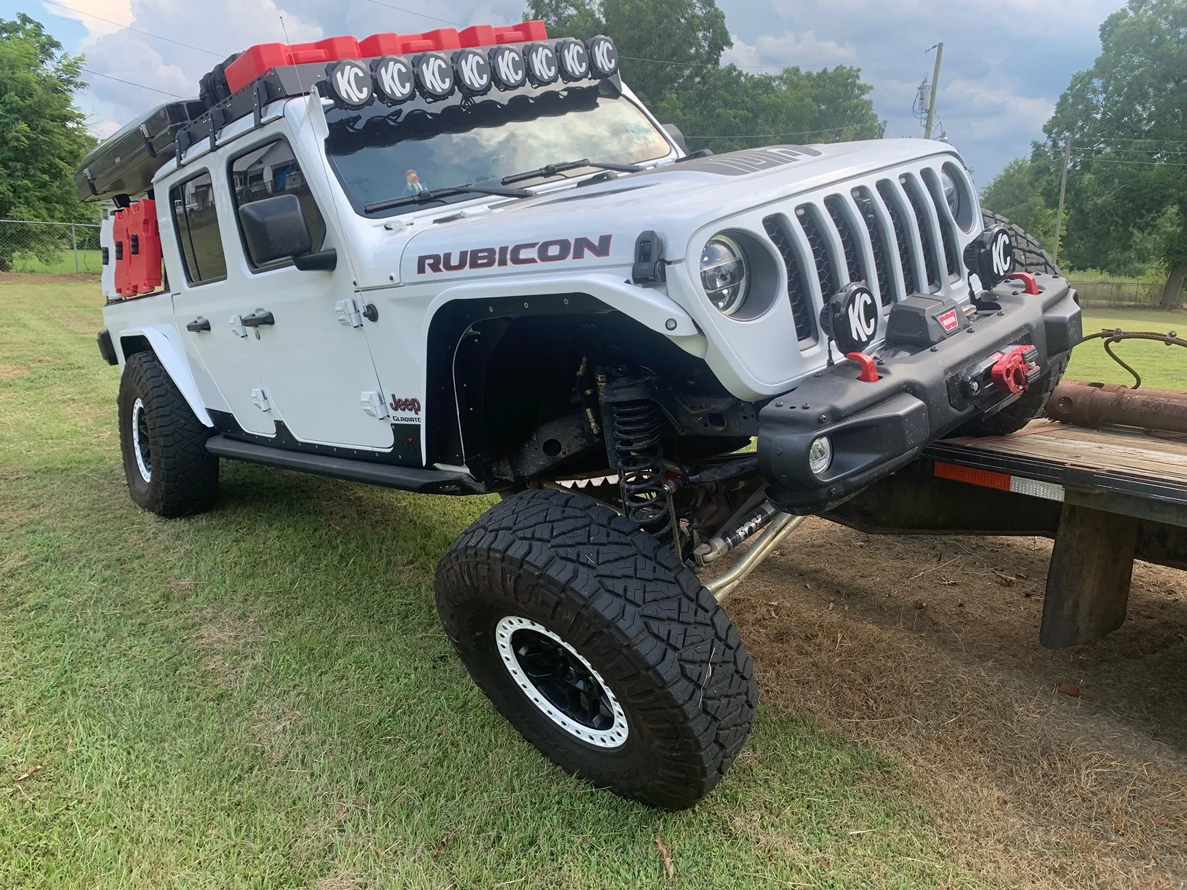

Well in preparation for the arrival of my @Metalcloak baller joints I started the tear down today.......easy work thus far. Cleaning everything, chasing threads and copious amounts of automotive herpes aka antiseize.
Also, huge fuckin shout out to my man Dan aka @WILDHOBO for spending an hour on the phone giving my his experience installing the MC Baller Joints with his lessons learn. Dude, thank you.
A post w/o pics is lame ......so the current status of my JTM right now
Final note, the castle nuts were barely finger tight and only held in place with the cotter pins. Maybe check your, retorque and add new cotter pins ......truly unsat.

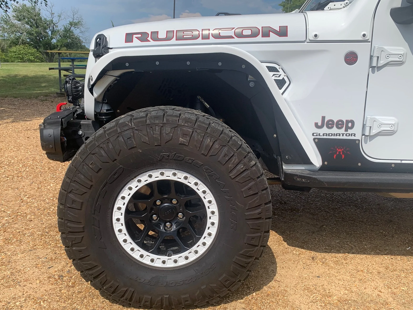

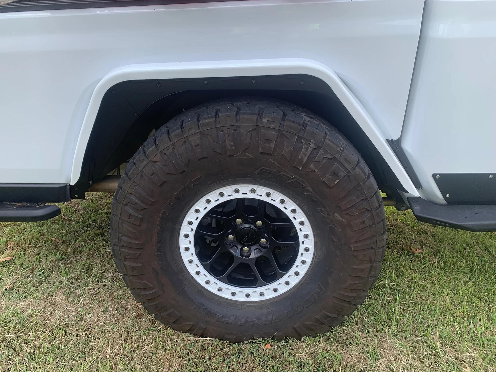

After finally getting my fenders and liners back from powder coat I got them installed today.
Jeep Gladiator What did you do TO your Gladiator today? [ADMIN WARNING: NO POLITICS, NO GUN TALK] IMG_2991
Jeep Gladiator What did you do TO your Gladiator today? [ADMIN WARNING: NO POLITICS, NO GUN TALK] IMG_2990
Jeep Gladiator What did you do TO your Gladiator today? [ADMIN WARNING: NO POLITICS, NO GUN TALK] IMG_2989

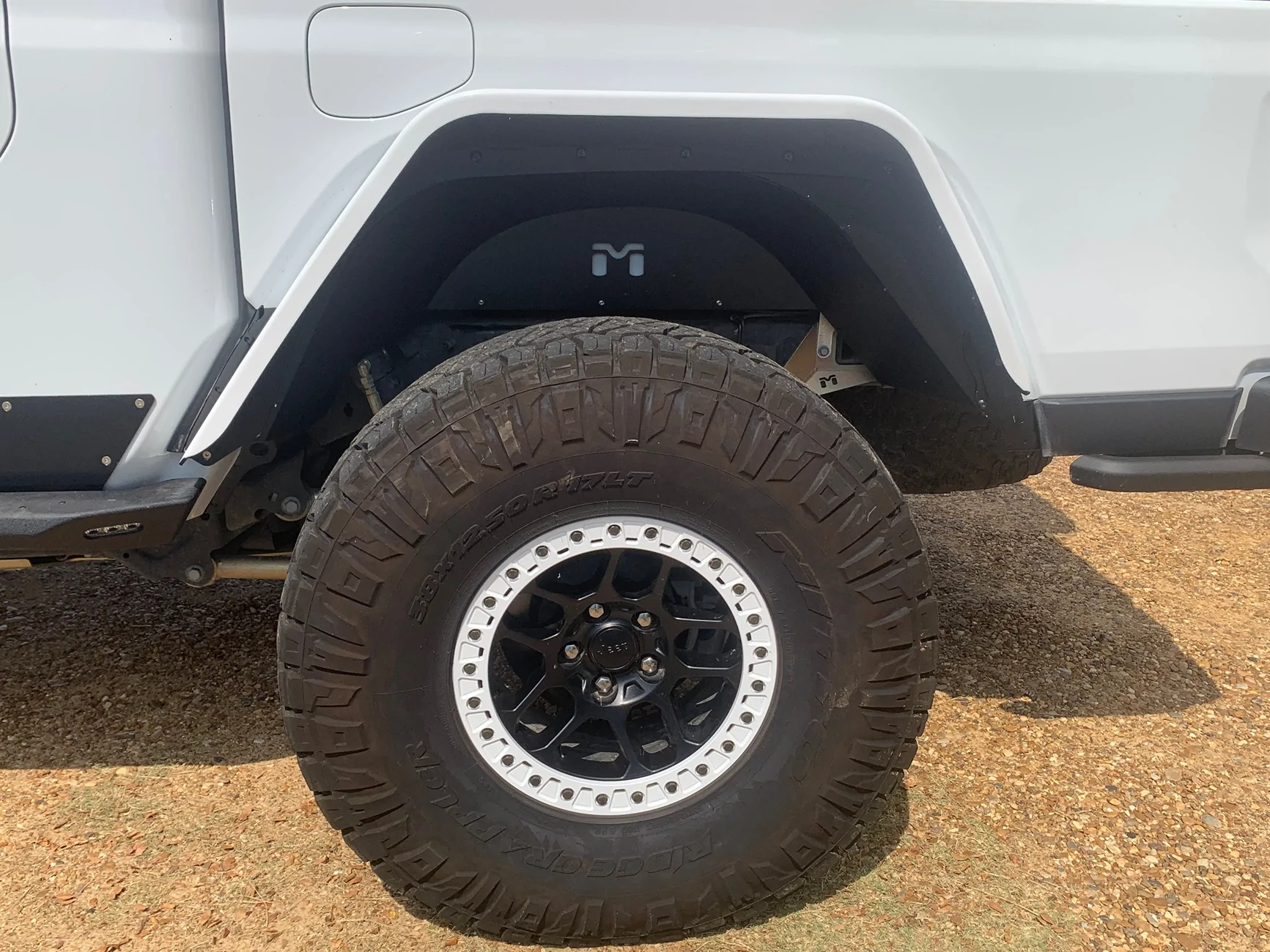

No more tire rub
Jeep Gladiator What did you do TO your Gladiator today? [ADMIN WARNING: NO POLITICS, NO GUN TALK] IMG_2995
Jeep Gladiator What did you do TO your Gladiator today? [ADMIN WARNING: NO POLITICS, NO GUN TALK] IMG_2998
Jeep Gladiator What did you do TO your Gladiator today? [ADMIN WARNING: NO POLITICS, NO GUN TALK] IMG_2997
Jeep Gladiator What did you do TO your Gladiator today? [ADMIN WARNING: NO POLITICS, NO GUN TALK] IMG_2996

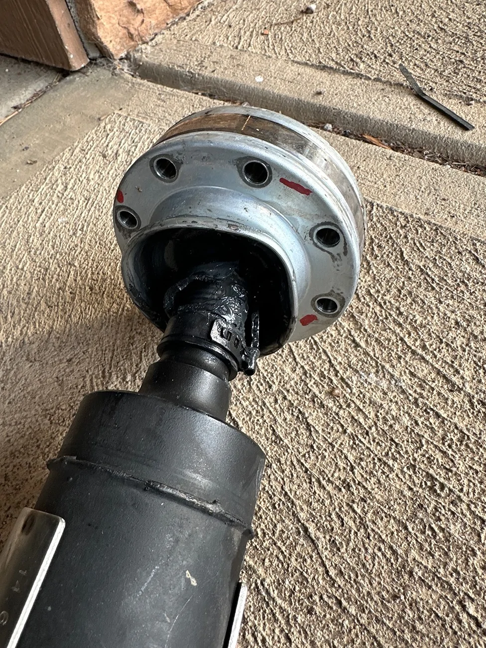

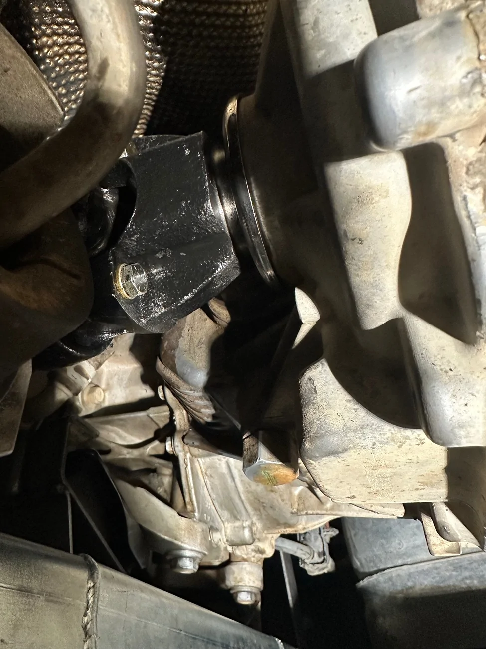

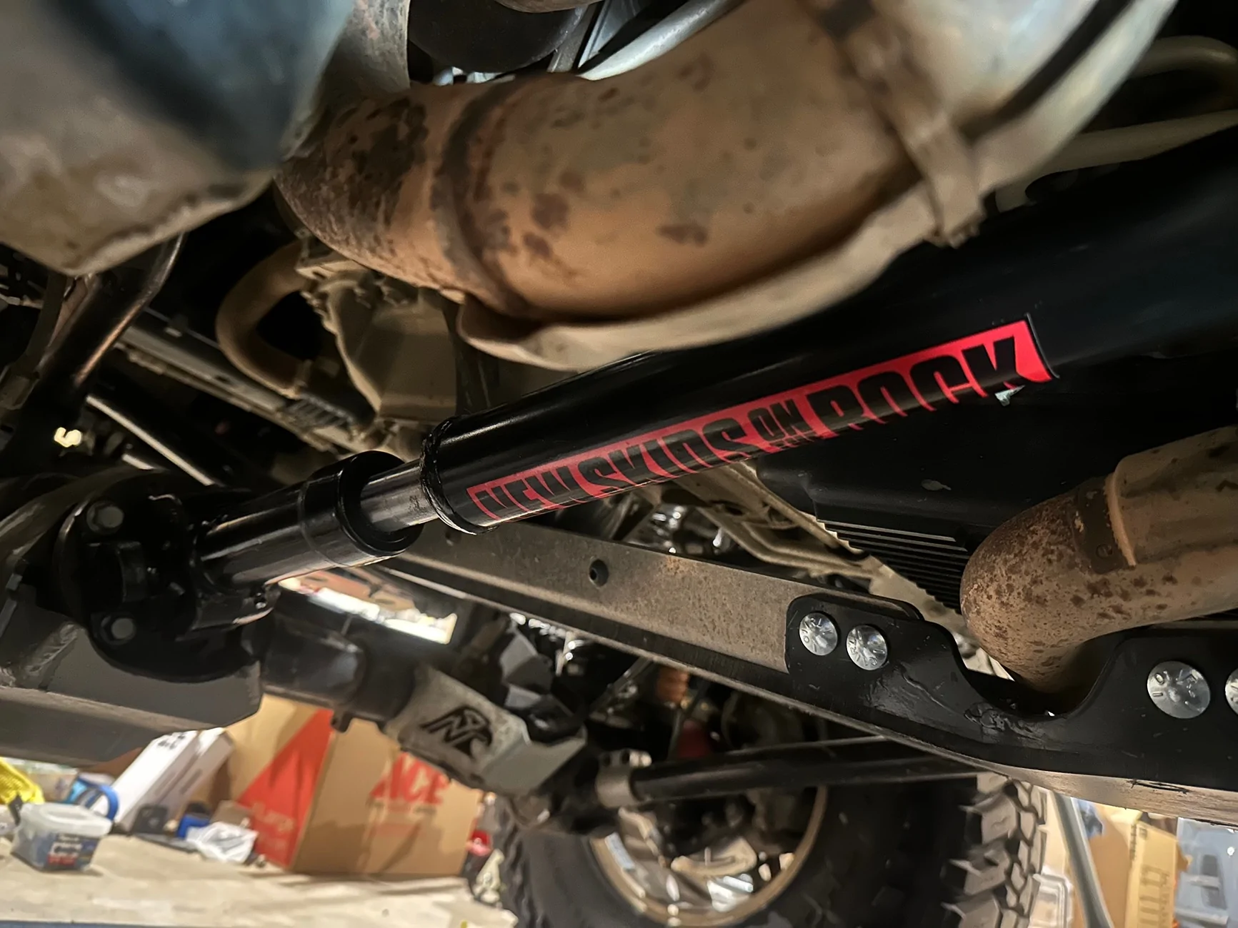

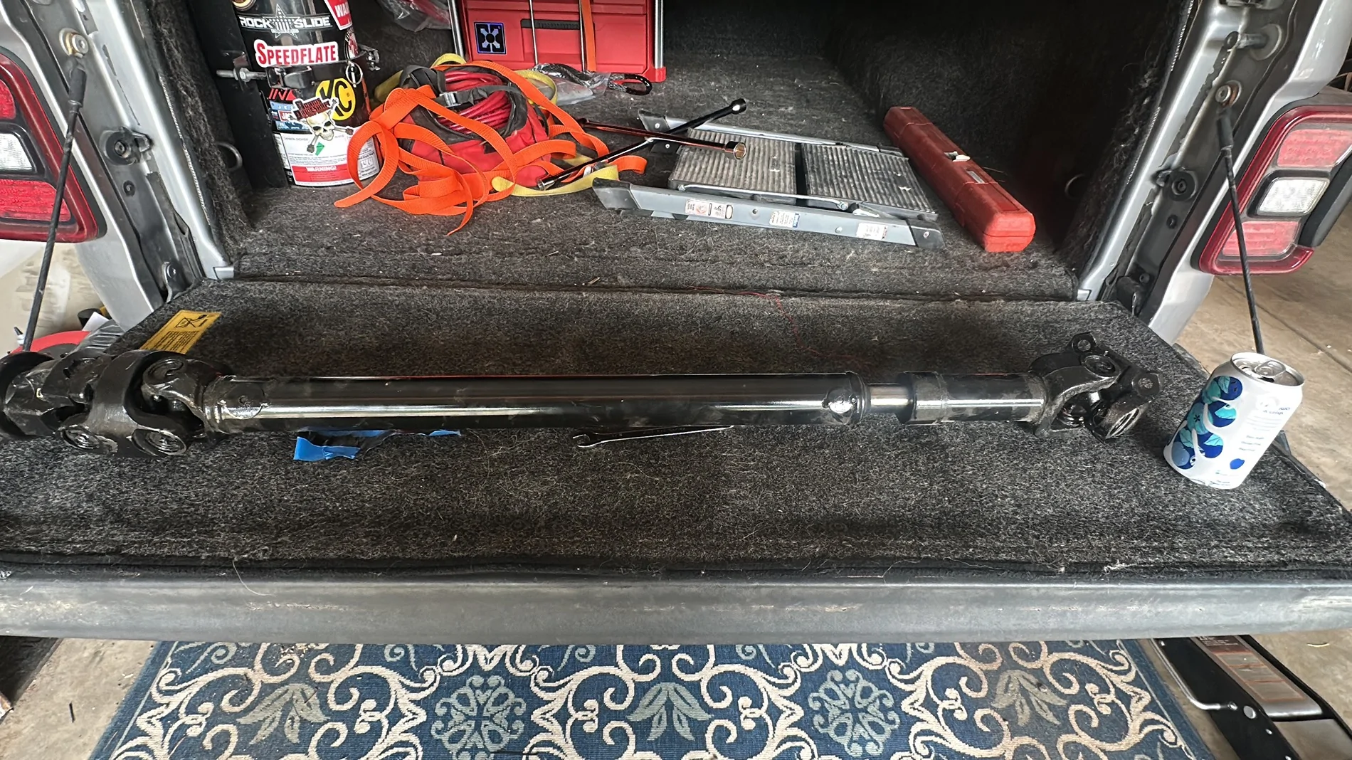

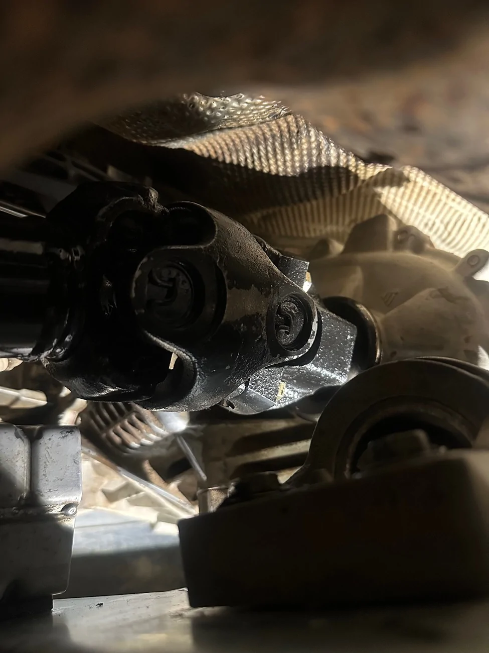

And dammit if I didn’t need to talk to @Minty JL and @Stan H same day for their advice. I was underneath just checking paint marks and torques and found a blown front driveshaft boot. I’m leaving at 5am to meet up with @40x40 to do a week of hard trails. Not exactly what I was hoping to see. It happened in the last few weeks. Grease everywhere. The shaft was only like 4 months old. Oh well. The angle on the joint was too steep. It’s my fault it failed. So I had to pull it; swap the yoke, and put in a 1350 double cardan I had laying around since 2022. Just now finished. Not the day I planned, but now I can pack and go have fun wheeling.

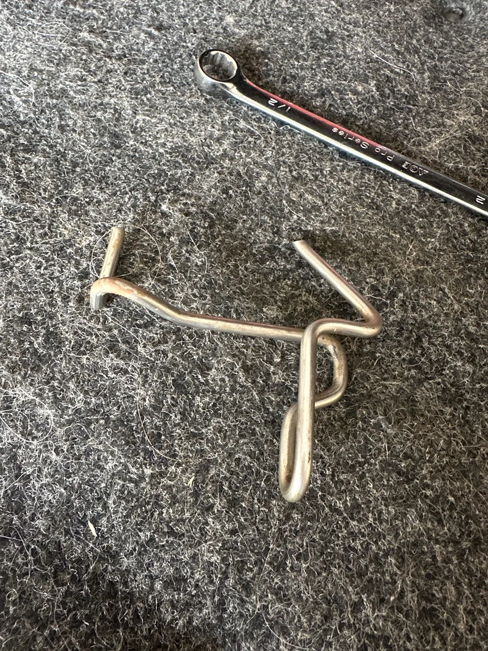

Anyone know where the cable management thing in the picture goes? It was on top of my transfer case skid. I couldn’t figure it out, so it’s not installed. Oh well.
There is a bracket it locks into . I would have to get up under mine and take a pic . Im in the dust . Can ine if y'all with a garage take a pic for @WILDHOBO
If it’s not mission critical, it can stay off this week. Thanks very much. Meeting John @40x40 in minutes to do Holy Cross. Them off to Moab. Here’s to a 10 rated driveshaft test drive! :)

Good thing I didnt take you up on your offer to put it in the back of my truck as a spare! Looking forward to your wheeling pics!
