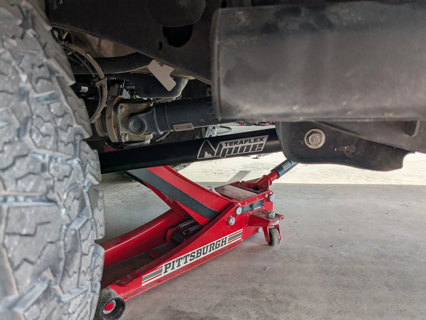

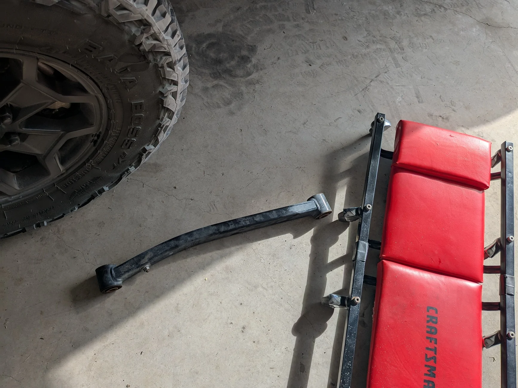

Corrected the caster of the front end with some Alpine LCA from Teraflex. Done before the high of 102° today.
Now where did you measure at cause I seen several different places people are measuring from .
Some on top of the upper ball joints
Some on the diff . Some are using the pinion angle of zero which will equal 6degree caster on the ball joints ?
Pinion angle and Caster aren't the same but are related since both are affect by the amount of rotation and one can give a clue the other isnt right.

Goal is pinion angle of 0° which is 6° caster. You can spend some money and get a fancy digital angle reader, or $5 for a Harbor Freight unit. Check your garage floor for base angle and transfer that correction to your pinion reading. I'm probably within .1 to .5° now. I was told a couple angle places by @WILDHOBO to measure it, and the only one that I remembered was the pinion angle. Hope that helps. Test drive, everything tight, steering self-centers again, checked the torque on everything and all is good.
That is correct 👌
