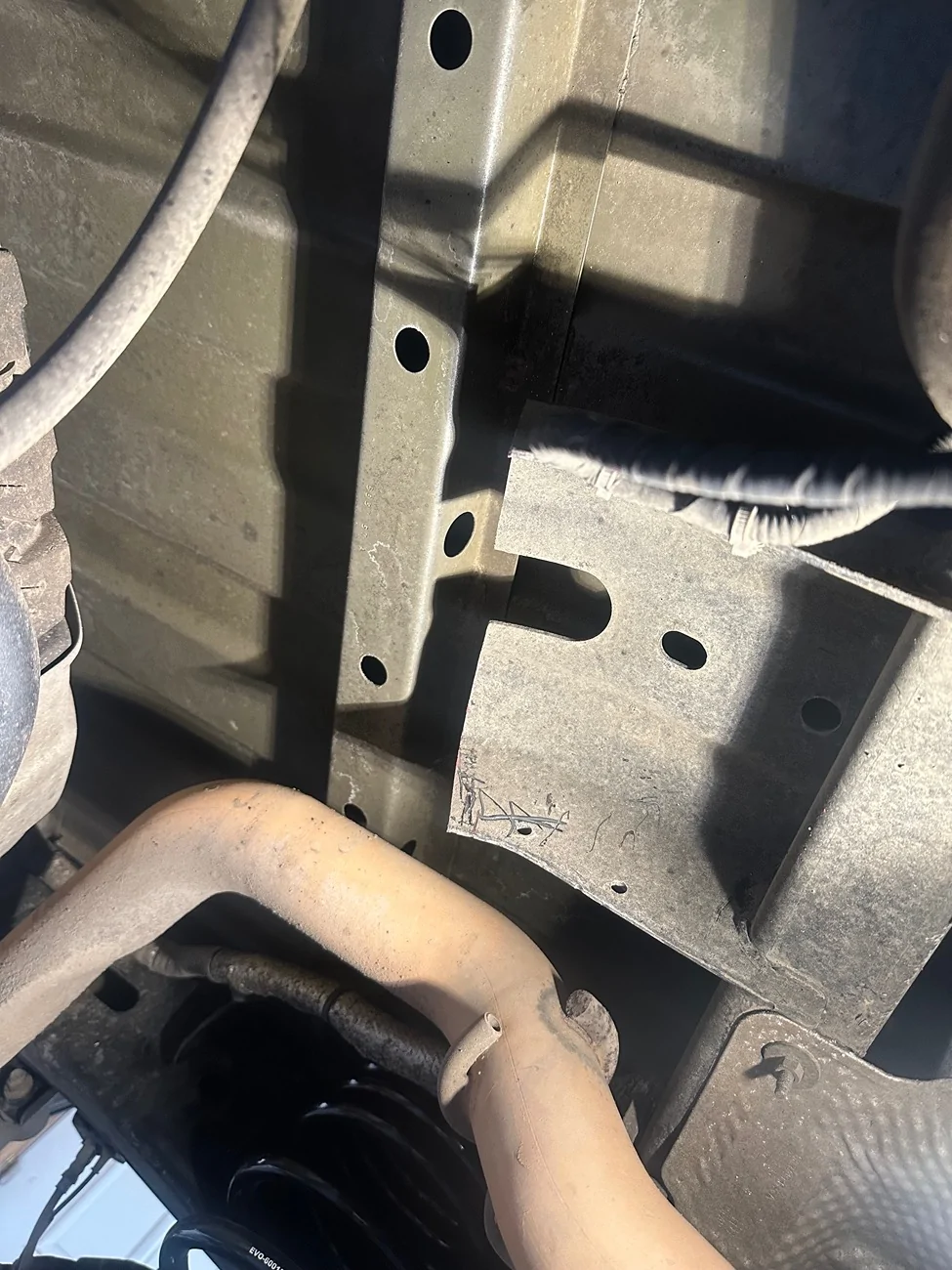

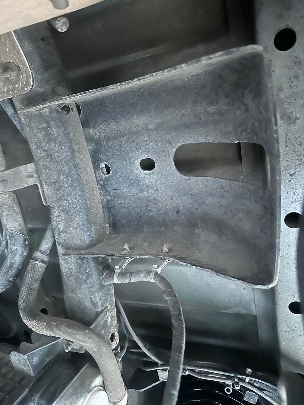

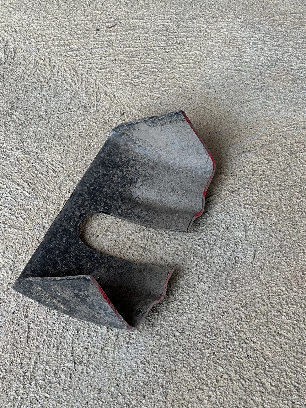

Metalcloak 2.5" gamechanger. Down to 1 puck in the rear.
At 6.5” in the rear, I think I only have 3” of puck back there. No bottom out issues with a flex test. I’m sure you’re fine. If you have a bent rear track bar and have relocated your track bar up for a more level bar, check the “diff catcher” above it. I don’t know what else to call that stupid thing. It was the only thing that would have hit on mine. I may have “trimmed” it a little. :)
