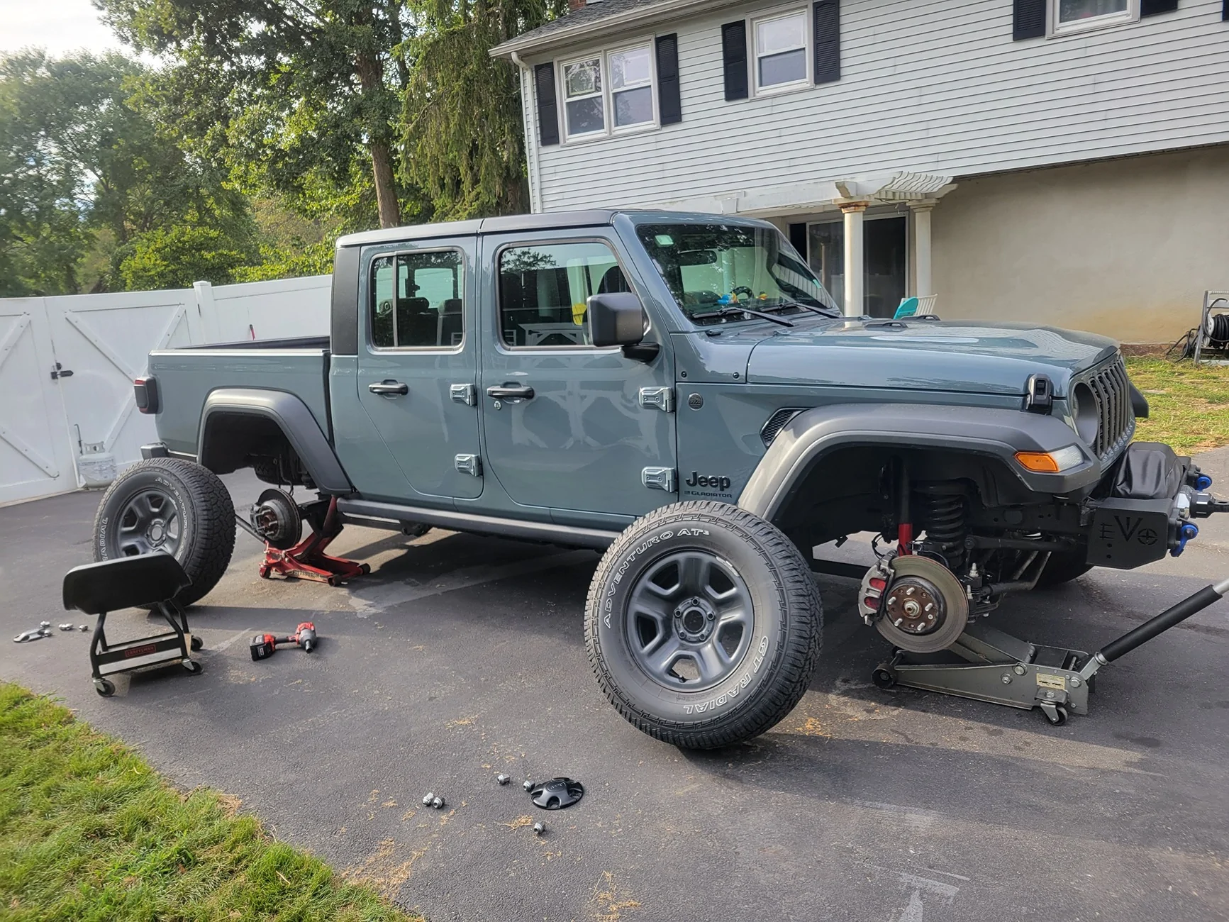

Decent weather today and decided to rotate my tires and recheck the torques on all the suspension stuff from my axle swap a few weeks ago.
Axle swap ?
RubiNewbCB
Jun 1, 2022
1,077
1,394
757, Coastal VA from the 810 Thumb of the Big Ol'
22 JTRD, 21JGCL, 07 Mustang GT, 05 Chebby Hoe, 90 Fox body stroked and poked393W
USN NSW Seabee (1994-2021Ret.) / Current status DoD PMC
I removed 1 puck one each side of the rear per the suggestion of the Metalcloak Team from my trip on the CTI trailer last week.
How much lift, and how many pucks?
