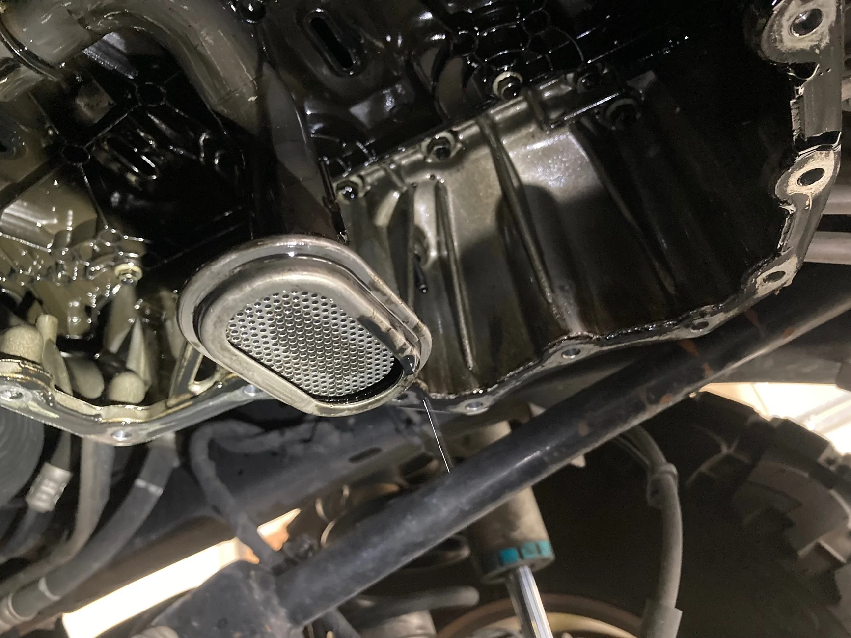

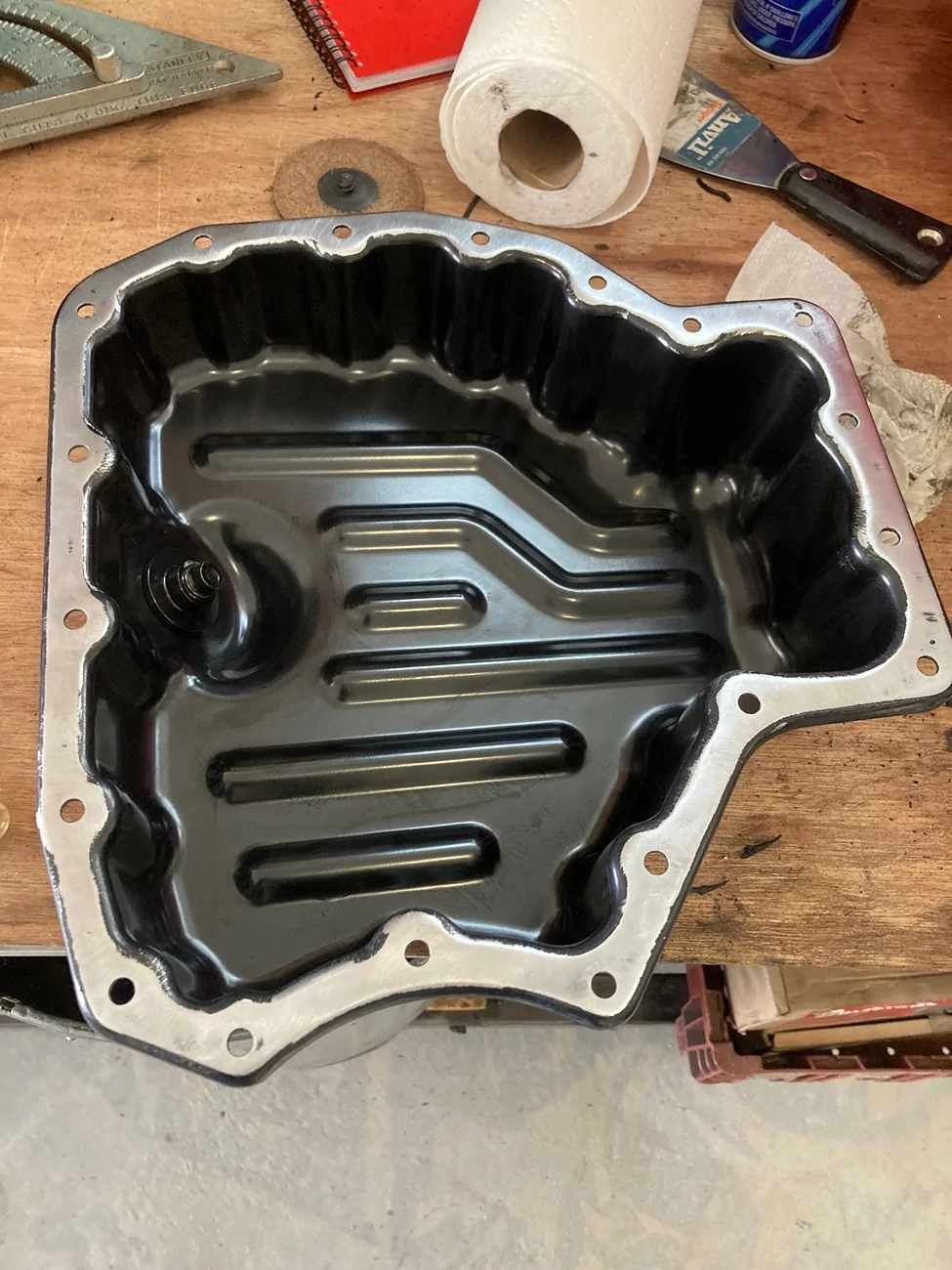

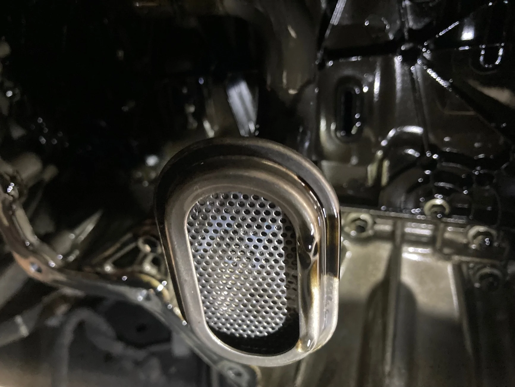

Friendly PSA to the diesel crowd.. Saw a video a while back about plugged up pickup tubes in that 100k mileage range. I was due for an oil change so decided today was the day to check it. Glad I did. As soon as I took some cleaner to it oil came back my way! I couldn’t see through the screen at all till after I cleaned it. It’s apparently a thing… make it a point to drop that pan at some point and check it. Cost 15$ of high temp RTV to do it. Cheap insurance to make sure it isn’t starving the motor of its precious blood.

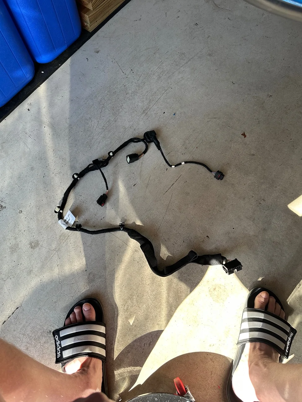

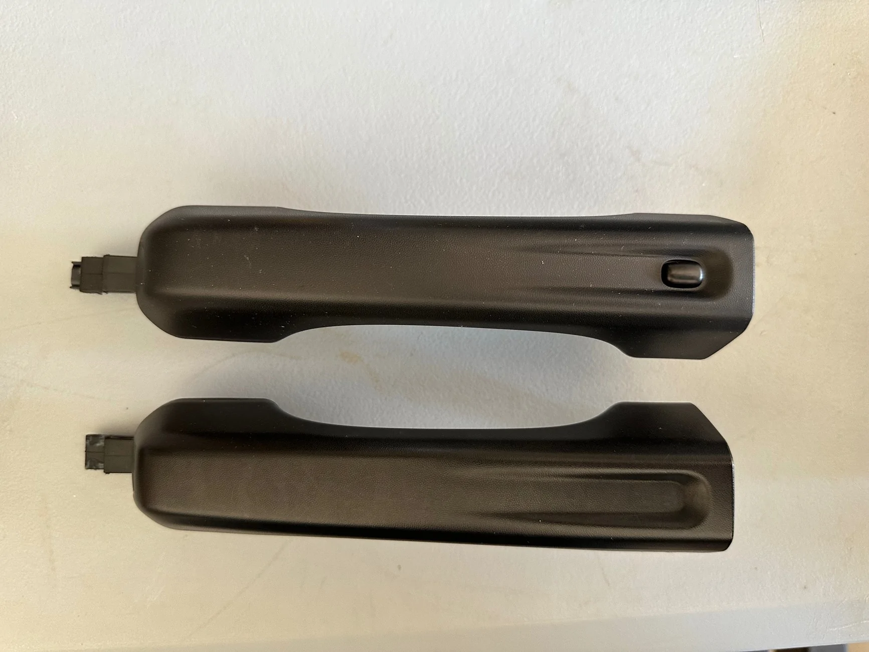

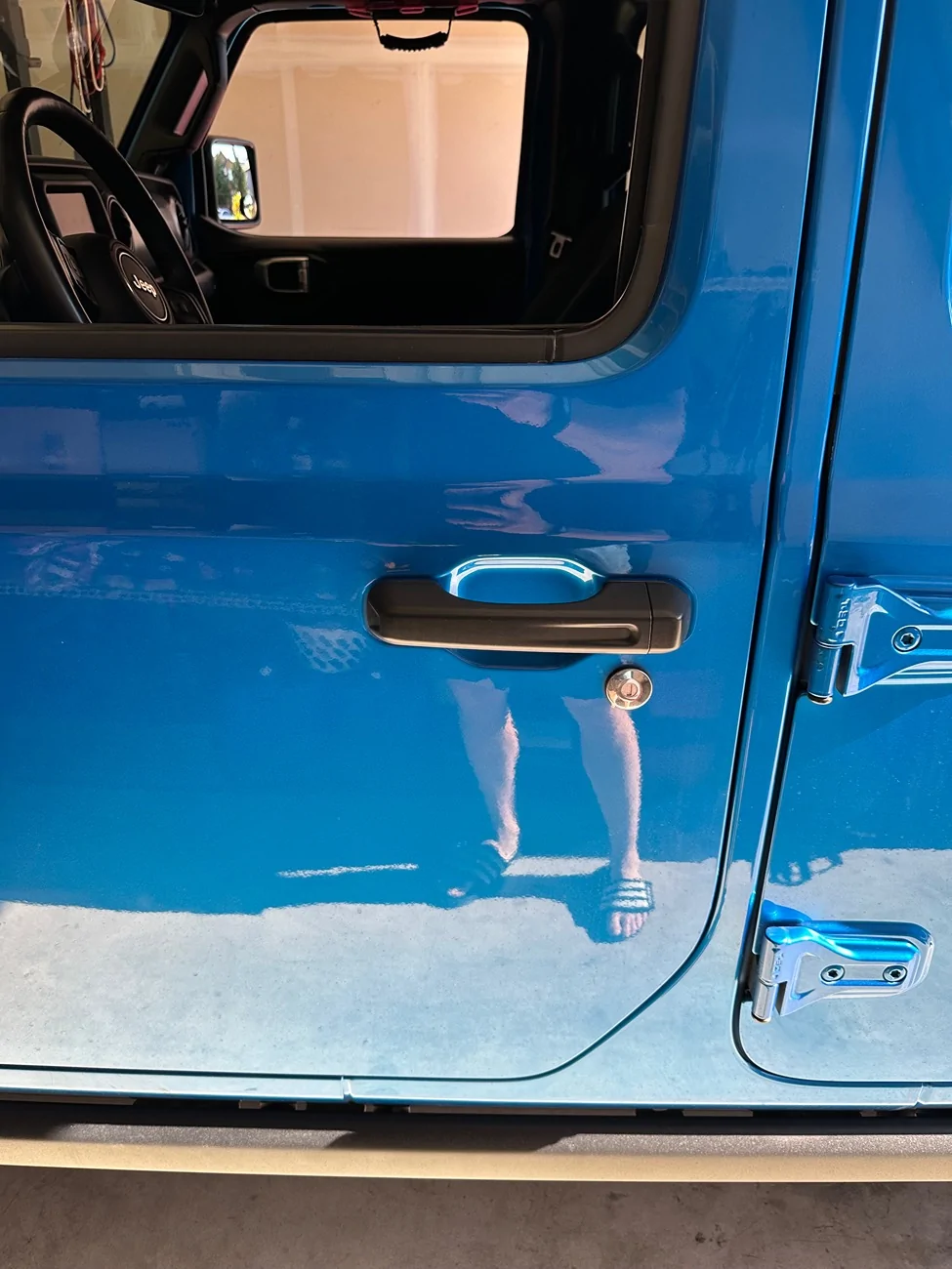

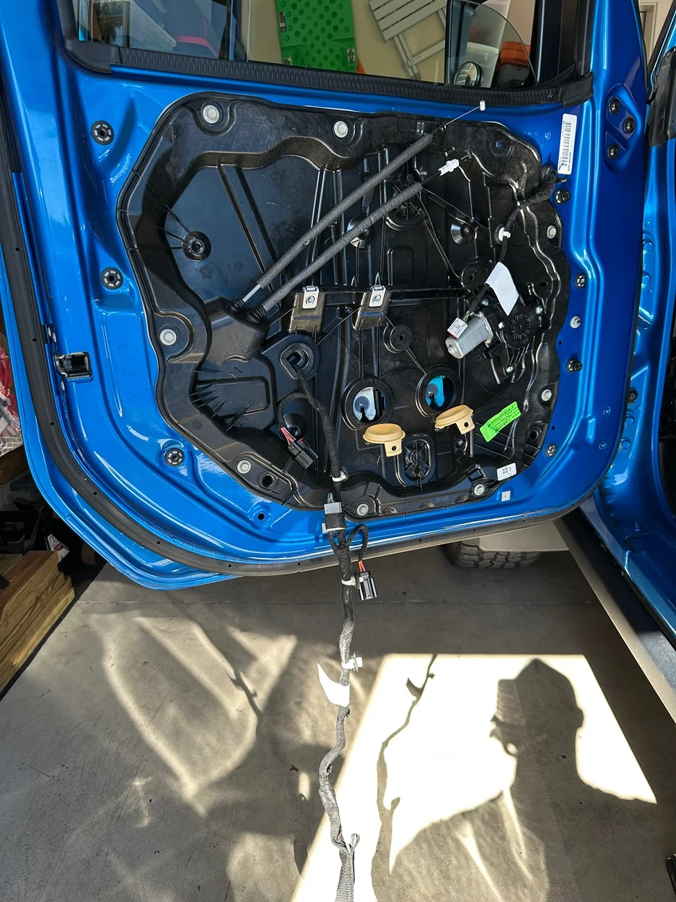

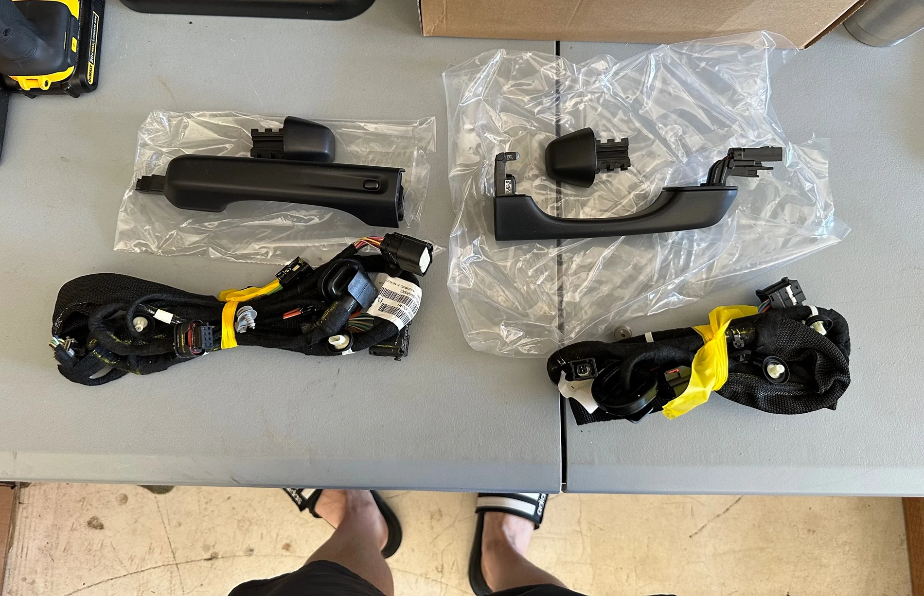

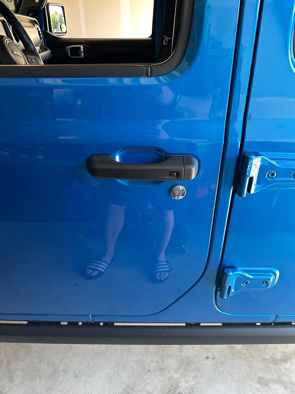

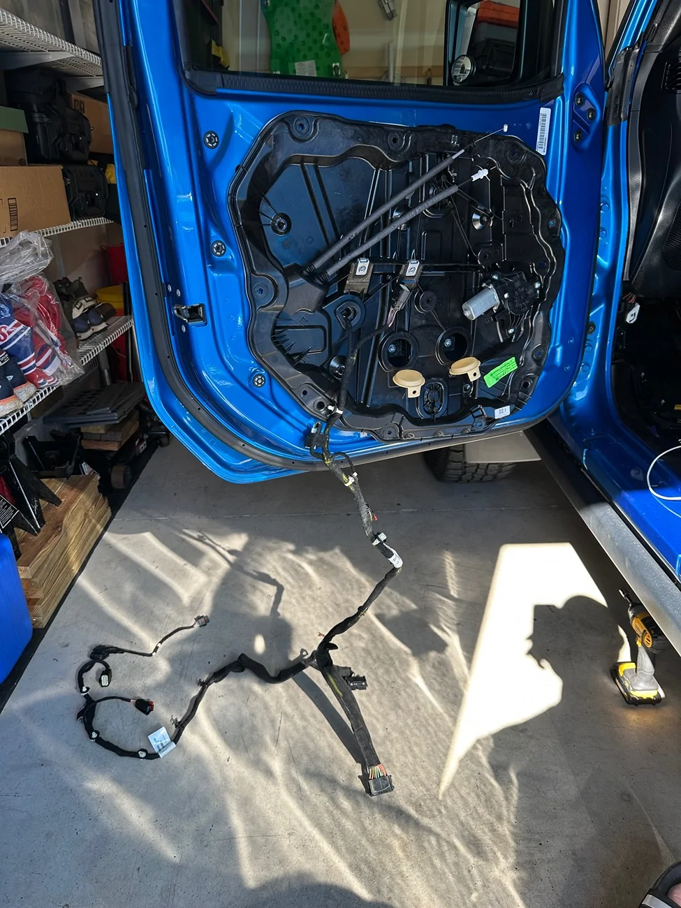

Holy rutabaga! What is the part number for those handles/harness ?? I so need that.
My Glady came fully loaded and doesn't do that.

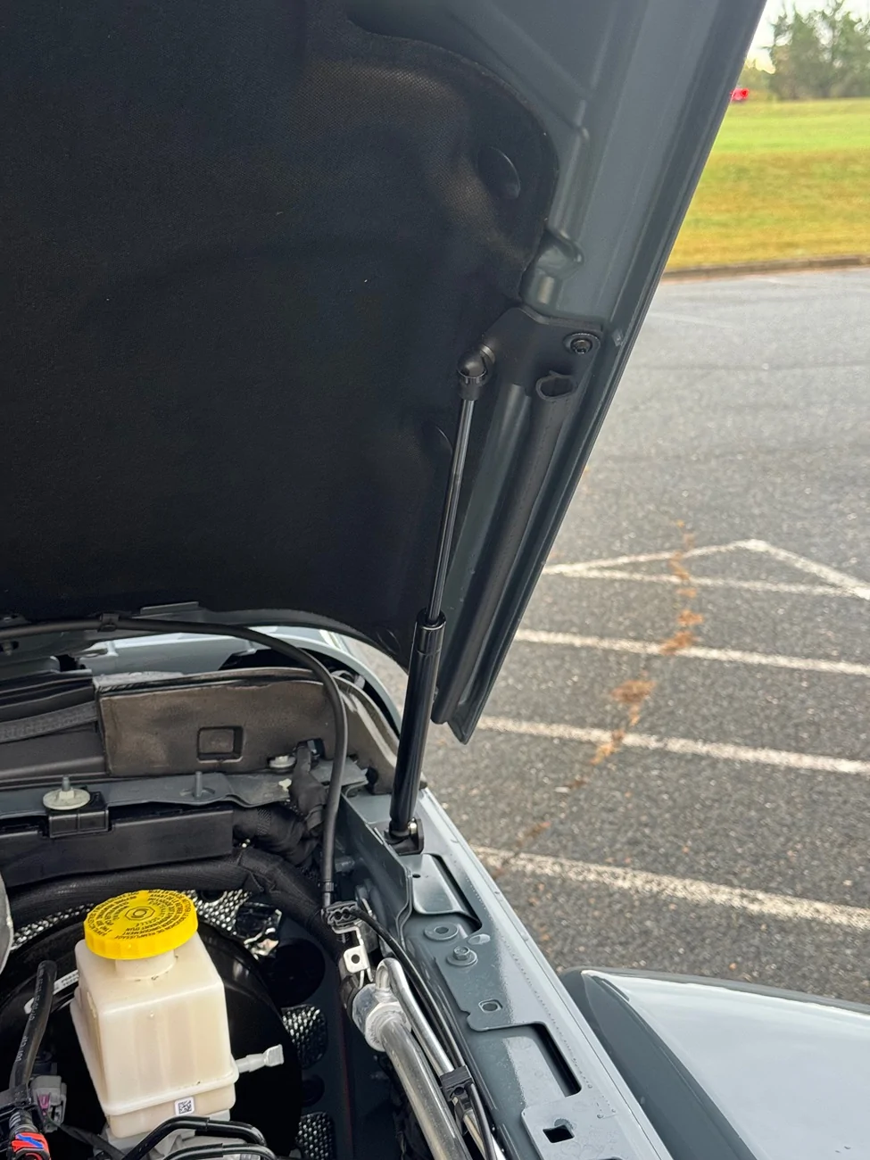

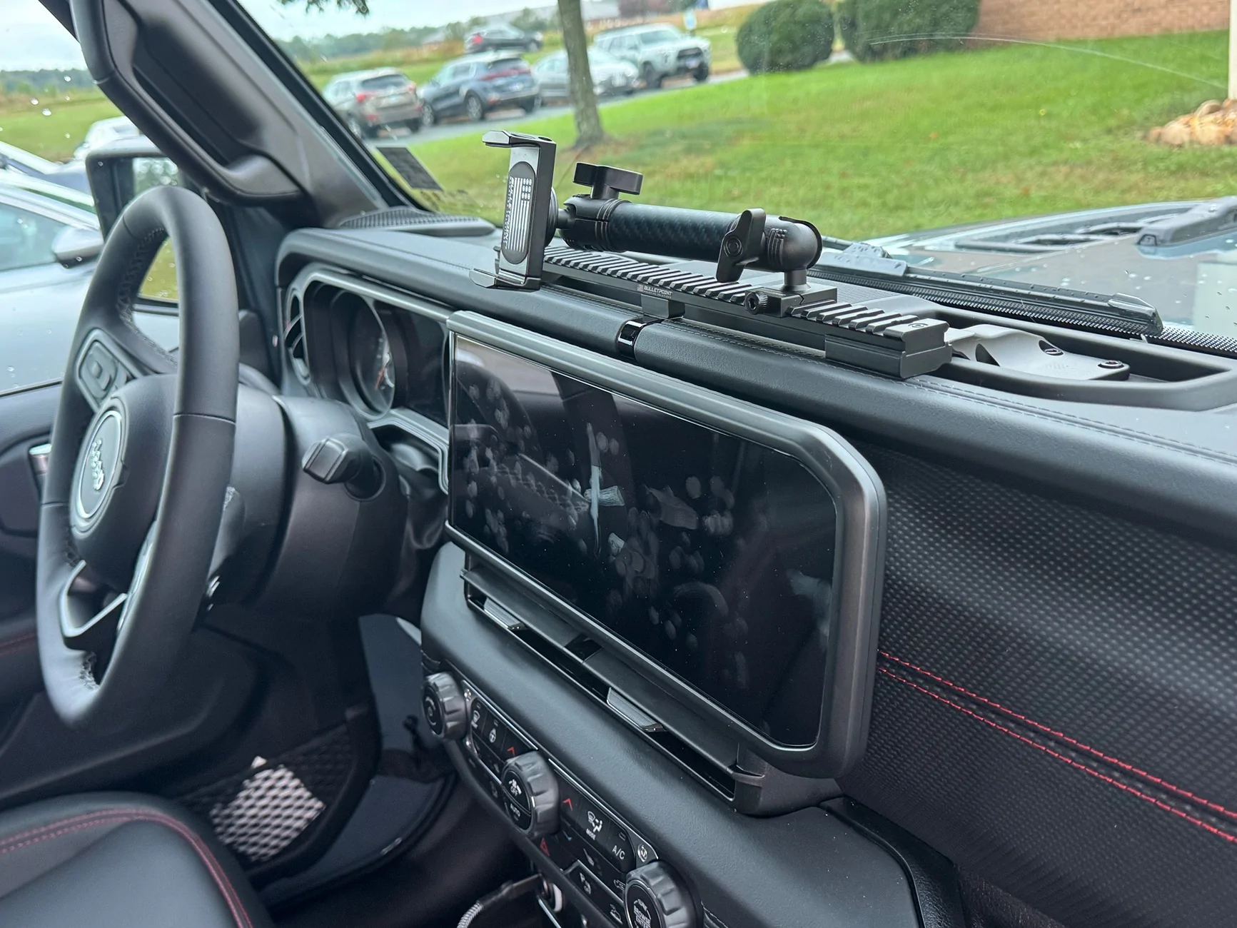

Got my billet point mount for my phone. They make awesome stuff. I also installed struts for the hood. Hook is the maker. Easy quick install.
