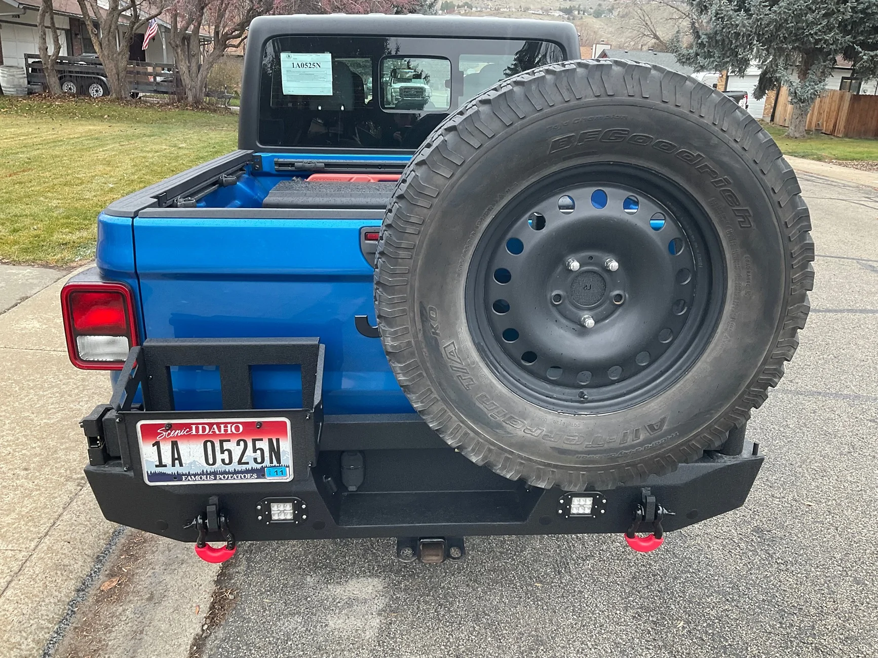

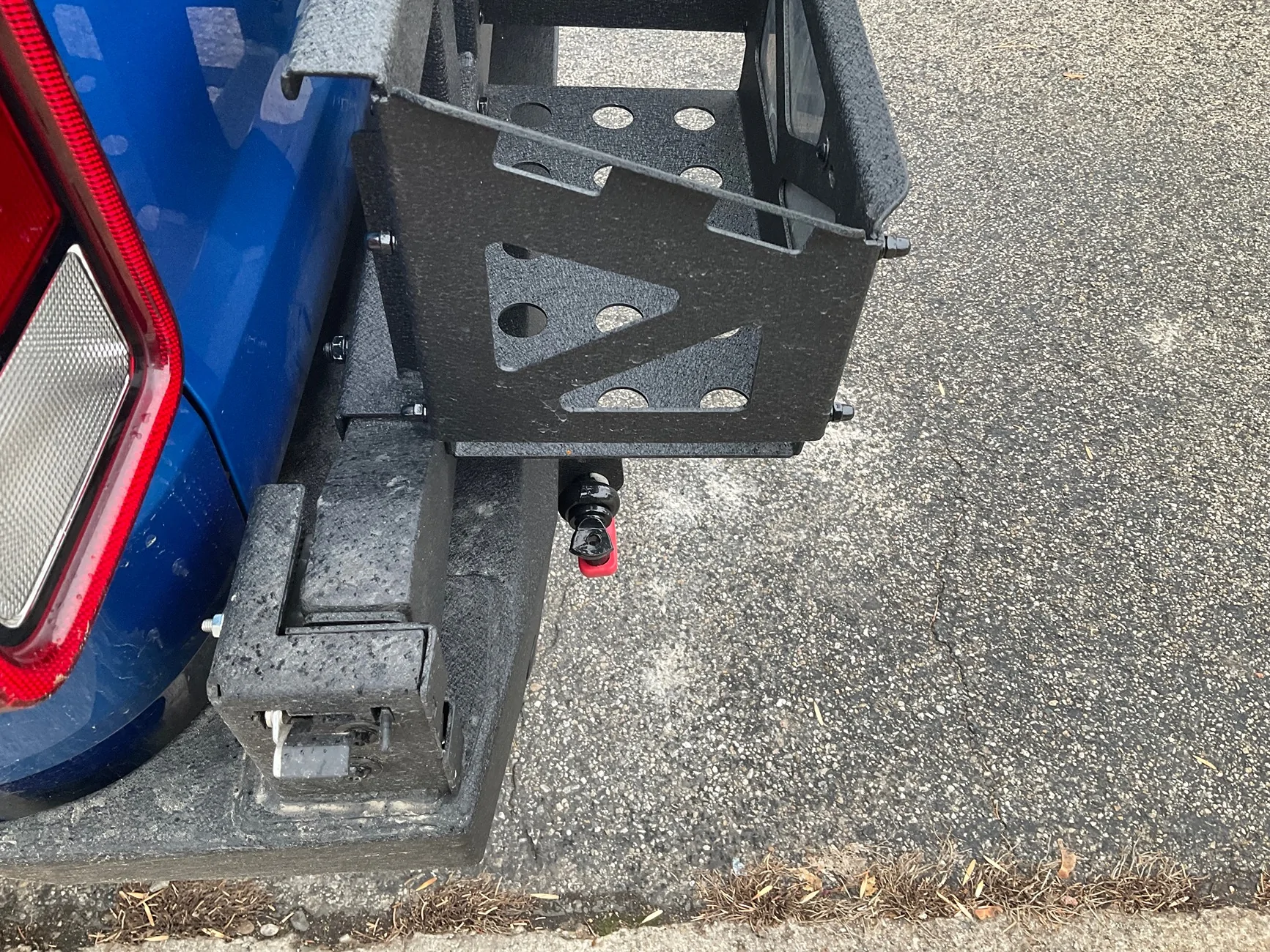

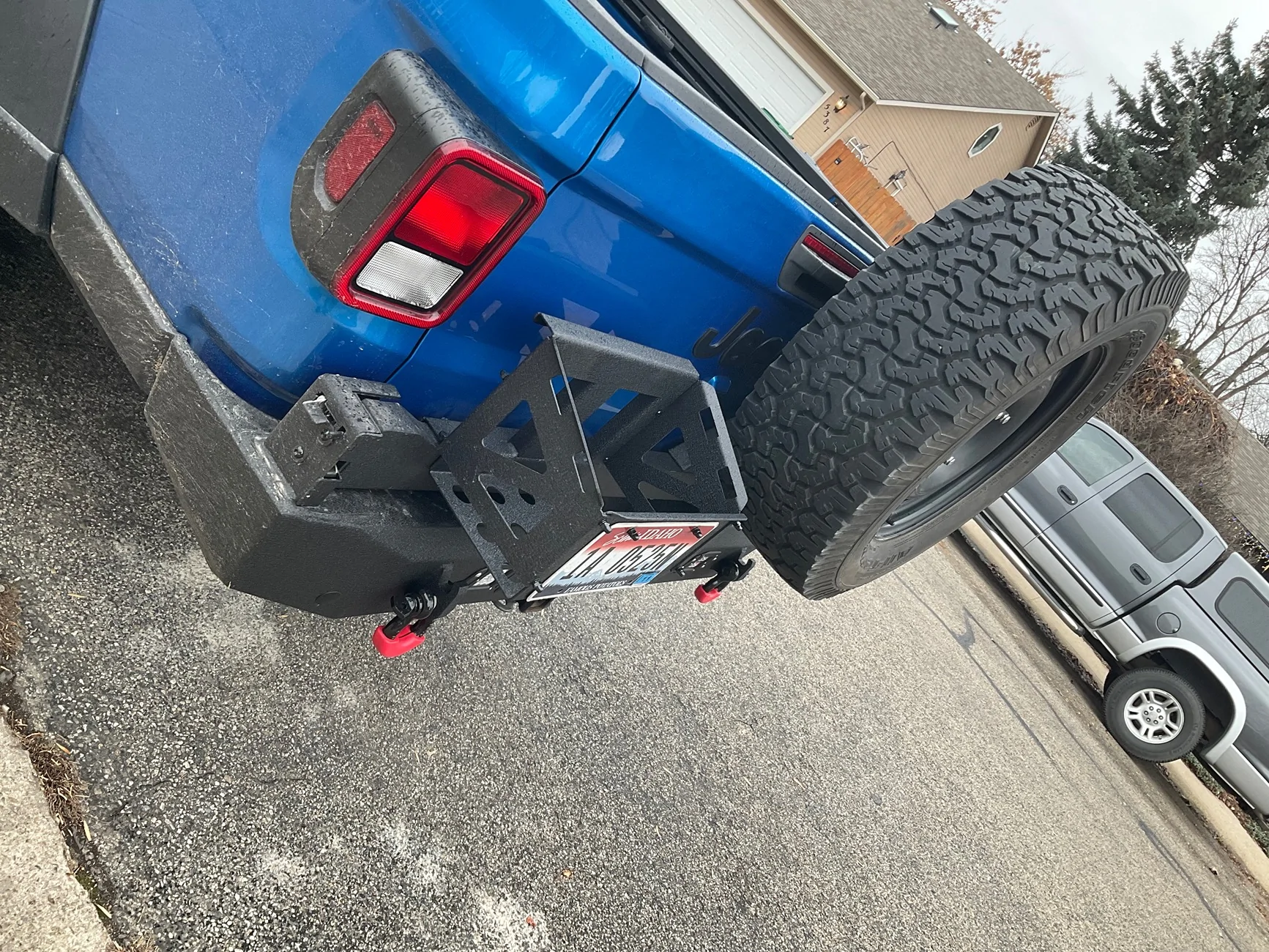

This goes back to a Black Friday purchase….i bought a AMZ / YZona rear bumper with a swing out tire carrier. I’ve shopped every one of these that fit JT on the market, first off I was shocked at how much these have gone up in price this year, some reaching +$2K!! My BF priced shipped to the house was sub $500. This thing a beast, weighing in at 140lbs! It can take up to a 37” tire. The best latching system I’ve encountered on one of these, It even has a dead man lockout on the swing out. In the pictures attached the tire on the swing out is a 34” bfg ko2…my old back up spare. I’m waiting on the arrival of a new KMC rim to match the four on the ground and found a good used MTX MT to match for a new spare. Installed it myself with the help of my HF 1k lbs lift table. A couple of things to note on this unit; The main bumper was formed out of 3mm mild steel, using a CNC press and fully welded! Corner bracing is 6mm and fully welded! The plan is to build a winch frame that will bolt to frame in the old spare tire space, I’m waiting (not patiently) for HF to put the long drum Apex 5500 on sale. I’ll drop some pics as I get the winch frame welded up and installed.
Some thoughts on how it drove and handled with a new +140 lbs and the 80 lbs spare three feet higher in the air. The first day I could feel it, since then I have completely forgotten about it, except to see it in the rear view mirror. No sag on the bumper height after the install. Very pleased with it so far. Oh yeah, thought the Fede guy was going to blow a nut getting to the door. Haha.

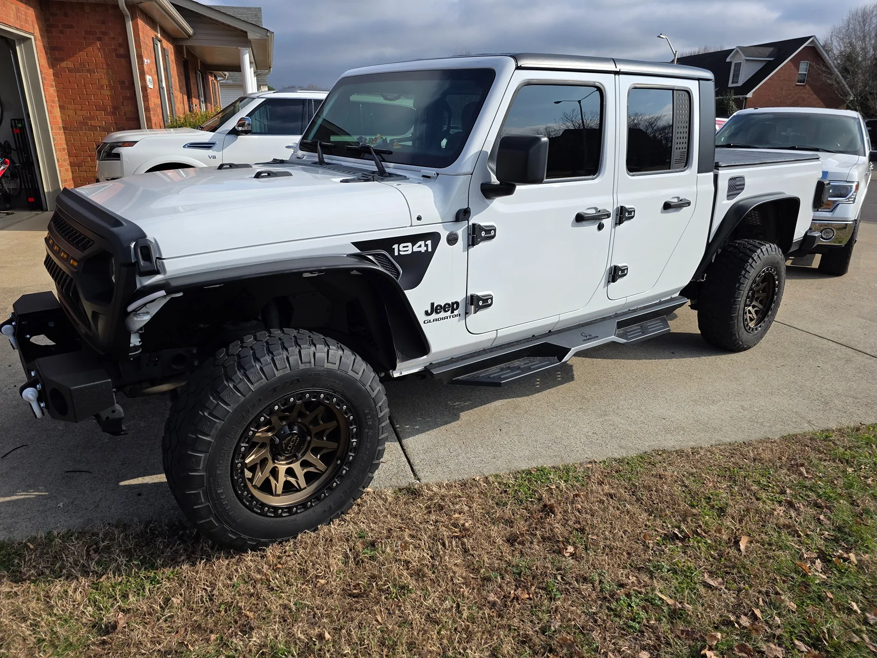

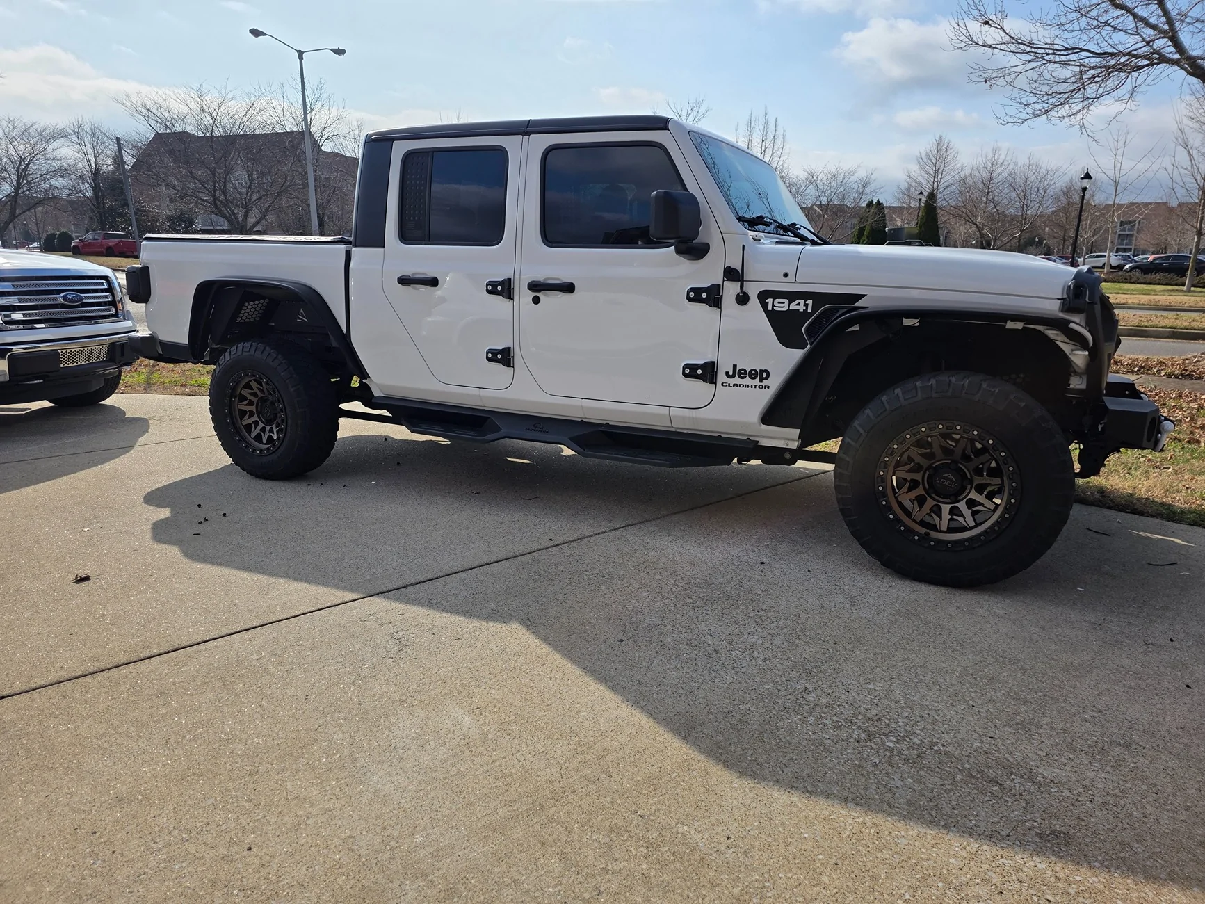

Stubbied the front bumper today in preparation for the winch to go in when the plate shows up!
Nice job.never left s mark

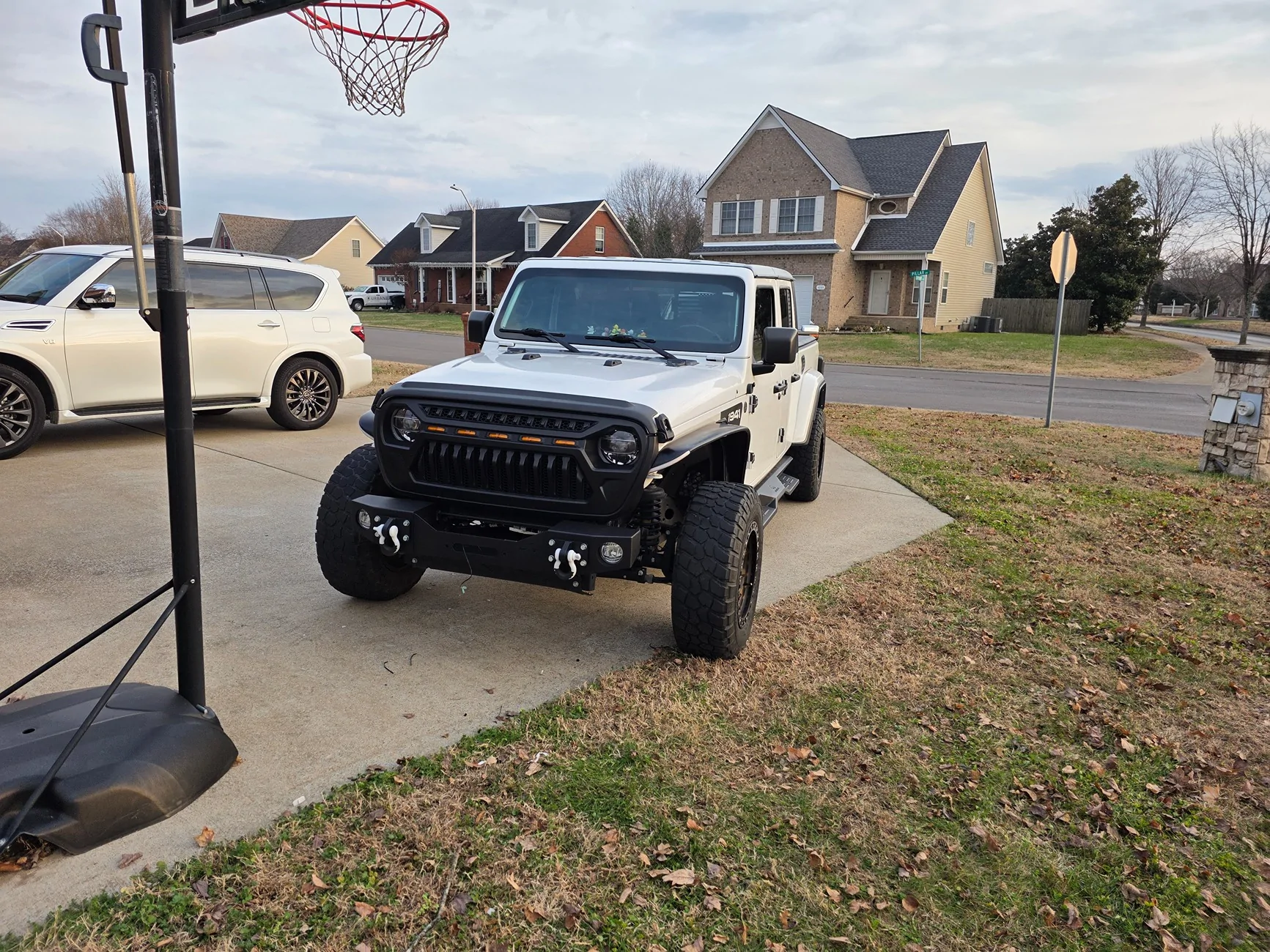

Got the Attica Frontier liners and the KBD fender flares (unpainted) installed! Thinking I may LineX them when they start looking worn. We'll see. But there's plenty of room for the 35s that will be added come spring... Merry Christmas!
