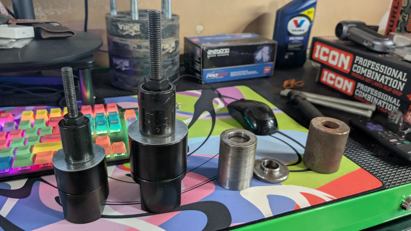

I have a Johnny joint press that would likely do it, but I can’t image it’s fun regardless.
Hell I'm still up and drinking beer. Left to right,
CE-9112T - 2 in. Johnny Joint Assembly/Disassembly Tool
CE-9110T - 2 1/2 in. Johnny Joint Assembly/Disassembly Tool
RJ-530000-1 - Tool Base (for Uni-Balls and JL/JT/JK Axle Housing JJs)
RJ-530001-3 - Tool Adapter Washer (for Uni-Balls)
CE-9102KT - Johnny Joint Install Tool (Factory JK/TJ/LJ/XJ/MJ/ZJ Axle Housing Kits)
RockJock tools link

If you're JJ on all the other arms, in my experience with my TJ, it really helps to tighten up the suspensions and get rid of that last little reverb. Yet to confirm on the Gladiator but so far the changes I've made translate just the same.
The JJ press service tool you buy from RockJock is for rebuilding the joints in a vise. It doesn't directly facilitate the removal/replacement of joints in the axle ears but some parts can assist. You need a ball joint press or a bfh. The new joints can be ordered with a two piece tool that assists in hammering the old joints out and new joints in but it's different than the JJ tools I posted earlier. And it's not a press in and of itself, just a driver.
::edit:: the more I think about it you might be able to use the JJ tool to press the new joint body in but I don't think the threaded rod is up to the task. It's designed to press a rubber bushing, not an interference fit metal/metal bushing. Use a bfh or ball joint press, don't break your handy JJ tool. The official tool of choice by RockJock and Currie is a BFH and their driver tool.
No, I don't think interference between the arm and the mount is an issue. Whether the joint is fixed in the axle or the arm the angle it sees is going to be the same. I don't actually know the reasoning for why they press the bushings into the front axle from the factory. The JJ ball through the joint provides plenty of offset and is offered in several different widths for different setups. It'll allow enough movement.
Easy Peasy.
Makes sense. I’ll be interested to see the results.
RockJock tools link
Yep. I have the larger one. Obviously designed for a vise, but I’ve used it on the trail with a huge crescent wrench.
