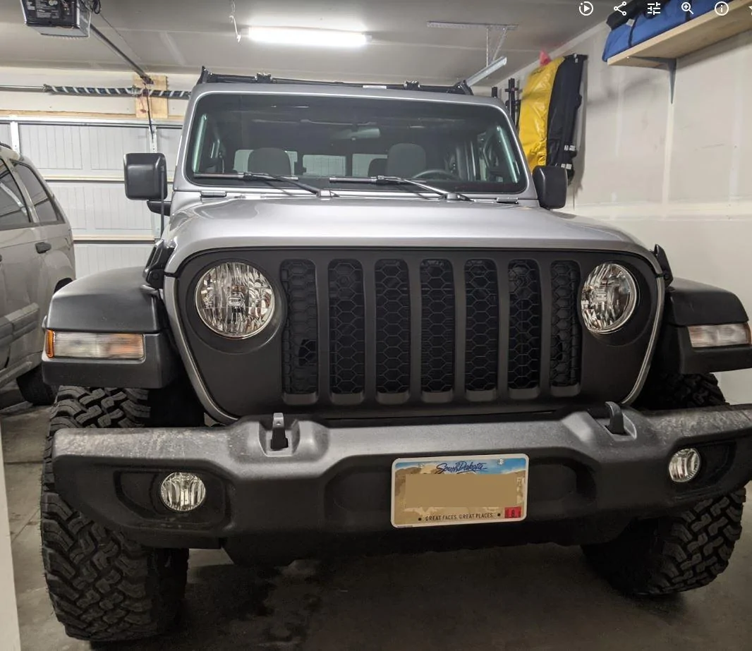

Decided to plastidip the grille today. I was pretty bummed when I found out the sport doesn't come with the removable body-colored trim pieces around the sides of the grille, but a little tape job and plastidip got the look I was after. FYI, I used a 50/50 mix of denatured alcohol and water to clean the grille. I then used electrical tape to mask off the outer trim pieces instead of painters tape since it's easily stretched around the grooves of the grille, and then 5 coats of plastidip (peel the tape as soon as you're done with the last coat otherwise it won't tear clean if it's fully dry). Hopefully it holds up as long as some suggest, but if it doesn't it's only $10 lost.
Did you remove the honeycomb? Looks good. I have the plasti dip. Just working up the courage to actually do it lol.

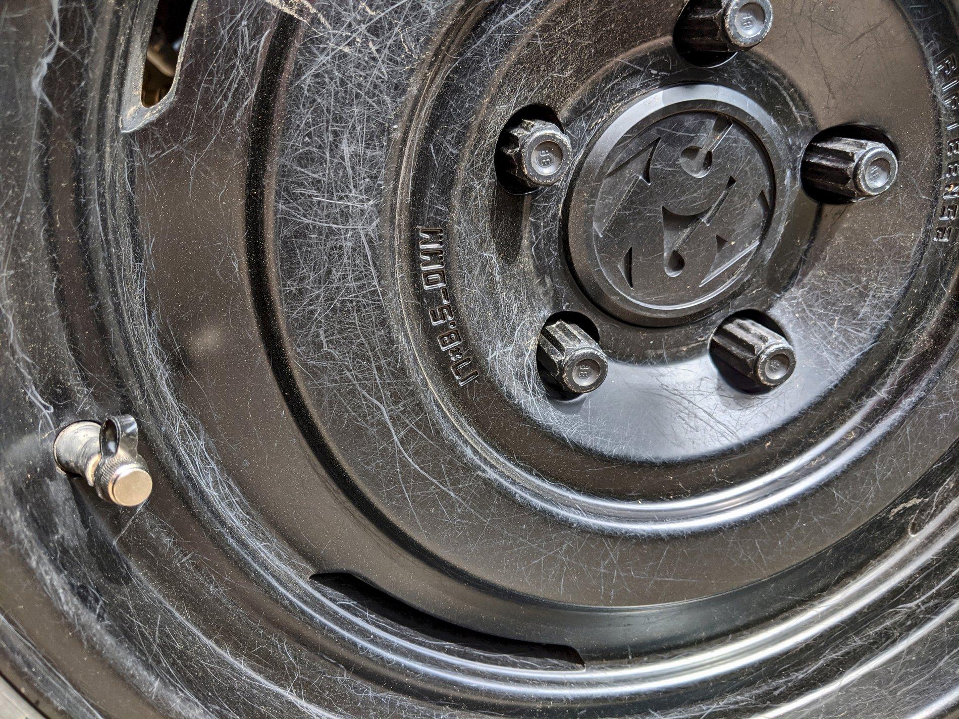

Tiny, but quite handy thing (for those of us who air down our tires): Added Extreme Outback tire valve caps. The lanyard holds the cap in place while you're airing down and up. No searching for one when you accidentally drop it on the ground. Still have a Genright Genesis dual-battery kit and two Odyssey batteries to install, and four KC LZR lights for the front bumper. I'll need to fabricate up some type of bracket for the lights.

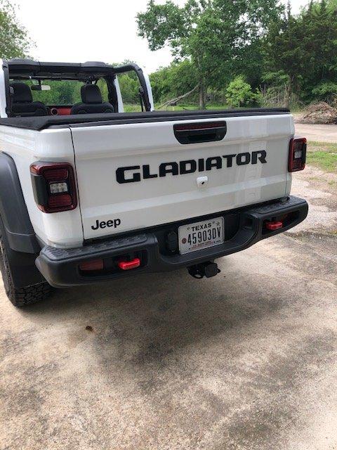

Funny cause mine came in and I painted them red also today to match diff skids I installed last week
Awesome! Red - why not! Good luck with the install. It was a bit tough. Post some pics.

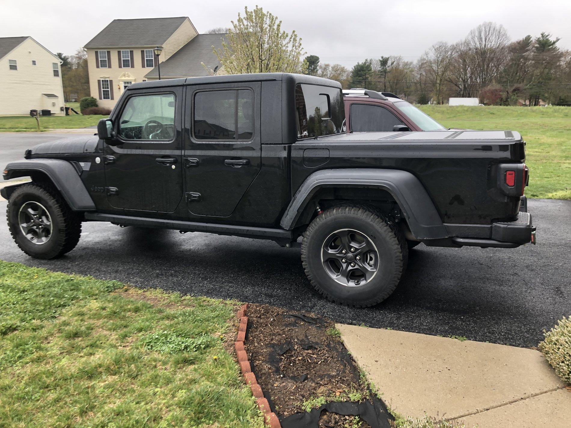

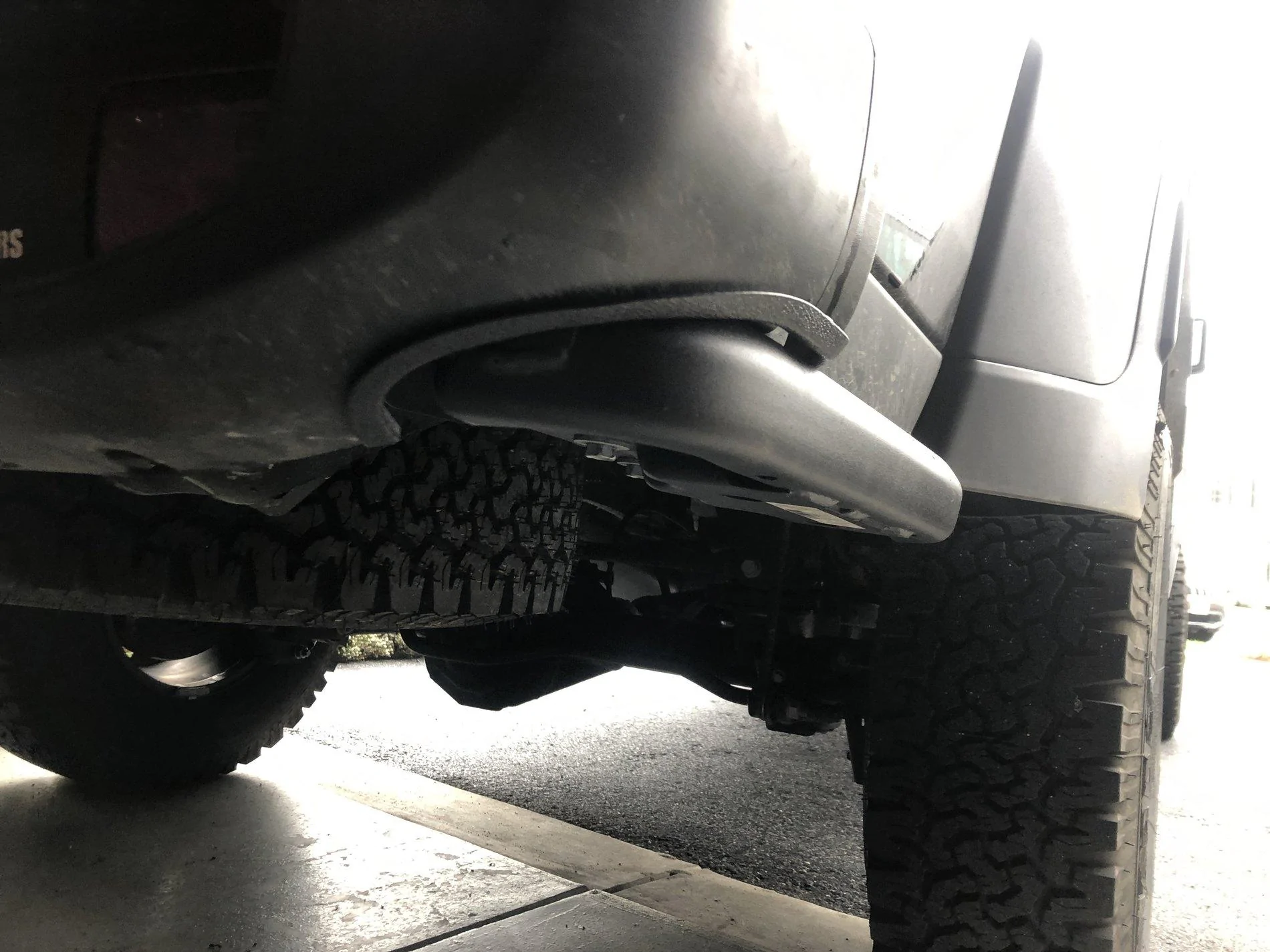

Installed rubi take off rear rock rails recently.
Also put in my rubi take off fox shocks and fox steering stabilizer
Thanks for the picture. I’m glad to see that the rear rock rails work with a saggy butt. I’m actually looking at getting a set as well.
I don’t get why they do that... once seen... ya can’t unsee, lol.
