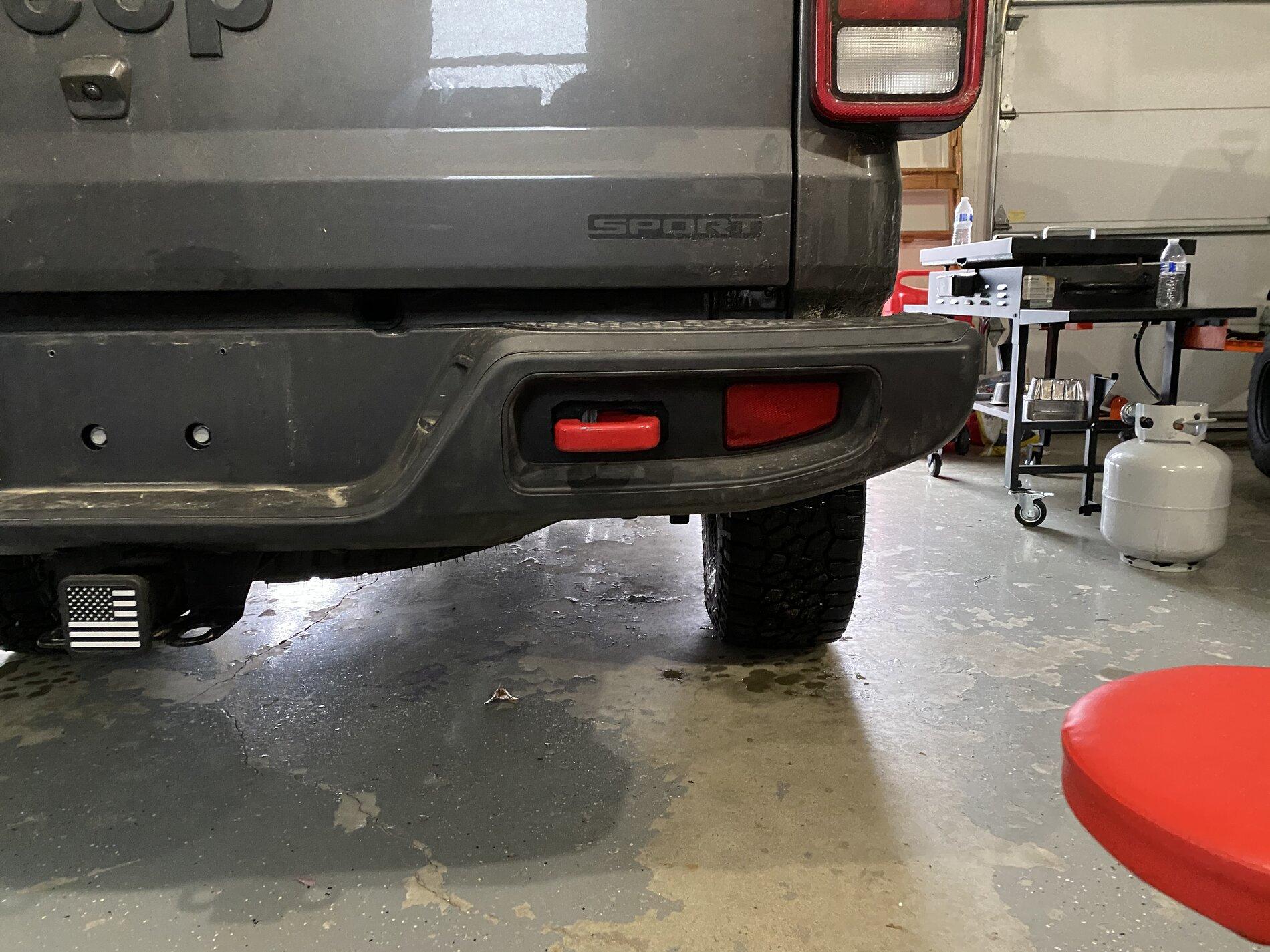

Looks good! How was the disassembly of the rear bumper to get to the bezel? That thread you linked to said it was a nightmare so they just cut the plastic. I’d rather use the correct bezel. I just ordered the parts...any tips? Thanks
Like the thread mentions, it is a PIA. There is a youtube video that shows some of it, but not the part I really needed (he gets down and dirty into the bumper but never actually shows you when he is removing the old plastic bezel. Just shows the new one in place). He did help in that he shows you only have to partially disassemble the bumper and then focus on the one side. Lots of clips, nuts and push tabs.
Here's the Youtube video I am referring to:
One thing he mentions is at 4:14 where he talks about one bolt holding the large metal plate in place. He cut the metal tab the bolt is threaded into to be able to pivot the metal plate out of place and to get access below. I did not have to cut that metal tab (I saw no way to fix it without full bumper disassembly). I was still able to pivot the metal plate and have it rotate over the plastic part of the bumper by going gently. So, when I (easily) swung it back in place when I was finished, no harm, no foul.
Anyway, my main problem was: to actually install the new $5 plastic bezel in place, I ended up having to use an air body saw to cut the old $5 bezel up (while in place). That let me deform it and pop it out. The issue I had was getting to the mounting clips on the one edge to free them up. I couldn't reach them with any tool (and I have a lot) to do it. Somehow, he got the old one off because he shows it out in the video and on the bench but doesn't show how he did it. Maybe my clips were just stubborn. If you have the same issue, study the new part and you can see where the tabs mount. (If you cut your old one out do so VERY CAREFULLY to not cut into the actual bumper cover. I did the bulk cuts with the body saw and then finished with a razor knife so I would have more control.)
Overall, it wasn't too horrible. I've had much, much worse vehicle projects. But, it was a pain. So set some time aside for it. Trim tools are your friend for this job.
(It actually took me longer to fab up that front light bar, but that was fun too.)
Anyway, good luck when you try it ?
Wow....thanks for the detailed info! Maybe I’ll just cut a hole in it after all. LOL
ill probably try to disassemble everything when the weather warms up. My Glady won’t fit in my garage.
Cut it and if you’re not happy then try the bezel. You won’t be out anything.
I'm very anal with my vehicles. So, I knew I wouldn't be able to look at it every day if I just cut it since it wouldn't look OEM. Especially on a brand new truck when I knew ahead of time that it was doable (although a pain).
